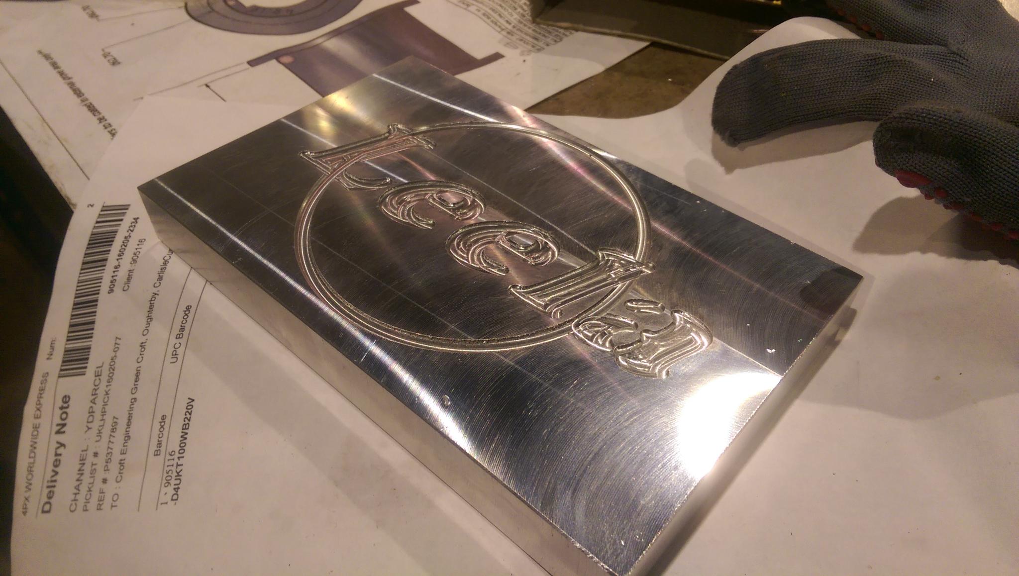

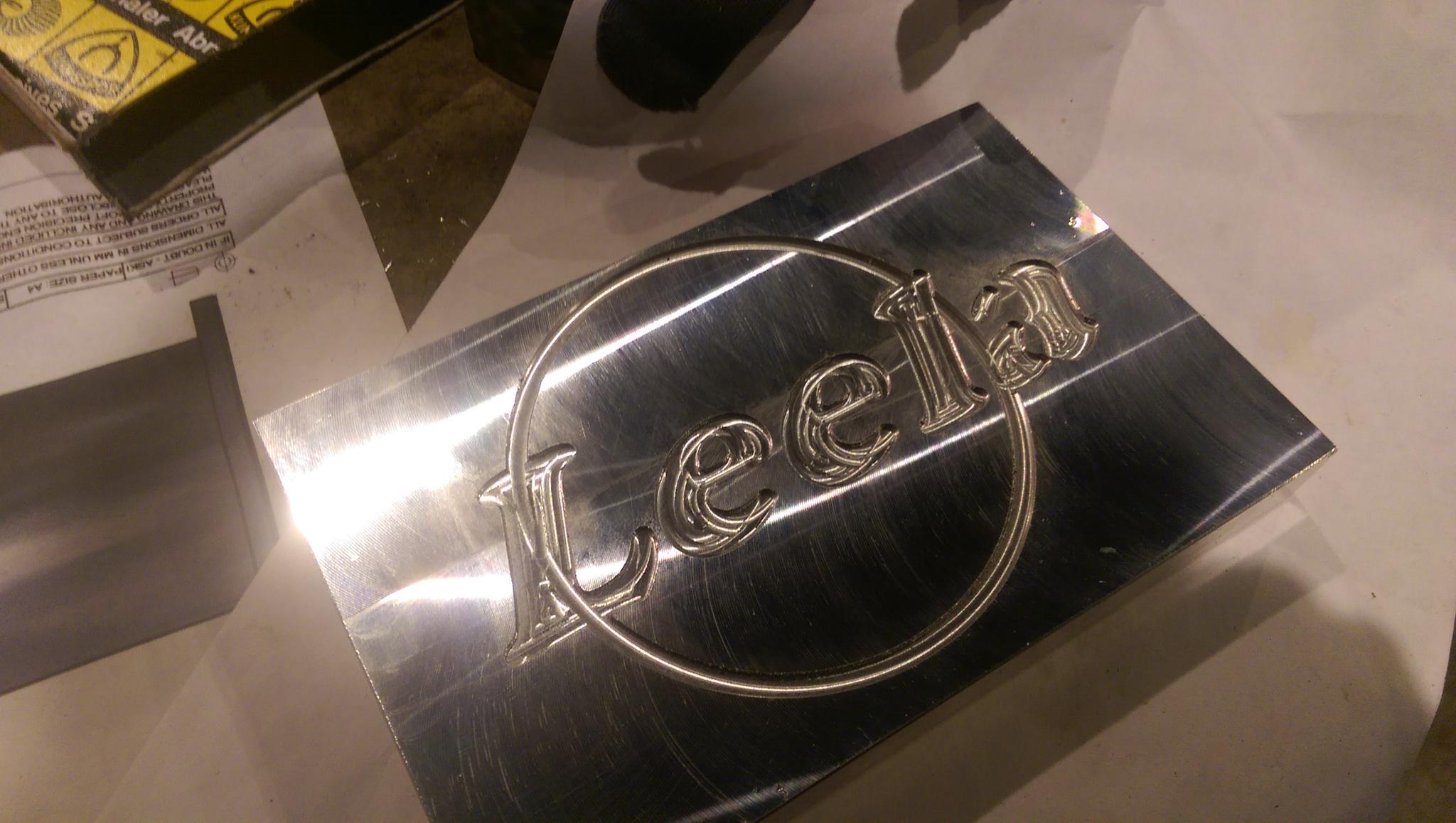

    Finally got it working! used Ade's 151 post processor took quite a lot of modifying to work for the 145 hey ho i now have a cam bam'd name-plate!
    Chuffed to bits.
    The circle was a mistake but it still looks neat. :)
    Thanks for all the help.
    Cheers,
    Jack

  7. #6
    Good to hear a +ve result !
  8. #7
    Share it here too !
