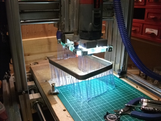

    I bought a Chinese 22m bottomer for £2.08 and a 30mm one for £3.43 + £1.00 postage. Both did the job and are good for making MDF dust and this inspired me to make a dust shoe. The brush is attached to the base by magnets, to allow easy removal for tool changes. I have yet to test it as I have already surfaced the bed.
