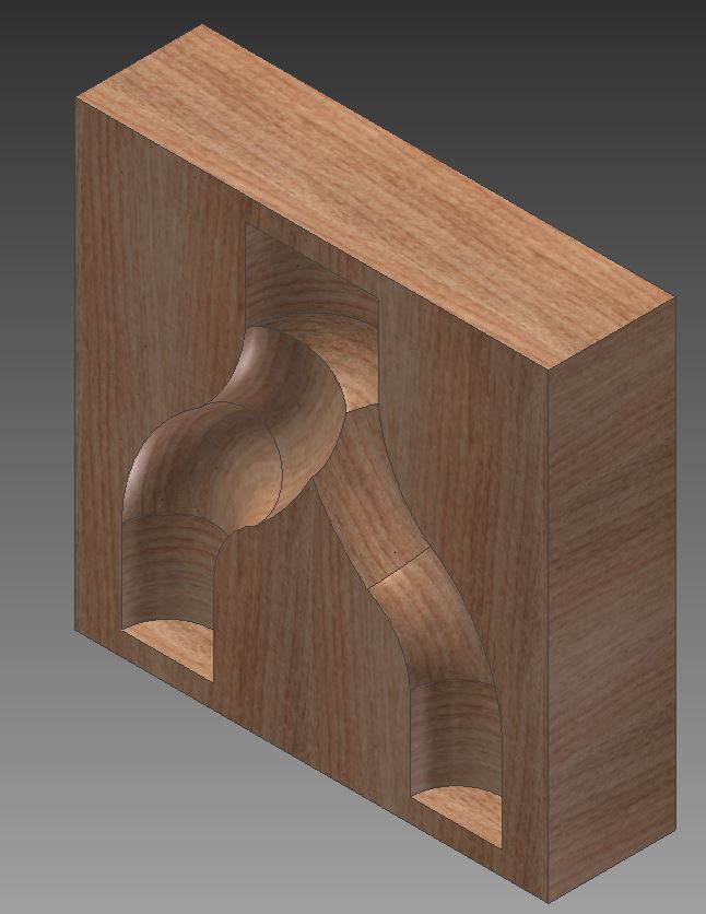

    While still waiting on the fan adapter so I can cut with the machine, I decided to draw up a dust collection adapter mold to lay up fiberglass in. Video shows the machine running this code.

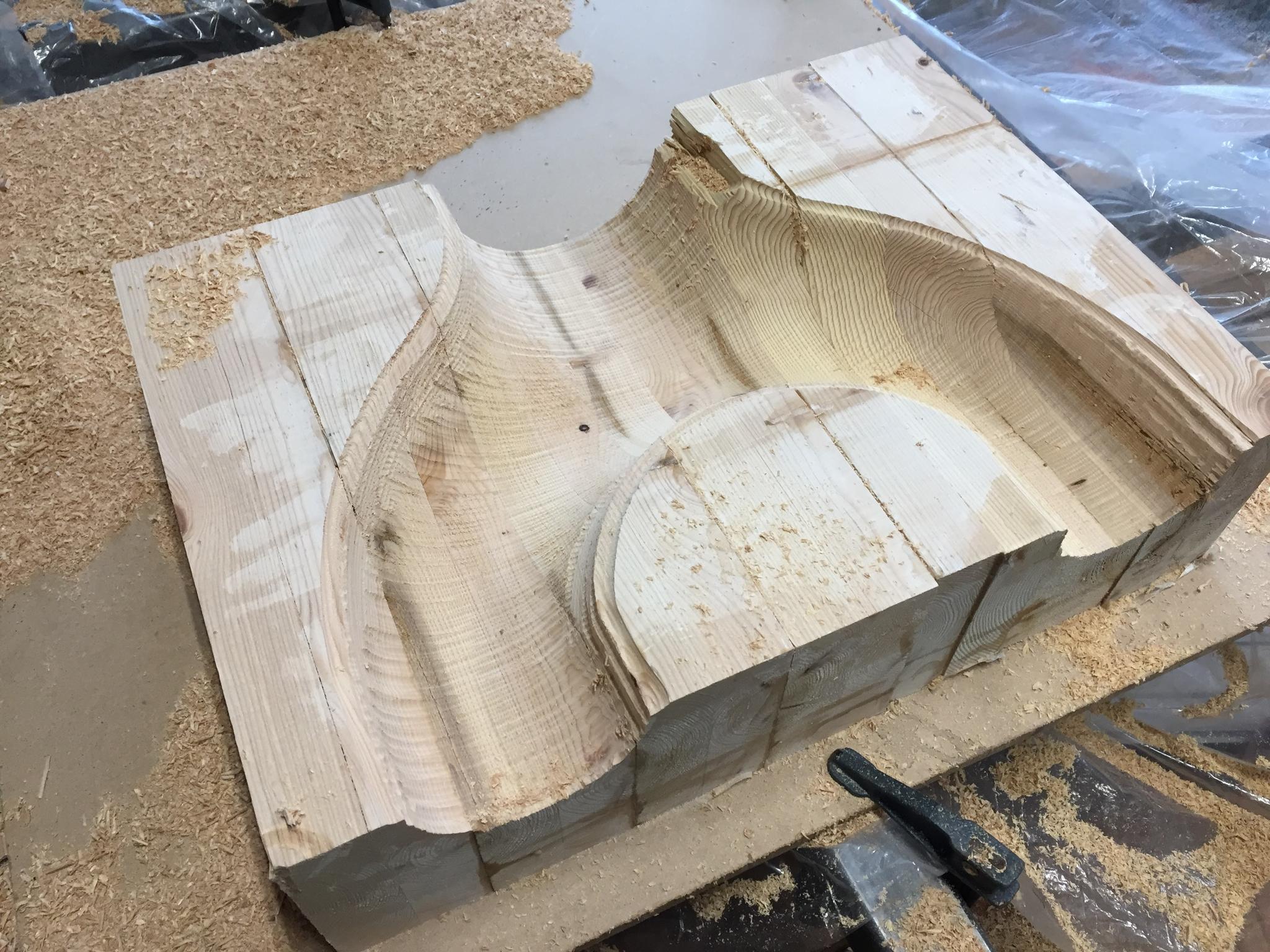

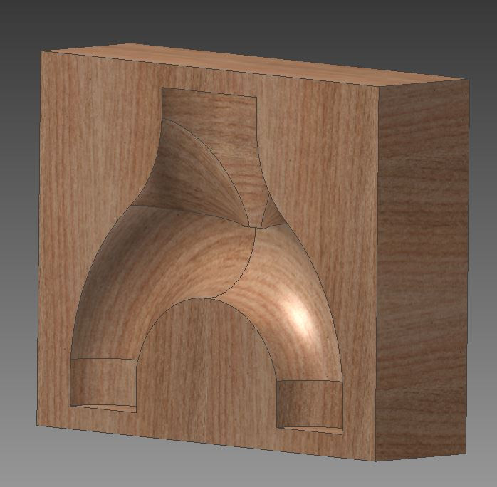

    So I decided to make a temporary spindle cooling fan adapter and get this thing cutting. So the first thing I wanted/needed to make is the dust collection adapter mold.

    Turned out pretty good for the first cuts, here is a final picture and the first 1/2 of the dust collection adapter laid up in fiberglass.

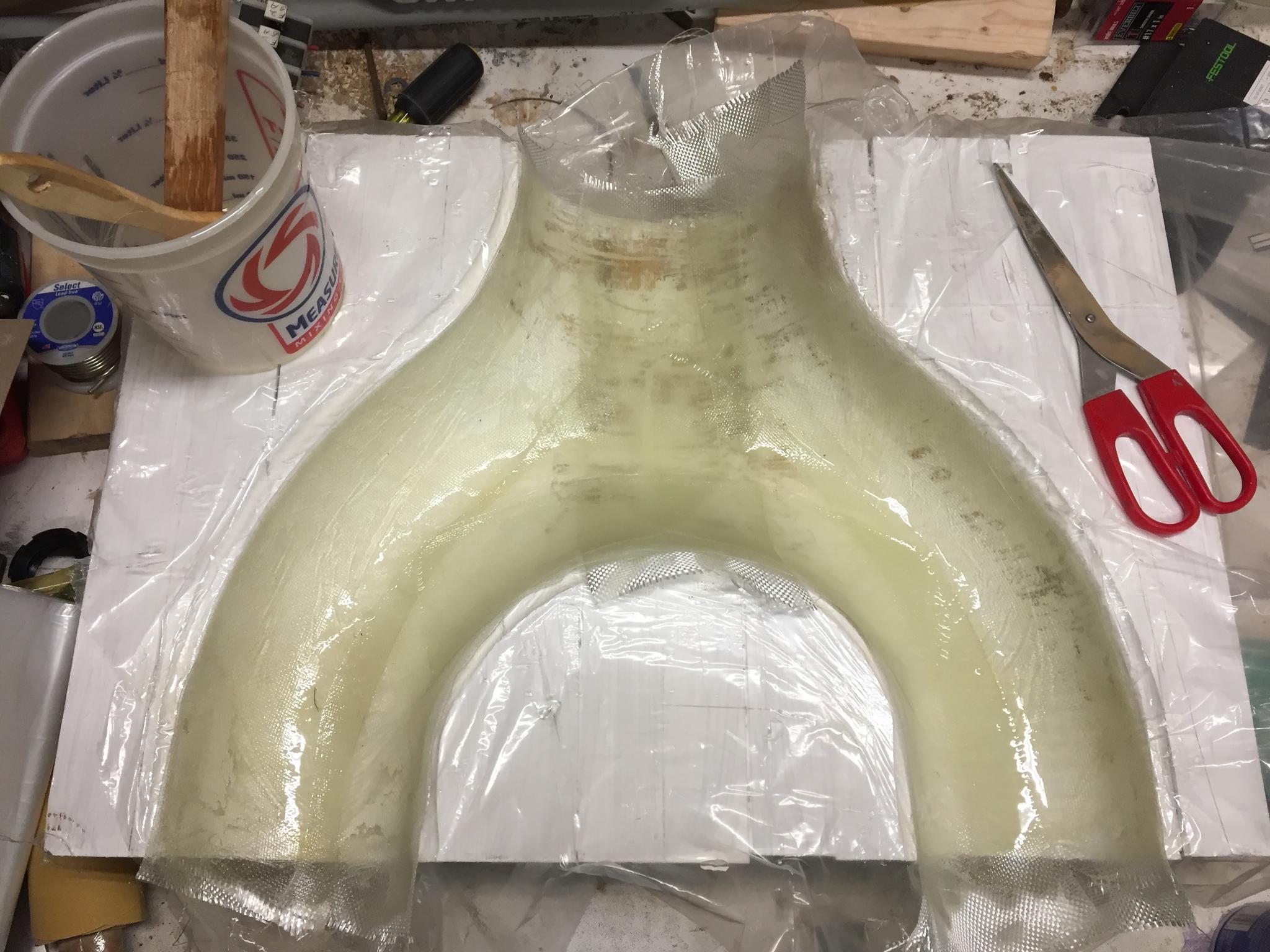

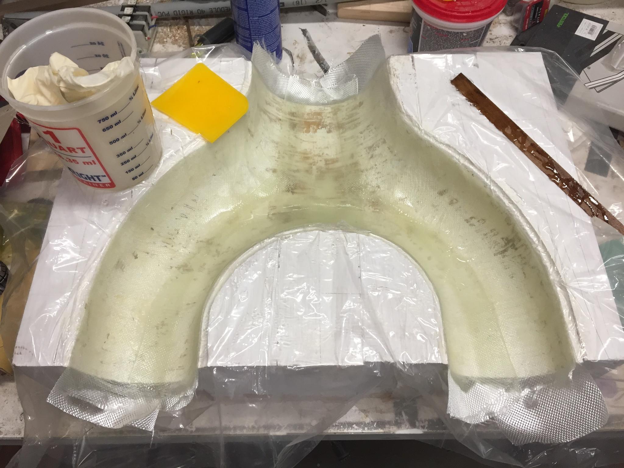

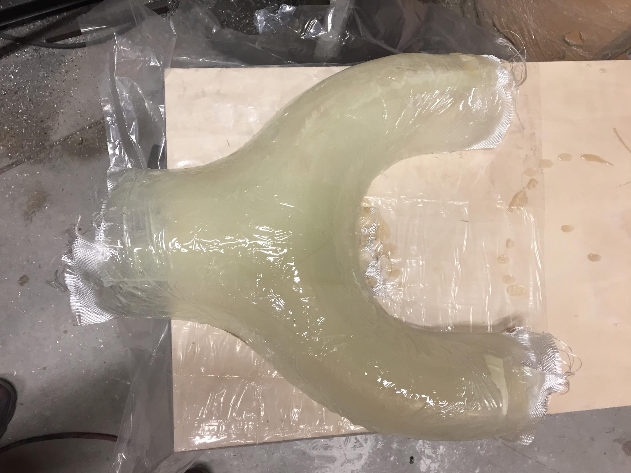

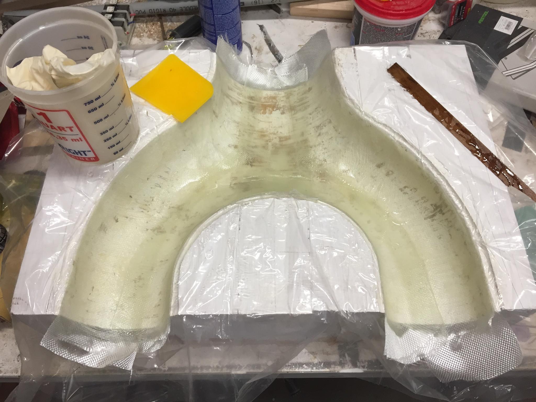

    Made some progress on the dust collection adapter first picture is the first half out of the mold and the second is the second half laid up in the mold.

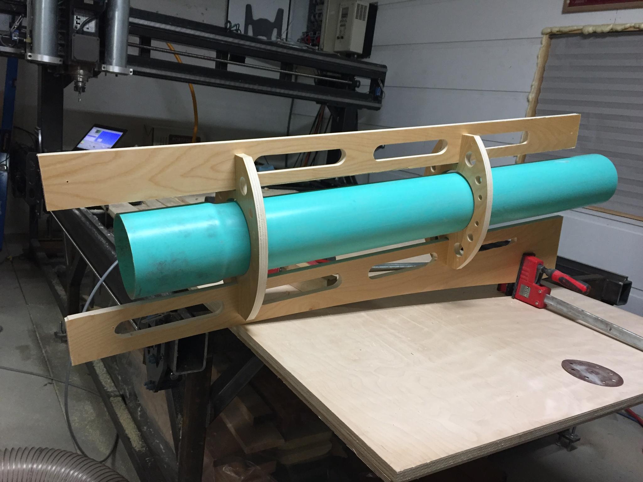

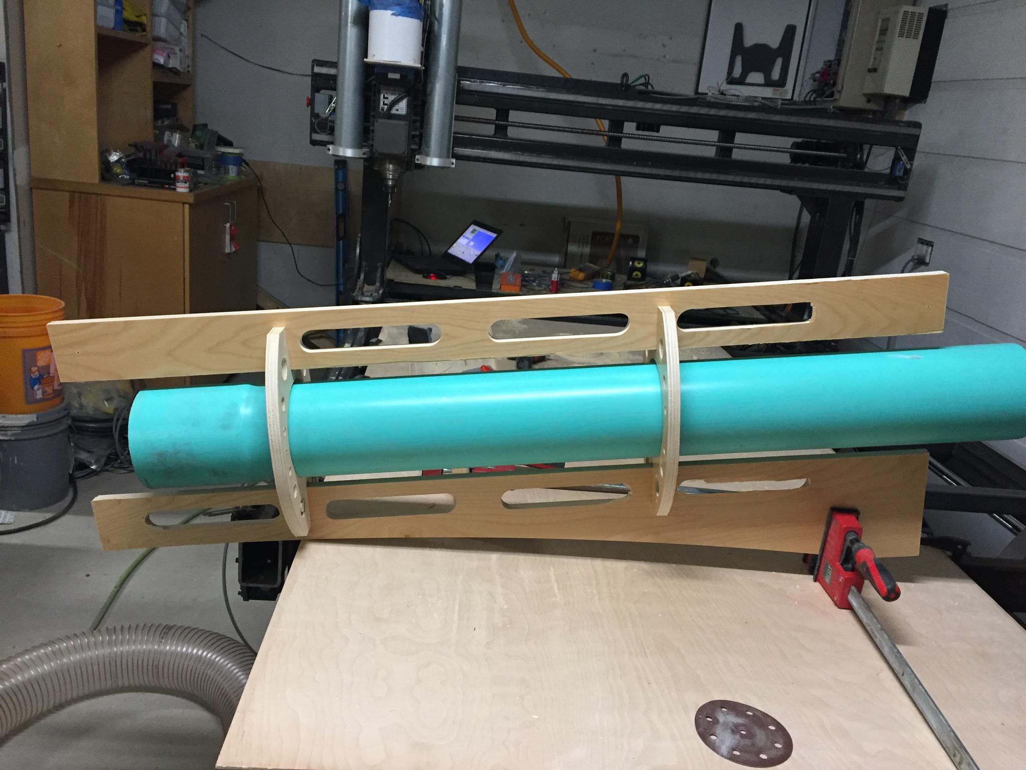

    Also worked on a support arm for dust collection tube. It bit overkill but it was fun to make...
