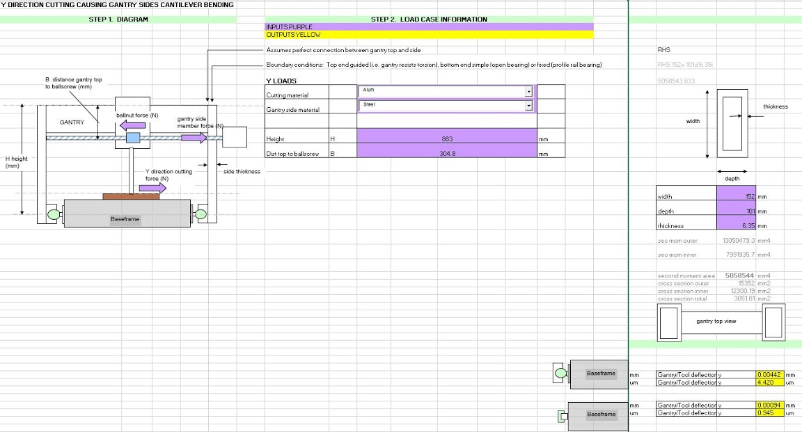

    Alright so I ran the numbers through the excel spreadsheet.
    Heres what I got
    0.010mm deflection
    0.00028 deg delfection
    deflection at tool 0.002mm
    0.00094mm deflection
    Maybe I am entering the numbers wrong I will run through the numbers again but these look better than what I got when I just did the free body diagram. Thoughts on these?
    These seem acceptable but im not sure what I should be shoot for as far as max deflection?
    Thanks for any help. Want to make sure this is right before I get too far that I cant make changes.
  5. #14
    Hi Scott,
    I wrote that spreadsheet some time ago to compare simple shapes. For the numbers you have entered it looks like it is giving the correct answers.
    Things to note:
    It assumes everything else (e.g. spindle, tool, bearings, bedplate, joints . . . .) is infinitely stiff - so it is best case
    Have you entered just one of the two gantry beams? If so the real stiffness will be higher as you have 2
    Or have you given the overall gantry dimensions as a single beam? If so the real stiffness will be lower
    It makes no prediction for deflection due to cutting vibration and machine resonance
    It terms of max deflection it is personal choice but I would say wood <0.05mm and alum <0.01mm as a starting point. Others opinions welcome!
    I get the point about raised gantry vs raised X axis (in the US this can be Y axis) for material loading, so as long as you've thought about the options and made a choice that's fine. Didn't know what you knew.
    In summary you have a very stiff machine that is stiff enough for wood, but that gantry is heavy (hence our concern over stepper/driver/voltage - if you know these are OK then that's good), and resonance is unknown (the sheet can't show this).
