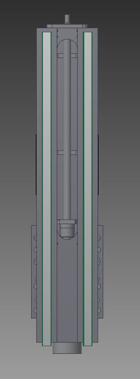

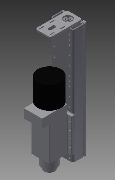

  9. #49
Name:	New Z Axis.JPG
ID:	17960Click image for larger version.
Name:	New Z Axis3.JPG
ID:	17961Click image for larger version.
    I think this will be my final Z axis design. 20 inches of travel with the ballscrew inside a 3inch x 5inch x1/4 wall box tubing. I have added supports to the internal of the box tubing to add strength and support the tubing when I cut the large slot on the backside for the ballnut.
    I think this will keep it pretty compact and also plenty strong. As always comments are appreciated.
    Scott

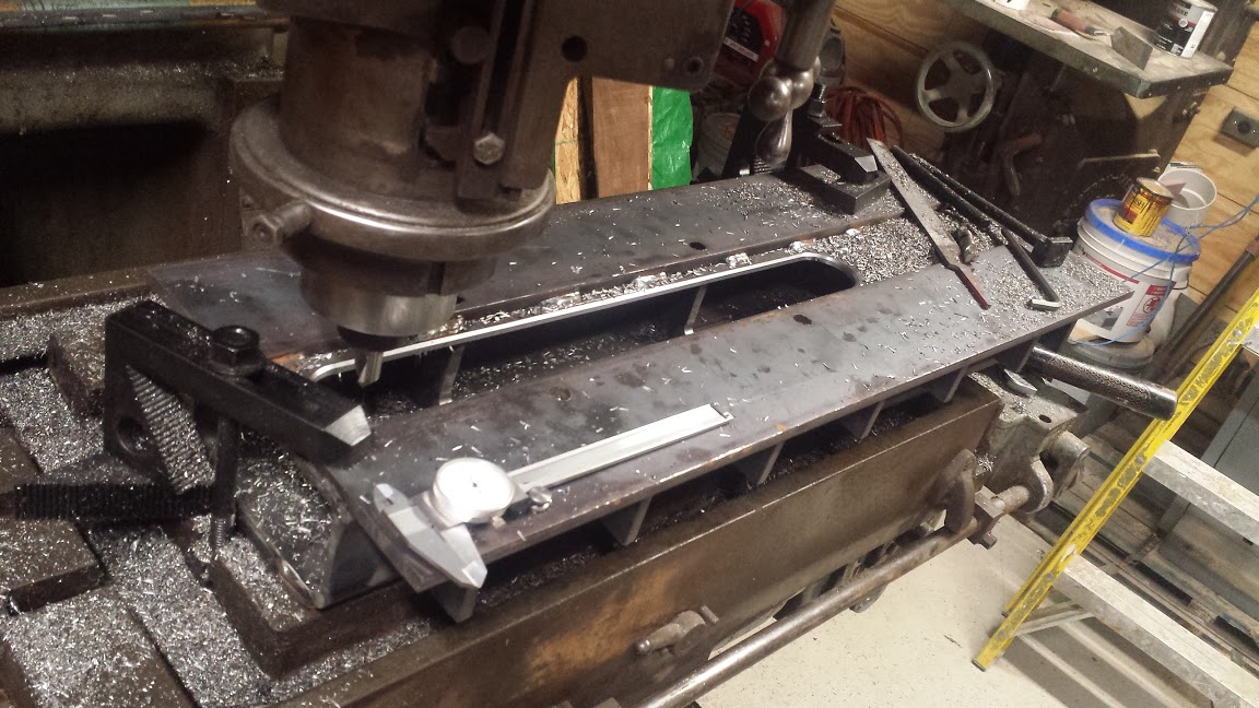

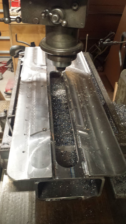

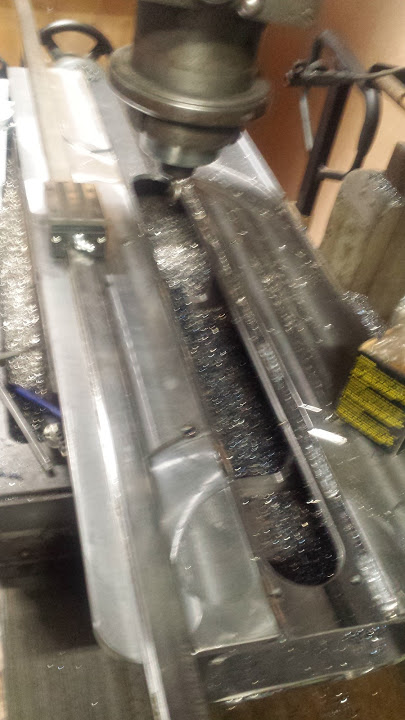

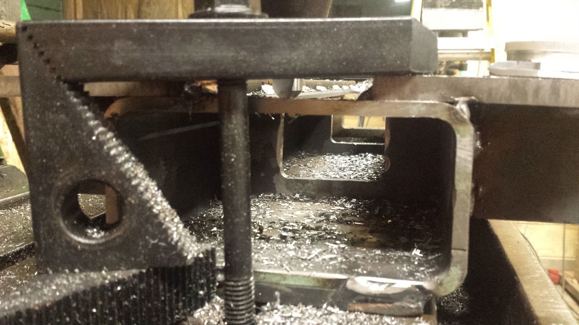

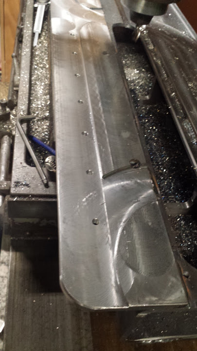

    I got a bit done on the Z axis over the weekend. When I was laying everything out for the Z I decided that 4.5 inches between linear rails was not wide enough. So I welded on some 3/8inch plate in order to widen it to 8 inches center to center on the rails.
    Starting the milled slot for the ballnut to travel
    Slot cut through and now cleaning up the edges
    Internal view showing 2 internal supports. I figured these were needed to help keep movement to a minimum when I cut the large slot in the tube. They had to be driven in with a sledge as they were a little tight but I got them in. They are welded in place by drilling 3/8inch holes in the box tubing and then spot welding through those holes.
    Begining the face milling process. I milled a linear reference for one of the rails. The curves are just the tool paths I had to take to make it all work as my mills travel isnt enough to do the whole thing in 1 pass.
ID:	17979 Click image for larger version.
    Here you can see the milled linear reference for the rail
    And a blurry picture of one of the rails test fitted
