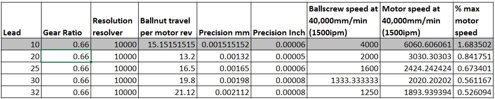

    Ballscrew
    I need to finalize my plans for the X axis ballscrews so I can make mounts for them. Then motors mounts.
    So a couple questions -
    Do the numbers for the 2525 screw look good and make sense? On this long screw should I go with fixed:fixed mounts, I have read that this can stiffen things up a bit for a long screw.
    Like some of the big guys do, can I get away with intermediate supports along the ballscrew and drive the screw? Or go the rotating ballnut route?
    Do I even need the belt ratio on the X axis ballscrew? Would the motor speed be to slow without the gearing (~1600rpm at 1500ipm)? If I spin the screw, I could go direct drive with a 0 backlash coupling. Not that belting is all that difficult to implement it just takes some complexity out if I go direct coupled.
    Motors
    Ive run my inertia numbers multiple times with a few different numbers to try to account for some unknowns.
    What I ended up with is, 2 of the 1.8kw motors for the x, the inertia ratios in my calculations worked out between 1.75 ---> 3.4 depending on the numbers. And the torque worked out between 4.25 -->5 Nm per motor, these motors are 6Nm so I feel like this is a pretty good choice.
    Then for the Y I went with the 0.75kW motor 2.4Nm motor, inertia ratio calculations worked out between 2.25 --> 3.5 and the required torque was around 1.5Nm so a little headroom on torque.
    I also picked that same 0.75kW motor for the Z, my inertia ratios get closer to 1.5 here and if I find issues I could change the gear ratio
    If anyone has thoughts on these options for the motors Im all ears.
    One thing, that I cant yet confirm, but it looks like the drives from Fred show a limit on the inertia ratio of 5. This was based on data I found online from who I think is the supplier of the drives.
    Resonance
    I think I will cross this bridge if/when I need to. In my day job I am a noise and vibe engineer (although automotive and nothing to do with machine design) so I may be able to figure out the correct countermeasures. I will say, as the frame sits it rings when hit, so I may borrow some accelerometers and do some impact testing (frequency response...) on the machine and just see where things are if I get ambitious.
    Thanks for all the help this far!!!

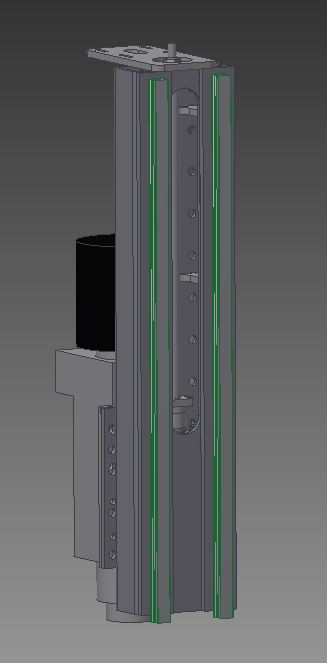

    I think this will be my final Z axis design. 20 inches of travel with the ballscrew inside a 3inch x 5inch x1/4 wall box tubing. I have added supports to the internal of the box tubing to add strength and support the tubing when I cut the large slot on the backside for the ballnut.
    I think this will keep it pretty compact and also plenty strong. As always comments are appreciated.
    Scott

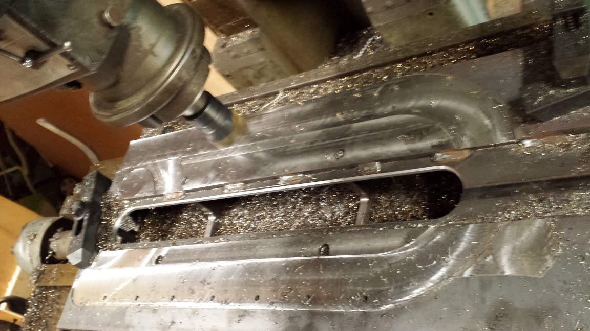

    Starting the milled slot for the ballnut to travel

    Slot cut through and now cleaning up the edges

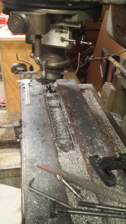

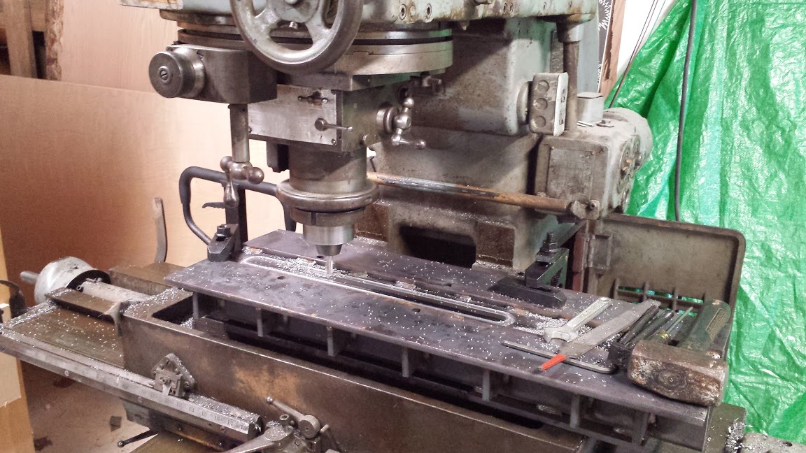

    Begining the face milling process. I milled a linear reference for one of the rails. The curves are just the tool paths I had to take to make it all work as my mills travel isnt enough to do the whole thing in 1 pass.

    Here you can see the milled linear reference for the rail

    Is that a manual mill or CNC controlled? Either way, good craftmanship!
    Quote Originally Posted by sinnsvak View Post
    It is a manual mill but it has a rotary head. Pretty cool machine, Kearney Trecker 2D rotary head die mill. I had never seen one before and just stumbled across this one when looking for a mill. It can cut circles up to 8 inches. The one I have was built in 1946 and was a little rough, very helpfuly with this cnc router build. Although the table only travels 18 inches X and 12 inches Y so for the Z axis its a bit limiting... but I find ways around that so not a big deal.
