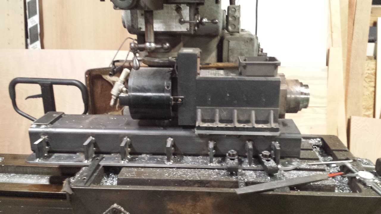

    It is a manual mill but it has a rotary head. Pretty cool machine, Kearney Trecker 2D rotary head die mill. I had never seen one before and just stumbled across this one when looking for a mill. It can cut circles up to 8 inches. The one I have was built in 1946 and was a little rough, very helpfuly with this cnc router build. Although the table only travels 18 inches X and 12 inches Y so for the Z axis its a bit limiting... but I find ways around that so not a big deal.

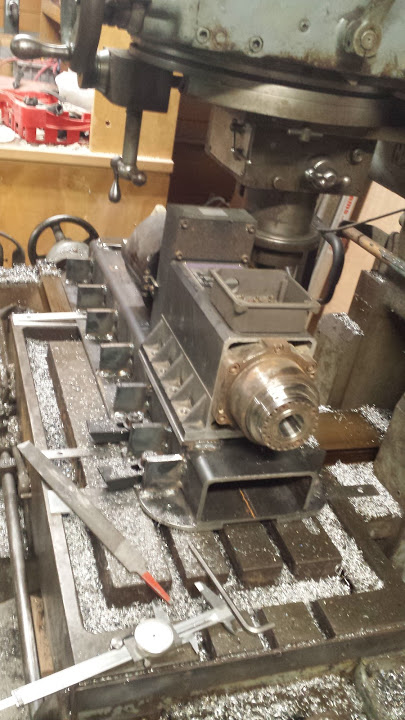

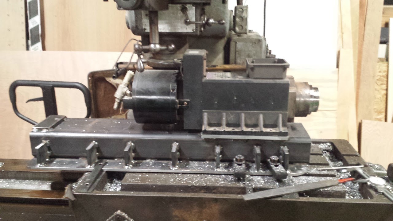

    Quick update
    Z axis machining is done. Now just need to start putting this together waiting on ballscrews to arrive. I hope to do the epoxy pours this coming week as the weather is starting to get warmer...

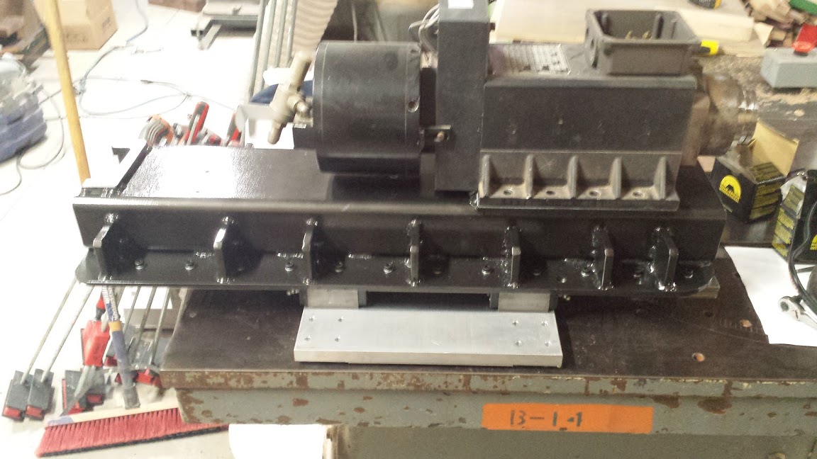

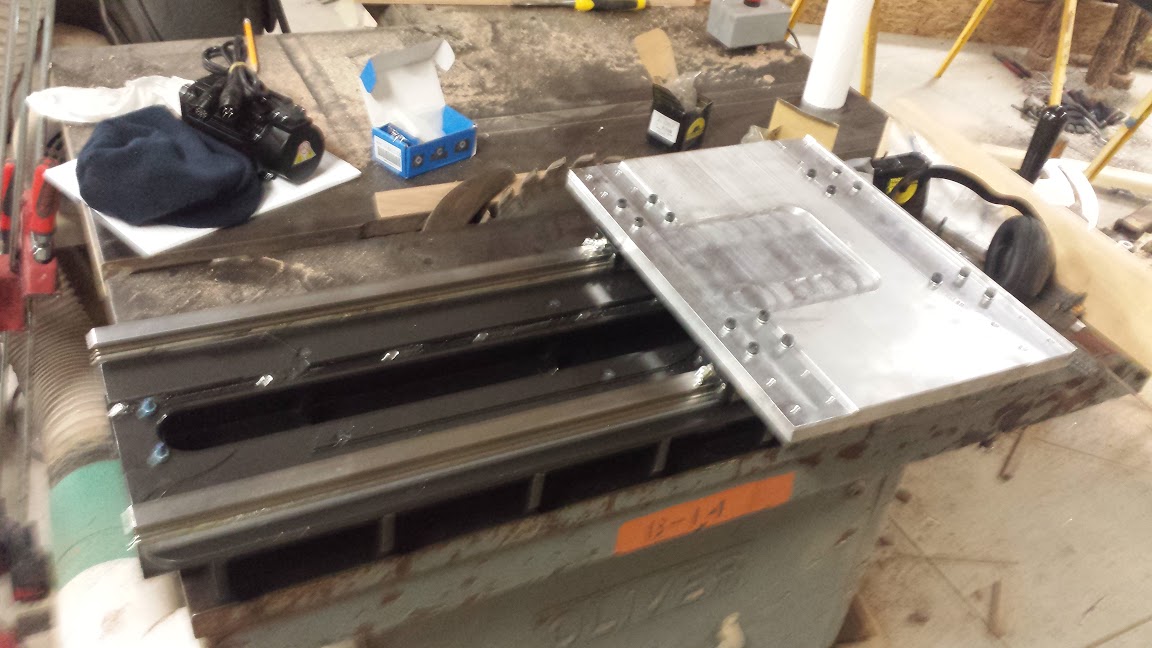

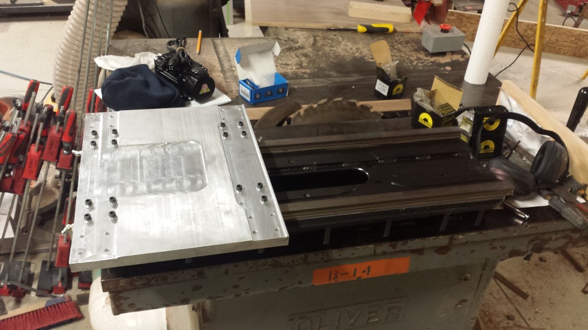

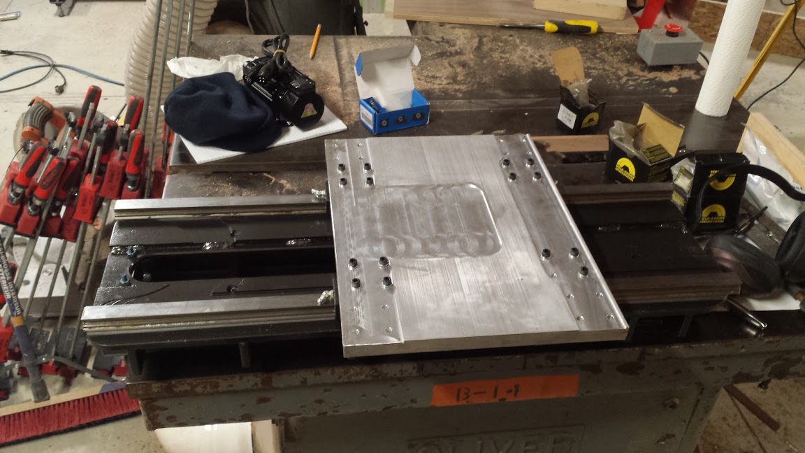

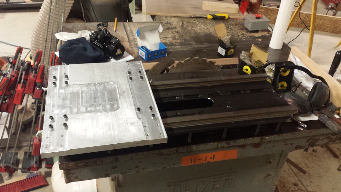

    Finally a little bit of progress, got the Z axis final machining done, painted the metal work, and installed the linear rails. I also made up the Z to Y plate and did initial checks for squareness.

    I am waiting on my ballscrews to arrive so I can finish the build out of the major mechanical parts. Crazy how they can go from China to US and clear customs in 1 day and then take 4 days sitting 3 hrs from me... Still no guarantee they are coming tomorrow.
    Once ballscrews are mounted and some initial adjustments are made I will do the epoxy pour.
