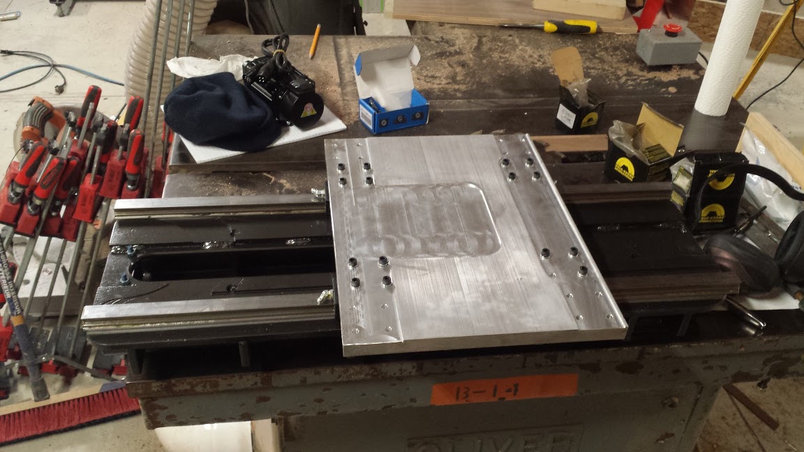

    Thanks for the thoughts on mounting the VFD to the gantry. I had kinda thought about those items as well, the main driver for me was actually 3 phase switching noise caused by the VFD. I use double shielded VFD cable but at these high frequencies (300 - 400Hz AC at 2.5khz switching) there can be alot of noise that causes interference elsewhere in the home. Anyway I have scrapped the idea in favor of wall mounted.
    Finally some updates on the machine.

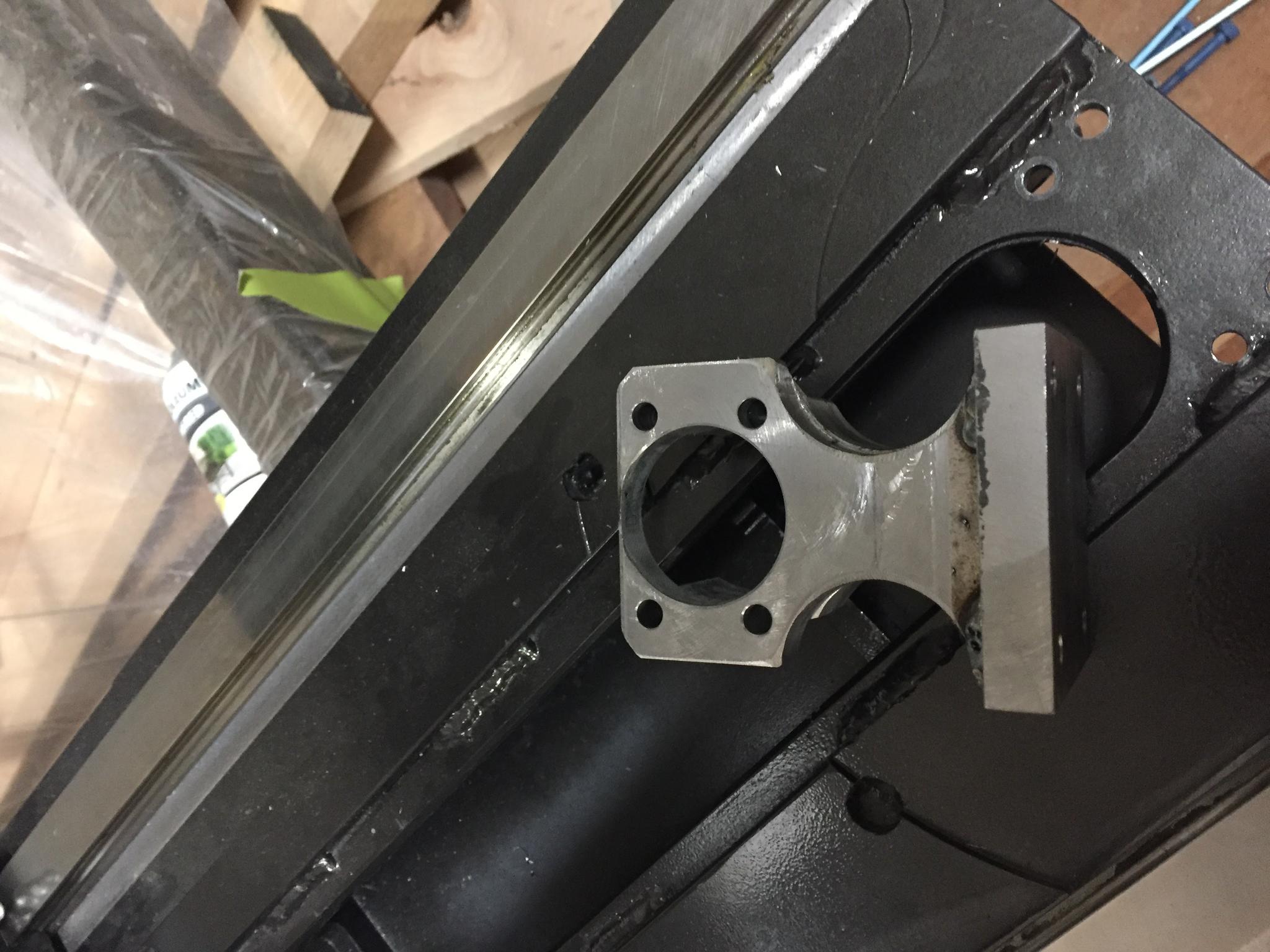

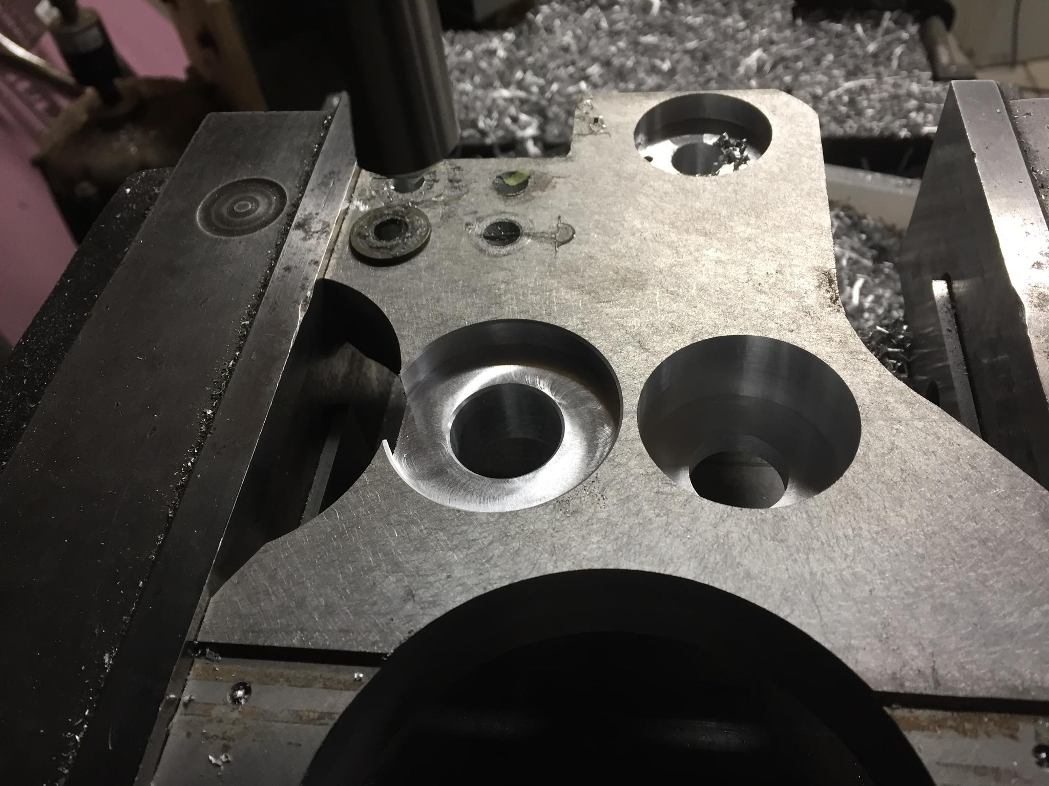

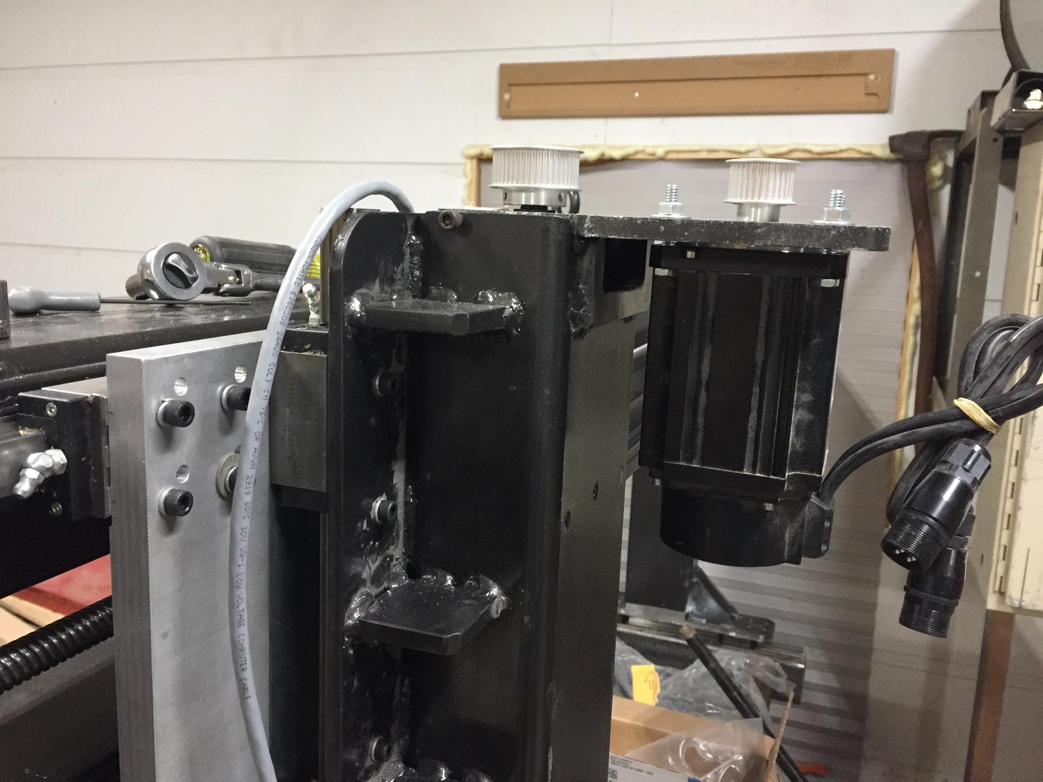

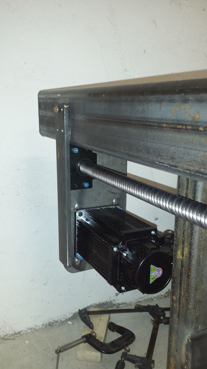

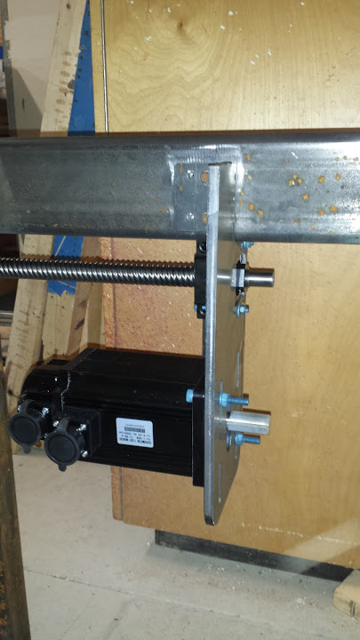

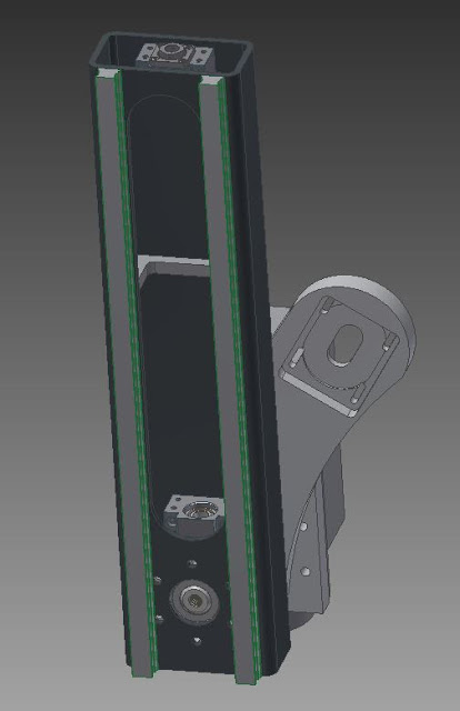

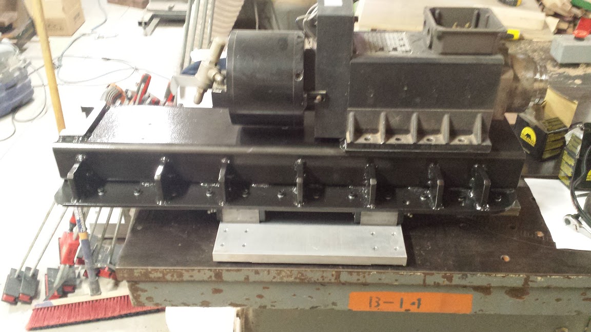

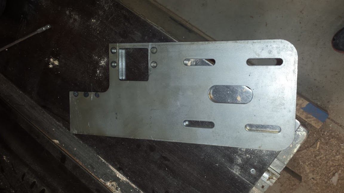

    X axis motor mount plates (laser cut) and servo motor mocked up.

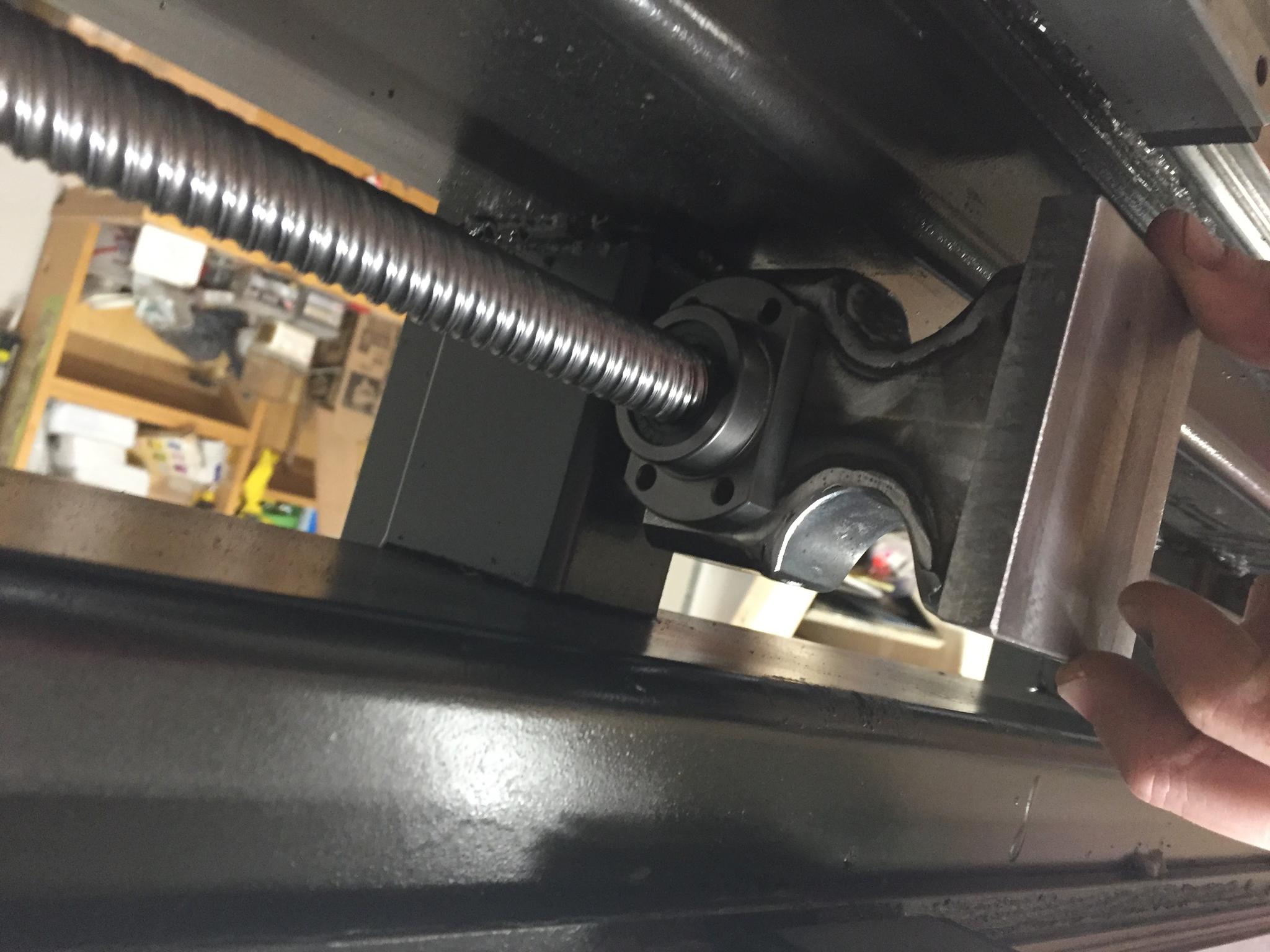

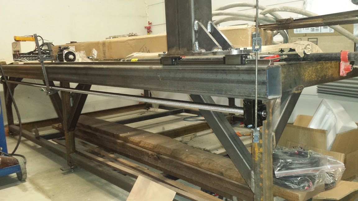

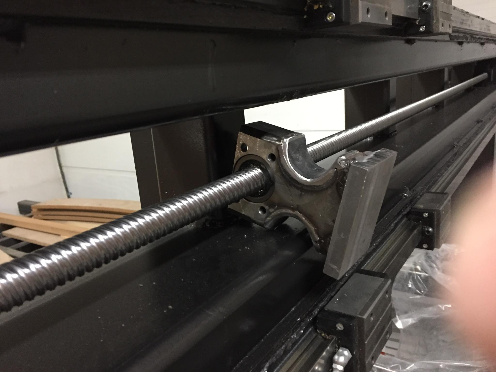

    Long ballscrew mocked up for bracket design

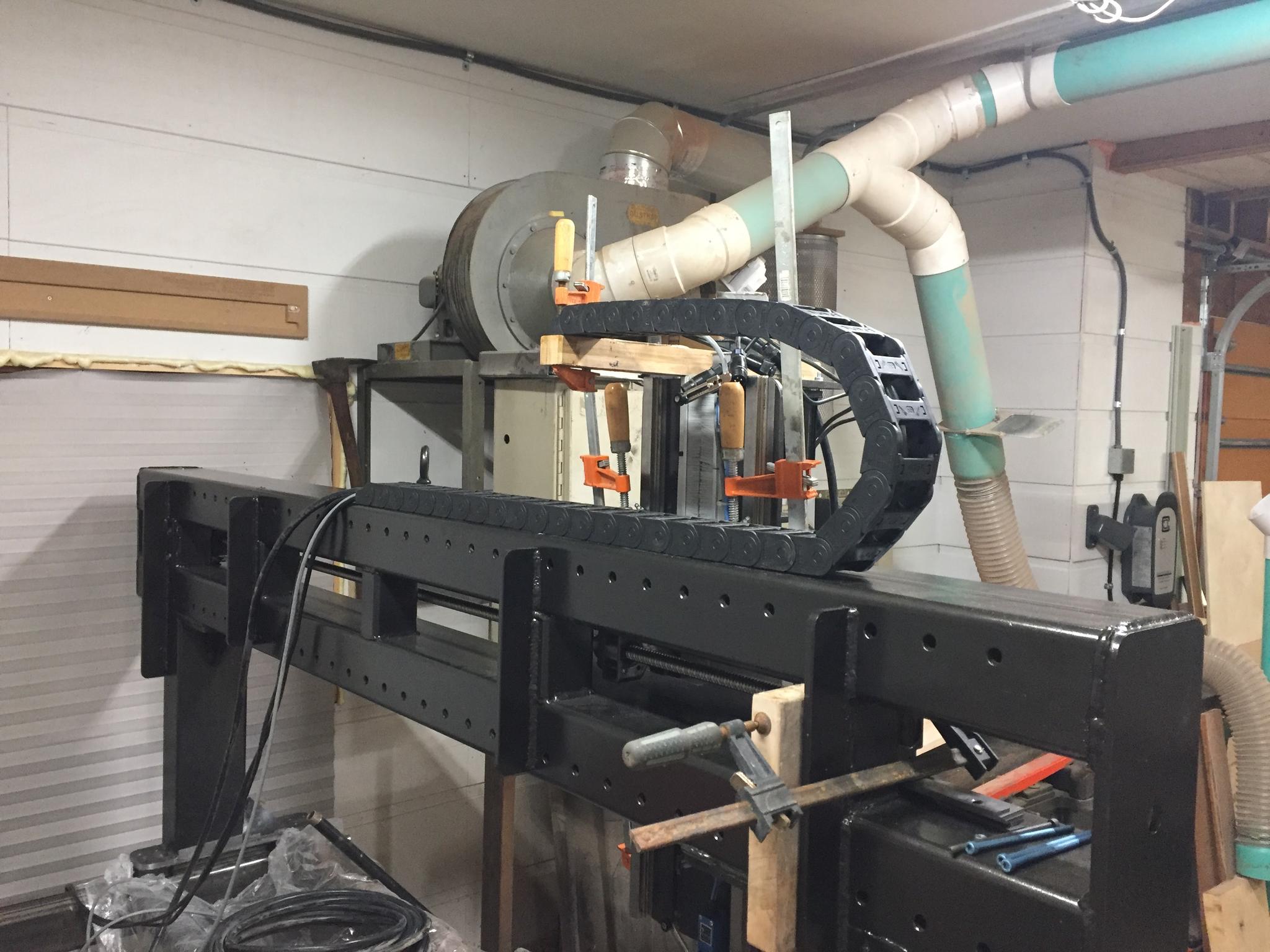

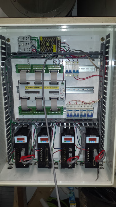

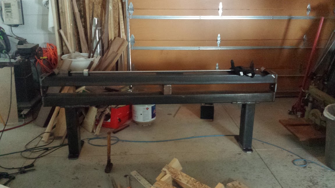

    Also made some good headway on the electrics. Still cant get CSMIO to connect so will have to contact them here soon but Im a bit of time away from needing it.

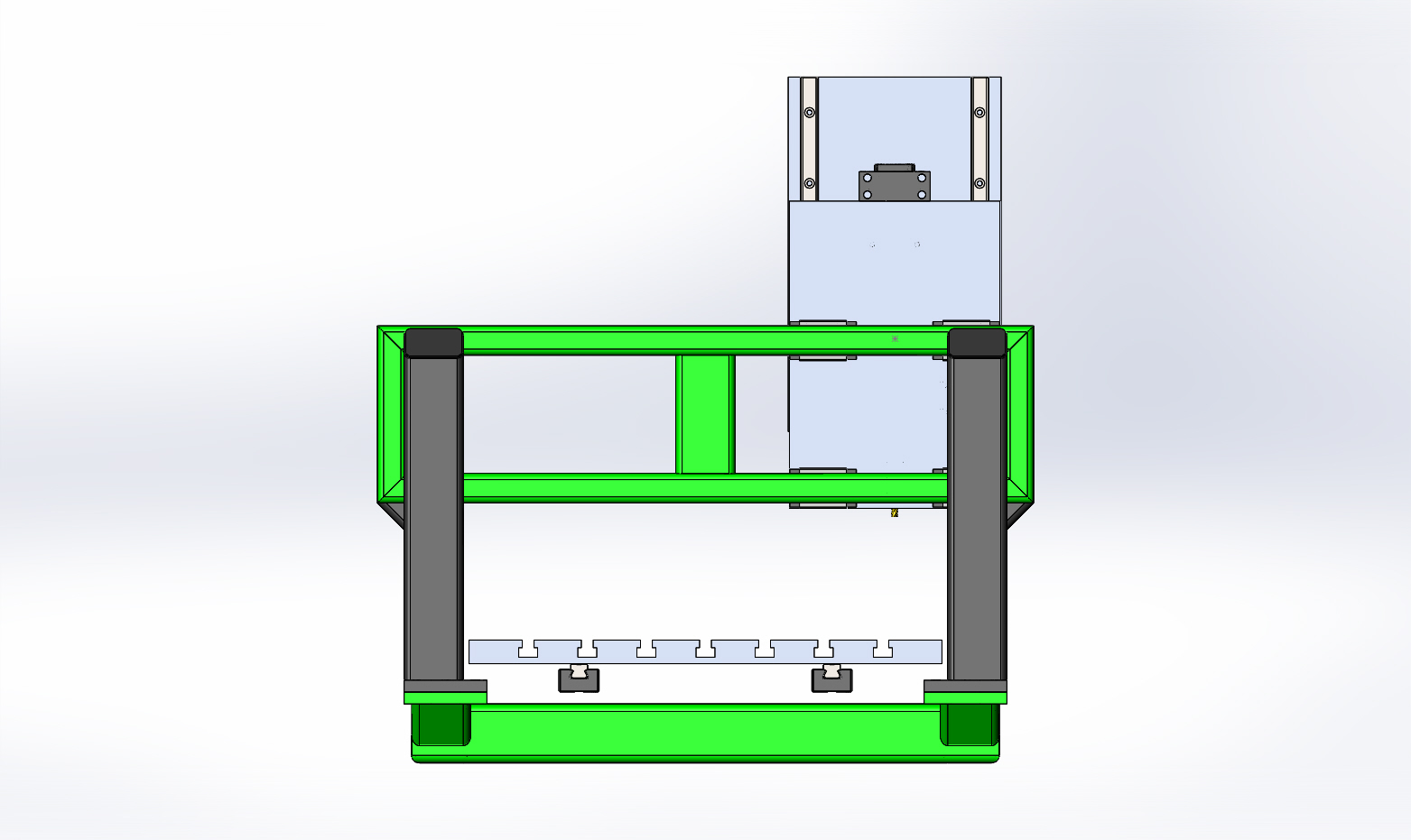

  2. #62

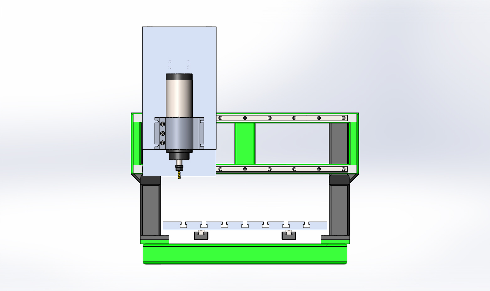

    I fully agree, legs has to be revised.
    I make another desktop router with fixed gantry this time and see how I made it:
Name:	Assem long table.JPG
ID:	18946Click image for larger version.
Name:	Assem long table2.JPG
ID:	18947Click image for larger version.
Name:	Assem long table3.JPG
ID:	18948Click image for larger version.
Name:	Assem long table4.JPG
    all made from rectangular profile 50x25x3
    I weld everything with Tig this time will start new topic about my build
    Good luck
    Tom

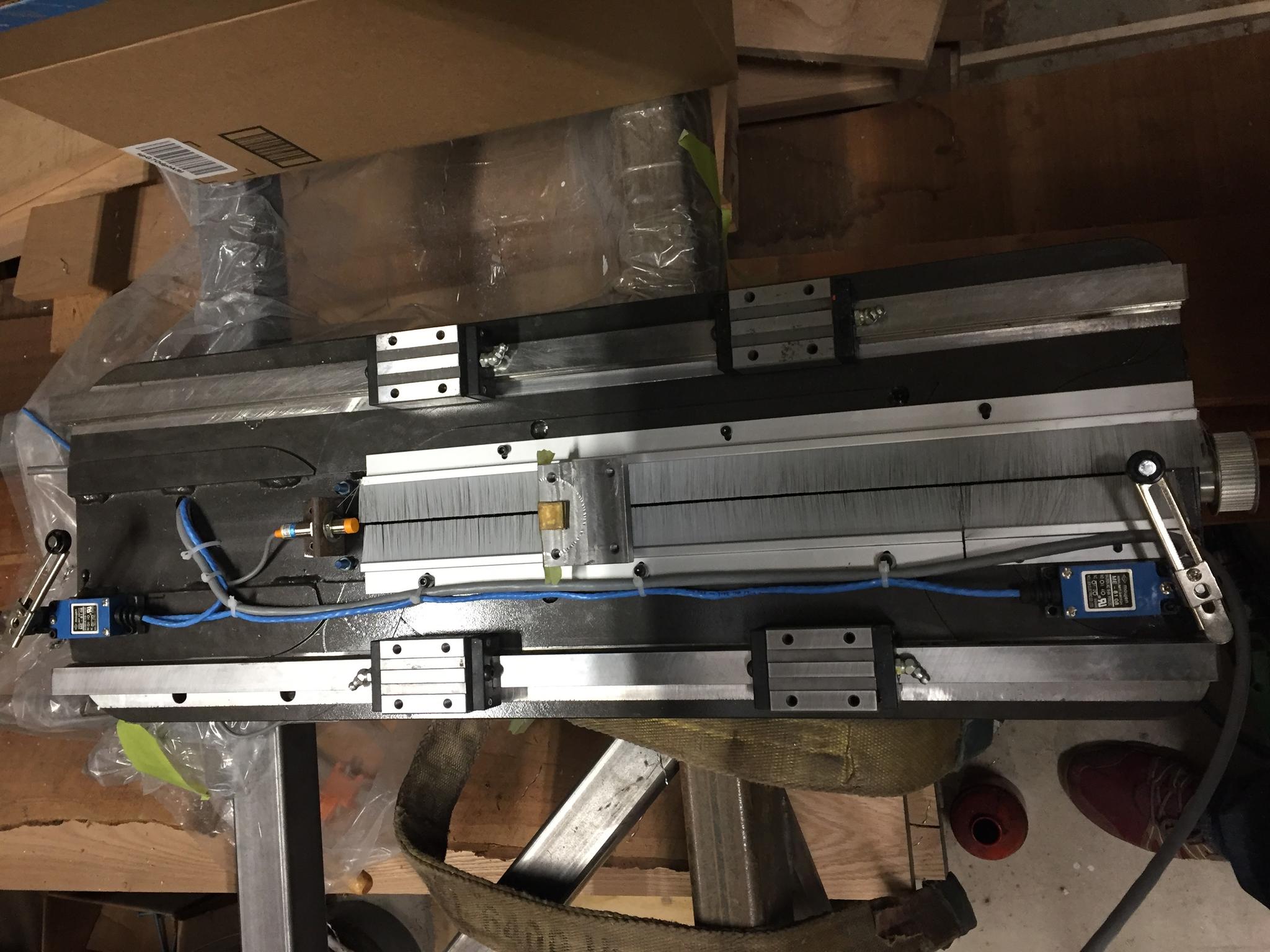

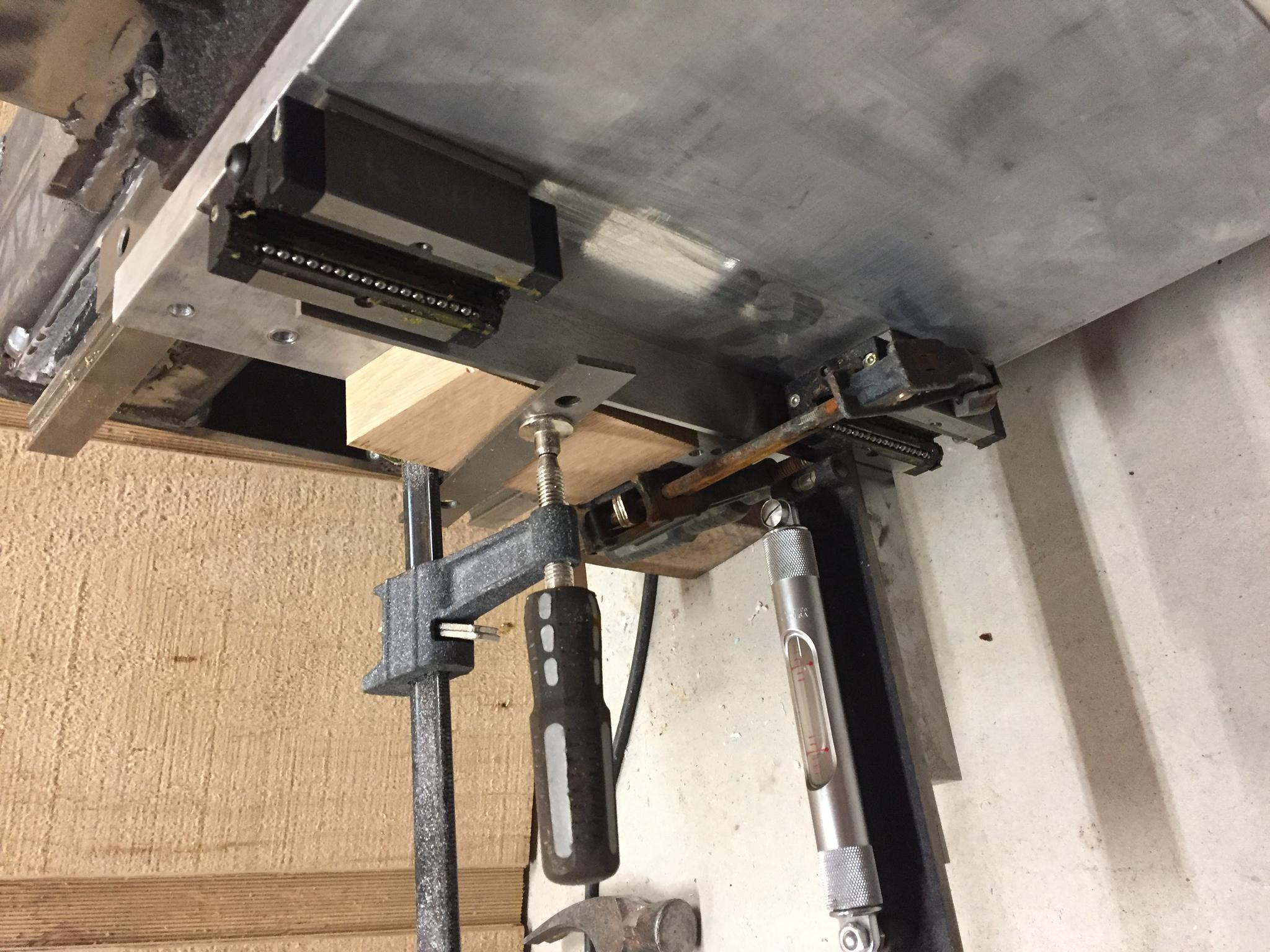

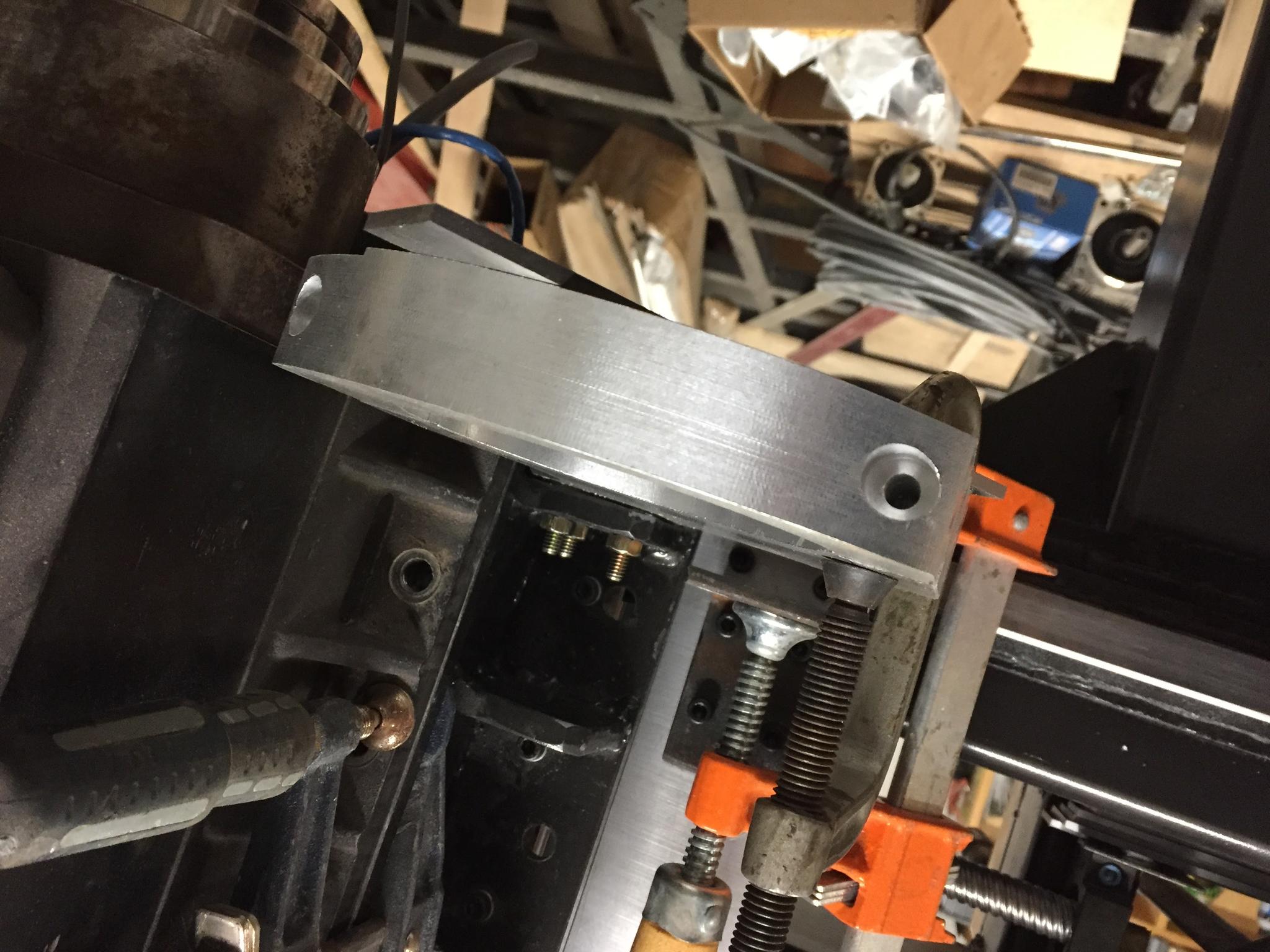

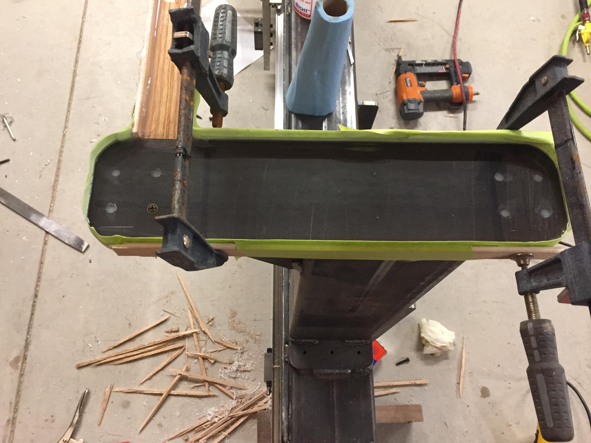

  3. #63
    I have been MIA for a long period, normal life and other projects got in the way over summer. Finally back to working on the CNC.

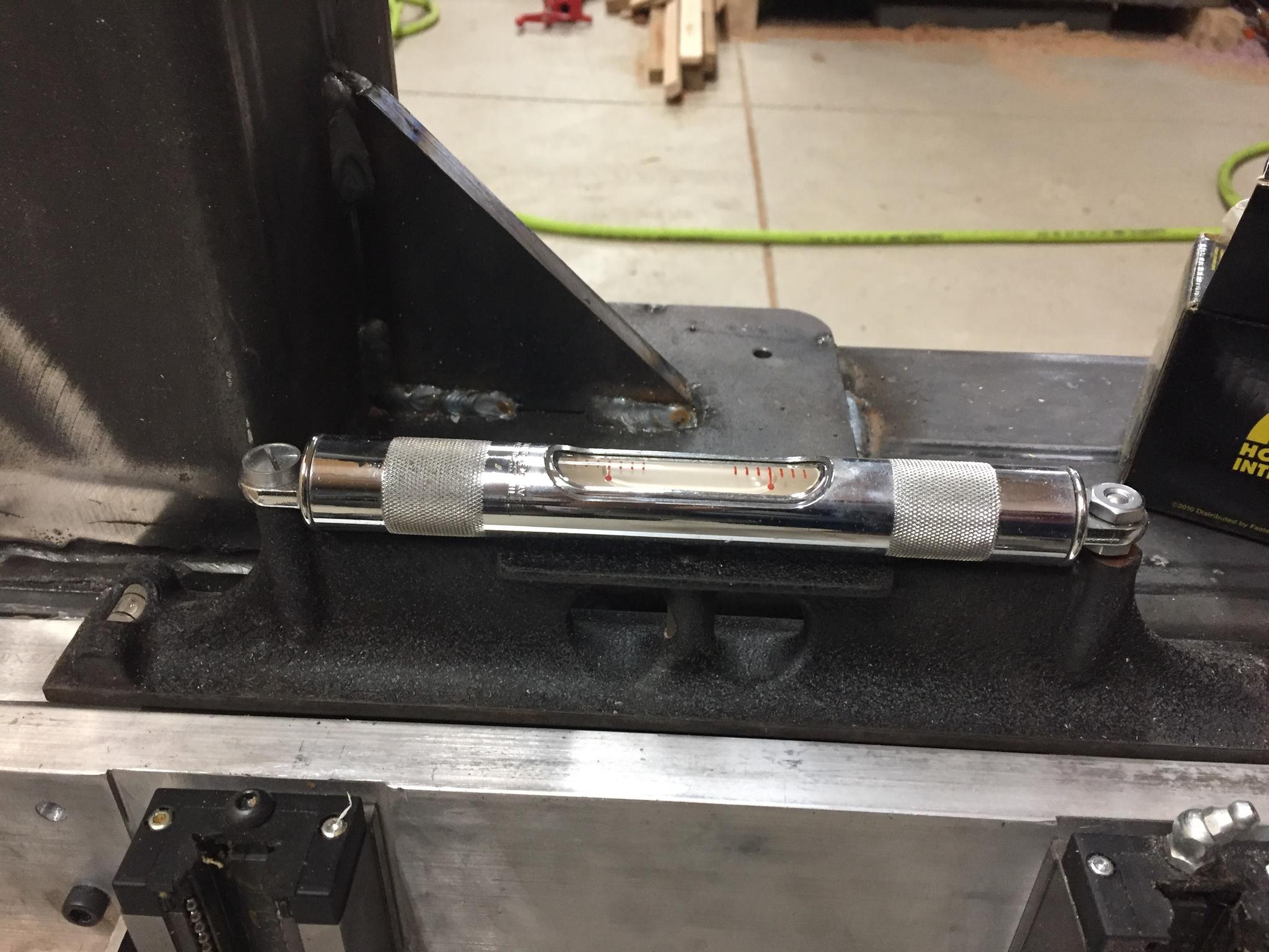

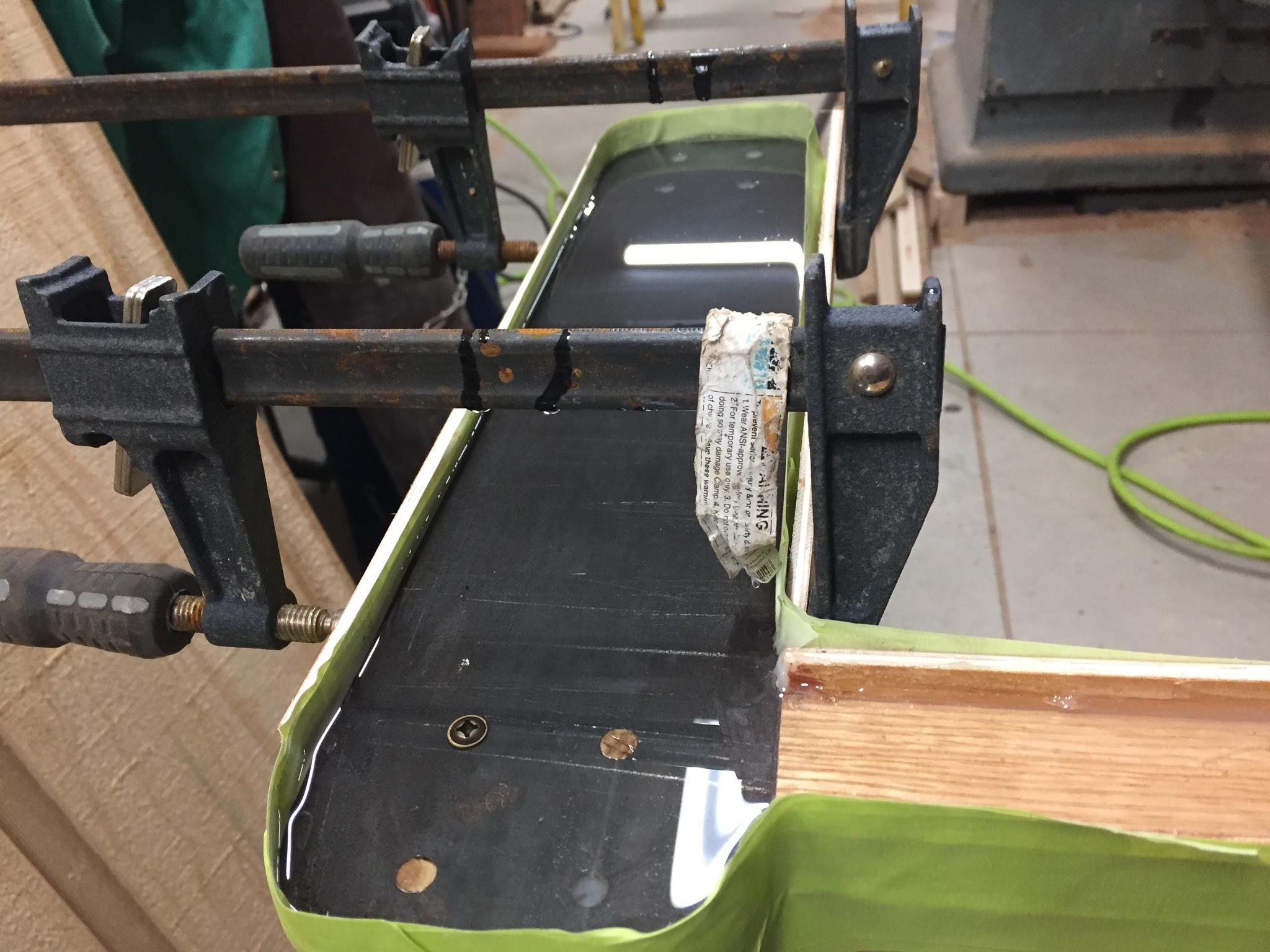

    Leveling the Y to Z plate for gantry foot epoxy pour
ID:	19860Click image for larger version.
ID:	19861Click image for larger version.

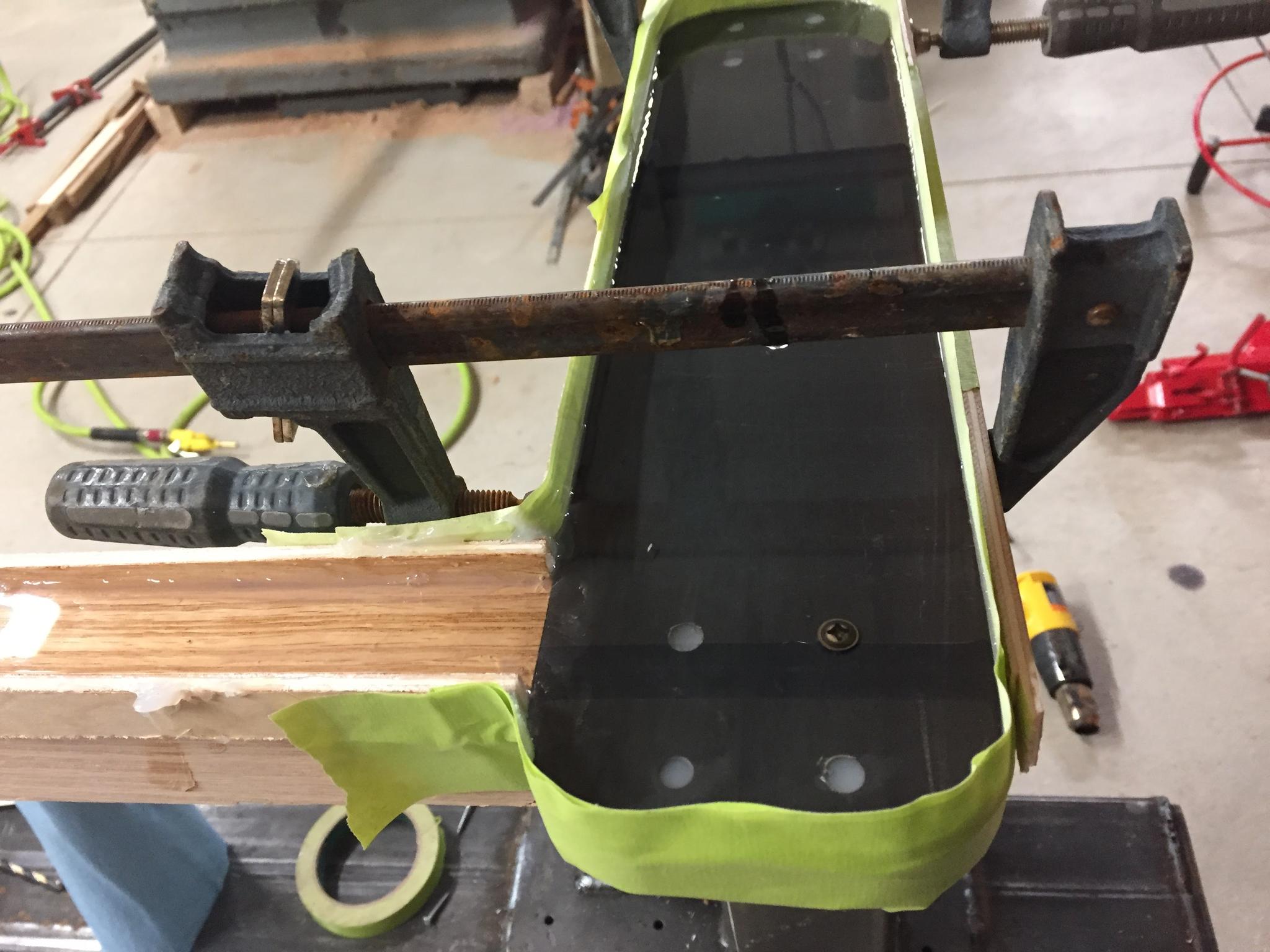

    Pouring the gantry feet
ID:	19863Click image for larger version.
ID:	19864Click image for larger version.
ID:	19865Click image for larger version.

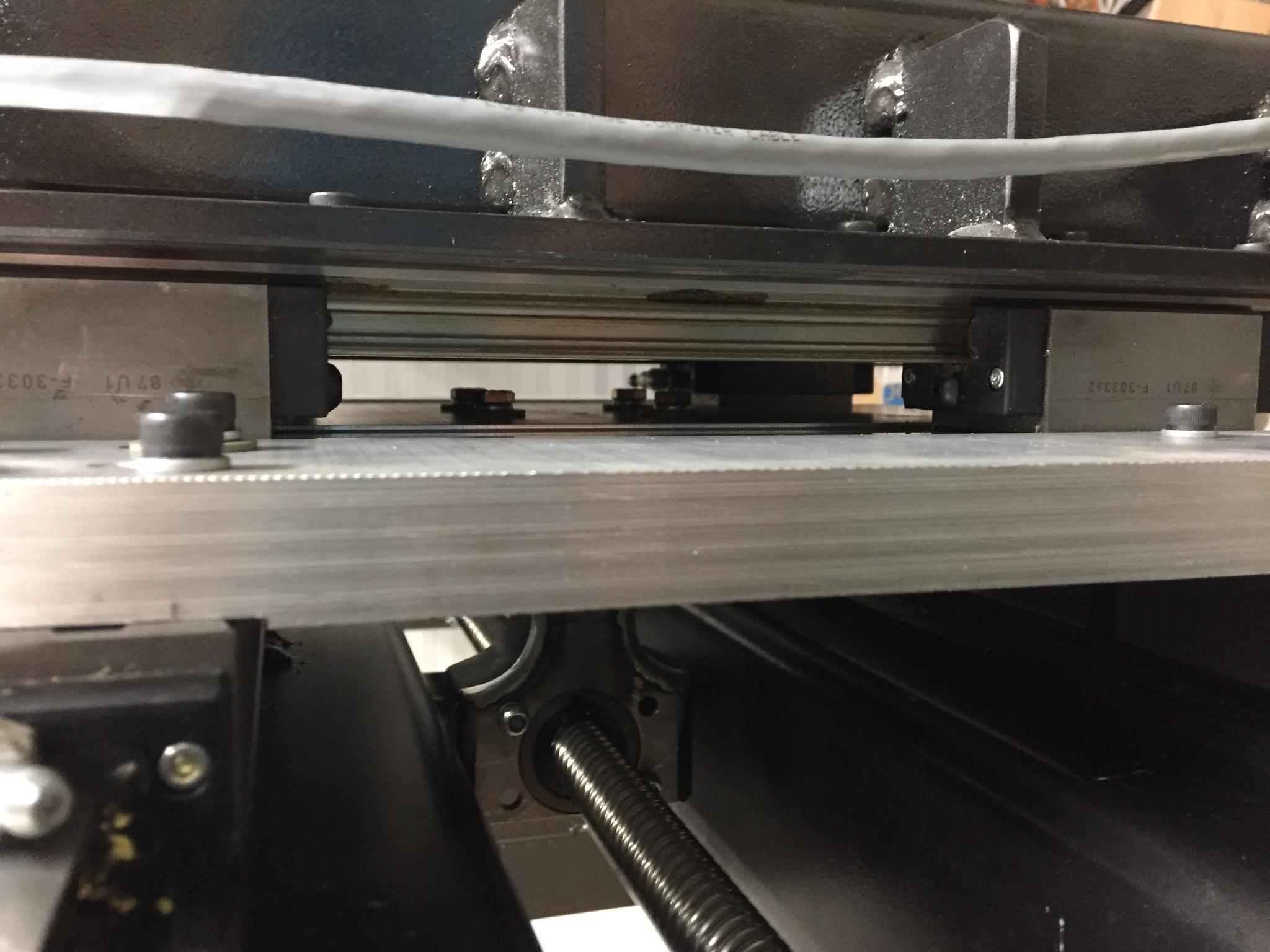

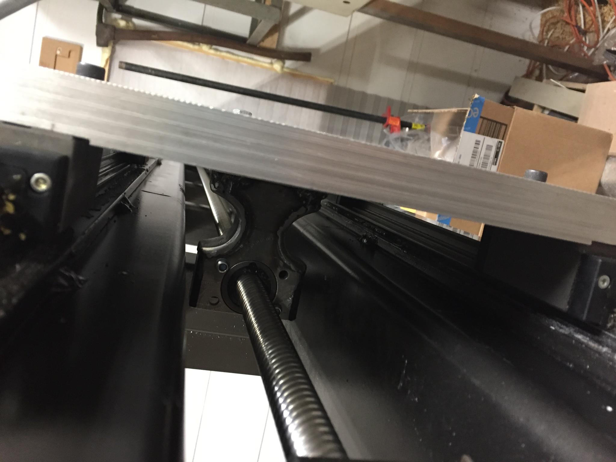

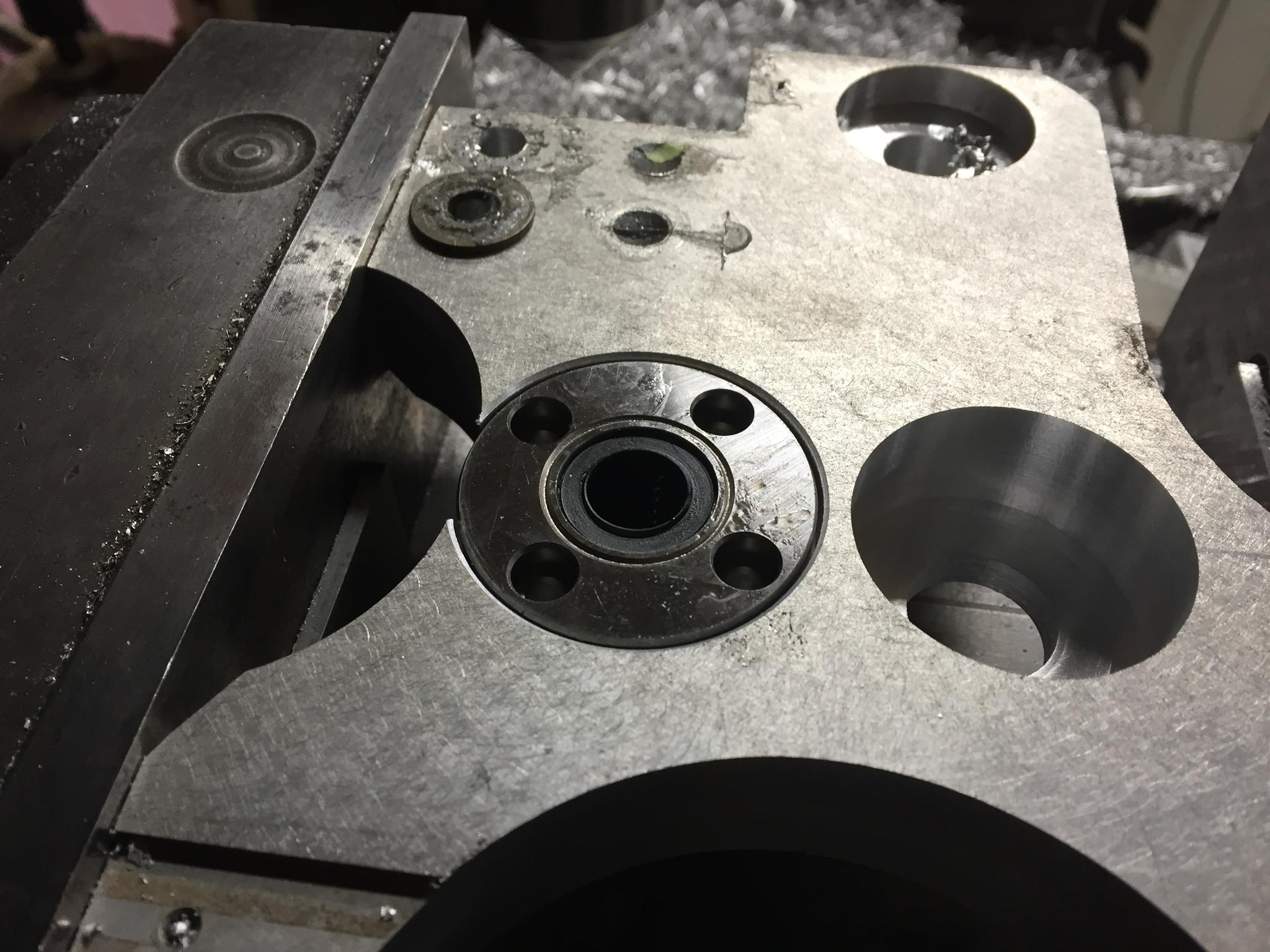

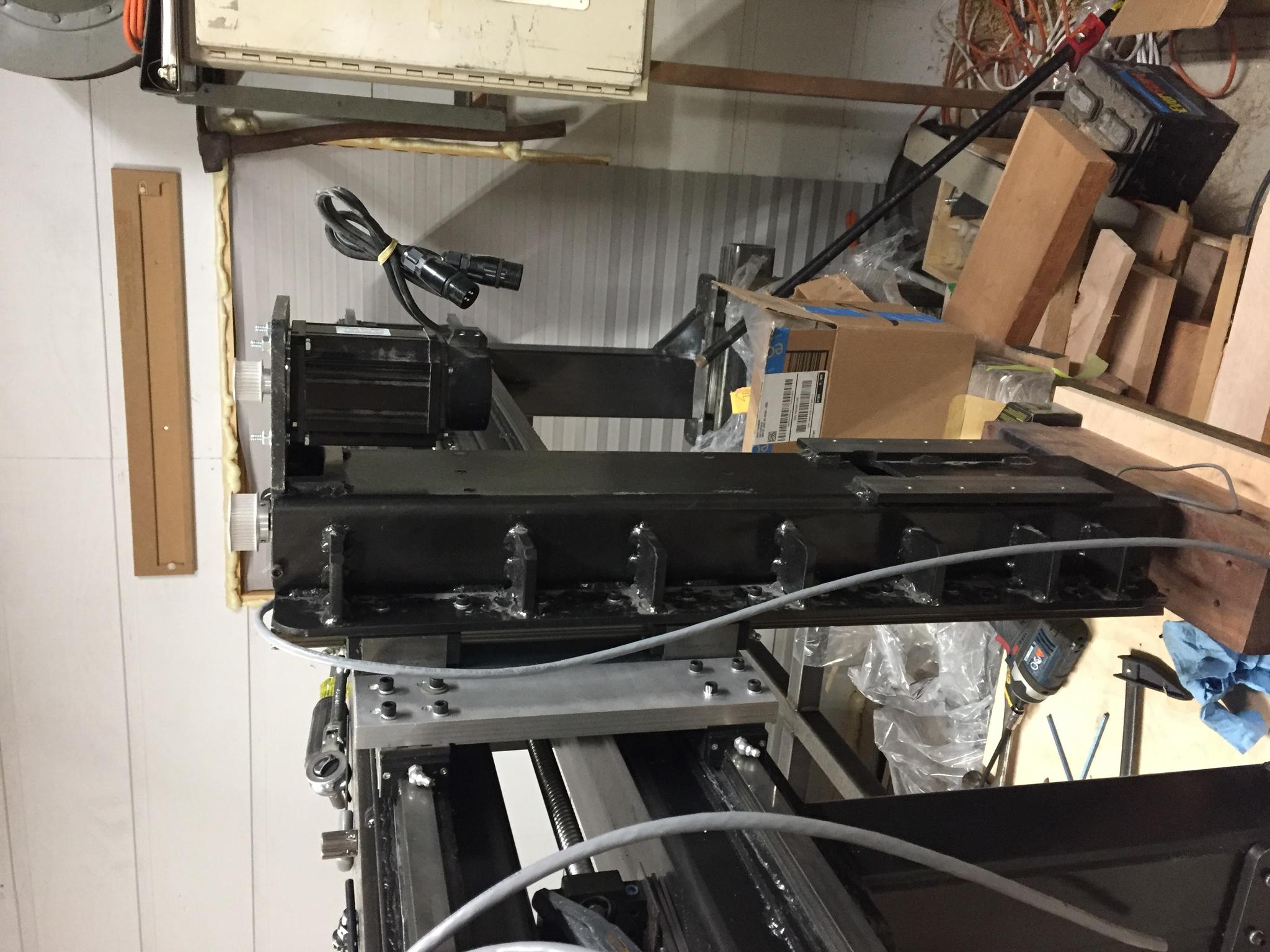

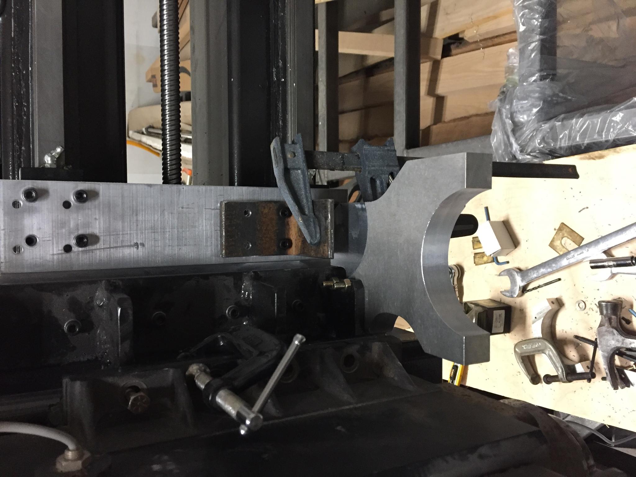

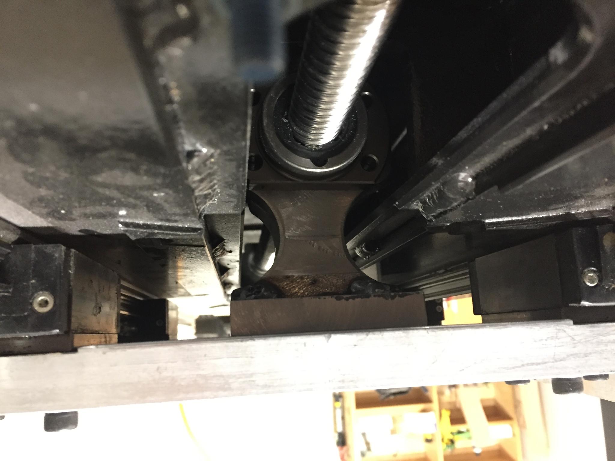

    Ballscrew to Z axis plate, made with steel I had on hand
ID:	19867Click image for larger version.
ID:	19868Click image for larger version.

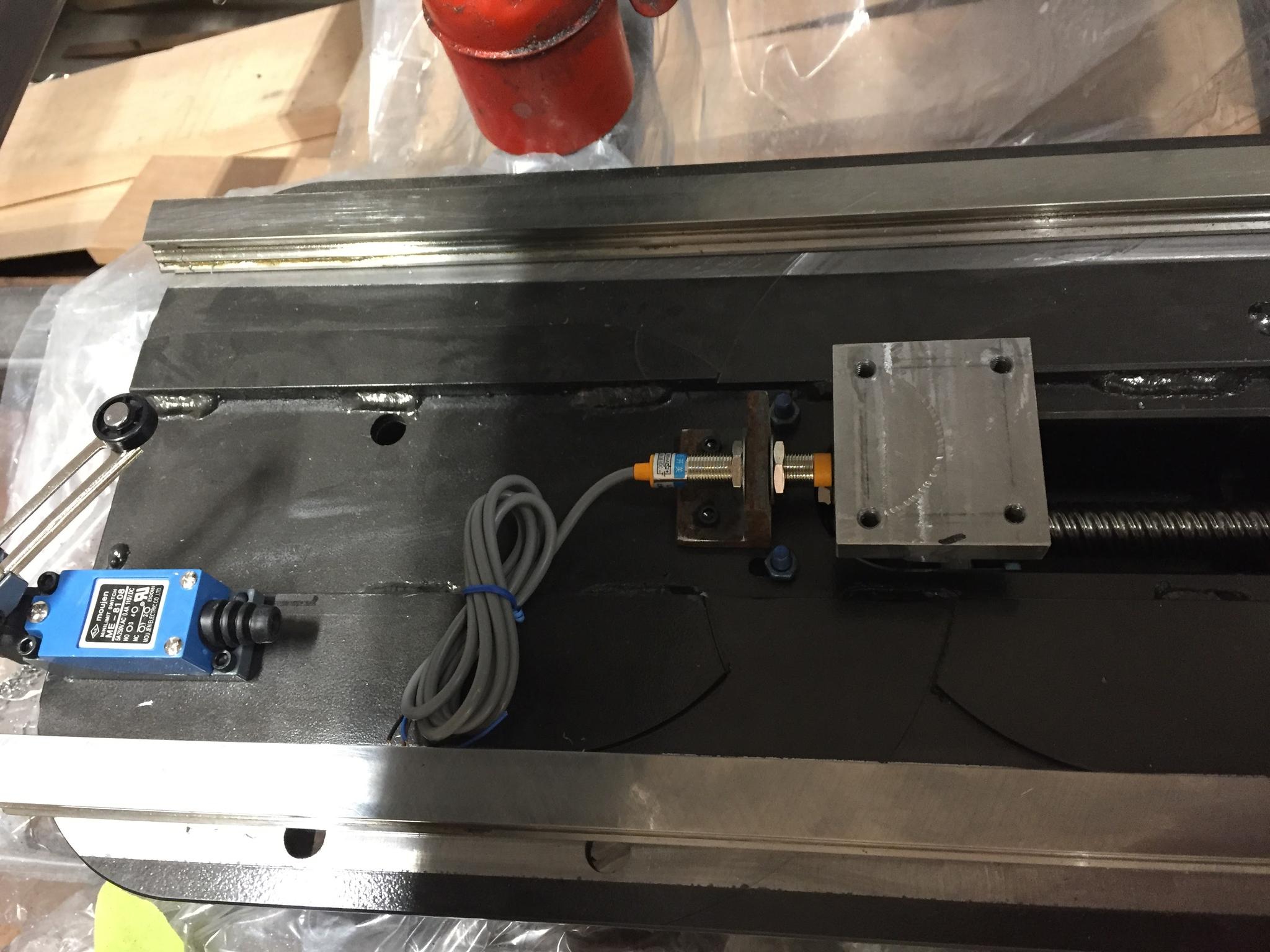

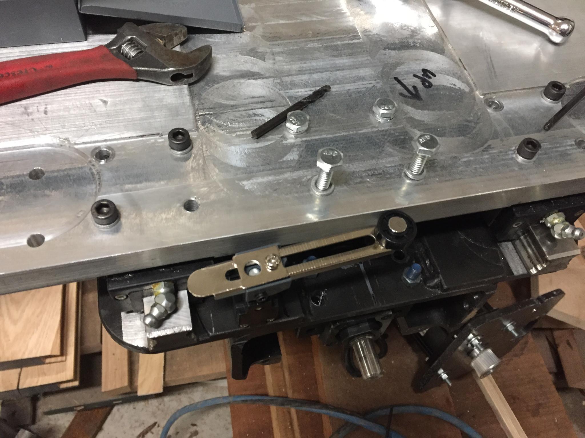

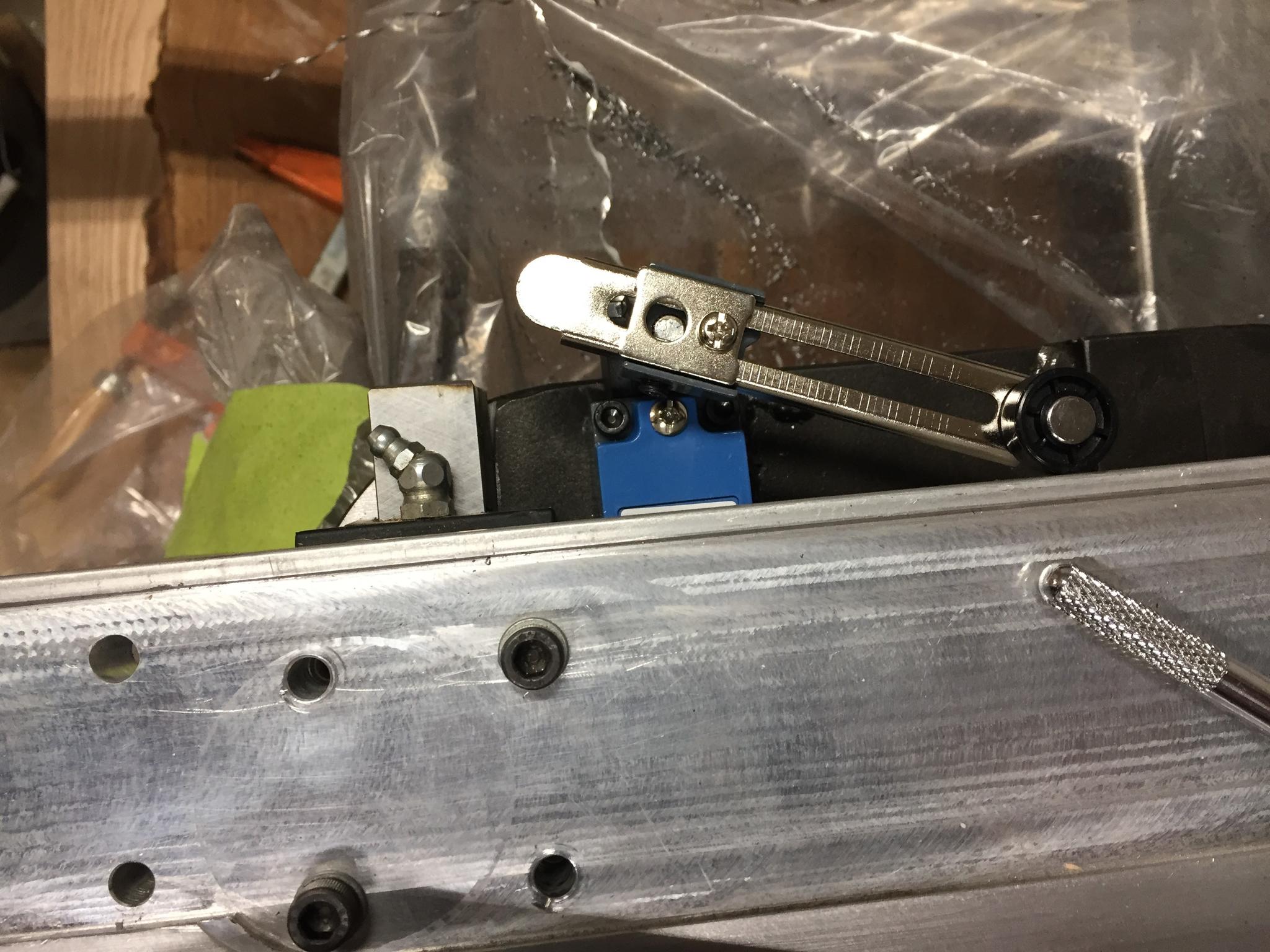

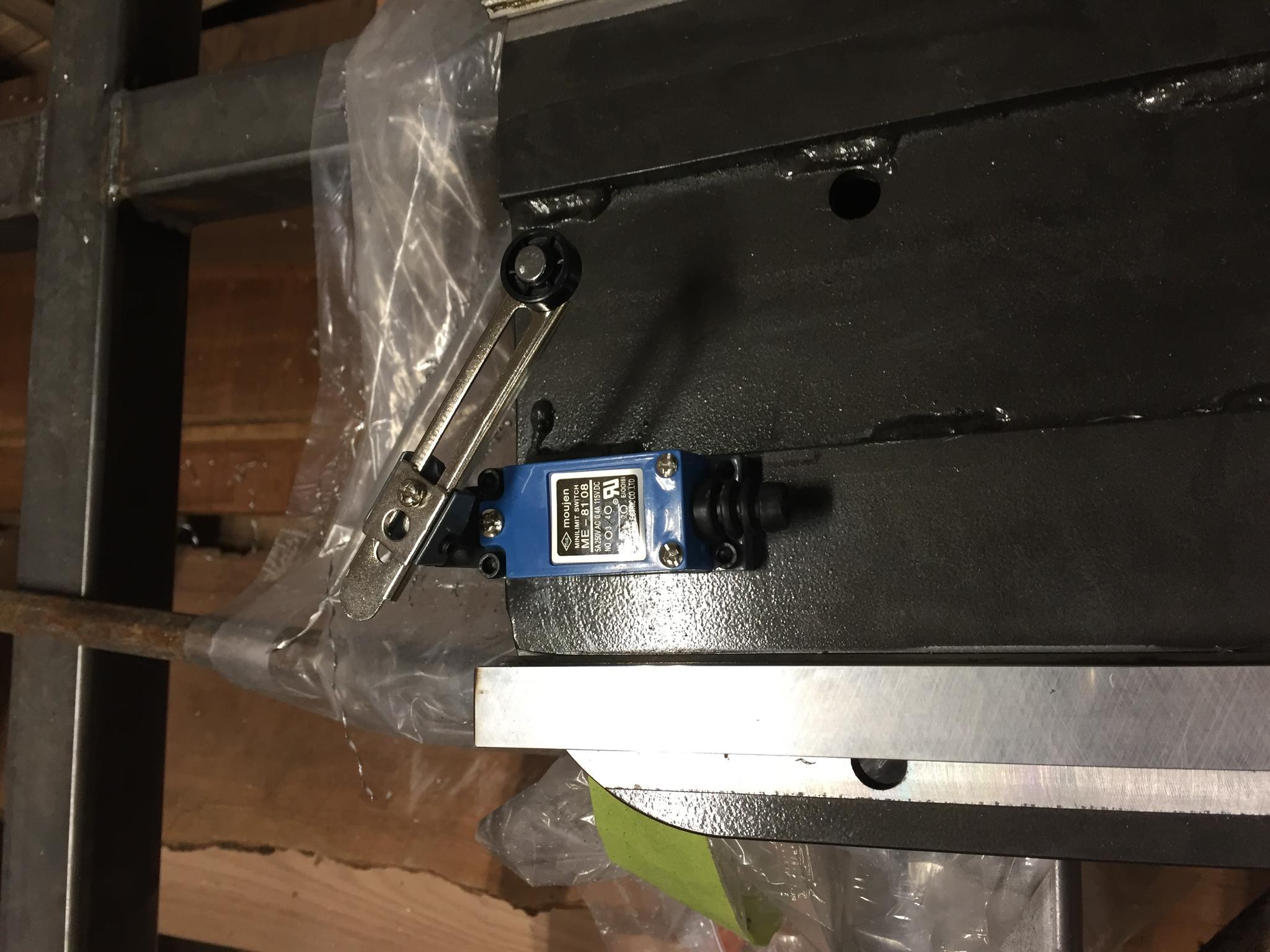

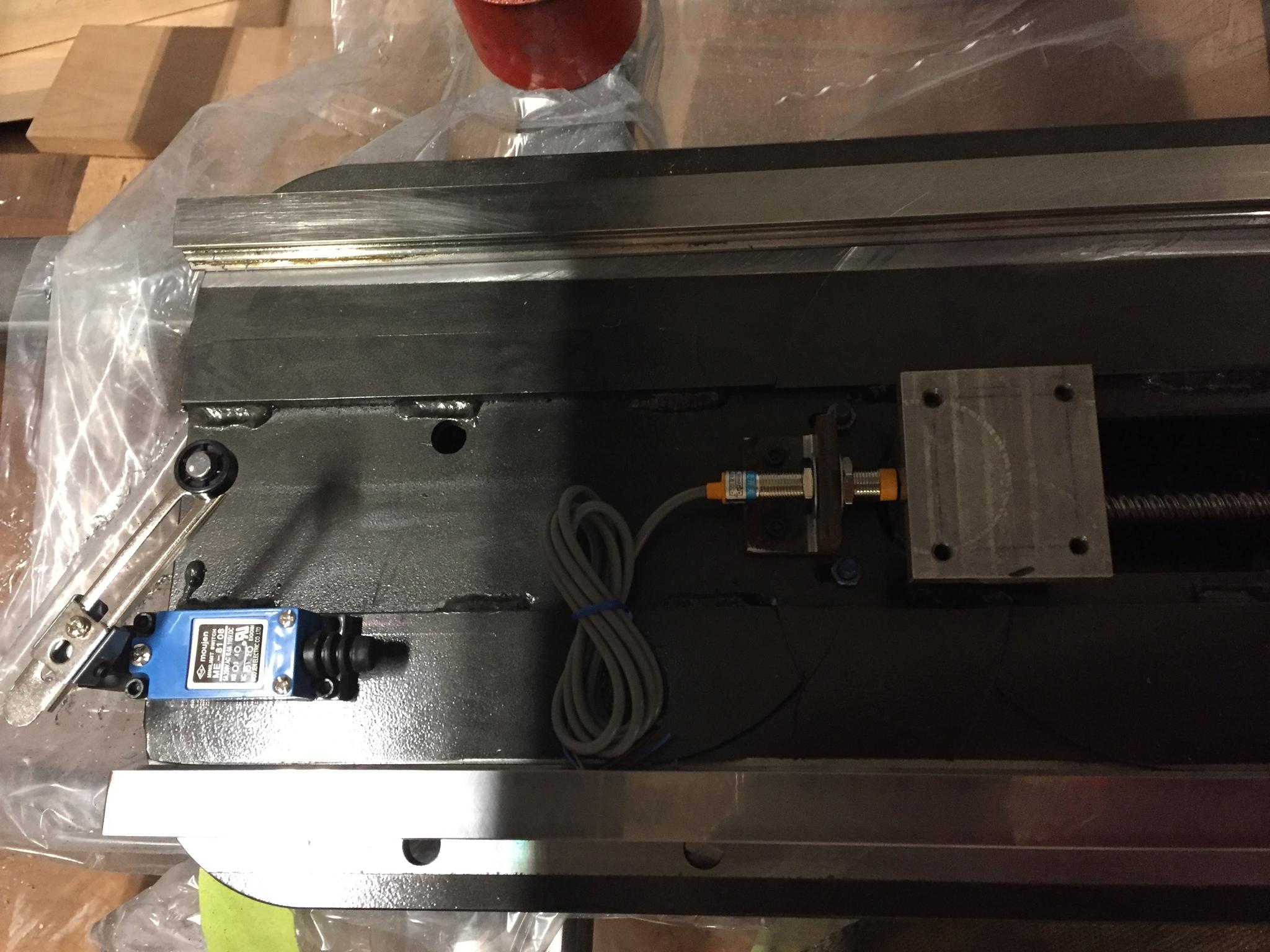

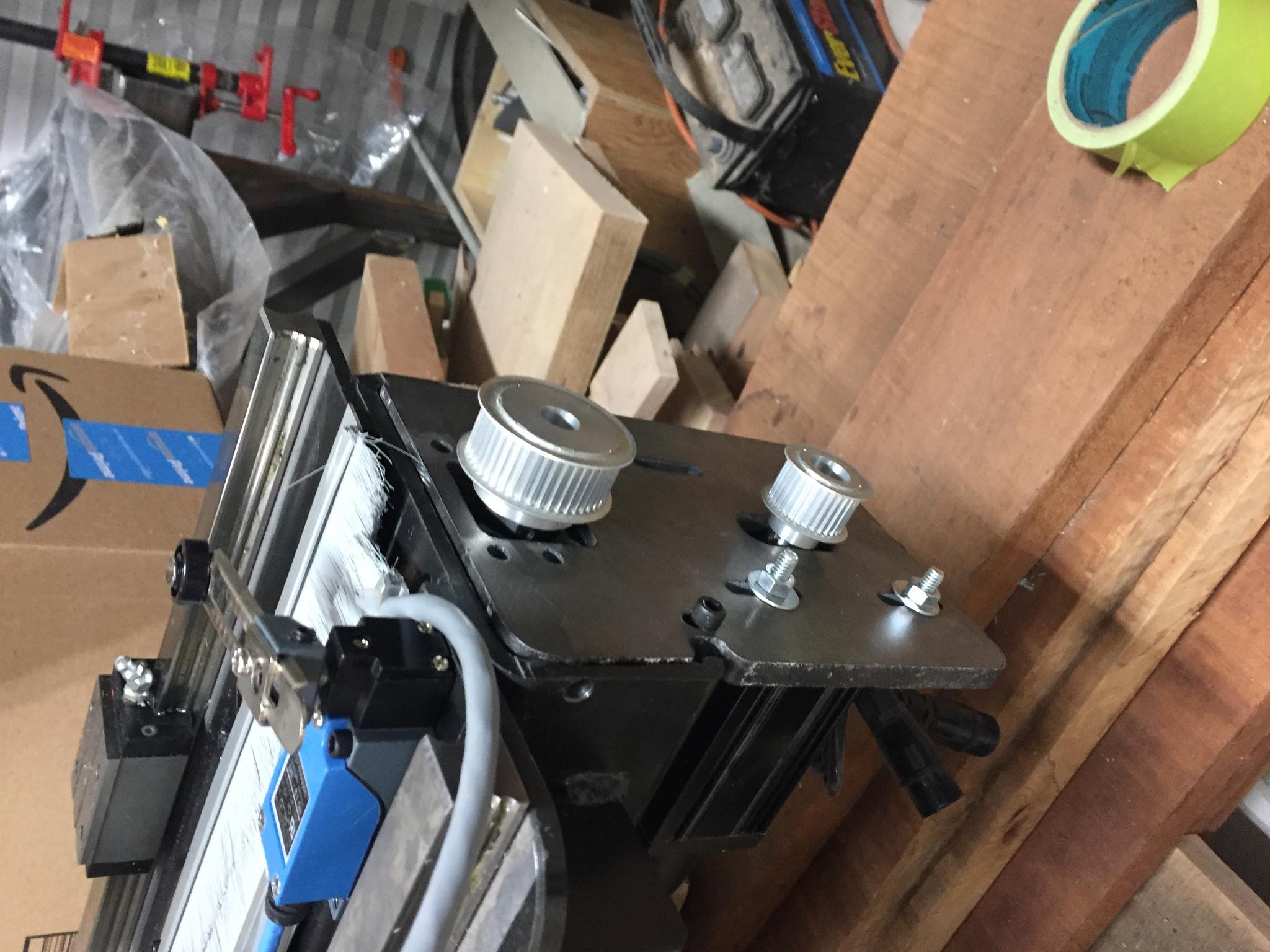

    Installing limit switches for Z
ID:	19870Click image for larger version.
ID:	19871Click image for larger version.
ID:	19872Click image for larger version.

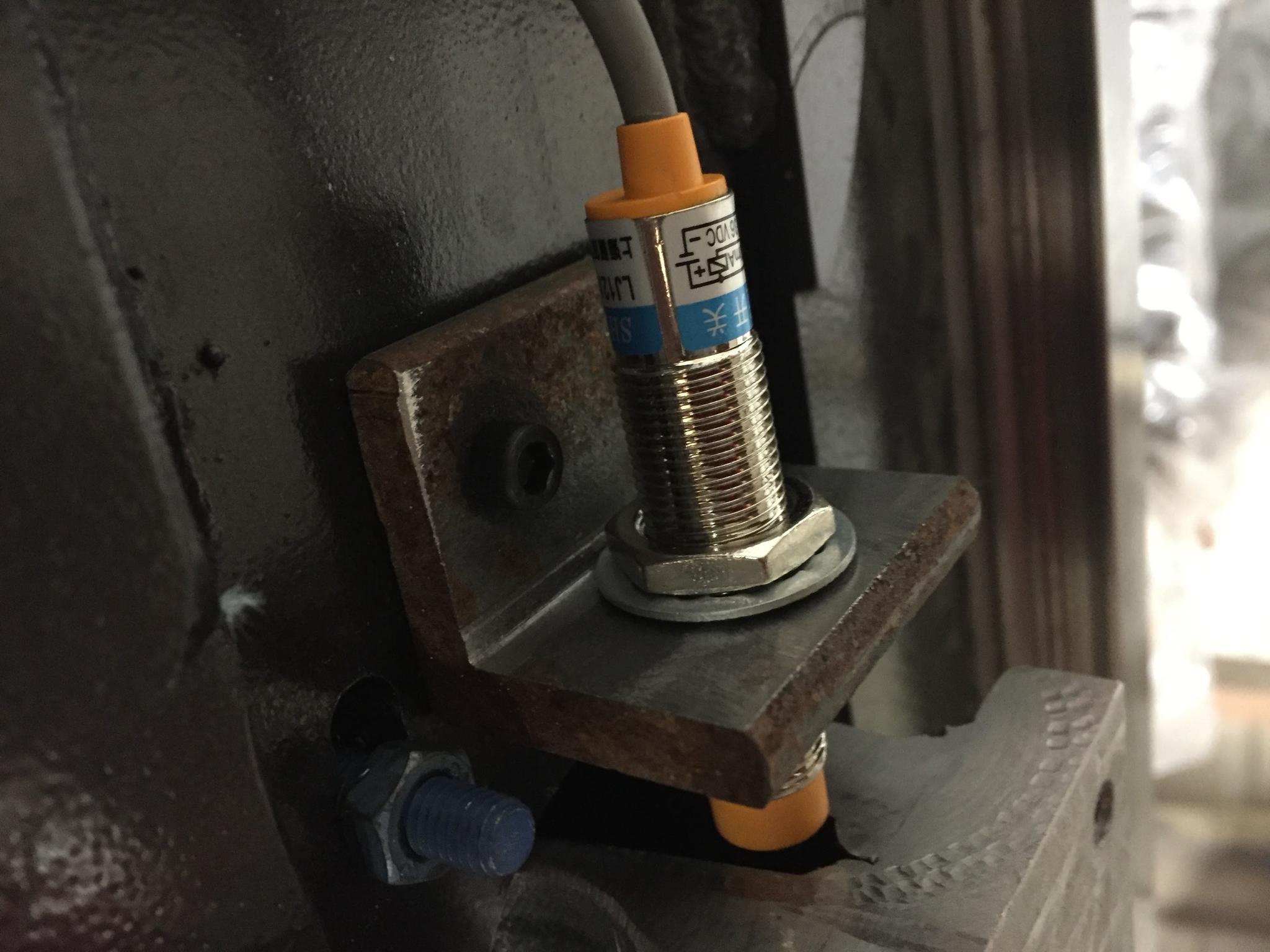

    Z home Prox Switch
ID:	19874Click image for larger version.
ID:	19875Click image for larger version.
ID:	19876Click image for larger version.
ID:	19877Click image for larger version.
ID:	19878Click image for larger version.

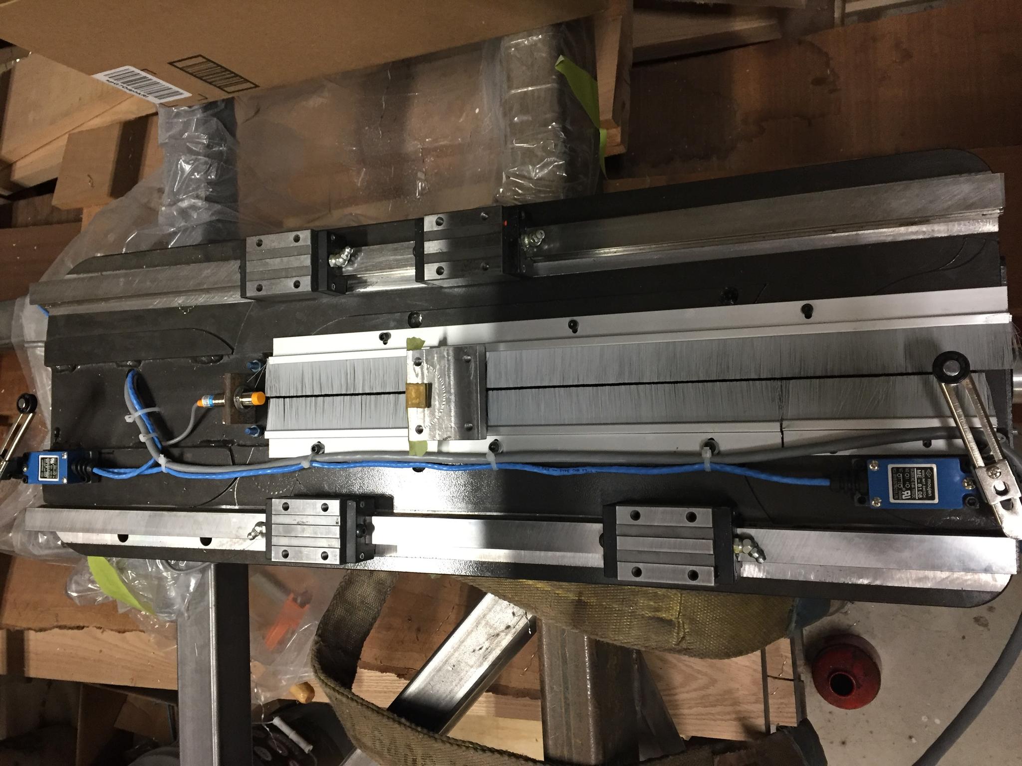

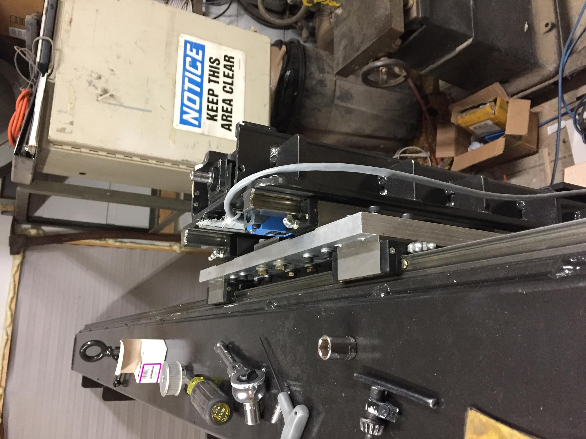

    Finished underside of Z axis with dust shielding in place
ID:	19880Click image for larger version.
ID:	19881Click image for larger version.
ID:	19882Click image for larger version.
ID:	19883Click image for larger version.
ID:	19884Click image for larger version.

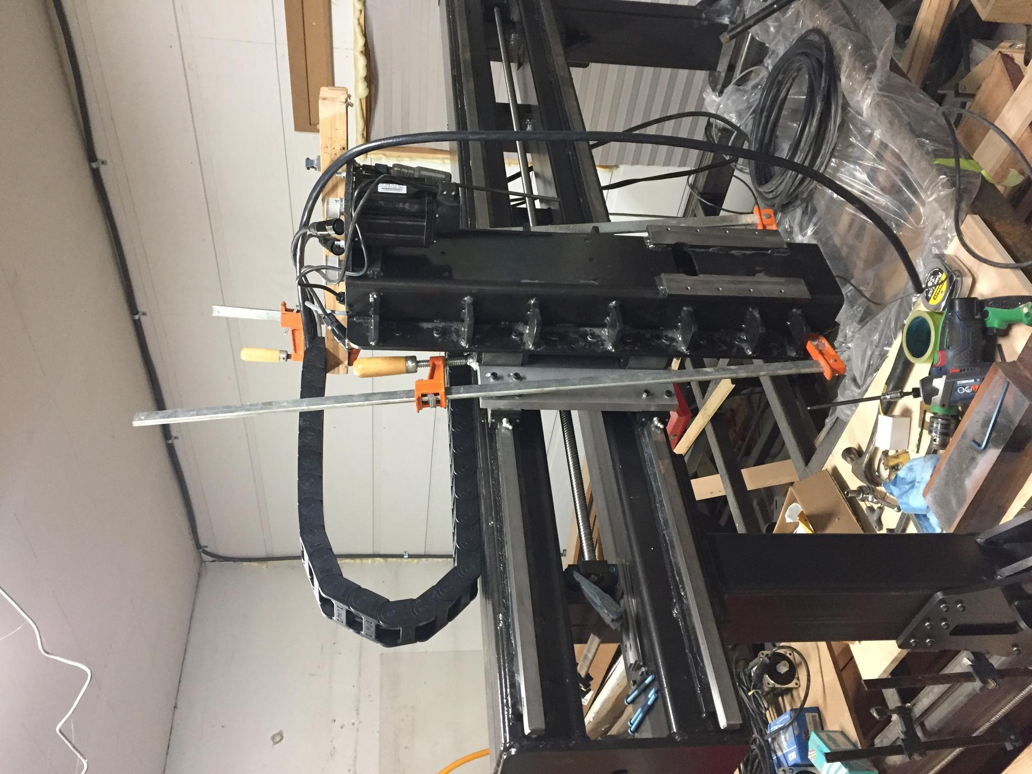

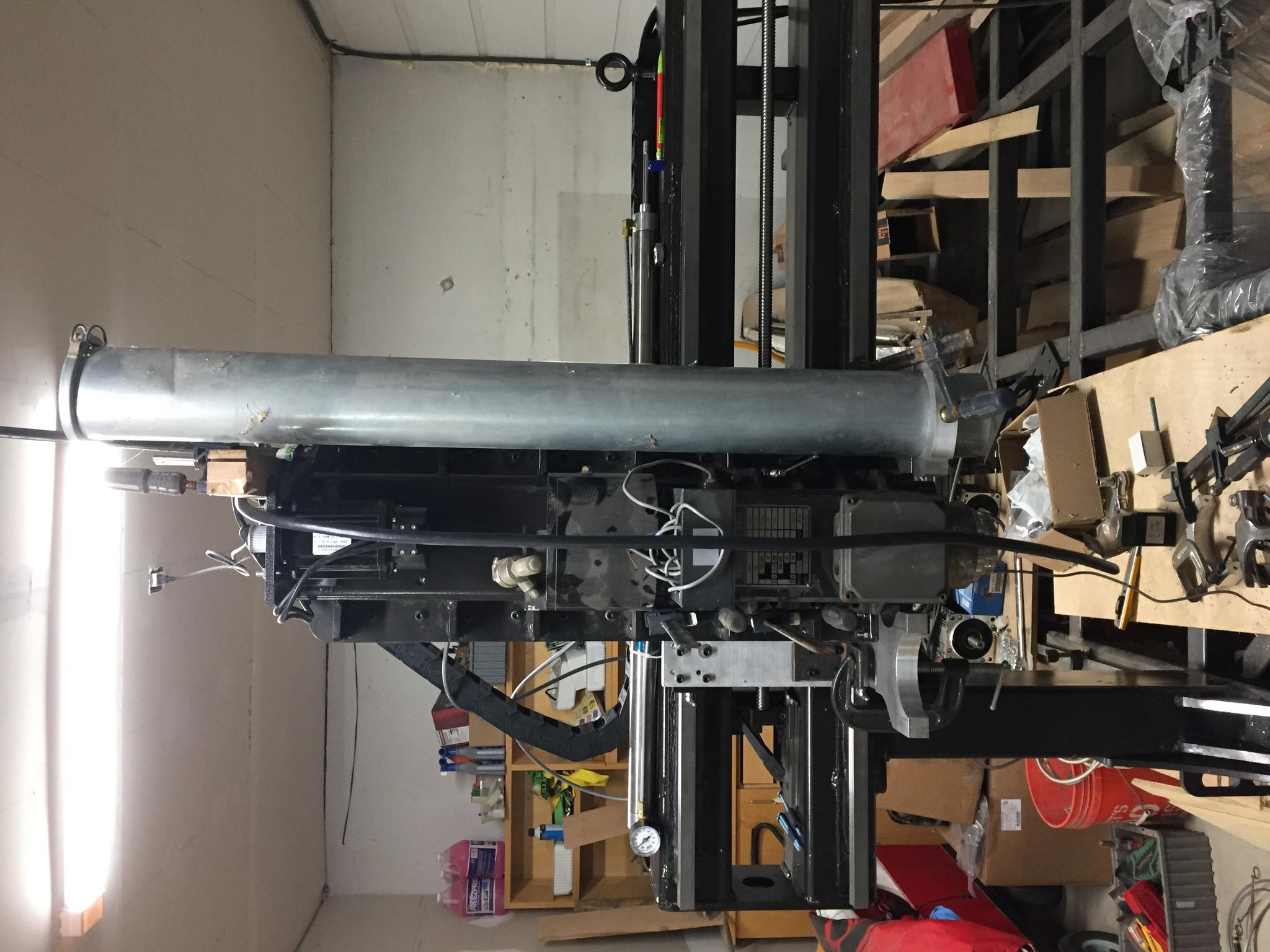

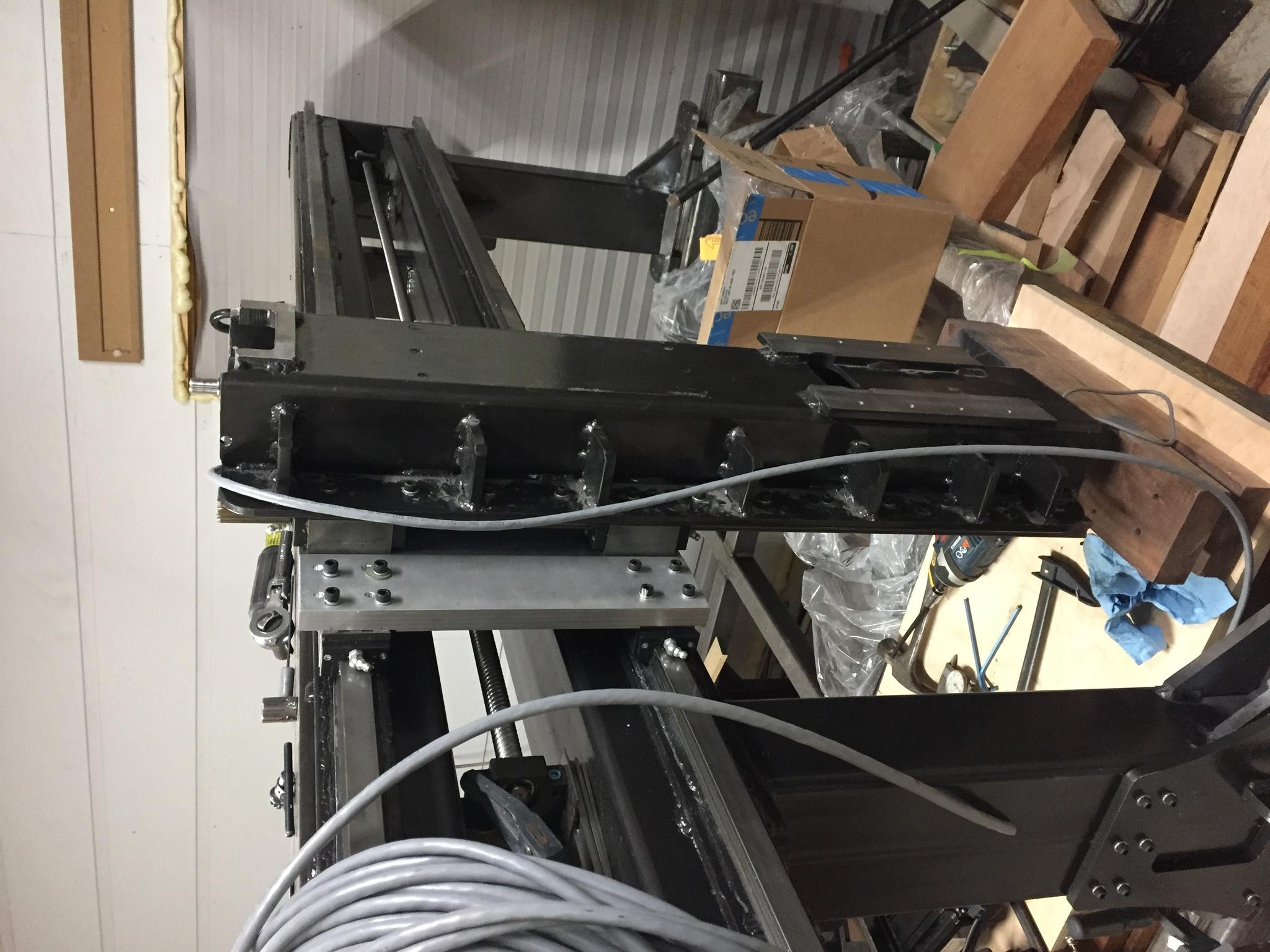

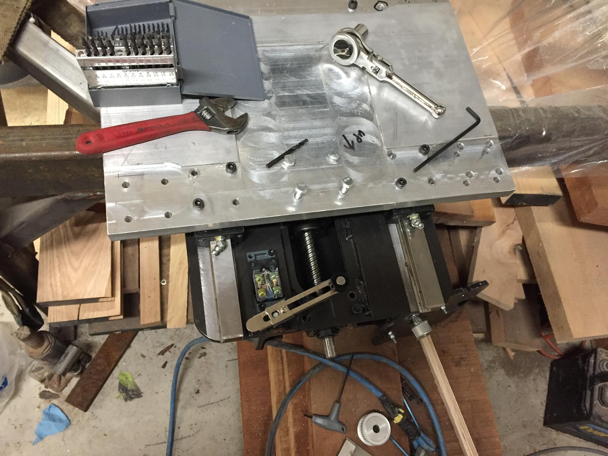

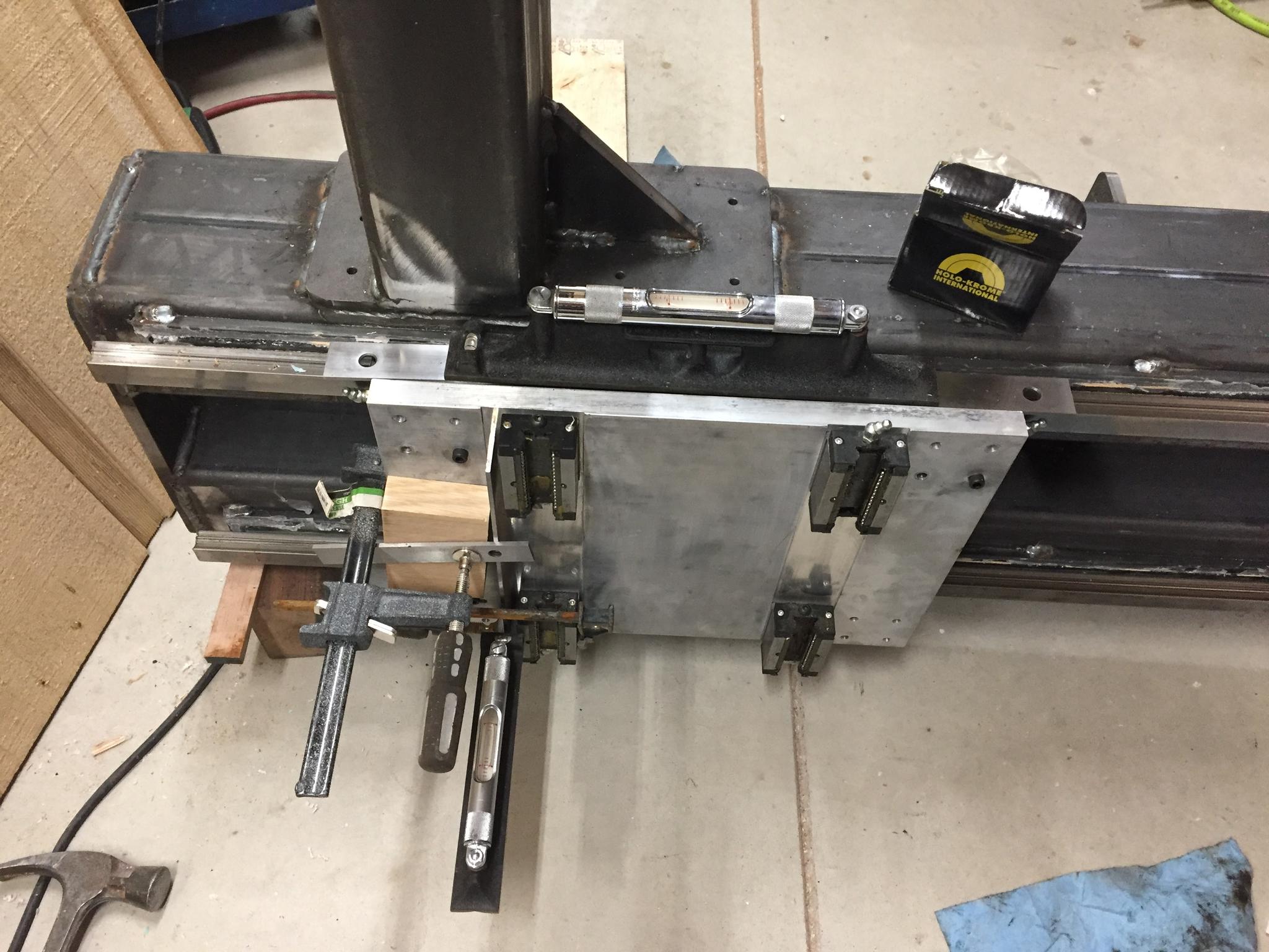

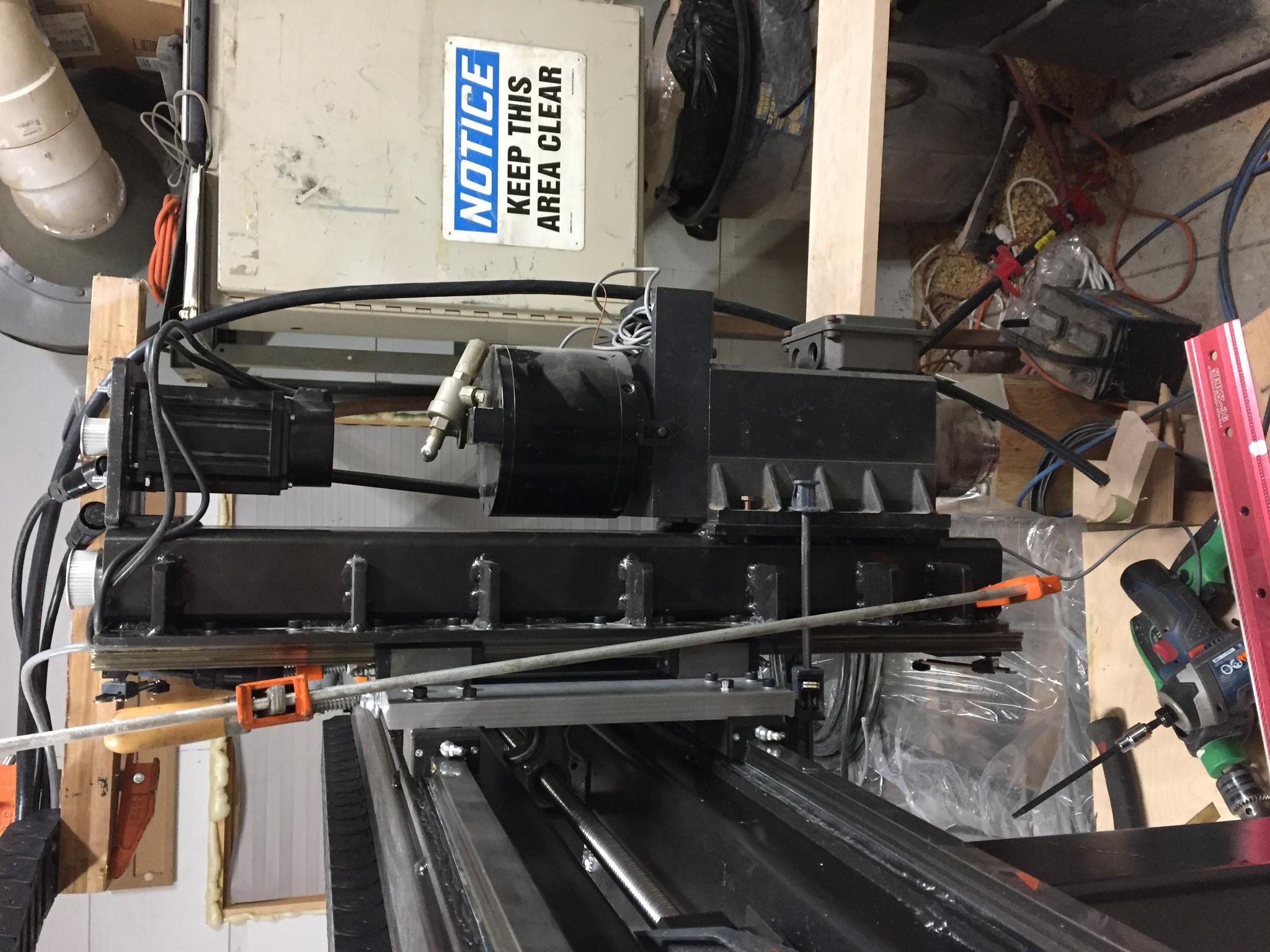

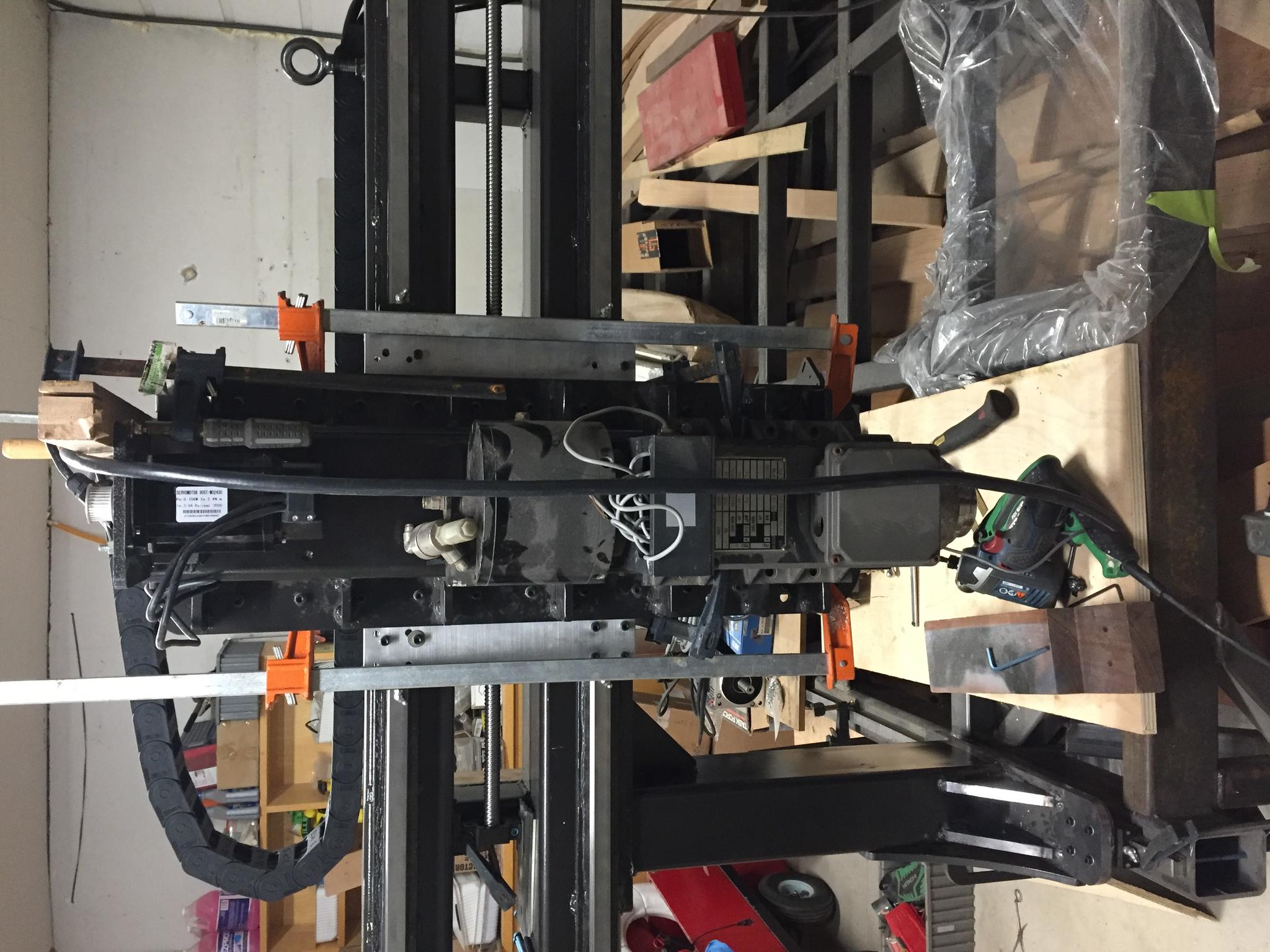

    Z axis installed onto Y axis/gantry
ID:	19886Click image for larger version.
ID:	19887Click image for larger version.
ID:	19888Click image for larger version.
ID:	19889Click image for larger version.
ID:	19890Click image for larger version.

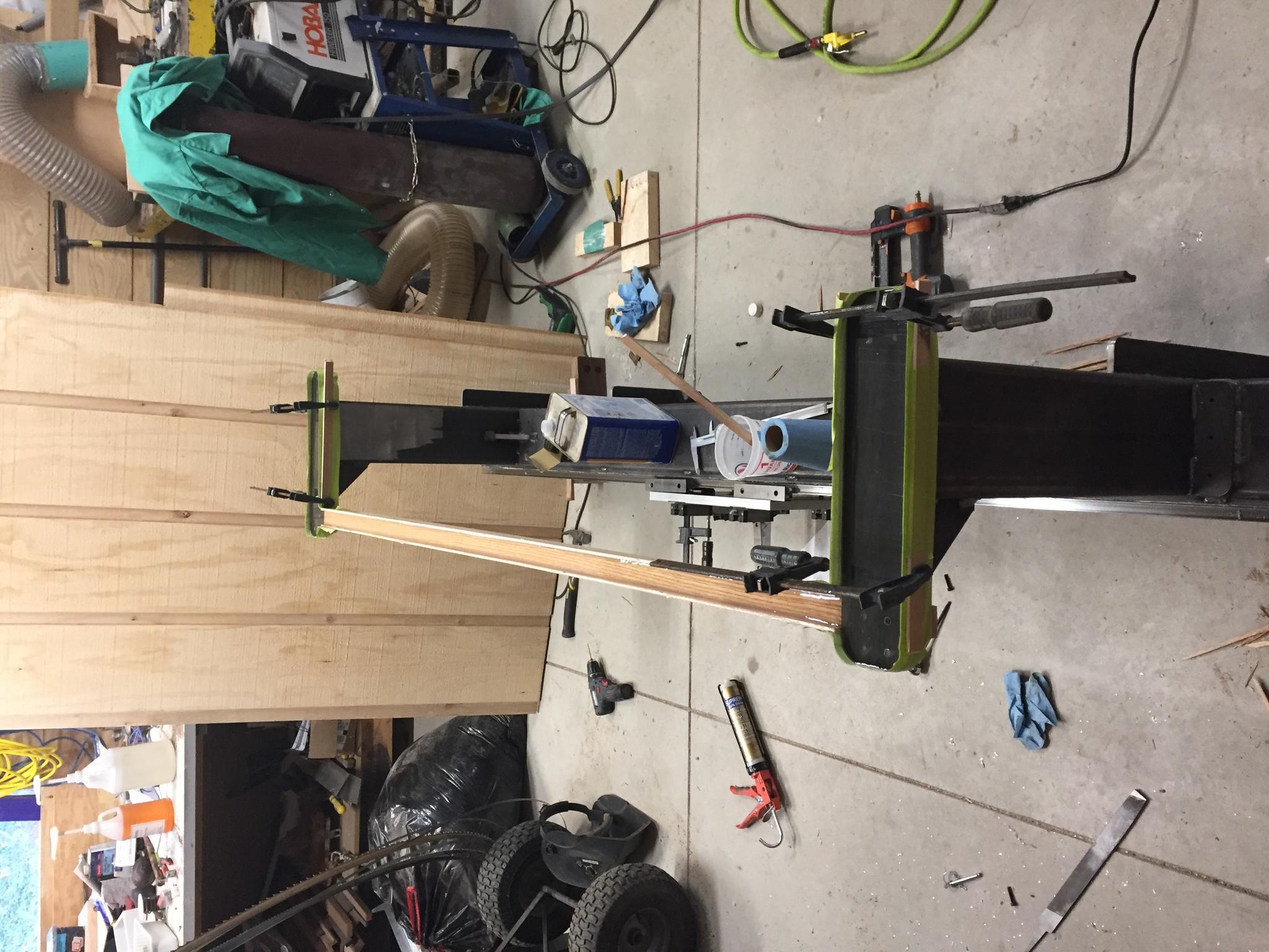

    Lots more Z axis mockup
ID:	19892Click image for larger version.
ID:	19893Click image for larger version.
ID:	19894Click image for larger version.
ID:	19895Click image for larger version.
ID:	19896Click image for larger version.
ID:	19897Click image for larger version.
ID:	19898Click image for larger version.
ID:	19899Click image for larger version.

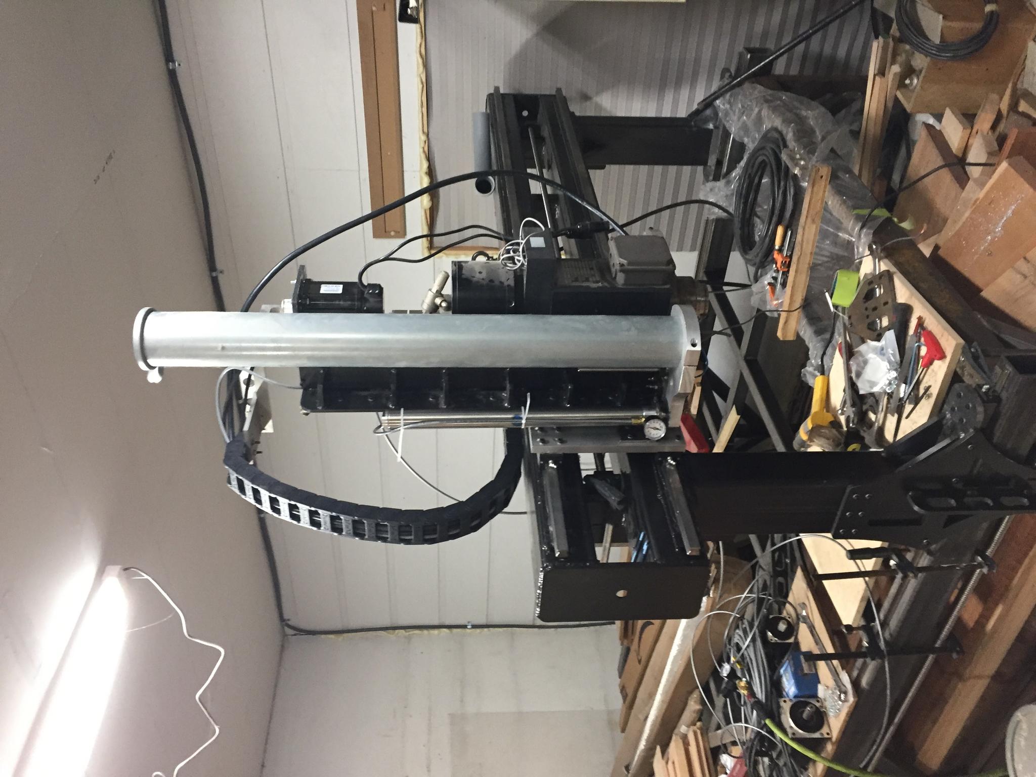

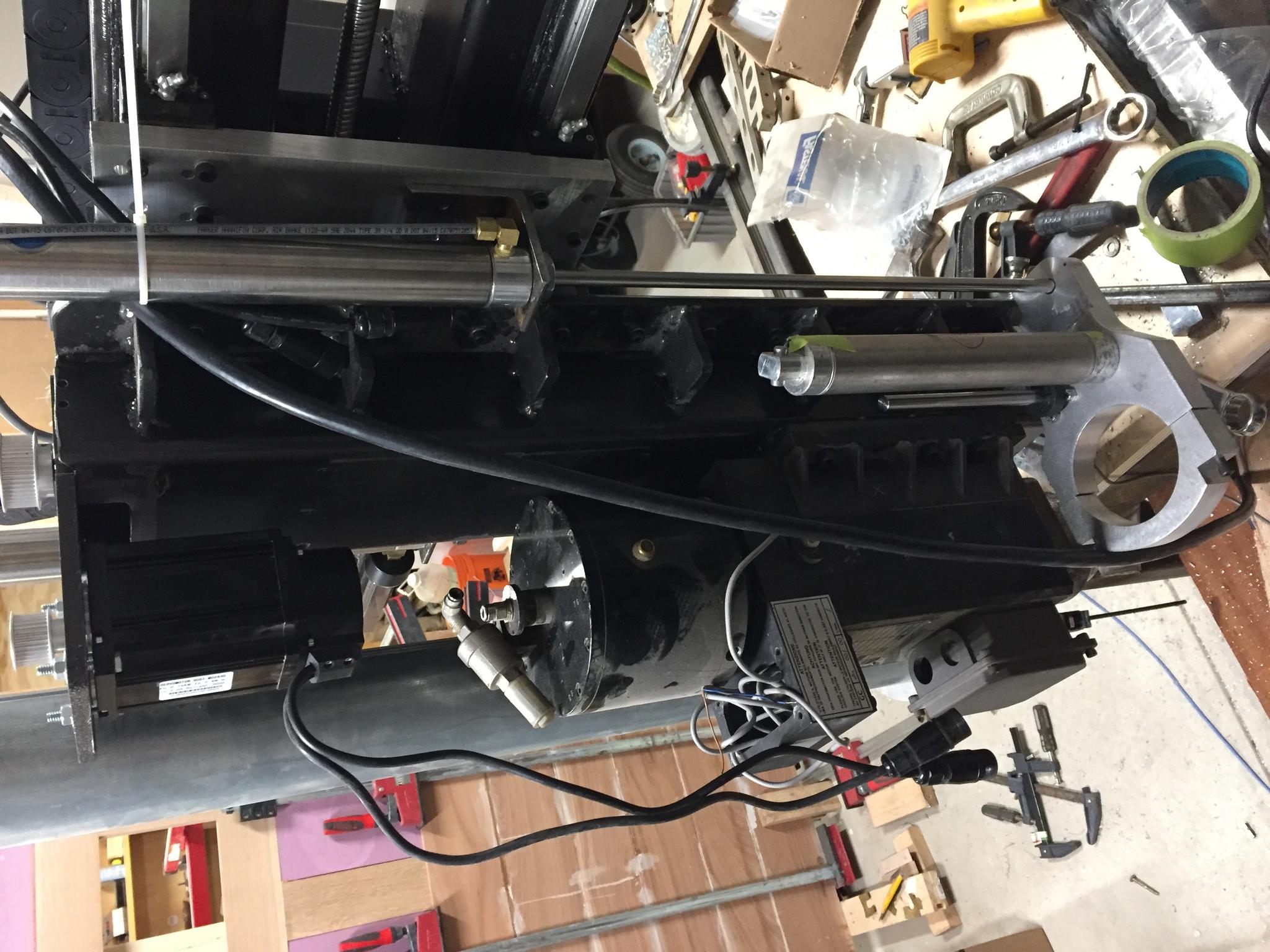

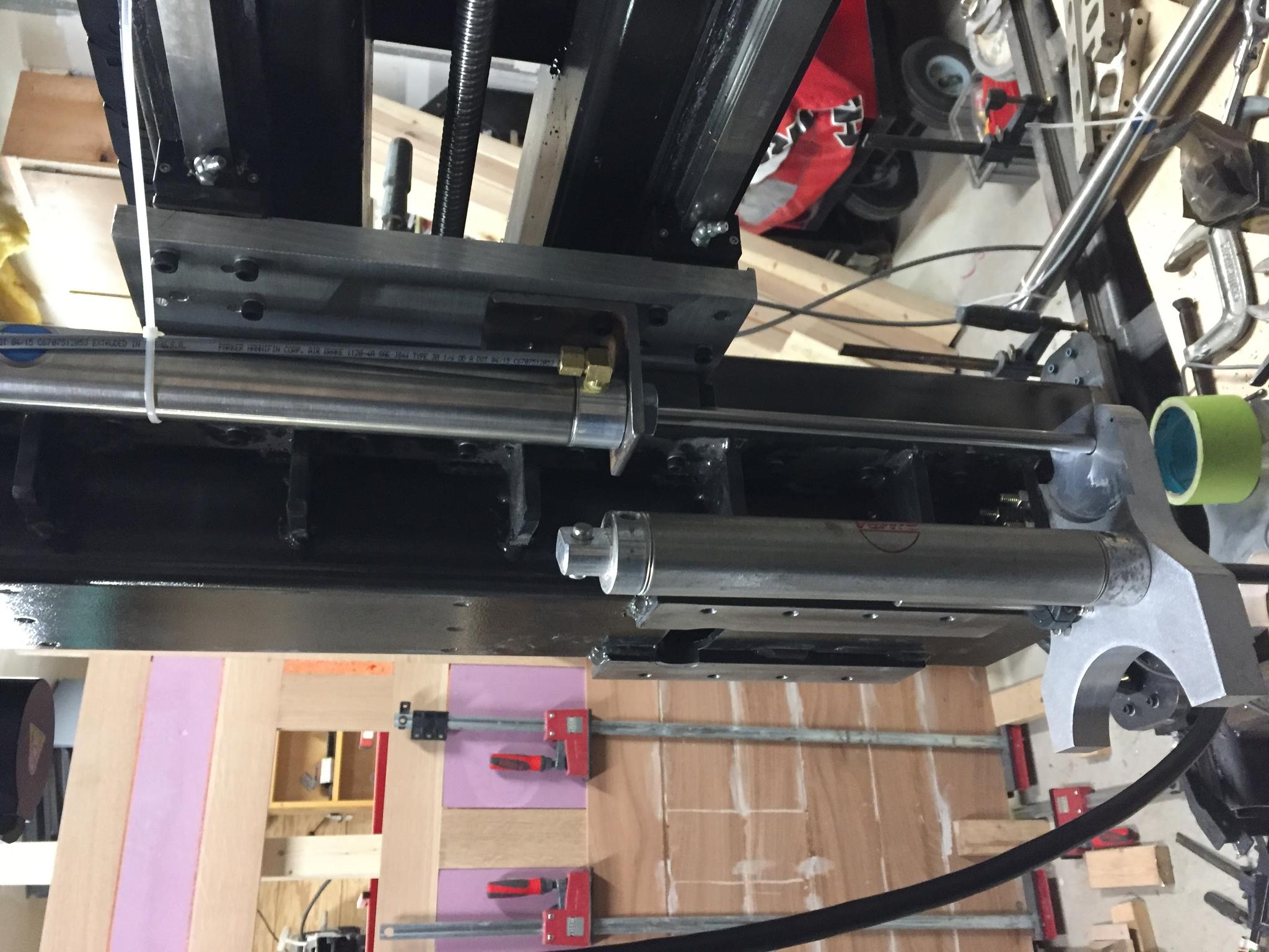

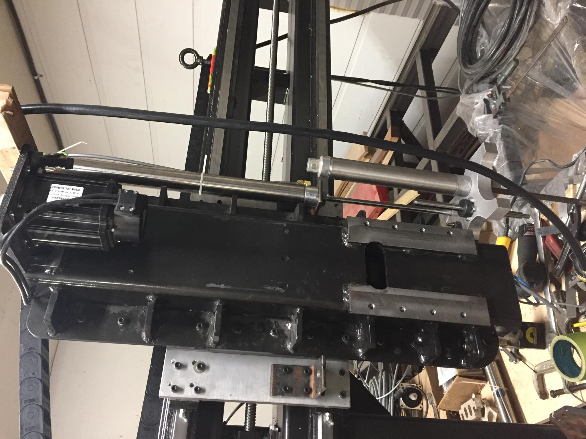

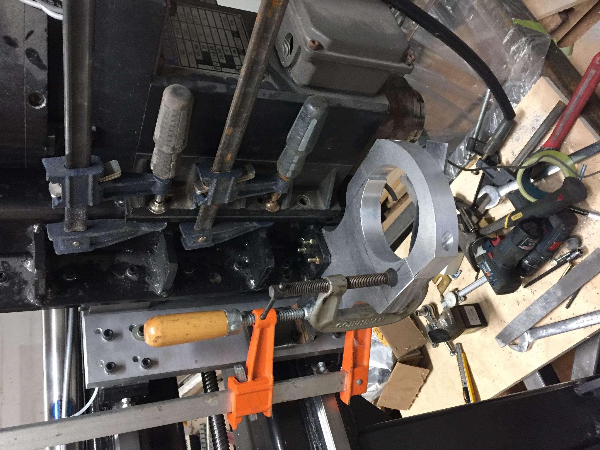

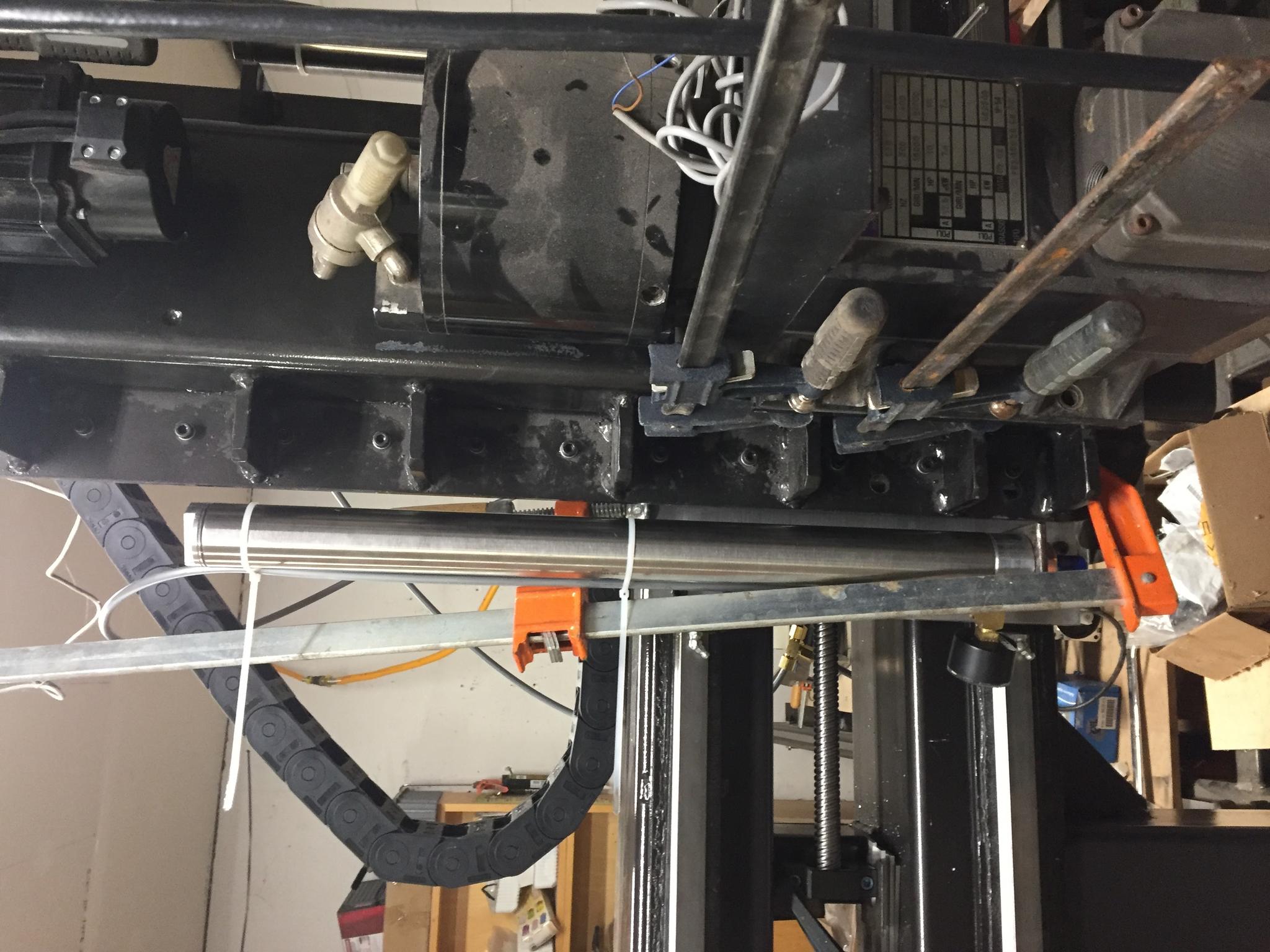

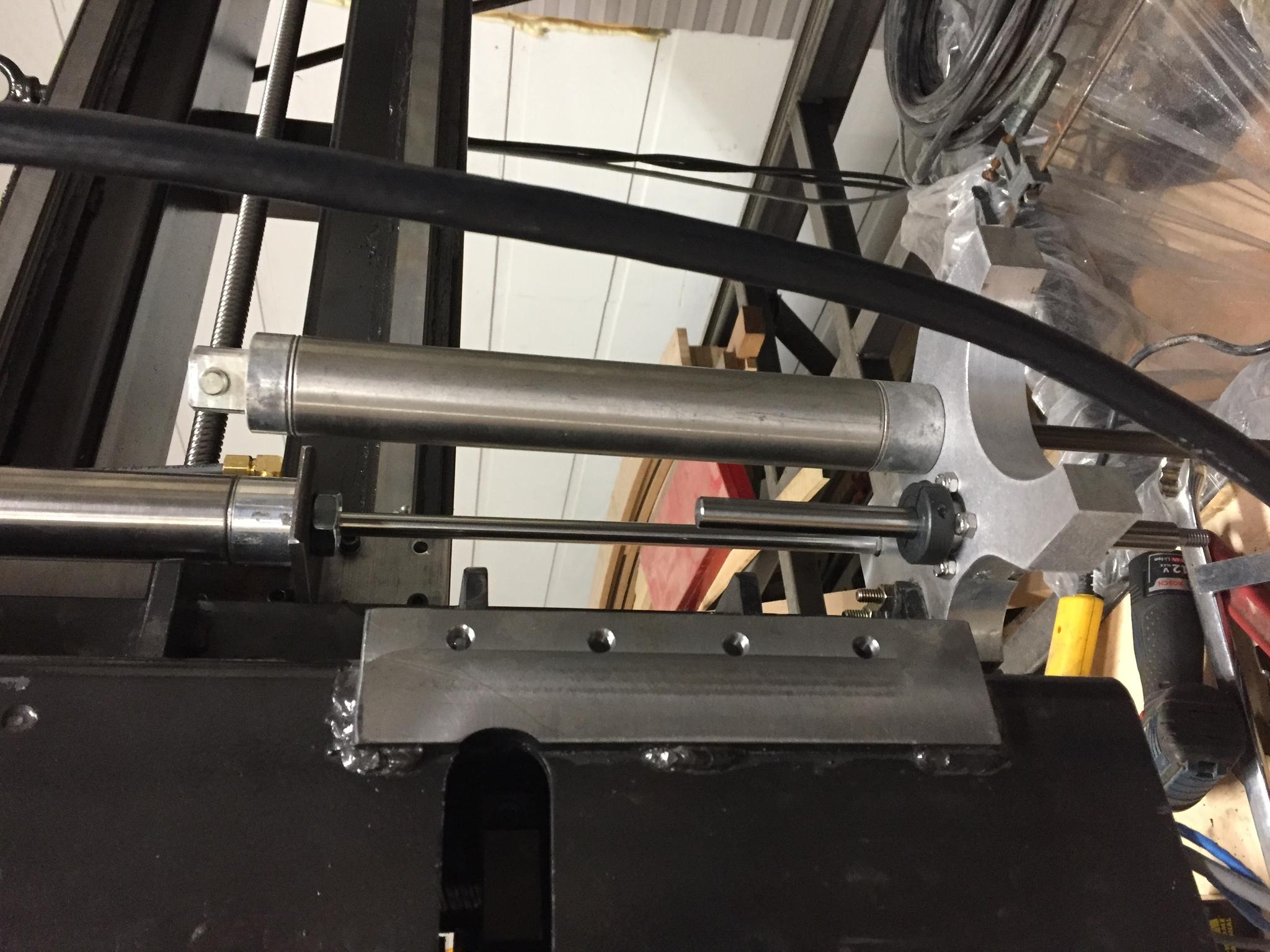

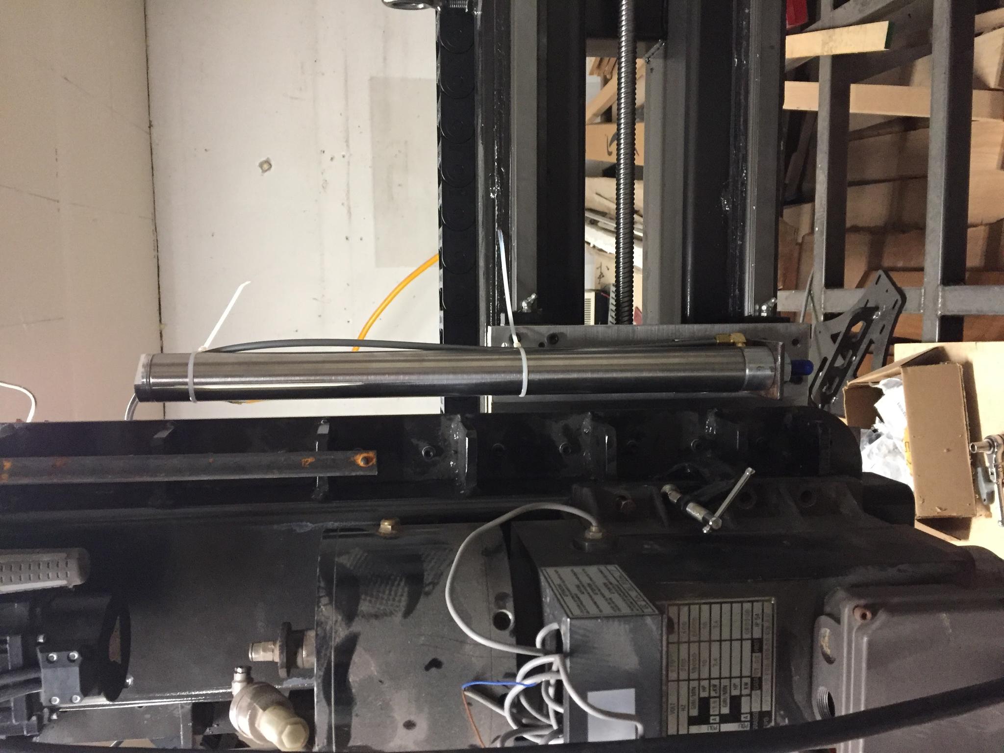

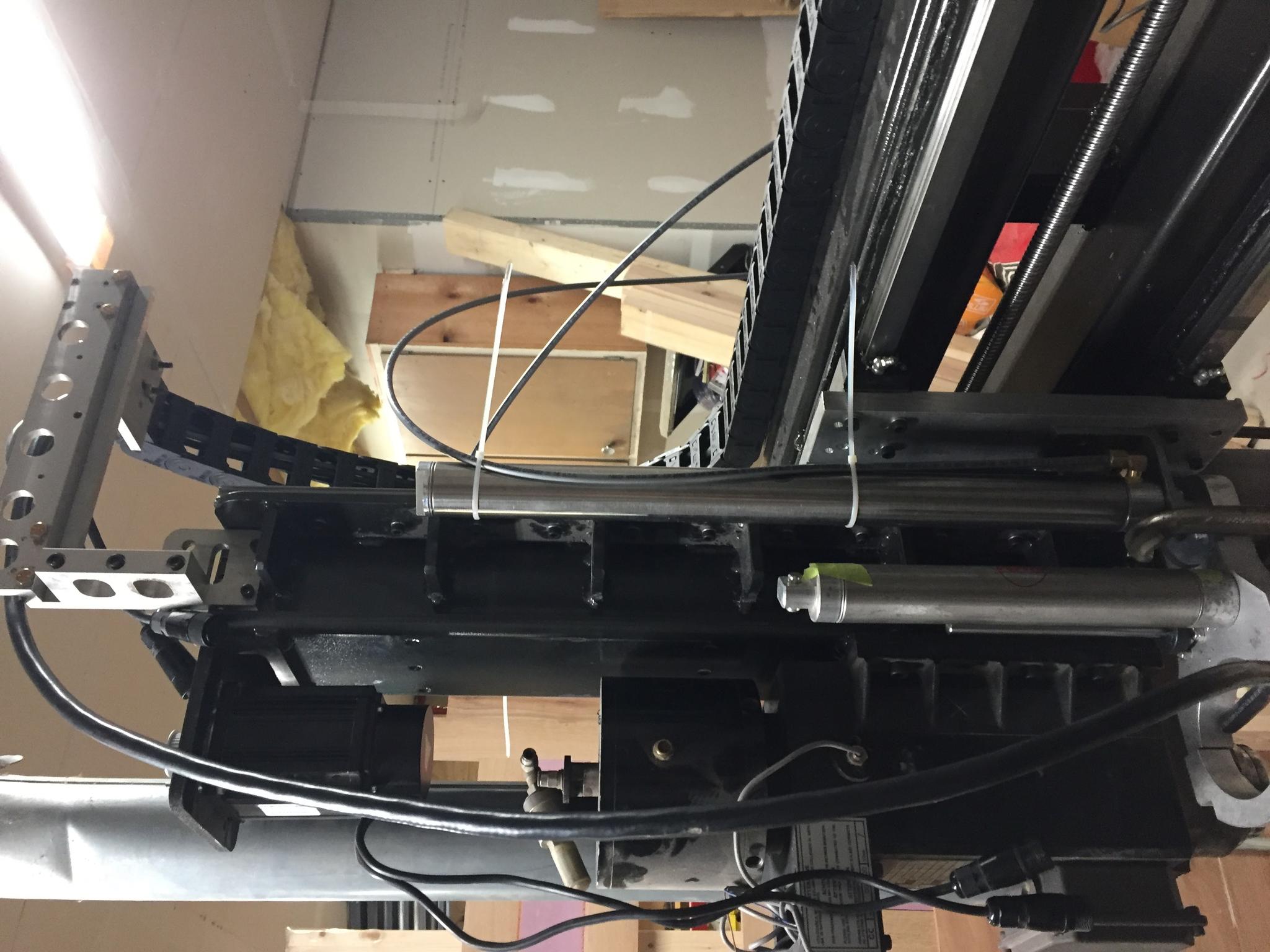

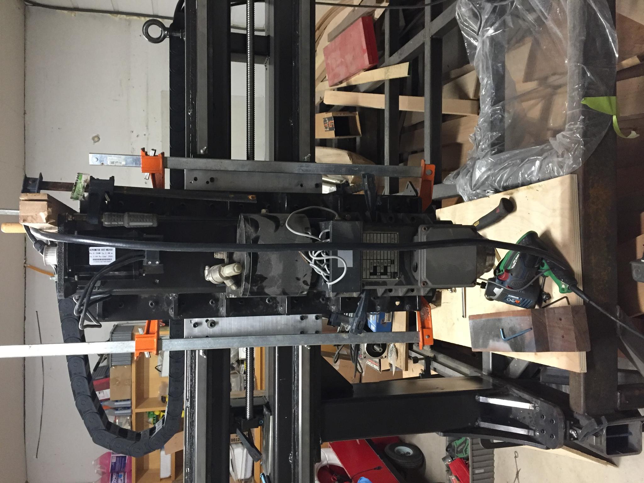

    Building brackets for dust collection holding and pneumatic counter balance system
ID:	19901Click image for larger version.
ID:	19902Click image for larger version.
ID:	19903Click image for larger version.
ID:	19904Click image for larger version.
ID:	19905Click image for larger version.

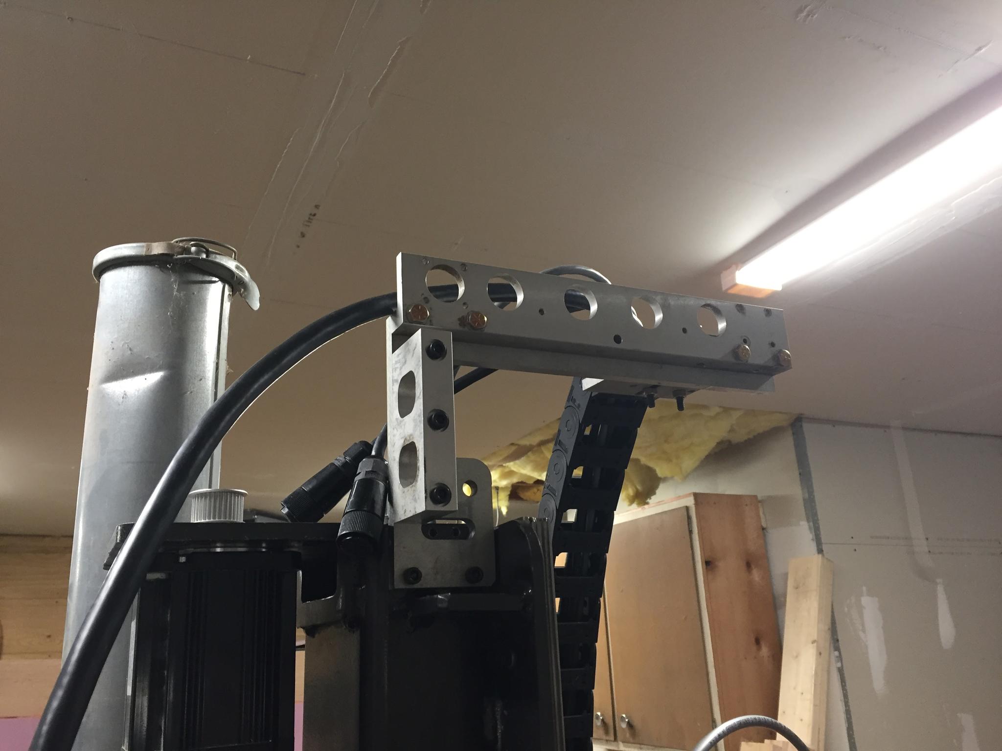

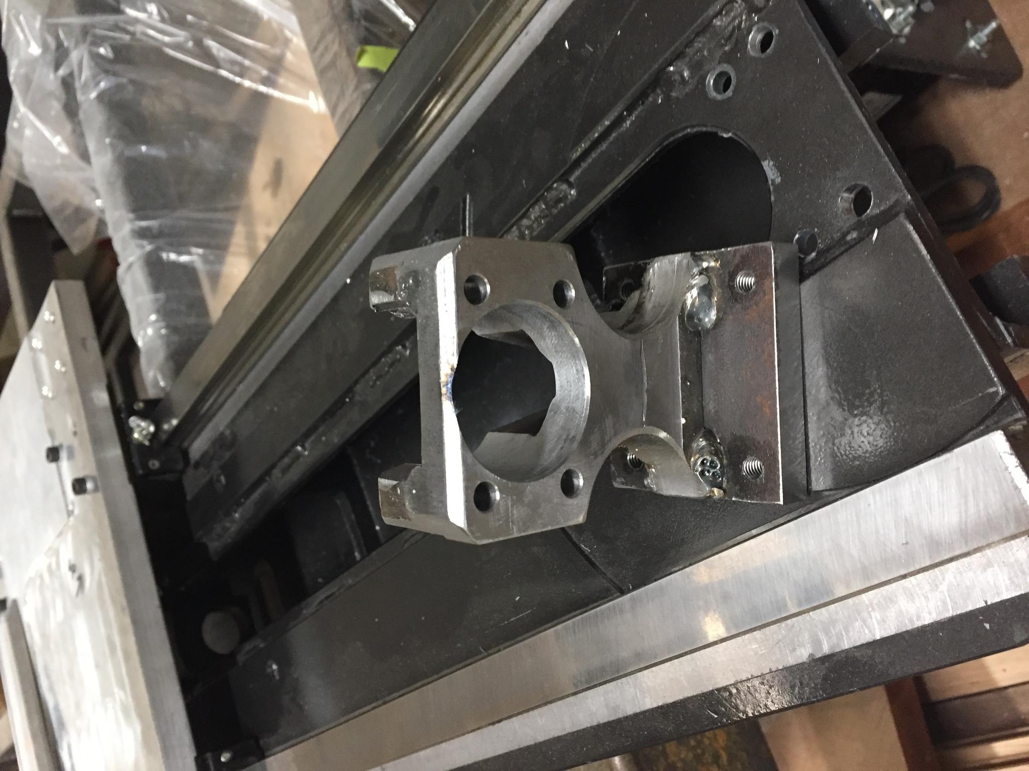

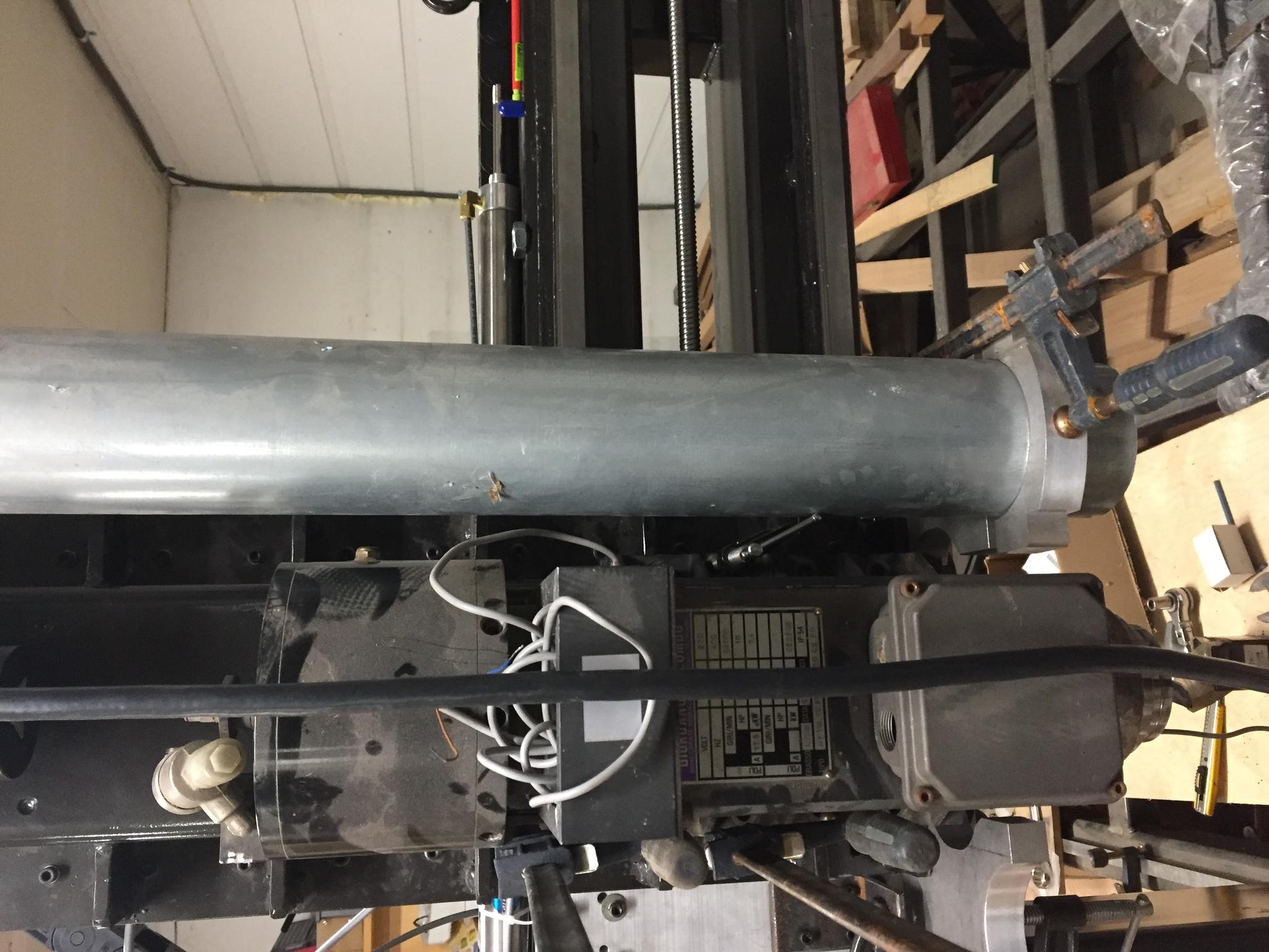

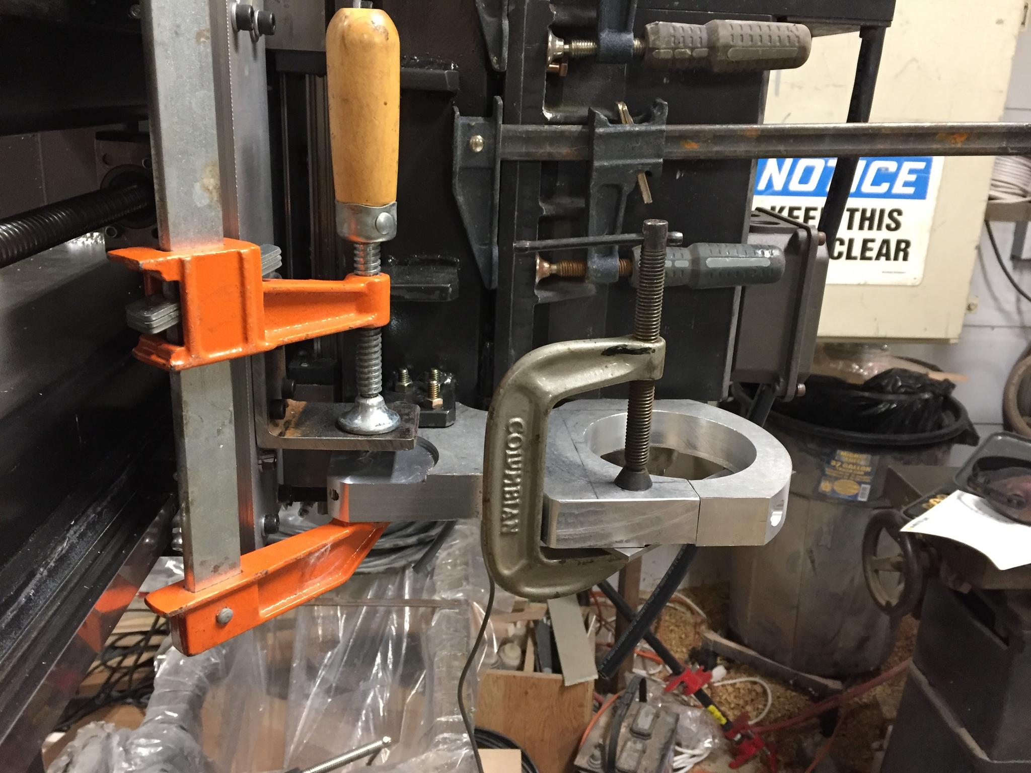

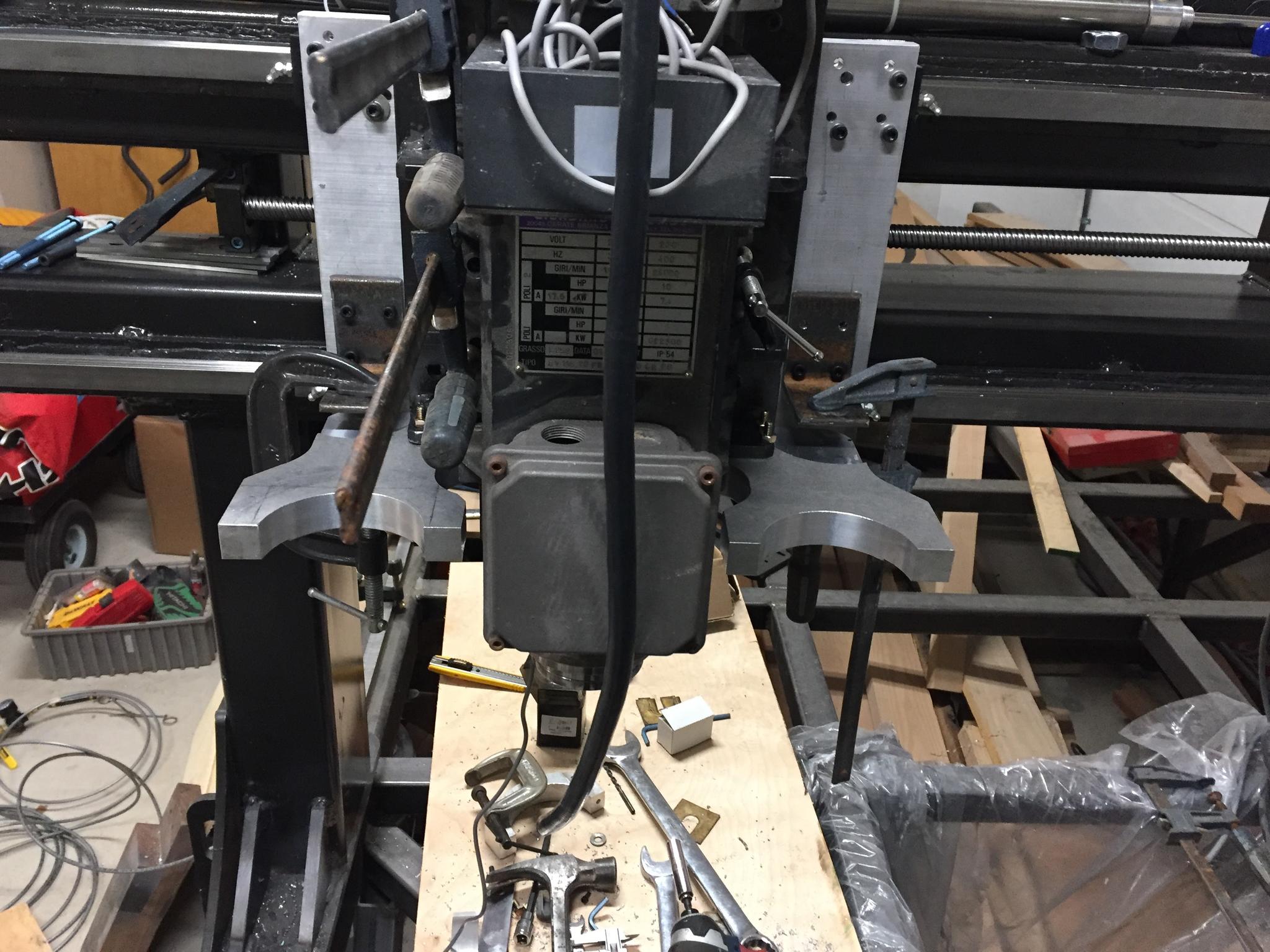

    Machining and installing guides for dust shroud, shroud/brush will be on pneumatic cylinders so it can be pulled up when needed and also when I add the tool changer.
ID:	19907Click image for larger version.
ID:	19908Click image for larger version.

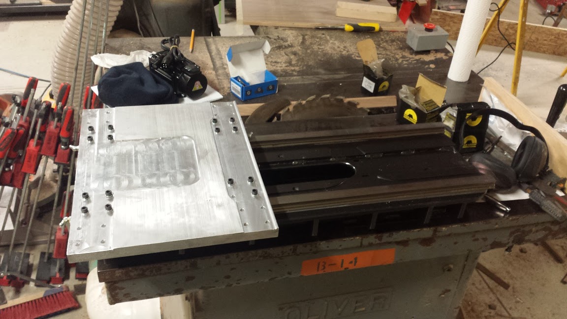

    As it sits today, my plan is to work backward from the Z axis finishing each axis as I go. Sorry for the dump with little text but I wanted to update this with where things are. I can give any specific information as needed
