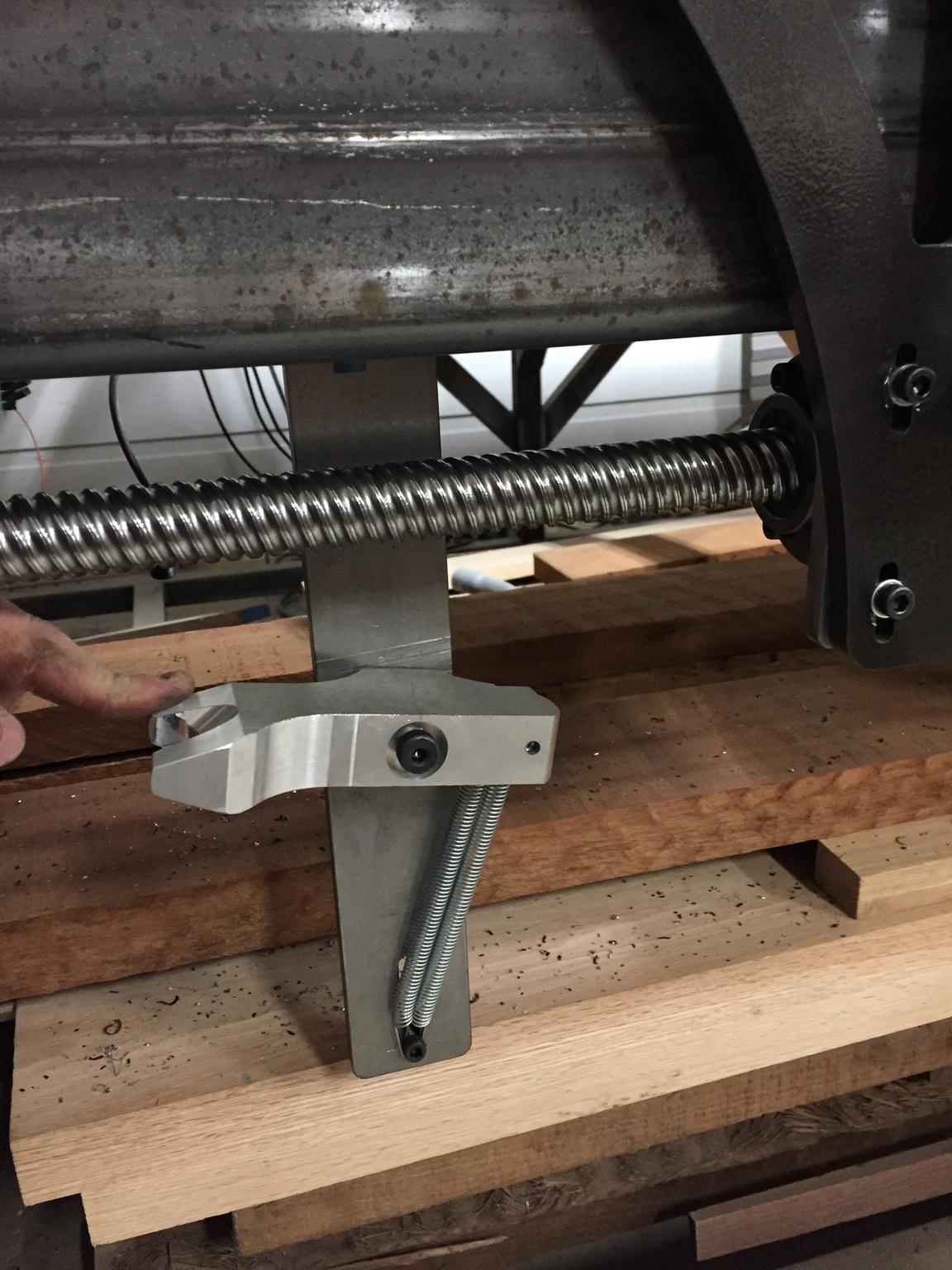

    Made a bit more progress over the weekend,
    Got one of the X axis screws mocked up

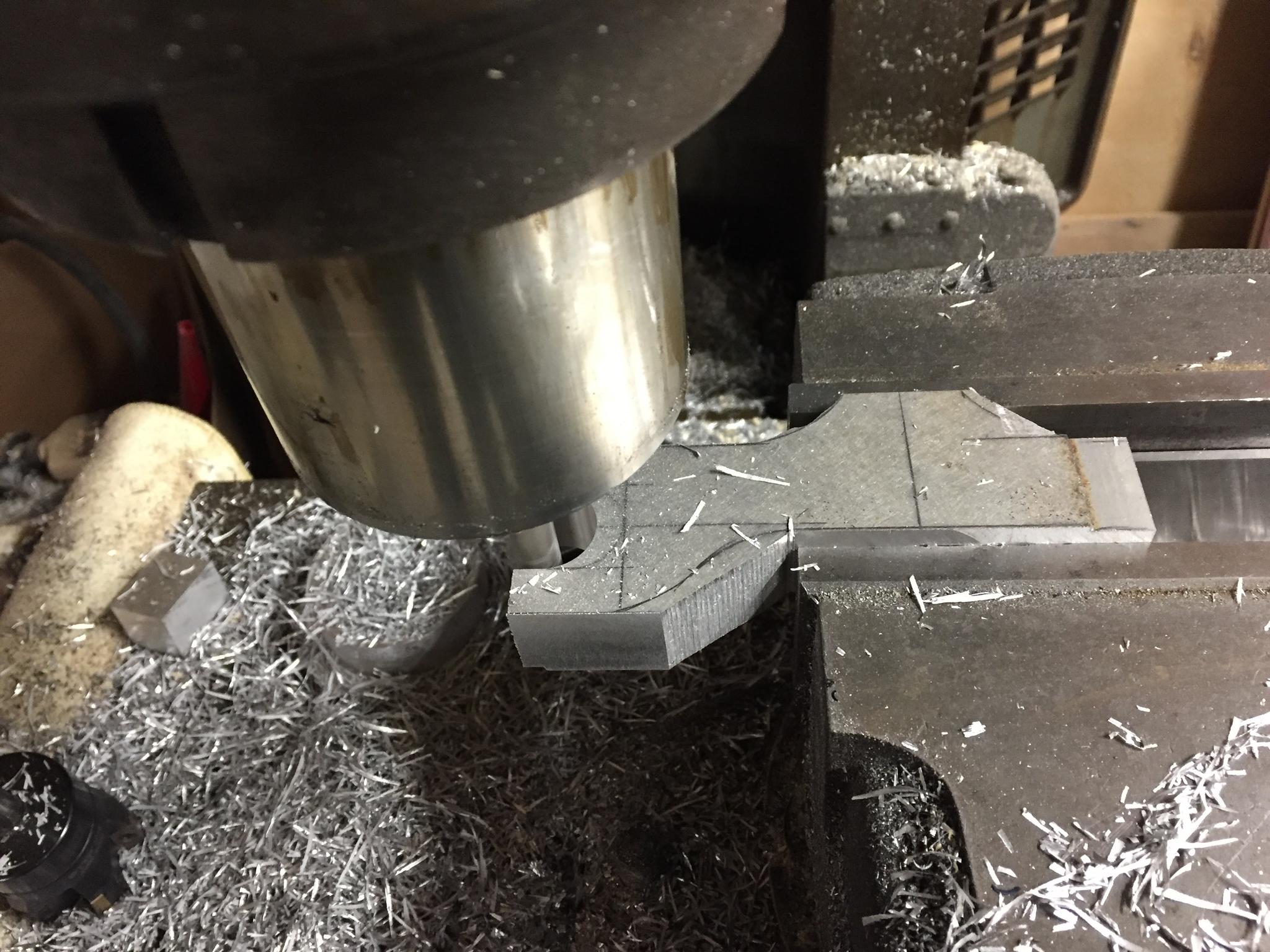

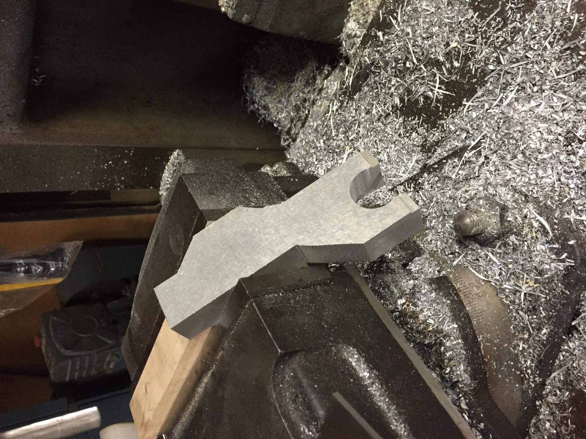

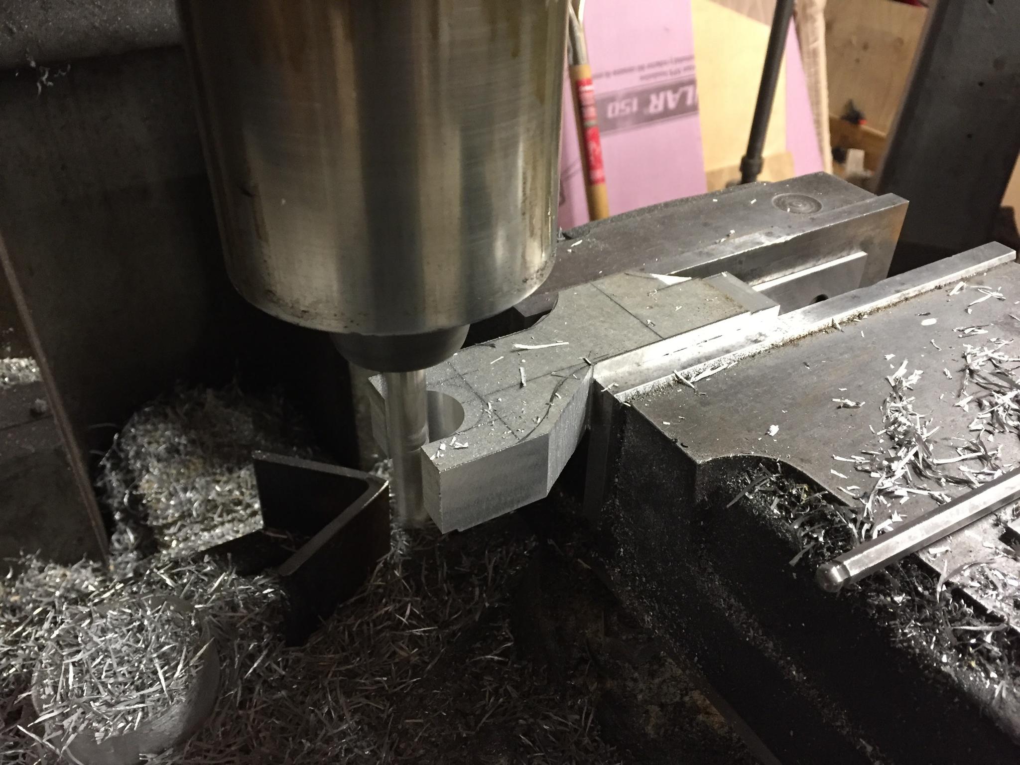

    Here I am machining the spring loaded brackets that will act as X ballscrew mid supports. These will support the screw and when the gantry goes by will move out of the way on the pivot. I need to get some shoulder bolts still for these and do a bit more machining for clearance of the ballnut as it passes (to ensure that it cant get hung up on a change of direction).

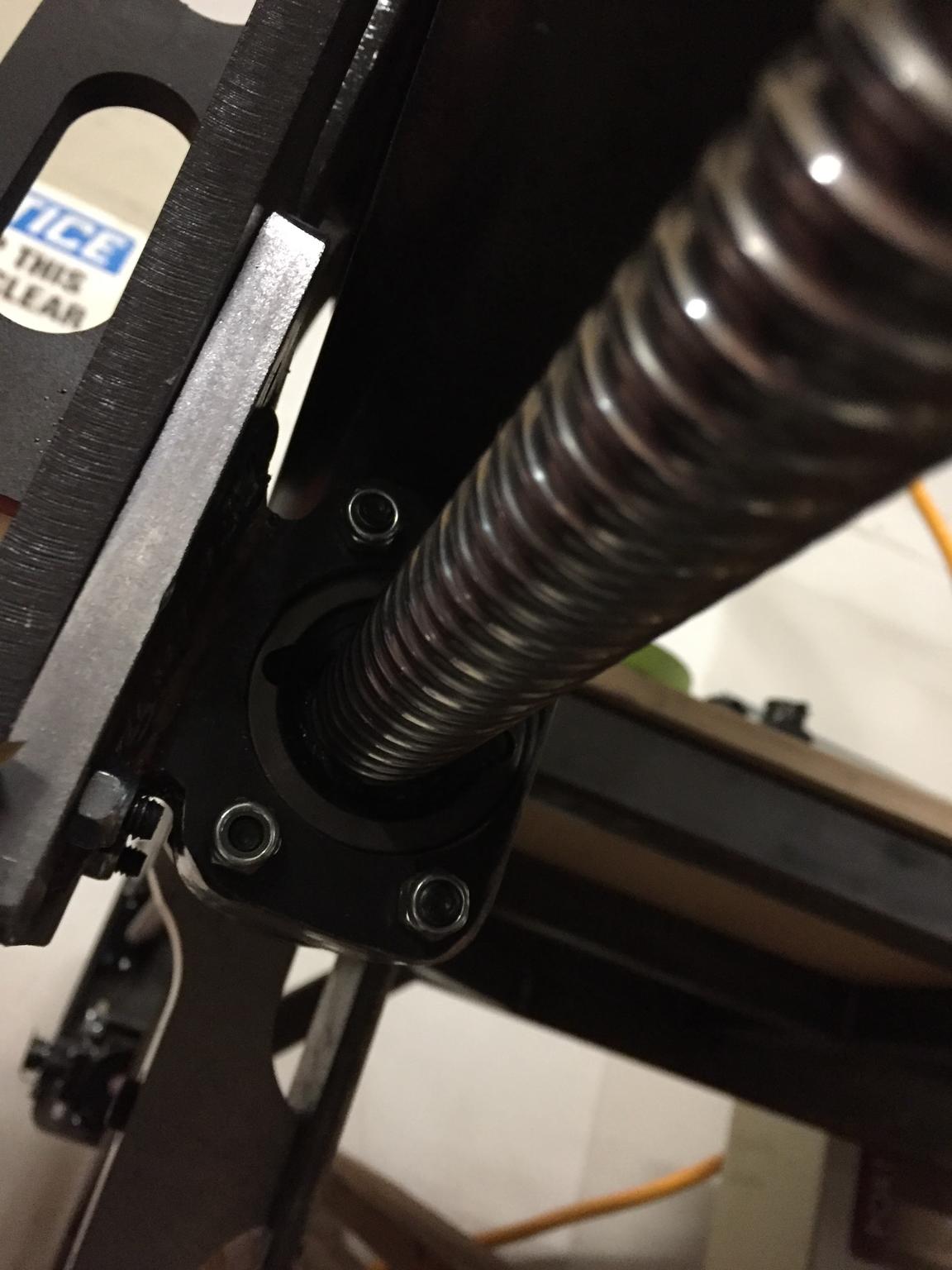

    Some more progress made, I got the ballnut mount made and installed and also finished one of the ballscrew mid supports. I made a video of one of the ballscrew supports in action, I am just pushing the gantry back and forth. I pushed the gantry from one end to the other as fast as I could and this one support seemed to damp the ballscrew frequency. Im hoping to finish up this side tonight and then do it all over again on the other side.

    I need to do some learning on tuning 2 X axis servos at the same time, if anyone has any suggestions im all ears.
