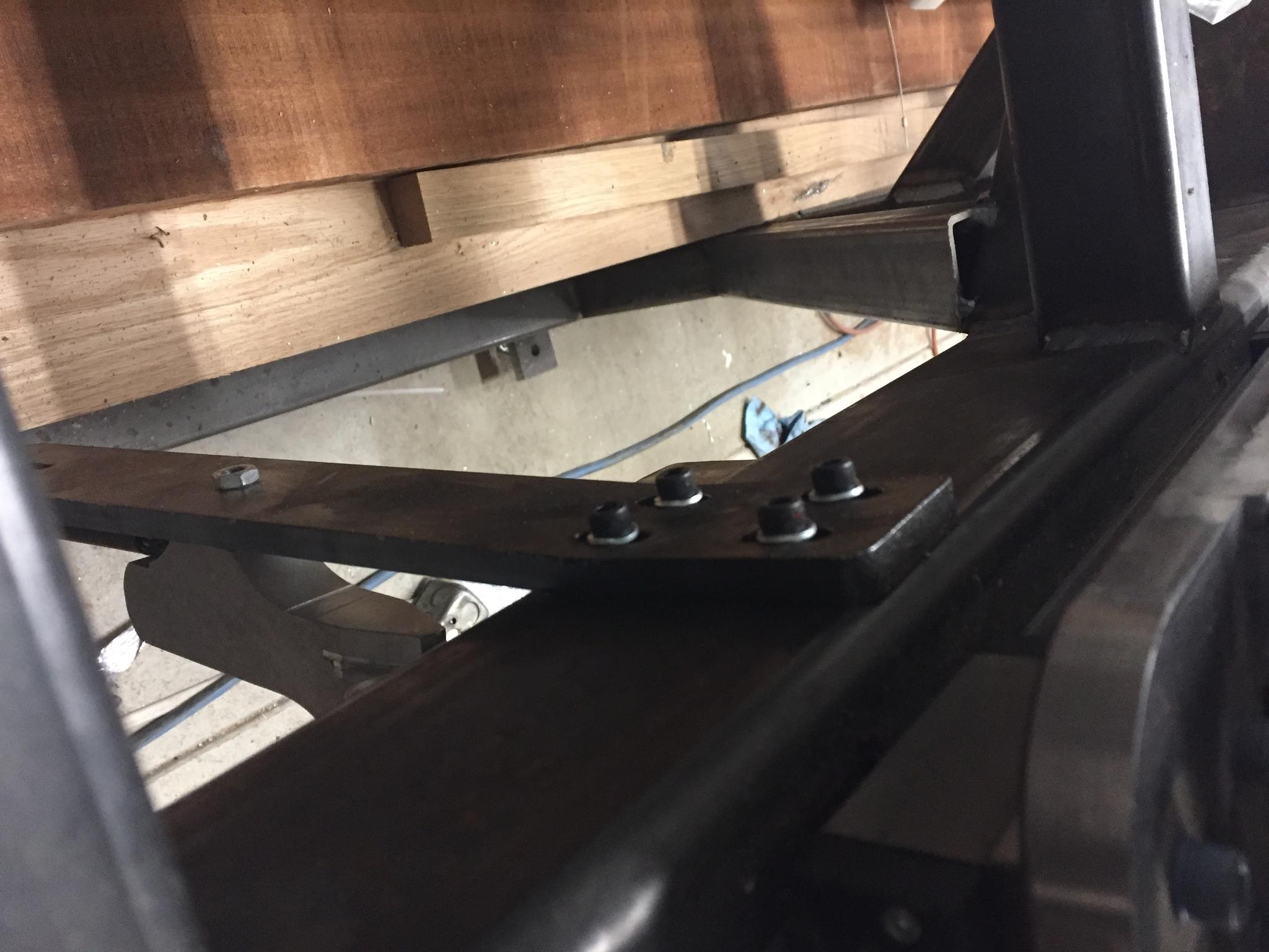

    1st, make 400% sure that the ballscrew mid-supports can not get hung up on a sudden change of direction.

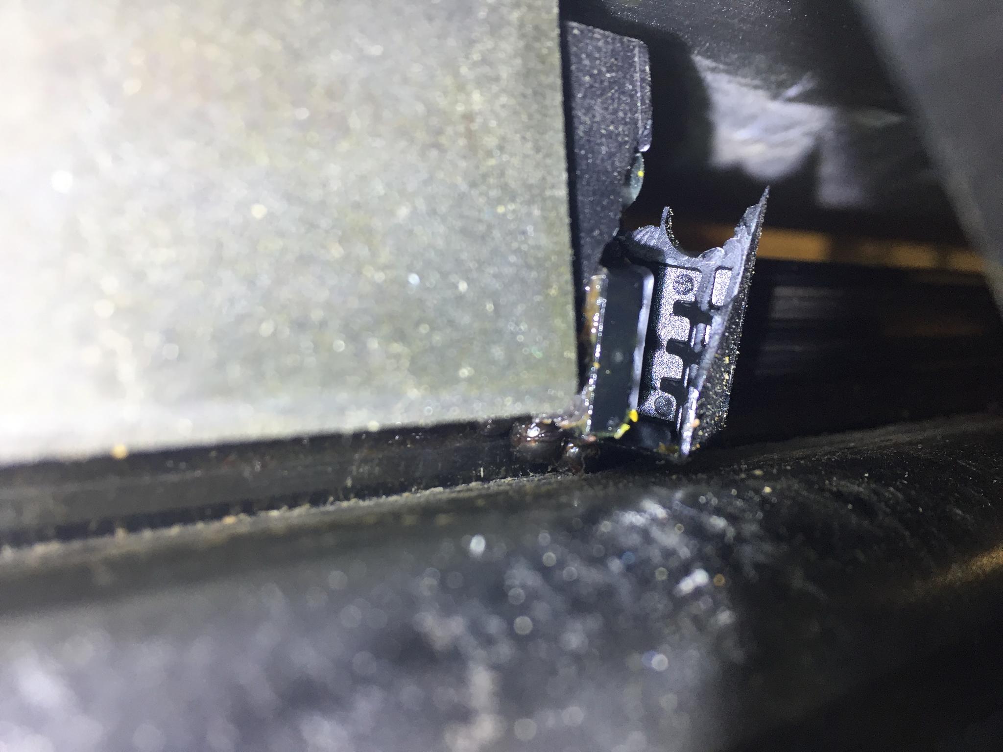

    This bent back pretty easily but I will need to make some modifications to make sure it cant happen again. Basically the machine stopped before the support flipped and on change of direction it caught on the ballnut mount. No other damage observed which is good.

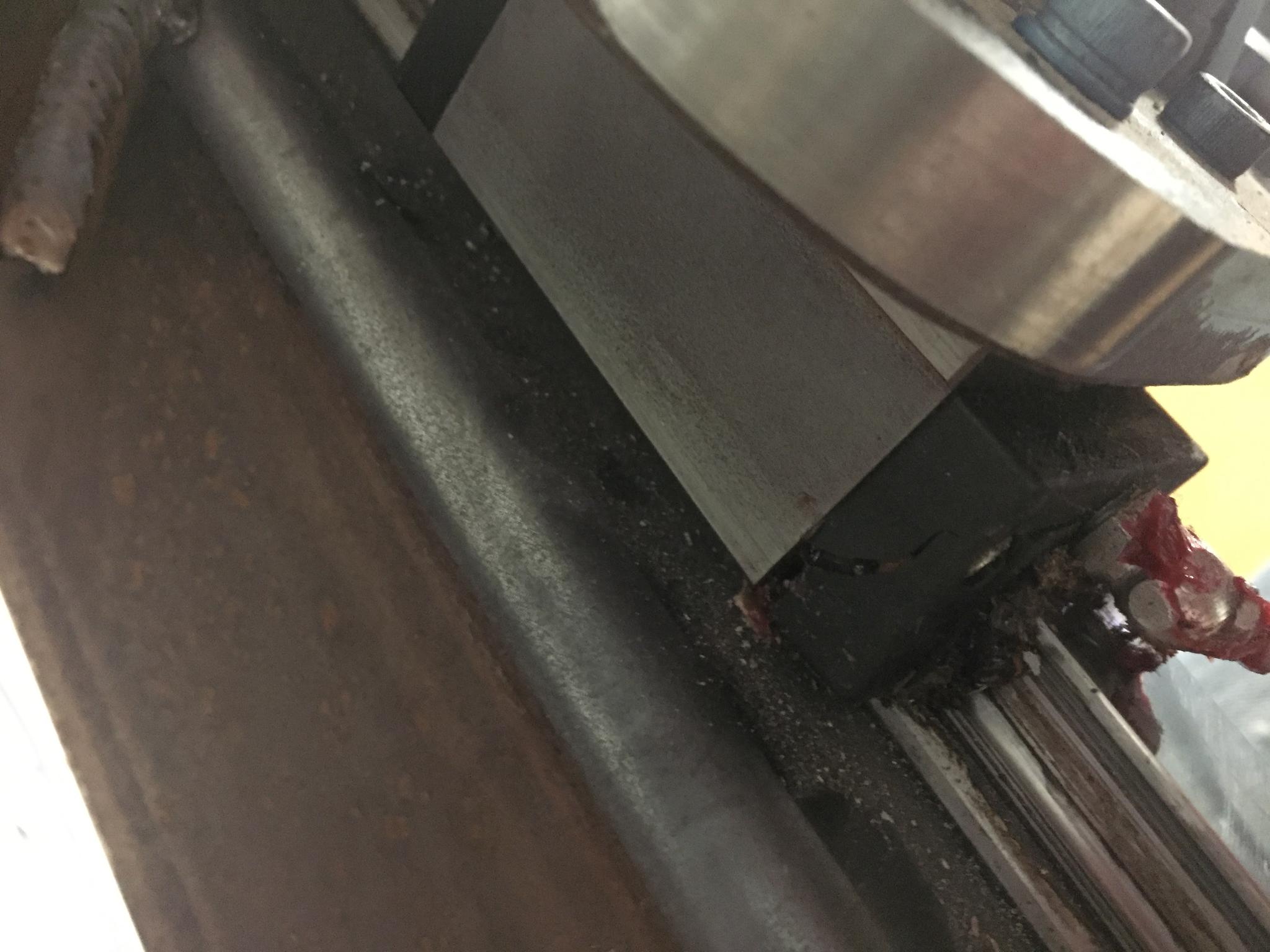

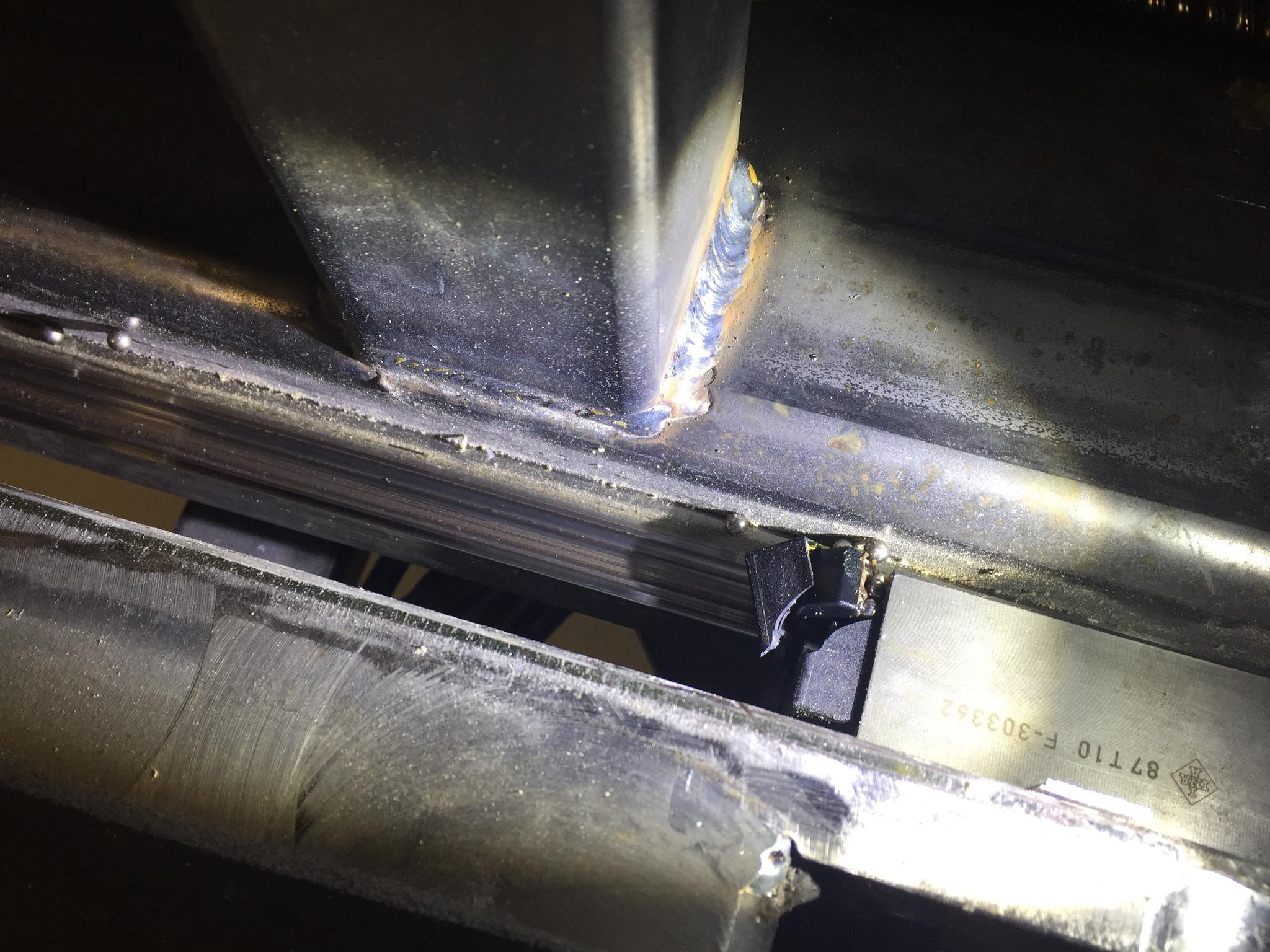

    2nd, and this is the big one, when butting linear rail together remove the lead in on each rail. I had known this was the case but being that I got the rails for cheap and not having a way to accurately grind the rails I chose to try it.... bad choice.

    What the pictures show (or what I assume happened), as the block went past the joint a ball dropped into the joint, caused alot of extra force and blew the end of the block off. At lower speeds it seems to be fine, but I was running past it at ~1000 ipm. I think the block counldnt handle it I was able to stop it before the other 2 blocks hit the joint. I have 4 extra blocks that came with the used rails so I can put it back together for now but I need to make a plan for future.
    I think my options are
    1 - remove rails and have them ground and put back together - this is a no go as the cost would be more than just buying Hiwin rails
    2 - buy Hiwin rails and blocks - definitely the best option but costly
    3 - try to fill the groove/lead in
    - Im thinking of trying this method, couple options, epoxy, babbitt, other options?
    - I think I just need to keep the balls from dropping in there, I think there shouldnt be too much stress on the fill otherwise.
    4 - just use the 8ft of full length rail for now???
    Any thoughts are appreciated...
    Ouch.!! . . . Bad luck. That's difference between Servo and steppers. They take no prisoners! . . . Stepper would have stalled before bending that bracket or possibly ripping the bearing end cap apart.!
    1st Choice is no brainer new Hi-win rails.
    2nd Choice new Hi-win Rails
    3nd Short term Choice fill with Metal Epoxy. Think it's called JB Weld in states.
    No other choices IMO.!
    Short term I have moved the entire machine to the other side of the joint and moved my X home switch. Gives me 6.5 feet in the x and 5.5 feet in on the Y and gets me going with making parts. I have ordered machinable epoxy to do a pour to try to fill the joint. Long term after a few paying jobs, probably going to order some new full length rails. This will unfortunately require some modifications to the machine as the rail height will be different.
