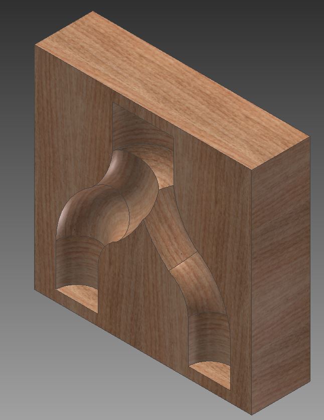

    While still waiting on the fan adapter so I can cut with the machine, I decided to draw up a dust collection adapter mold to lay up fiberglass in. Video shows the machine running this code.
Name:	ISO View Dust Collection Adapter.JPG
    I put the X and Y to 1000ipm as 2000ipm scared me and while I am learning about this machine I wanted to be a little safer.

    So I decided to make a temporary spindle cooling fan adapter and get this thing cutting. So the first thing I wanted/needed to make is the dust collection adapter mold.
