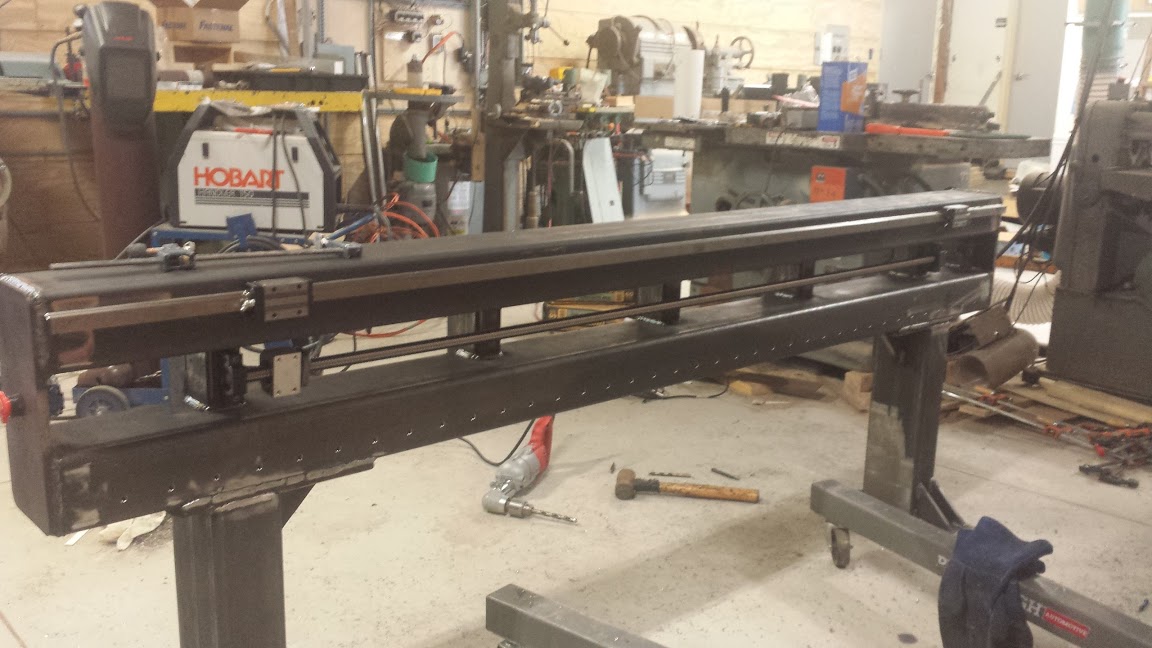

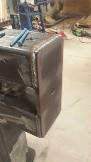

    Gantry partially welded up, Gantry is built from 4in x 6in x 1/4in wall box tubing and will get blocking in between the 2 tubing with some vertical bracing on the back. I machined the ends of the gantry before welding them up so I can put an e-stop on each end. The ballscrew is laying ontop of the gantry and will live between the 2 box tubing when complete.

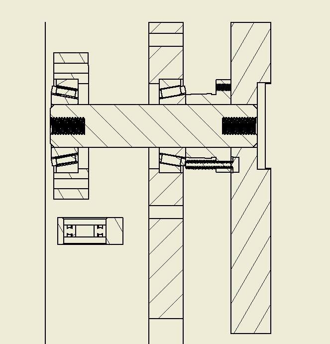

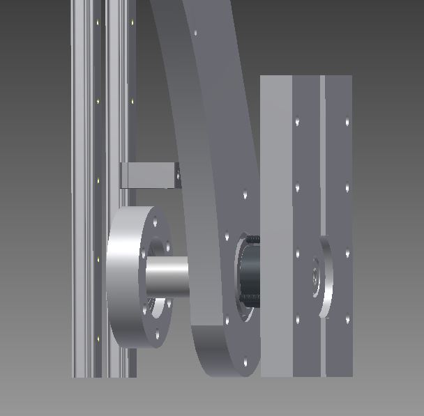

    Here is the plan for the Z axis, made from 3in x 6in x 1/4wall box as a starting point. I plan to make an A axis and have mounted the motor up and off to the side. Although this could still get in the way. Should I put the motor for the A axis above the spindle motor? This will make the HTD belt 20 inches center to center. If I did that would I be looking for trouble as far as belt stretch is concerned?

    Heres what I was thinking for A axis

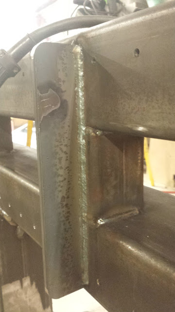

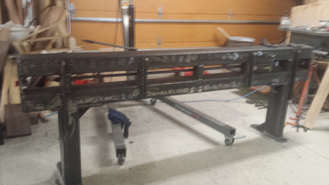

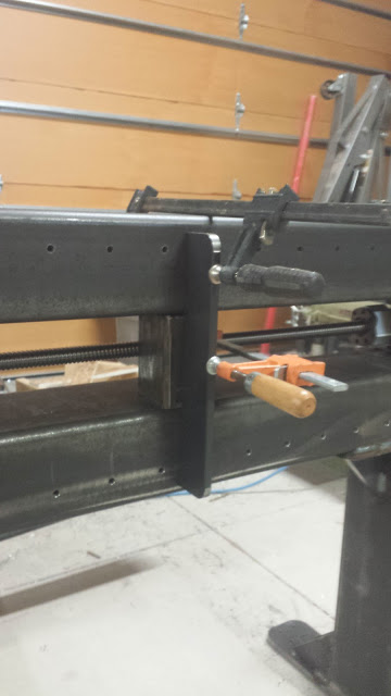

    Some updates on the gantry
    All of the bracing clamped in place ready for spot welding. The ballscrew is in place to set the distance between mounts.

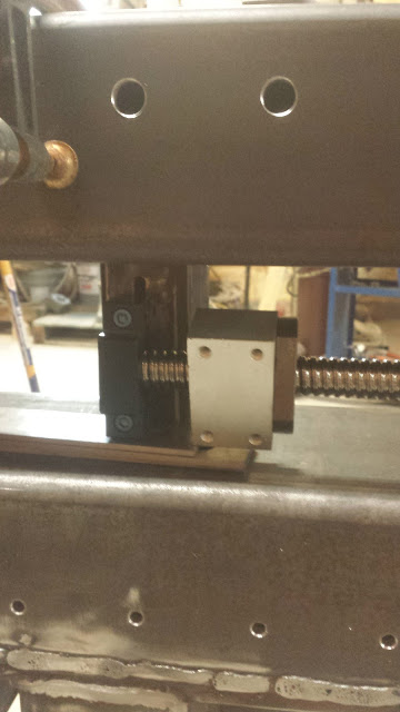

    Here is one of ballscrew mounts

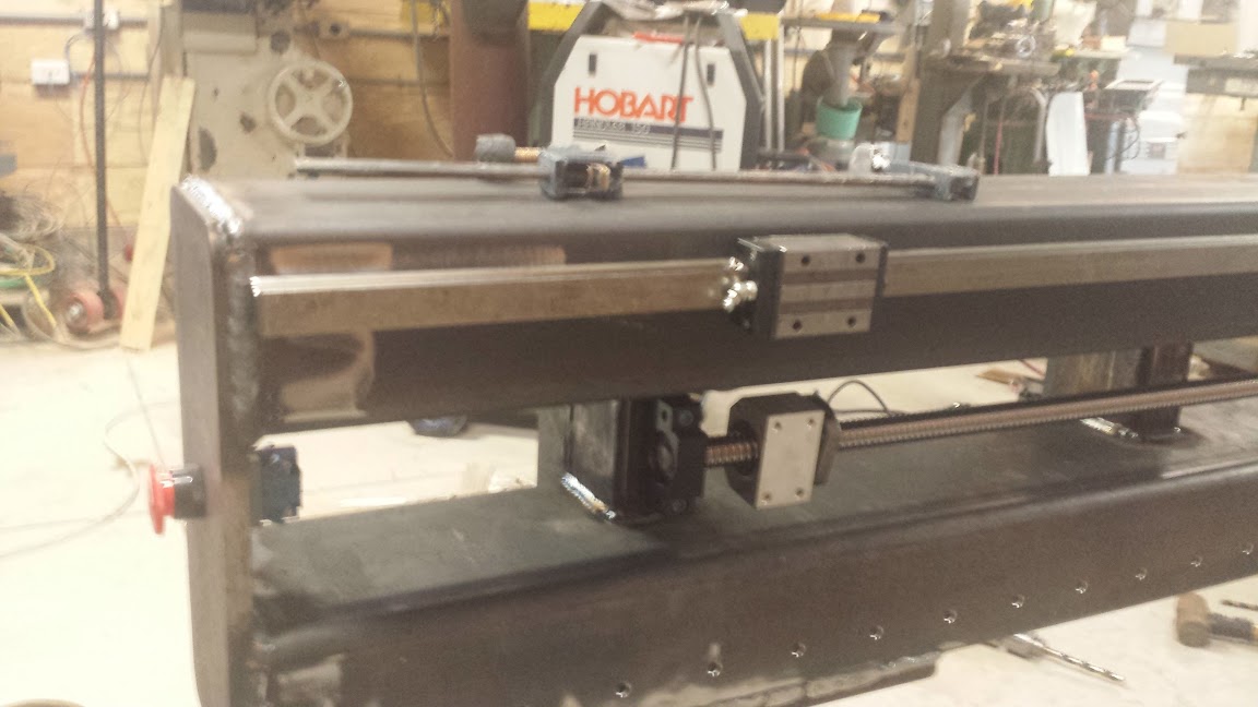

    this is the end of the gantry showing the space for the estop
    This is one of the longer braces that connect to the ballscrew mount block

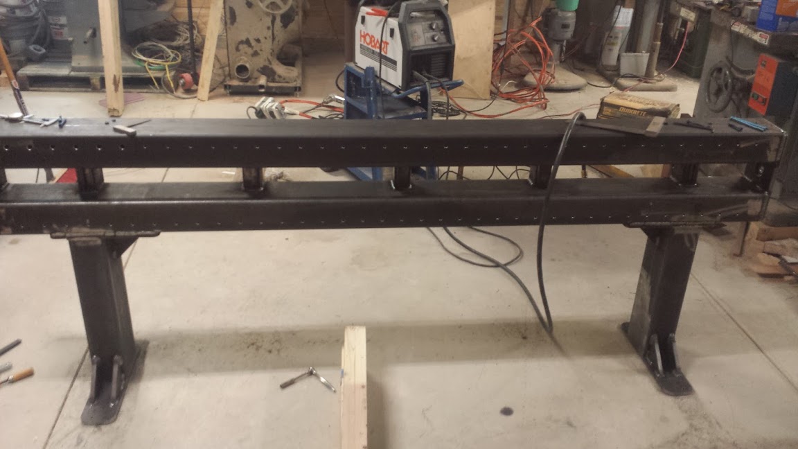

    Here is the backside with all the bracing welded up

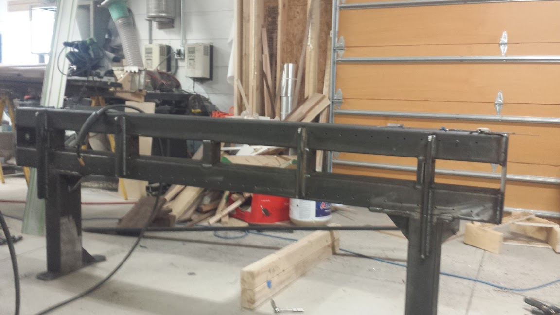

    And the front side, notice I drilled some 1/2 in holes on the wrong side. My linear rails are threaded from the backside so I have to through drill from the back. The good news is I am welding on 3/8 plate (I drilled the holes to the correct spacing on the mill first and used the 3/8 plates as templates) on the front side where the linear rails are going to mount.
    Very impressed, with a lot of things. Very excited about your A-axis, sometimes one should just go to ahead and build it instead of pondering if it will work or not :D I have not attempted to build it yet, as I dont even have an idea of how I would use it. I really have no clue how one would incorporate 4 axis programming.
    I would probably fit the widest possible belt there, if I were to use belt, you want the spindle to be rigid enough. What kind of bearings, if that is how you are pivoting the A-axis? Got any detailed view of it?
    Nice work so far.

    Heres a view of the bottom of the Z axis and a section cut into it.
    **sorry the drawings are upside down**
    Here is the box tubing removed
    The bearings are roller bearings that I can get from McMaster Carr easily. 1 1/4 diameter shaft. Bearings are designed to be held into aluminum housings bolted into the 3 x6 steel tubing. The shaft is a 6 inch threaded on both ends. Again something I can just order from McMaster. The bolts into the shaft allow me to put preload into the bearings. I was thinking of bolting the pulley hub (pulley is not pictured) to the spindle mount.
    Open to thoughts on this design. I think it will work....

    I threw a couple bolts into one of the linear rails just to see how things were coming together.
