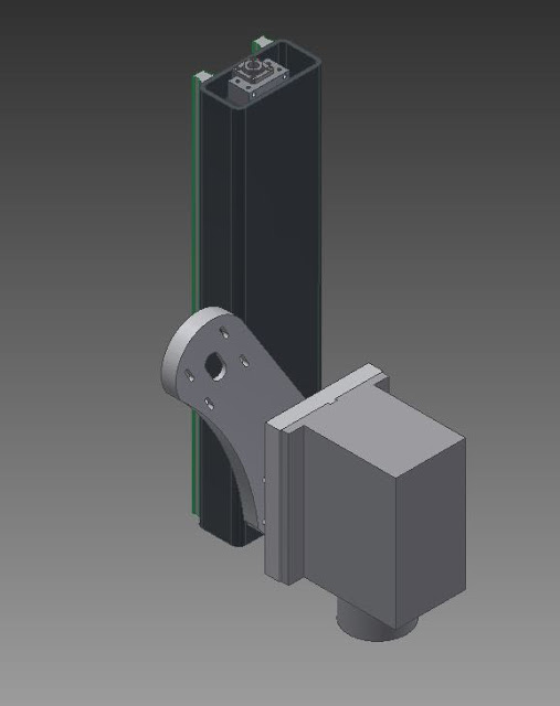

    Heres a view of the bottom of the Z axis and a section cut into it.

    **sorry the drawings are upside down**

    The bearings are roller bearings that I can get from McMaster Carr easily. 1 1/4 diameter shaft. Bearings are designed to be held into aluminum housings bolted into the 3 x6 steel tubing. The shaft is a 6 inch threaded on both ends. Again something I can just order from McMaster. The bolts into the shaft allow me to put preload into the bearings. I was thinking of bolting the pulley hub (pulley is not pictured) to the spindle mount.
    Open to thoughts on this design. I think it will work....

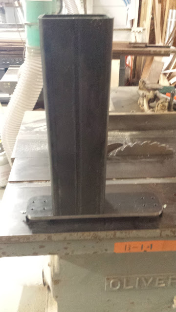

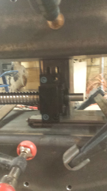

    Drilled backside holes out to 1/2 inch to allow bolt and ratchet to be put through from the back. Im thinking I will just order a bunch of plastic plugs to put into these holes once I am done.

    I threw a couple bolts into one of the linear rails just to see how things were coming together.

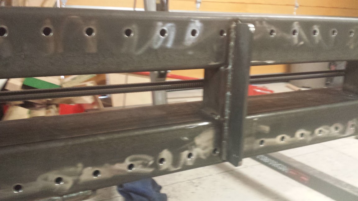

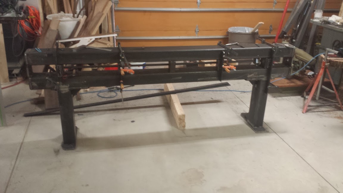

    So far I am pretty happy with how the build is coming together. Time will tell if I have some precision/accuracy when im done...

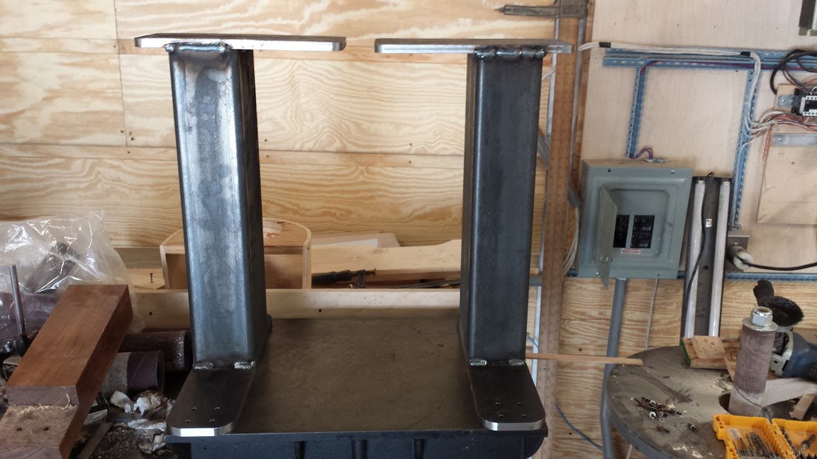

    Some thoughts:
    -the gantry legs dont seem adequate for the rest of the parts you will use on your machine
    -the A may work for foam but i dont see it serious for anything more than wood
    -the stepper motors , ok- the huge stepper motors, what drives will power them? 230VAC?
    -that bracing may be was totally unnecessary. I dont see how that will strengthen anything. It could even make things worse, strengthening one point too much and not allowing the forces to spread uniformly and creating pressure points. So later all rings.
    What will you be using this machine for? Remember- the weakest point is the criteria for how strong your machine would be. Again-the gantry legs.
    PS:
    That gantry legs will greatly benefit from bolting or welding on them 10mm steel plates in both directions, 2 per leg in total

    Hi Scott,
    This is how I see couple of not so little things.
    Steppers:
    Really Cannot comment if they will be good enough because you haven't said anything about what your using for linear motion on the X axis. I assume Rack n pinion but what ratio etc.? . . . But let me put it this way 550lbs or put anohter way 1/4 Ton is lot of Mass to Accel and stop so better get this correct or you'll seriously regret using steppers.
    A Axis: You need to think again on this I'm afraid NO WAY will Stepper with such small ratio hold that Big spindle at angle without moving or vibrating.
    Remember the Z axis is the MOST important area on machine so weaken this and all that OTT work you have done on the frame is pointless.

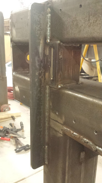

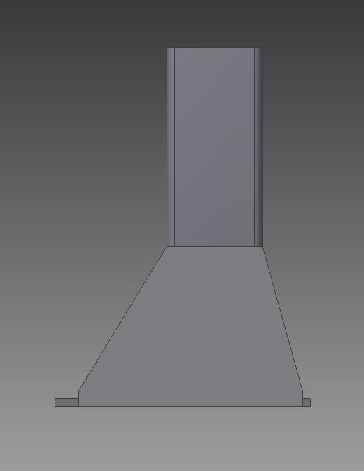

    I think you are talking something along these lines for the sides of the gantry legs? I was wanting to do FEA on these legs but never got around to it, I did however do calculations (free body diagram) to try to calculate total deflection based on 1000lb force at the bit and keeping the total deflection ~3 thou at full load.
    I could go higher with the bracing as well this is just a quick drawing.
    The thinking behind the bracing was to connect the upper and lower gantry beams. I used box tubing between the beams. Now the rear bracing, the thought there was to reduce the twist in the gantry. Hopefully it doesnt cause issues...
    So the A axis, this is exactly what I am worried about, holding it in place when at angle and also moving it. The A axis would really only be used when machining foam blanks for paddle boards. However since I want to be able to machine wood, and aluminum as well then I really need to make sure this thing is right.
    Couple things I am thinking thoughts are greatly appreciated.
    - Eliminate A Axis...
    - greatly increase the belt ratio
    - keep A Axis but have an air operated taper pin that holds it at 0 when machining wood/alum
    - look into a harmonic drive rather than belt drive

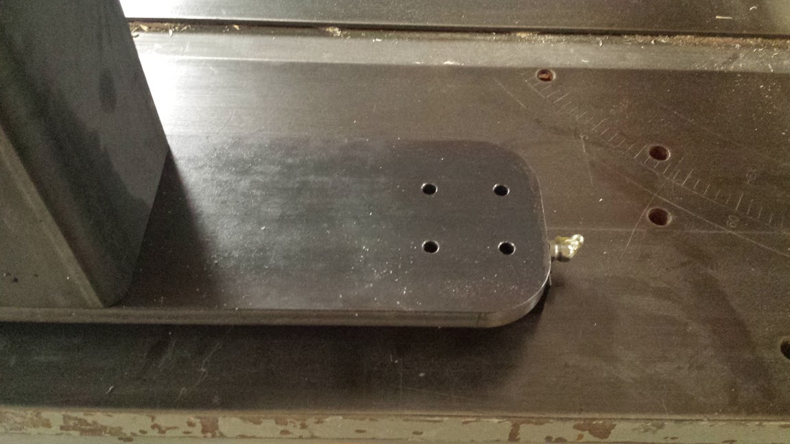

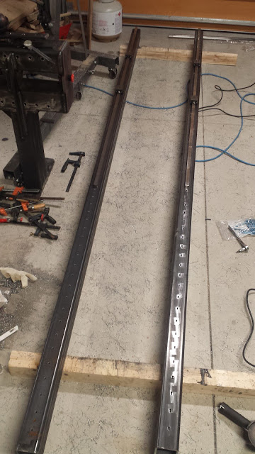

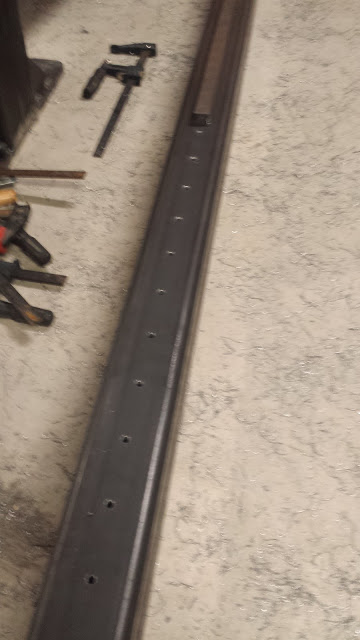

    Got the X axis steel drilled these needed to be through drilled as well since the linear rails are bolted from the back. 244 holes!!!!

    Any help with servos for this size of gantry is greatly appreciated.

    I don't have any experience of the 4/5 axis machines but i would imagine that the "A" axis you are trying to emulate would be a wheel & pinion mechanism.

    Ok, lets start from the beginning. I will try to resume some things, you just need to further research the topics:
    1. You should absolutely know what weight your gantry is with all things mounted. Knowing the mass of the gantry will be decisive on what motors, what size ball screw, rotating nut, Rack and pinion, etc..
    2. Be realistic about the feeds and speeds. And what you really need the machine for. All in one would be usually a disaster in some area.
    3. Motor sizing. People drive 3nm nema 23 motors at 70VDC. And we are talking low inductance motors. Expected reliable performance from such motors coupled with xx10 ball screws is 10000mm/min. The motors you have are high inductance motors. I am not a specialist here but there are a lot of knowledgeable people here that will tell you at what voltage, but i am sure that it must be more than 110VDC. Do your research and find at what voltage these motors perform well. And if these drives will be ok.
    4.Without knowing the total weight of the gantry... but i see you start ambitious, so yes, you will need servos to drive the gantry reliably fast if you aim at 25000mm/min. And you will need rotating ball nut or rack and pinion
    5. There is a very well made calculator at the forum here, search for it, and i am sure that the gantry legs deflection will not be as you say...but may be i am wrong
    I dont want to discourage you, but i am having the feeling that if you continue without thinking it too much, there will be disappointments on the way. WHY JUST DONT YOU SLOW A BIT AND READ MORE BUILD LOGS. All the info is there.

    I fully agree, legs has to be revised.
