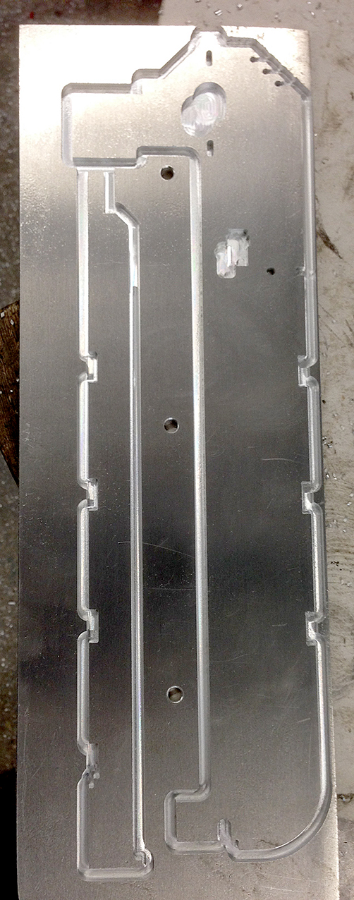

This is the first job - pretty complex but what better way to learn;)

It's from 5mm 6061 Aluminium, has plenty of 3mm holes, slots, square features, its about 320mm long.
So far I am looking at using a 2mm carbide 2-flute cutter, mist coolant, I have figured out how to get sharp corners, also how to spiral-down to cut the holes.
Questions -
1 - I have used a calculator for feeds and got 24,000rpm, 487mm/min feed, 1mm DOC, these seem reasonable?
2 - I am unsure of DOC - this is input rather than output on the feed calculator - how do you know how much bite to take at one pass?
3 - Holding tabs to keep it together on the outside cuts, I'm guessing three or four, 0.5mm thick or less?
4 - Use the one cutter and go straight to dimension or split and do a roughing & finish passes?
5 - Use a bigger cutter for the roughing outside then switch to the 2mm for the finish?
6 - Features like the oval hole - leave it to fall out or use tabs again?
Any suggestions appreciated, I realise this is fairly adventurous but I would like to get these made in-house to increase my profit margin considerably ;)
