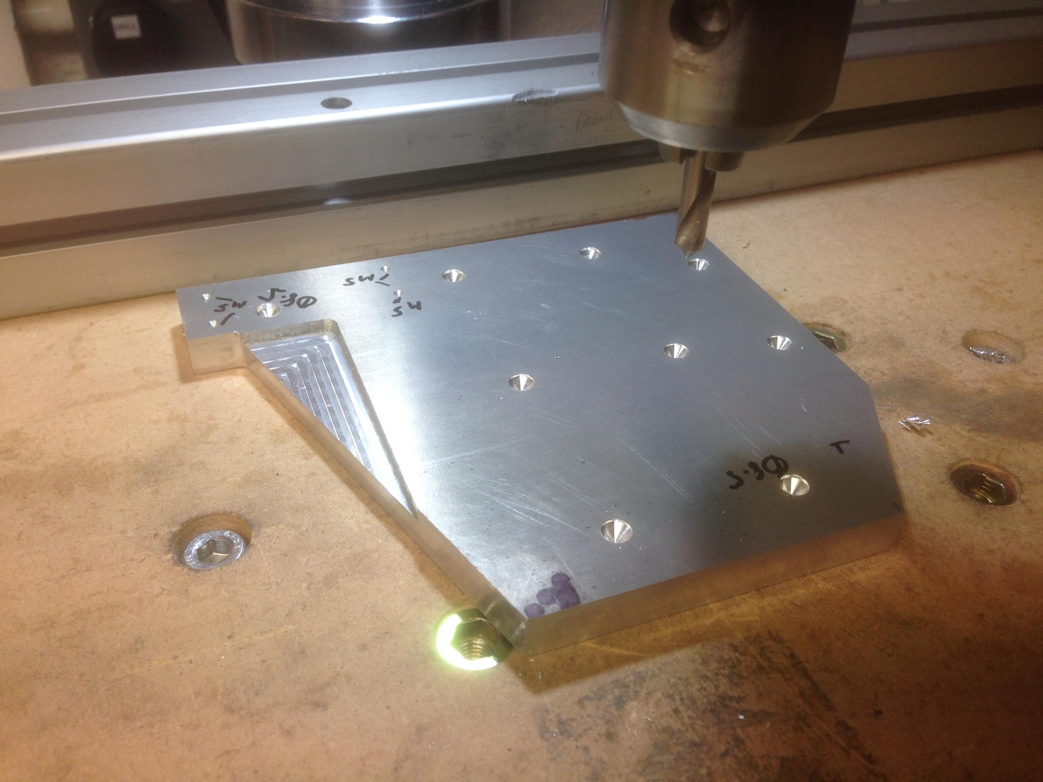

    Made it's first full-job :)
    Yes, I know it's a failed part - i lost a cutter due to it hitting a hold-down bolt caused by my messing with the CAM so much I forgot which file was which I didn't want to add wasted metal to a wasted cutter so i reset the file and cut the next run over the first one.

    Onion-skin was perfect, too thick and hard to remove at 0.15mm but i did manage to take the job right through all the post-finish drilling, counter-sinking and fettling just to prove the process.

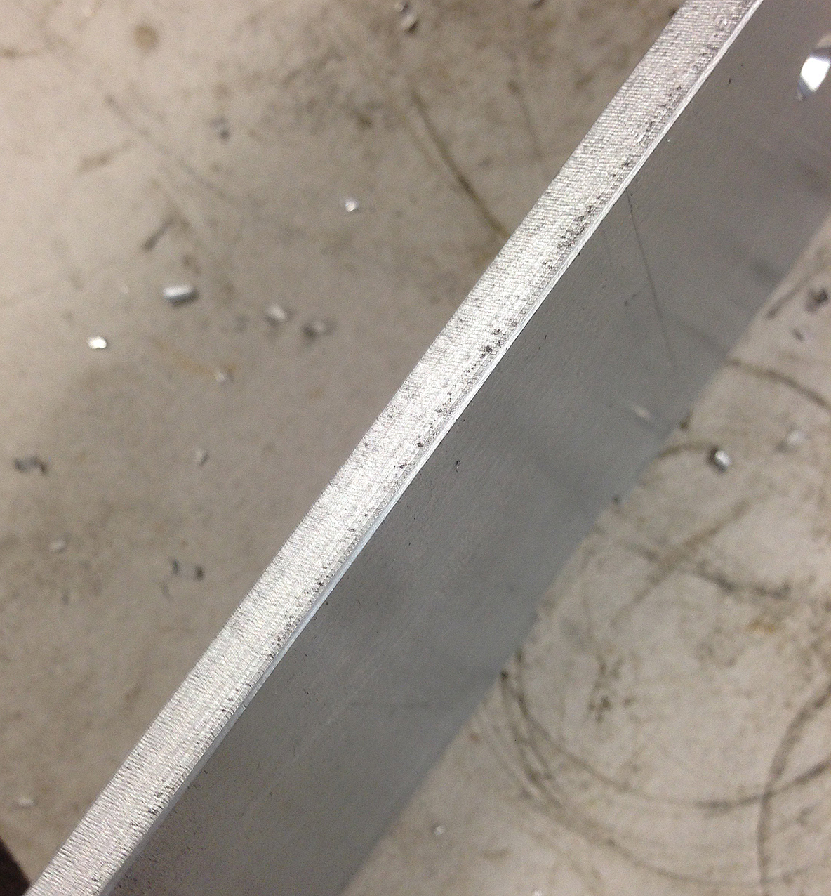

    OK, education time...
    Poor quality on the finish passes, 2mm single-flute cutter, 0.6mm DOC, 450mm/min cut, 23,000rpm - chatter I think.
    How to improve?? It looked better on the roughing cut ;)

    Job took 43 minutes including tool-change, mostly the delicate finish cuts, I will look at these a bit more as something is off a little there I think.
    Any pointers?
    On the next run I'm going to take the skin down by 0.05mm and also put a sheet of paper or card under so I take the fine detail - holes and slots, down to 100% depth.

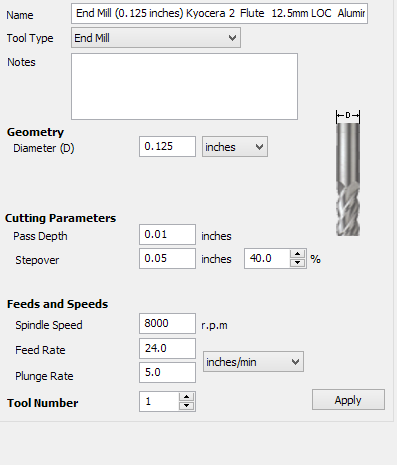

    The pointers: i said it many times, and most disagreed. For perfect aluminum finish if the machine is normal, that combo gives me the best finish. I don't care about 12k rpm or 30 krpm. That combo for 3mm bits gives me best finish. On the yellow machine i could cut at 12krpm and 2500mm min at 1mm deep with 1/4 bit. But best perfect finish is around 600mm min/ hence 25 ipm/

    Those settings are not far off where i was, I was a little slower feed and faster rpm, that may make a difference, don't forget there is a fair bit difference between a 1/8" and 2mm tool.
    Thoughts over dinner...
    1 - Make the final pass on the main parts with the 5mm cutter then isolate the small features and machine only those bits with the 2mm tool?
    2 - Try the final pass with the 2mm at full depth but add a slow-down in the corners where it's biting the rads from the 5mm tool?
    3 - something else?

    On the finish pass question - I don't often use small cutters so don't know what the problem is. But 0.6mm DOC seems small for the finish pass ?
    I generally use 6mm cutters and for finishing I leave 0.1mm roughing on the part - how much are you leaving?. Then I cut at 3mm DOC as this works well but I could probably do anything up to 10mm DOC as you're hardly removing any material on the finish.

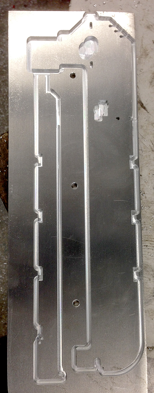

    On the part in the OP, there is a little square notch, first from the left along the top edge, it's about 4mm square and as such was not roughed out by the 5mm tool on the first pass. I set the code for a 2.5mm deep cut on the finishing pass with the 2mm tool and added a reduction to feed with CAM rules, it worked nicely until the tool reached that notch when it died.
    I then increased the before and after feed change in CAM so the rate slowed well before and after the notch - ping went another tool. I then reverted back to 0.6mm per pass and 450mm/min rate as before and it sailed through. Still got that slightly poor surface finish though.
    So, it seems despite what HSM says, even on severely reduced settings, you cannot slot 2.5mm deep with a 2mm tool.
