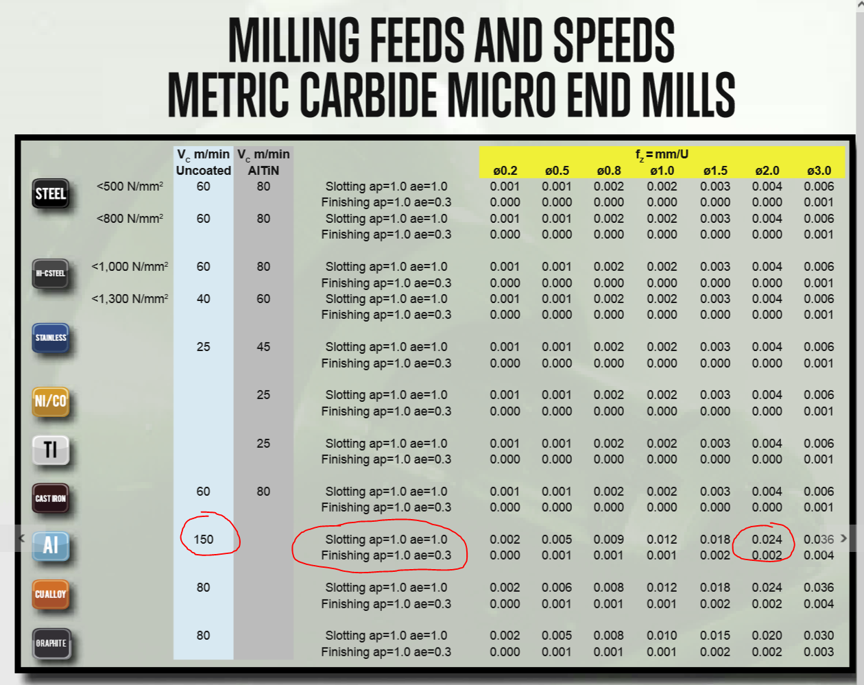

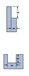

Name:	micro carbide  feeds and speeds.PNG
Name:	mm milling 3.PNG
    This is Kyocera carbide micro bits feed and speed chart. They are definitely one of the sharpest and overall best bits around. So if you are using inferior -30% at least on all data.
    Vc - cutting speed
    f - chip load or feed per tooth
    Fr- feed rate mm/min
    D- diameter of carbide bit
    U- number of teeth on cutter
    p=3.14
    Ae - side removal
    Ap - face removal
    1.
    determine spindle speed rpm/min depending an operation/roughing, slotting, finishing/
    RPM=(Vc*1000)/(p*D)
    so
    RPM=(150*1000)/(3.14*2)=~24k RPM, so you are spot on here
    2.
    Calculate feed rate mm/min:
    Fr=f*U*RPM
    so
    Fr =0.024*2*24000=1152mm/min for slotting
    =0.002*2*24000=96mm/min for finishing
    That all on a mill with very good cooling and chip removal. Diameter depth and 30% tool engagement
    So if you play with the second formula you could easily see why you can no make a nice finishing pass. cause for 800mm/min feed you will need to have the spindle at 8000rpm, not 24000.
    Now lower some percent that you ar not cutting on a mill with jet cooling the bit...
    And bear in mind that the first speed calc is most probably for roughing bit, because that's how typically is done, that's why seems so fast.
    From my experience there is no big science here, i have tested cuts on various machines and the only thing that really differs is the depth of cut that could be achieved with a particular machine.
    project 1 , 2, Dust Shoe ...
  8. #107
    Thanks Boyan, all I do is plug the manufacturers cutter specs into HSM Advisor, set the cut details and move the feed rate to 30%.
    I was not feeding at 800mm/min, don't forget my tools are only single flute.
    The cut is a tricky one though as the corners are more like slotting and the rest is plain finishing so a mix of heavy and light cuts.
  9. #108
    If my understanding is better, after a good chat with the guy that supports HSM Advisor, it seems I might be a bit over zealous with the settings?
    Plugging numbers again, I get for the 2mm tool, 18,500 rpm, 1,200 mm/min feed, 0.5mm DOC and 0.065mm/t chip load.
    Reasoning - the limiting factors are the larger rads in the sharpened corners - this becomes slotting - also the manufacturers chip load limit of 0.065mm/t was set to not be exceeded, that gave DOC as 0.506mm as part of a balanced result to meet those factors.
    So my earlier run was 0.6mm - too deep, 23,000rpm - to fast, 450mm/min - too slow. It survived but took a long time and gave poor surface finish.
    The tool cannot give a 2.5mm DOC with any setting due to the slotting factor - the tool exceeds 100% torque limits = snapping - this backs up what really happened when i tried it.
    So it seems lighter, faster is a way forwards, might risk a tool and try it I think. Its more passes but travelling at 3 x the speed so should still be quicker.

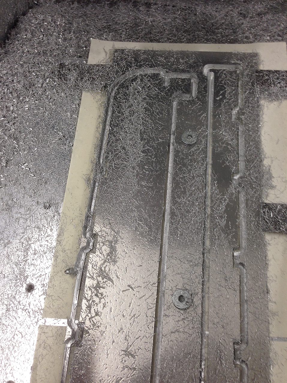

  10. #109
    RESULT !
    Had a bit of time off work today so out in the shop :)
    The new cut parameters seem to be perfect so far, the 5mm roughing cuts seem a bit off as i was seeing some chip-welding to the sides of the cut, this was at 2.5mmDOC an 1350mm/min @ 24000rpm, this was with coolant as well so its a bit wrong somewhere there, not sure if too much rpm, too much feed or something else, manuf states max rpm is 12000 so maybe i need to retune at that speed?
    I made several alterations to the CAM and CAD by way of pre-finishing the sharp corners with the 2mm tool - this works great, then the final pass with the 2mm at 24000rpm 5mm DOC, 0.1mm WOC and 244mm/min feed spat out lovely little shards of swarf and not dust. Surface finish is now 100% quality.
    The CAD/CAM changes also reduced my part time from 45mins+ to 20mins which is a considerable change, that includes tool change but not plate setting and bed clean-up.
    Pictures later.

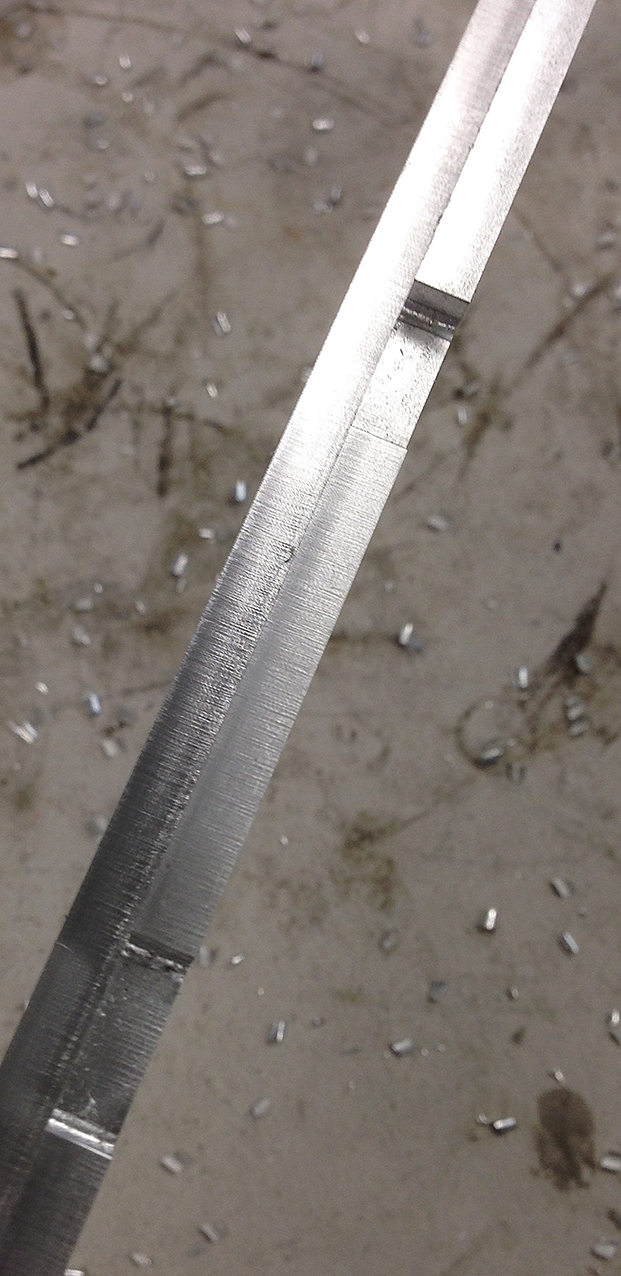

  11. #110
    The 5mm cutter runs cleaner at 18000rpm and 1000mm/min. :)
    Edge finish...
    Nice pile of swarf...
    I had the onion-skin set a little too tight and had to hold the parts in for part of the finish cut but that's easily fixed.
