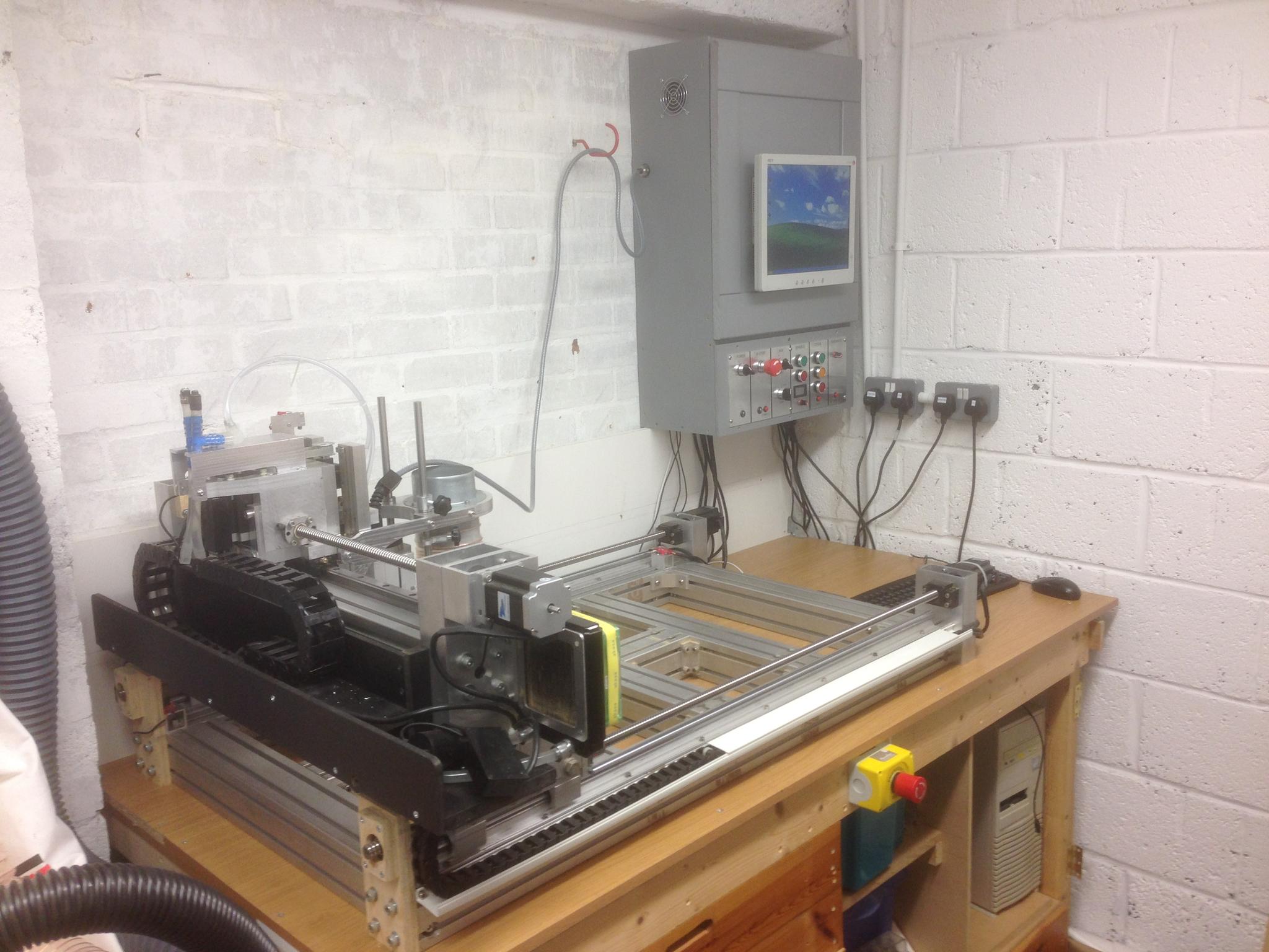

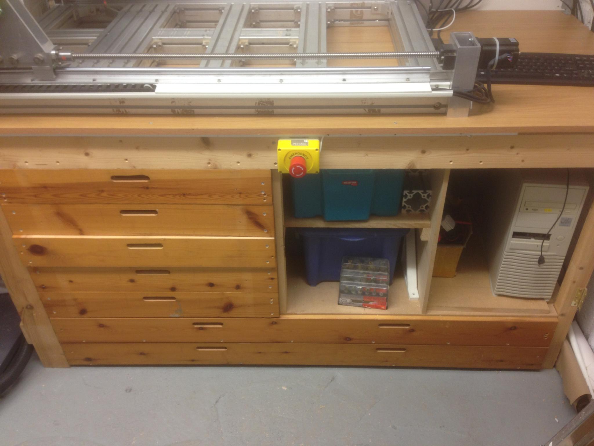

    More questions, anyone care to put pics up of their whole setup?
    I'm looking to find a home for the damn keyboard, monitor and mouse - this lot seems to take up more space than the machine! The keyboard and monitor are also suffering under the shower of chips ;)
  7. #156
    Nice, way too clean and tidy ;)
    Wall mounted monitor is good, the keyboard and mouse is sort of where mine is but the chips get flung for about a 4 foot radius when cutting so i have to cover the KB up every time i press start!
    I need to move it to a better location really but space is tight, or poorly arranged, or both ;)
    Too much in one room really, it's 5.2m x 4.2m - CNC plasma, CNC milling, manual milling, pillar drill, lathe, power-coating station and oven, bench, pedestal grinder/buffing, Mig welder and bench, 20T press, bandsaw, metal storage, probably more....

  9. #158
    As a move in the right direction, i have fitted some bracketry and mounted the monitor up high out of the chip path, the brackets stem from the main table frame which is 44x44 structural aluminium, makes it easy to bolt bits on ;)
    I also did a facing cut on the bed, here's a video of a bit of it...
    https://youtu.be/PSkSn_s8xF8
    It was with a 12mm indexable carbide tool at 21000 rpm and 2300mm/min feed, DOC was 0.15mm, just enough to get a cut off the whole face.
    The results show the head is a tiny bit off-tram but until i get a decent setup for adjusting it I think it best left where it is, using a DTI it seems the slight ripples made by the tool are about 0.01mm high at the peak,not bad i think as the head was just as i bolted it on!
    All things being equal, the results from now on should be 'as good as it gets' for a while at least.
