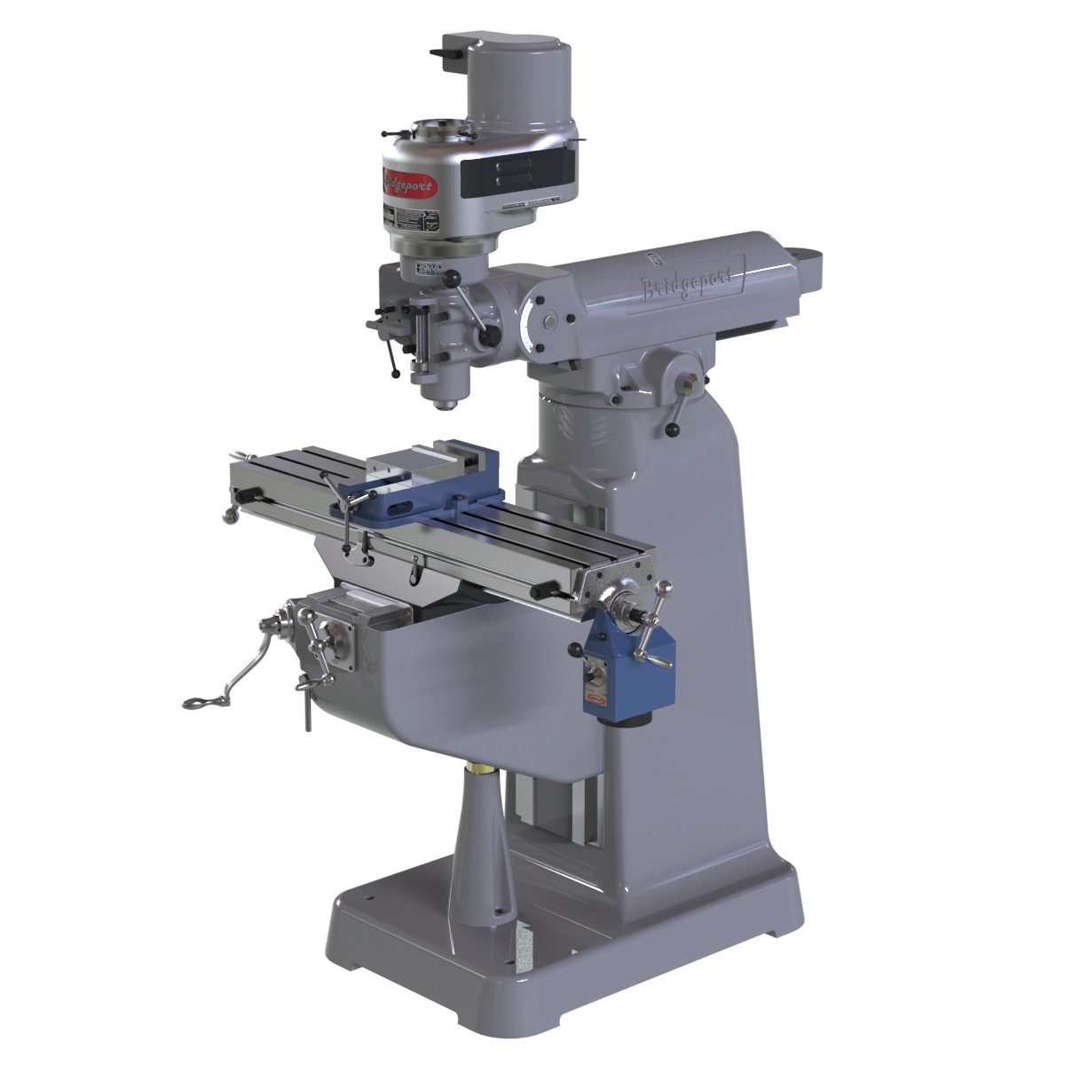

    As some may have read, I am converting my Bridgeport mill to CNC, the idea is to attache the high speed spindle to it to make a dual purpose machine.
    Seems I have a couple of options here - mount the spindle motor to the main mill quill or make a new Z axis complete and mount that to the head of the Bridgeport.
    Mounting the spindle to the quill is easiest - a simple clamp block would do it...
    The larger circle is the mill quill or Z axis (around 100mm dia), smaller is the 24k spindle (80mm dia), looking down from above. The distance between the two is 50mm and the clamp could be machined from 30-40mm thick aluminium or similar.
    Would it work though??
    Your thoughts...
    Second option is far more involved and needs a mounting bracket and complete Z axis making to take the 24k spindle, this assembly would mount on the rear of the swivel ram (at the back in this picture)...
    Would be harder to make but still do-able but if the first idea worked the much time and cash will be saved ;)
    Thoughts??

    I'd come of the quill to save grief. Chances are you'll only use small tooling anyway so no great stress.

    It's all about flexibility - the mill itself has 2Hp and 50-3000rpm range - no good for small cutters or engraving, great for hogging the crap out of steel etc with large tooling. The spindle has the speed for small cutters and engraving but no good for big tooling or steel work. The Base machine is simply a very heavy X/Y table - 300mm in Y and 1000mm in X - way bigger than my mini-mill.
    That's my view too, I have 125mm of Z axis movement and losing 30-40mm for the clamp won't hurt as there is also a manual 300mm of table up/down - no engraving spindle is going to be diving more than 80mm into the work so travel seems adequate even allowing for clearance plane above clamps etc.
    This is also the easy option to test out - only wastes a block of aluminium if it fails, my point of weakness would likely be vibration causing chatter marks, but time will tell here.
