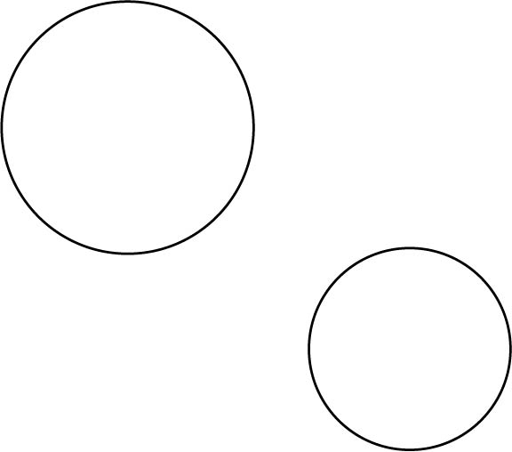

    The clamp block for holding the spindle to the mill, better made out of one big lump or two plates maybe 12mm thick spaced apart 10mm or so?
    My choice would be a single lump or to space them out more if it's for a typical water cooled spindle, 12's a bit thin in my book.
