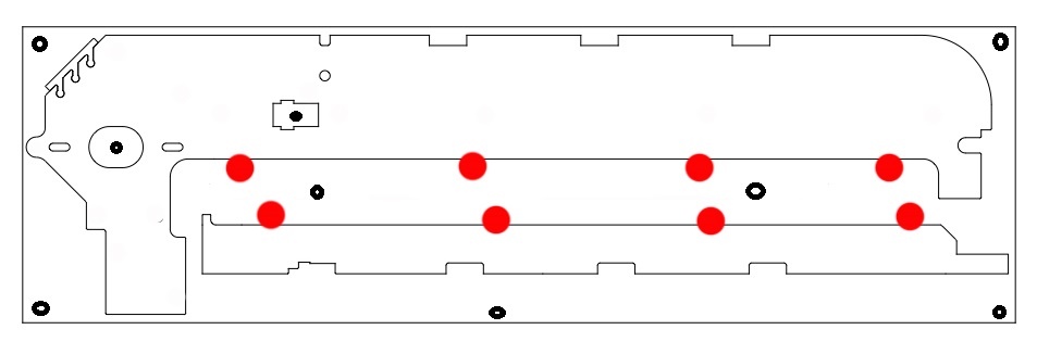

    Dave this what I meant when said Aluminium bed is Ok but often you'll have Spoil board on it. So here's what I would do.
    Fit spoil board that can be screwed into and surface it. Then I would change the Code and move the smaller part in wards and drill holes put screws where I have black circles on your last pick.
    Then onion skin the both parts with about 0.3mm. Doesn't matter the large part will not be held down one side the rest will old it.
    The skin then just breaks away and quick cleanup with De-burr sorts what's left.
    I do this type thing all the time in shity 1050 2mm plate and works perfectly.

  3. #73
    Points noted Boyan, BTW the coolant is working nicely - the cutter was clear even during the heavy cuts.
    Jazz, the two screws in the small cutouts - they would be fitted after the finish pass on this features?
    Spoilboard - MDF?
    What sort/size for facing cutters?
  4. #74
    Spoilboard - MDF?
    Yes screws with washers in cut outs after finish pass on pockets.
    MDF, ply anything that can screw into really.
    Facing cutter then widest you have but with such small piece then wouldn't take long if small.
  6. #75
    Actually to be honest dave if spoil board is resonably flat then just for this job won't even need surfacing because your only profiling. The main reason I said surface is because 0.3mm isn't much so can easily cut thru if not flat but if you want to have thicker skin then don't bother with surfacing.
