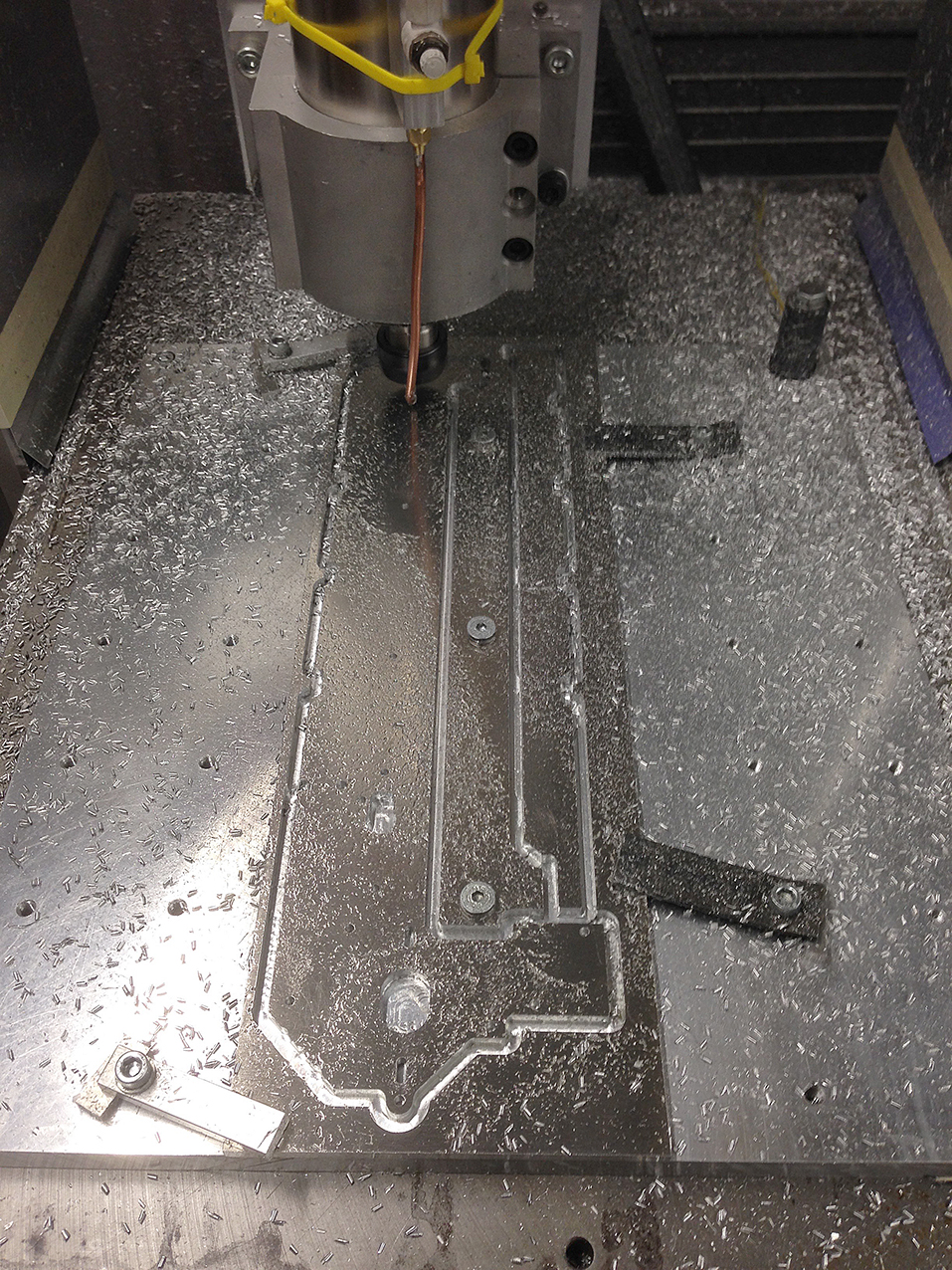

    Hmm, back to school, two issues tonight.
    Offsets, seems i have not grasped it yet or I am in the wrong work sequence...
    Yesterday I saved the work offsets for my production job - G55, I also added G55 to the start of the code. I then loaded up the material, changed the tool & set my top-of-material Z zero. Pressed cycle-start and got Soft-Limits warning on Z, looking at the numbers on the DRO's I could see something was wrong.
    I deleted the the G55 from the code, switched to G54 Offset, reset my tool zero just in case, set work X&Y zero as normal, and ran the job as before.
    So, not sure what i am doing wrong but clearly offsets do not work totally how I envisaged them to work. Do you have to be in the correct offset BEFORE setting the tool and Z zero?? If yes then that was likely mistake No1 as I was in default G54 when I set the tool. What I expected was for the offset to only affect X & Y not Z (i think)
    Z Zero, again.
    yesterday the job cut perfectly, onion skin just about held it together and a nice part came out. Tonight, same file, onion skin failed as the tool chewed the bed by about 0.1mm or a bit less - this meant the part got 90% of the way and failed on the finish pass, luckily the cutter survived but the part was toast and now resides in the scrap bin.
    So, I have two issues here, top-of-material setting and work-holding.
    Here is the part before it went flying to the bin in a red-mist
    Now, after cooling down, I miked the metal up and it seems the thickness is not very reliable, the 7 bits i have left ranging from 5.05mm to 5.25mm depending where you measure it - I think this accounts for the failed onion-skinning and subsequent junk output.
    My first resolution to this is to mark a spot with a sharpie, measure it, note it, CAM the part specifically for that thickness, set the tool zero exactly on the sharpie mark and try again - I do not think this is a machine error, more a material error.
    Work-holding, these parts must be 100% flat and clean, if I tried adding some carpet tape etc under it, would I be able to get the part off the bed when cut?

    If this is a regular job I cannot see why you do not create a jig waste board to hold material in a recess with appropriate hold downs permenantly in place so 4 nuts or so to lock jig onto bed, material in recess and locking tabs clamps (cheap chinese 120kg hold downs or similar you could have a couple to swing in after finishing pass goes by if needed and cut clean threough each time) to hold material off you go, no more biting into the bed, cutting through not going to matter occasionally one out quick vacuum next one one in, seems to me a lot of wheels being reinvented.

    On my website, there are some modified macros that will zero the Z axis for all of the G54-G59 offsets at once, regardless of which one you are currently in.
    As for material thickness, there's another option in the 2010 Screenset called "Material Offset". When checked, you zero the Z axis to the table, and Z zero is set at the material thickness value above the table. It's works basically the same as setting Z zero to the bottom of your material. If you are doing pockets, note that this will affect the pocket depth if the material thickness varies.
