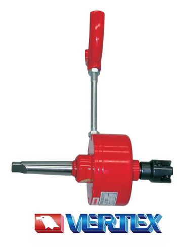

    Cheapest i found are the Soba, then slightly more expensive the red Vertex and then even more expensive the silver Vertex ones. /Chronox web site/
    Any thoughts on that? Somebody have one of these? Do they work well? Of course i will be using brand machine taps and use the attachment on the mini mill.

    The red vertex is for drill presses and is pretty long, I have varying degree of success in using it on my knee mill. You will need to drop the speed to around 100rpm and use machine taps with a spiral flute. To get it to reveres you really need to yank the quill back.
    The soba looks interesting in that it has a double speed reverse.
    https://emvioeng.com
    So they are long. I have not considered this. Unfortunately the mill is MT1 shank and all of these are at least MT2, so either i use adapter/ even longer/ or i take out the shank and figure to make MT1 for it

    What the misplaced bit means it's that it can allow the tap to float radially to account for you not having the spindle directly above the hole. The perpendicularity of the thread is governed by you drill press or mill being in tram.

    I use my red vertex if I have a lot of large holes to tap, it adds about eight inches plus tooling under the quill and the reverse isn't very sensitive, I use it on a floor standing mill drill that's bigger than me so clearance, sensitivity and power aren't issues.

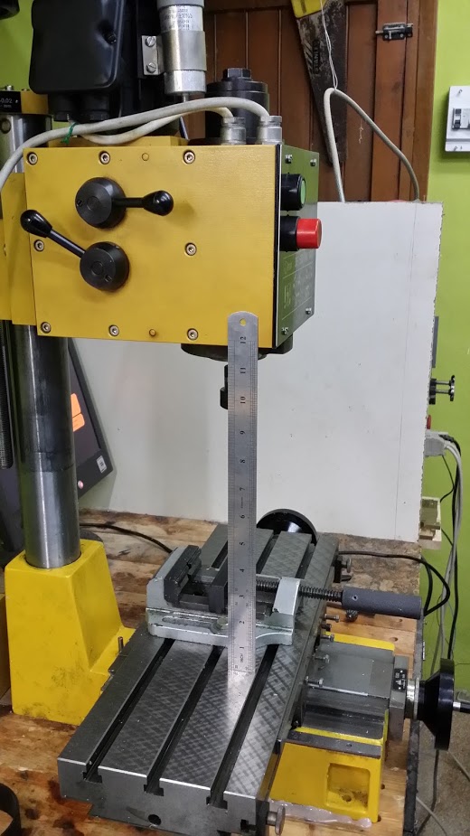

    Next seems the BFE is too short for that attachments:

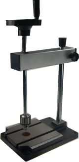

    or make from this/the one on right on first photo/ something like the tapping fixture on second photo and power it by my cordless driver and use its clutch against tapp breakage. that seems to be the fastest way to tap correctly, as i can speed the driver on exit just using the trigger and can change direction for a second

    the tapping fixture you show, last one, is really handy for making good threaded holes. I have one and prefer it for small parts than the autoreverse tool
