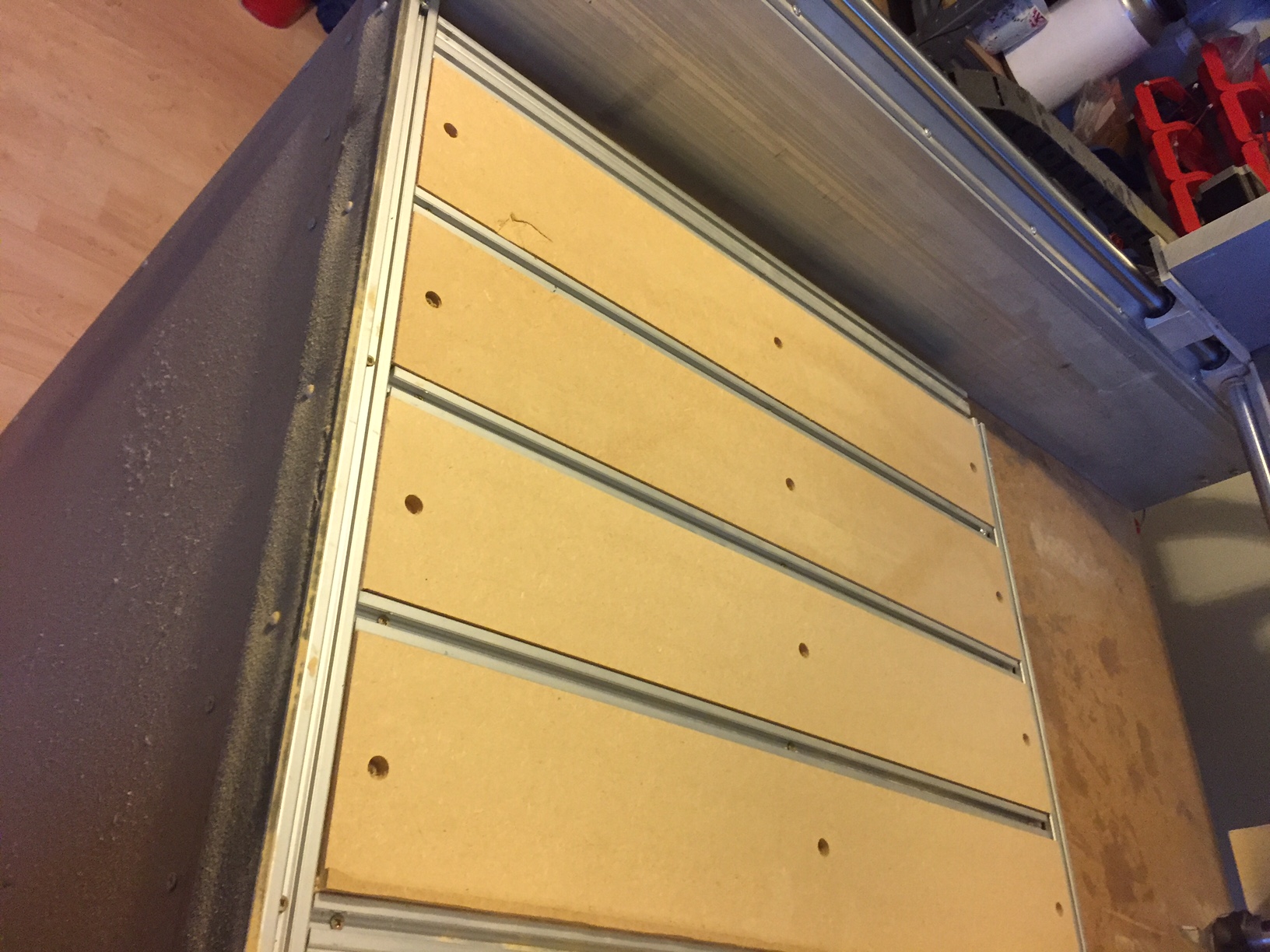

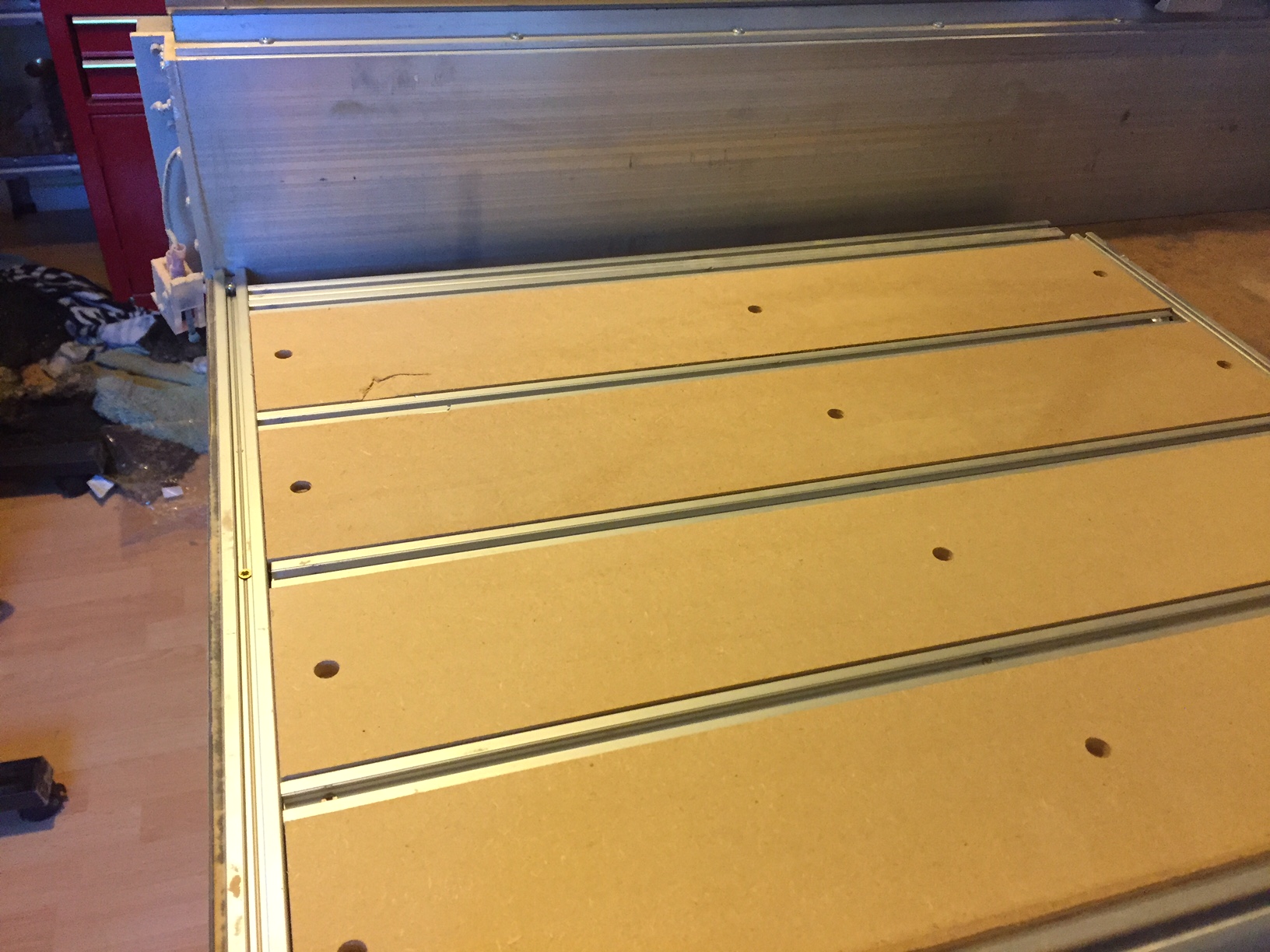

    And award for plonker of the week goes to ME!! rushed back so I could skim the bed before it got too late, I had trammed it in on an old offcut of ply last night. Set it up to face at 1.5mm DOC at 1.5mpm 6000rpm and it glided around leaving a nice clean finish, straight edge and a CREE to check and a blind man would have been glad to see it. Who decides wants to play some more and take just 0.2 to see how it goes, fired up the spindle and thought I would try the new hand control thats sat here for a week, DAMN straight down and 1mm ding in the freshly skimmed bed, well it can stay as it is for now until I feck it up again!!! Anyway have to remove the grease nipple on bottom Z axis bearing to skim it as it holds just off the edge.
