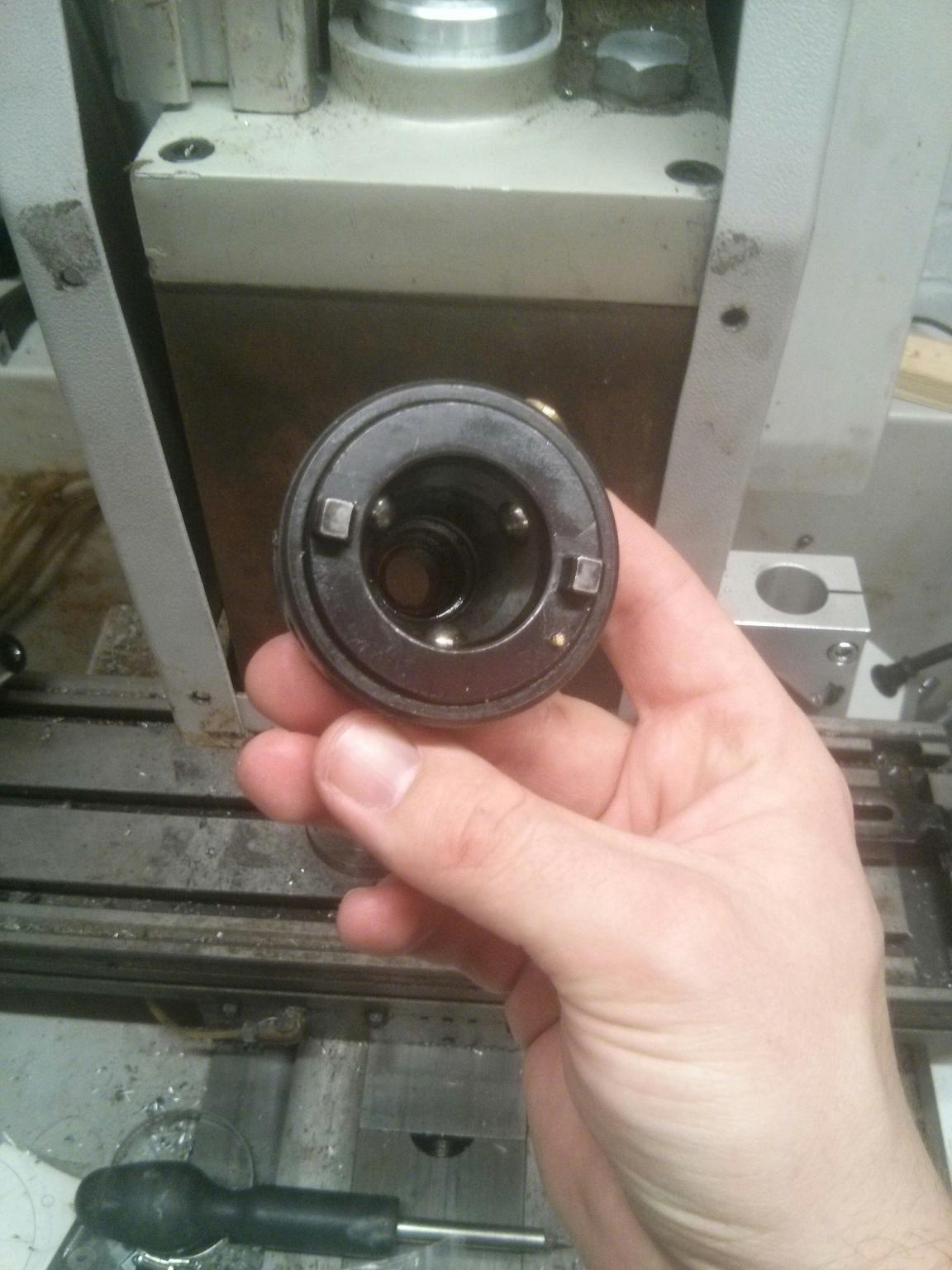

    Here you go. The spindle block is enclosed, with all bearings and pulleys concealed. At the top there is only an 18mm diameter shaft protruding. Ignore the bit of aluminium extrusion, it's just a temporary mount for a spindle speed sensor.

    Here is the easychange chuck. To secure it you push a bolt from below, through the hole in the narrow end of the chuck and into a thread on the spindle. (see original post)

    Here is one of the easychange toolholders:

    It's the Coventry Easy Change system, I have the same on my bench top CNC mill, it locks up nice and tight and works very well, check all the internal and external tapers for damage.

    Is it just the light/reflections, or is the taper on that toolholder look like somebody's sanded/filed it?
    I've got the easy change system on bench top mill, and my holders all lock in that tight, I usually have to use a screwdriver to break them away from the taper to get them out.
    Could it be the ratchet mechanisms not working correctly?
    I'd perhaps give Coventry a phone, and see what they say. It could be as simple as the spindle adapter needing stripped and cleaned, although I have no idea how they separate.

    OK, thanks guys. I'll give it all a good clean and check over before doing anything drastic. Maybe the locking mechanism just has some swarf in in.
    If you mean the toolholder with the threaded stud at the top. It looks rough because I've just rough turned it to check the principle. I was intending to grind and harden the taper before using it in anger.
