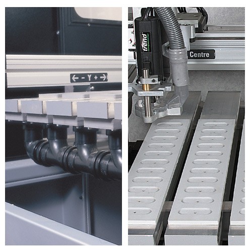

    mine has a vacbed the waste board according to the instruction book is made out of normal 6mm mdf, no metion of porus mdf,
    its cut to the right size then theres a program to cut the holes in the right places, this is then attached to the vacbed with a few bits of double sided tape to secure it,
    the work piece is put on the bed, and any surplus holes coverd with off cuts to get a better hold,
