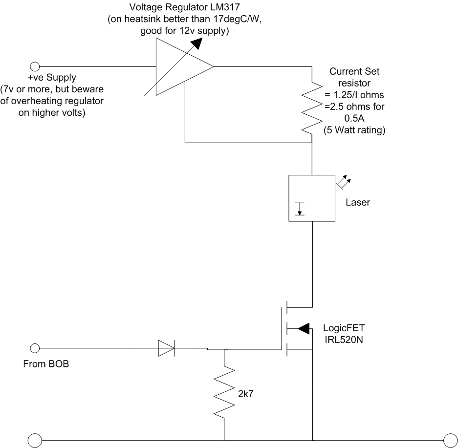

    Theres a load of waffle in this post - what it really boils down to is "what's a good way for a BOB signal to switch 12v DC, 500mA power"?
    I've got one of those 250mW LASER modules. I've soldered up the constant-current supply circuit, fed it some electric from a 12v wall-wart transformer, and got a nice shiny red line coming out the front of the LASER. Lovely.
    But what I'd like to do is to be able to turn it on and off really quickly, so I can draw dots and lines etc.
    I'm pretty quick at flicking a power switch on a 13A mains socket, but not *that* quick. :heehee:
    I use an SSR to control my proxxon mini-drill from the computer (EMC2), which works very nicely. But when I use the same method to control the LASER, the beam takes a while to switch off. About half a second. It's the capacitor in the wall wart doing its best to smooth the power.
    So I've then tried using a FET. But I'm no electronic whizz. I can read a circuit diagram, but I'm lost when it comes anything remotely tricky.
    It's a little 2.7A power MOSFET. I've used them before to control a 1A LED from a microprocessor, so I thought this would be a doddle.
    The Gate is connected to the logic pin from the BOB.
    The Sink is connected to ground, and the 12v LASER circuit connects between Drain and 12v.
    But the LASER stays on constantly.

  2. Keith,
    To switch a FET on the gate voltage needs to rise above the sink by at least 1 or 2 volts or so, but no more than the Vgs(max) parameter of the device but a lesser known fact is that at very low drain-source currents (<0.2A) it can turn on sufficiently at a gate voltage as little as 1v.
    It would help to know what FET you are using but if you are using devices such as the IRL520N you may find you can't turn the FET off sufficiently.
    The attached shows a circuit that should work...

    Thank you - the diagram is really useful.
    The FET I'm using is an FDN359AN - a fiddly surface mount thing.
    The Vgs max is +-20v, which looks fine.
    The gate threshold for switch-on is 3v max, 1.6v typical.
    The circuit I've used is *very* similar to the one you show - An LM317 rigged as a current regulator.
    What I don't have though, is the diode into the Gate of the FET, or the resistor down to ground.
    *Numpty question*
    Are they important?
    (I'm not sure if this changes anything, but I ought to admit that it's not a straightforward BOB it's connected to. It's a CRH Electronics 'System 3+' driver board. Reading the instruction manual, it says that the output I'm connecting to the FET is 'buffered and capable of driving up to 30mA')
    Keith.
  4. the diode/resistor is to allow gate charge to drain away and allow the FET to turn off fully. A buffered logic output *should* pull down hard enough to do so, but I have experience of them not doing so...
    If you have a test meter, what is the voltage swing at the gate? If you disconnect the BOB does the laser go off? It could be a dodgy FET of course... or reversed so the source-drain diode is conducting... (I know you've probably checked that, but I've lost count of the number of times I have checked and doubled checked and *still* managed to get it back to front!)

    A FET is charge driven not voltage driven, the gate is a capacitor. The FET turns on when the gate charge exceeds a specific amount and off when that charge is depleted below a certain limit. Charge = current x time so to turn the FET on you need to pump enough charge in which means charging the gate capacitor. The datasheets helpfully give the charge required, in this case about 3.5 nanoCoulumb (nC) which means a pulse of about 1uS and 3.5mA will turn it on, and similarly a 3.5mA current should turn it off in about the same time. The actual gate voltage is not critical, its only needed to drive sufficient current into the gate capacitor and to maintain the charge as it leaks away.
    Long and short of it is that a Bob output, buffered or not, should easily be able to drive and sink sufficient current to turn the FET on or off.

    I've then soldered the FET back into the circuit, and added the diode and 2k7 resistor to the gate for good measure.
    Still no joy. LEDs light all the time. :sad:
    The LEDs/LASER circuit draws 180mA (I've got it 'turned down' while I'm testing) whatever the BOB outputs. That's the same as it was drawing when I plugged the LED circuit straight into the 12v supply, without this FET switching malarkey.
