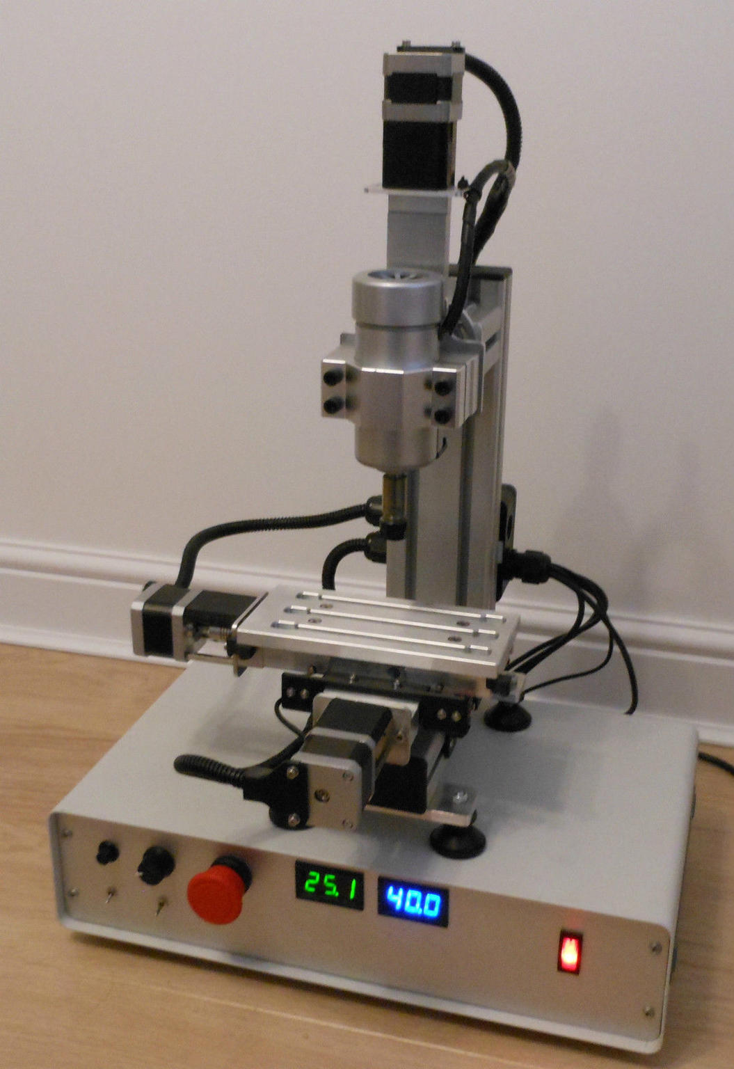

    A couple of months on and I totally changed my plans lol, partly thanks to this thread but partly, because I
    knew it would be a steep curve to learn all the skills to even run a cnc. so I bought thisClick image for larger version.

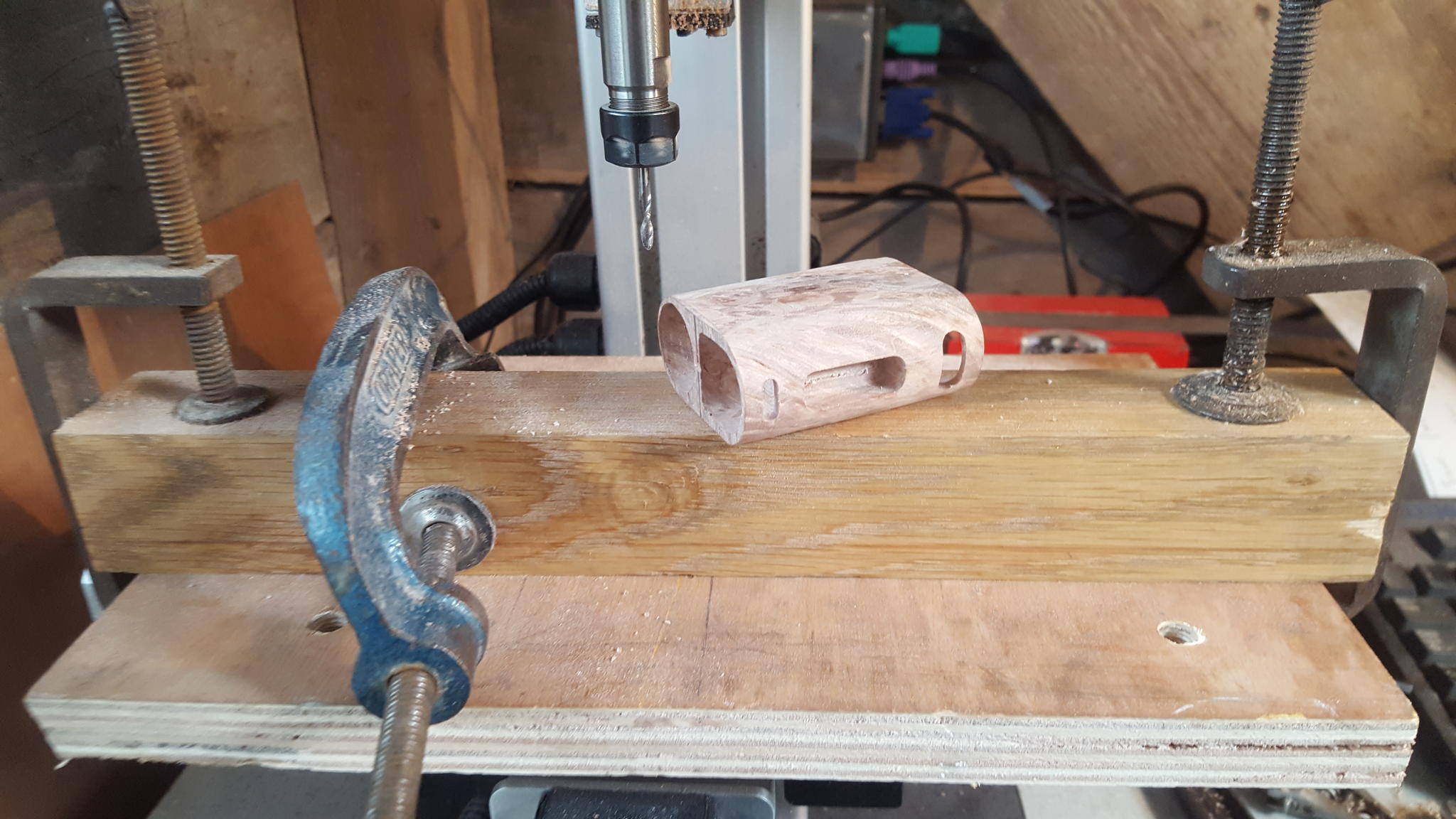

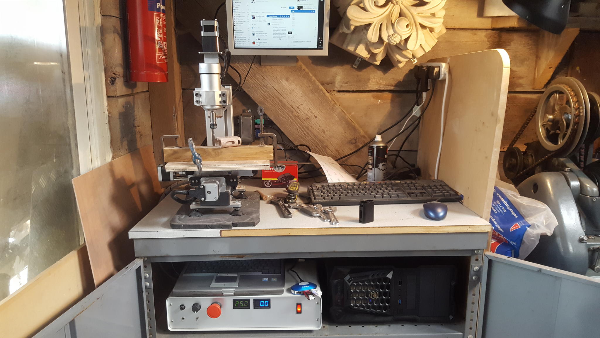

    Basically just to get going. It cost less than a Proxxon micro mill and runs on LG motion slides. Ive got it running on EM2 using Fusion 360 for the post process, so i'm happy for now... looking longer term to pick up a converted X3 or x2 but still open to suggestions. very much enjoying my first steps into the the world of CNC :D
