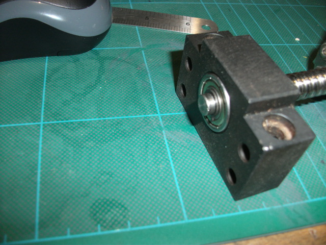

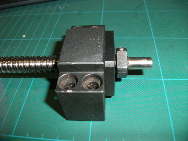

    It looks to me that the leadscrew for the Z axis is not clamped at one end (it should be floating in one bearing and fixed in the other)
    Here's a a couple of photos to show what I mean.
ID:	18223Click image for larger version.
    It looks as though your machine is using the stepper motor to 'fix' the Z screw. However the type of coupling you are using negates this option.
    It is bad design to use the thrust bearings in a stepper and you should post some pictures of the leadscrew bearings at each end for us to check this out.
    The 'Oldham' coupler you have is not designed to resist being pulled apart, which is what is happening and the whole leadscrew is slipping downwards.

    Nick, I think it is the leadscrew bearings that are design deficient.
    Rob

    As Rob suggests I think you have a problem with the bearing holding the screw in position the motor should certainly not be doing that job. It will further damage your machine without sorting this problem out.
    Take the motor off and see if you can check for end float in the screw
    Rob
    Rob,
    probably so, my response was to the fault as described, before photos were added.
    Having watched the video there seems to be a glaring absence of end-float bearings on the ballscrew, unless you count the screw the coupling rubs against ;-)

    It isn't end float. More like end sink. That has got more slop in it than an old Beetle crankshaft. I would bet that there is no fixed bearing at all.
    Nick - I agree with you the OP was confusing us talking about the Z Motor.
