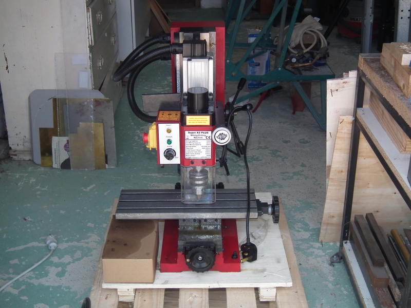

    My new mill arrived last week. TNT did a good job of getting it from Leicester to Montpellier (South of France) in 40 hours but it then took them 6 days to get it the last hundred miles. However, it arrived in good condition.

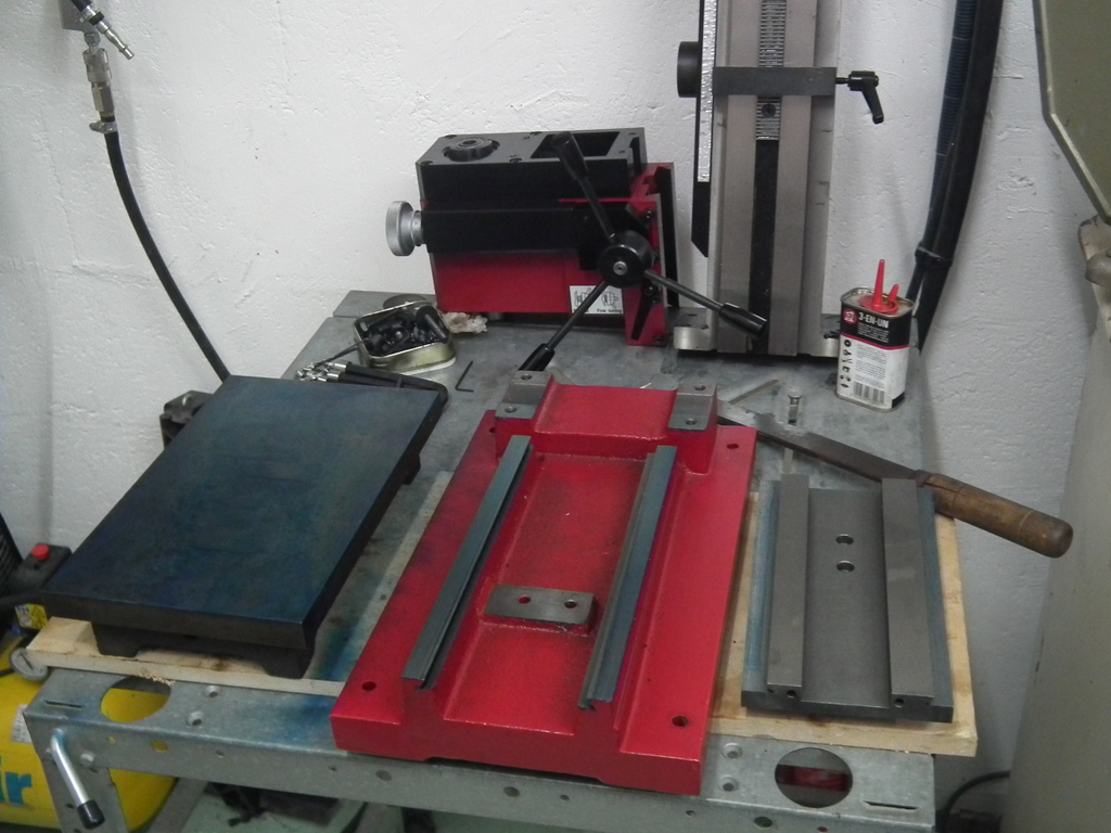

    Mill as received. I then stripped it down, washed everything in paraffin, and checked everything. The base was pretty good really but I blued up the surface plate and scraped it in:
    The Y slide fitted pretty well despite the visually rough machined surface so I just smoothed it off a little with a diamond lap leaving just enough texture (I hope) to hold some oil.

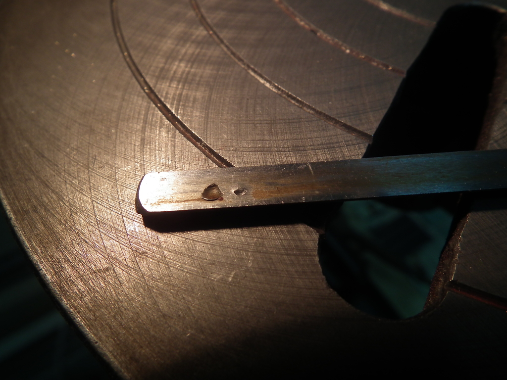

    The only fault I've found so far is the gib strips:

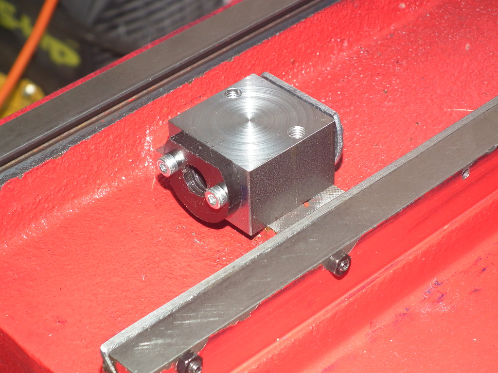

    The photo shows a close up of one end of the X strip. The dimples are only partly formed and are such that any movement will give a wedging action and stiffen things up. I will deepen the dimples and put points on the adjusting screws (as recommended by Arc Euro) and see how they go. If they are still unsatisfactory I will then fit a dowel to prevent side to side movement.

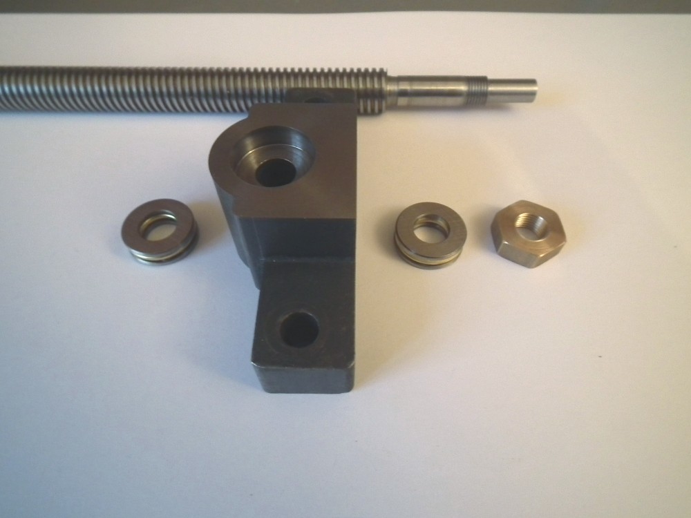

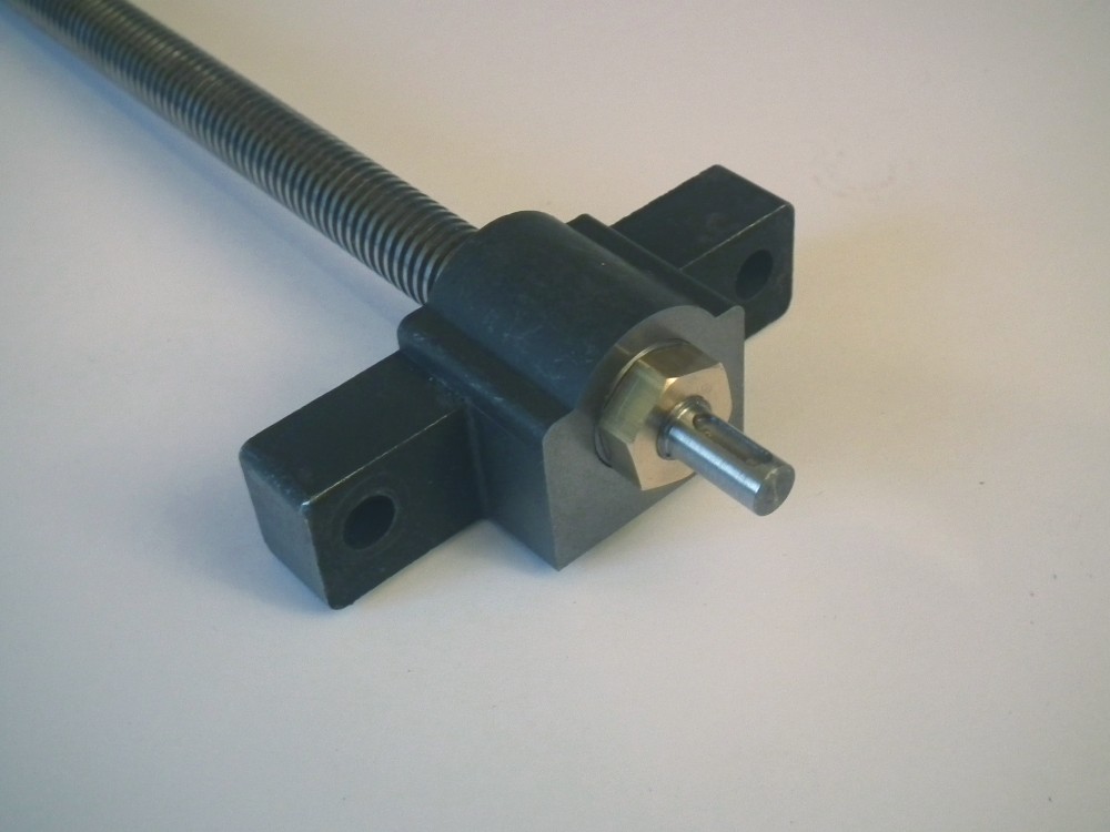

    I've fitted thrust bearings to the leadscrew supports and modified the ends of the leadscrews as shown:
    As the leadscrew has an undercut next to the start of the thread I machined the tread away for 1 mm so that there is a good location for the thrust bearing. The thread on the end of the leadscrew was cut off and the remaining end reduced to 1/4 in to suit the flexible couplers. The end of the 8 mm part was threaded 5/16 x 32 for a nut to adjust the preload on the bearings. I'll fit a grub screw to lock the adjustment. Just waiting for an ACME tap to be delivered so I can make the acetal anti-backlash nuts. I had to reduce the width of the bosses on the mounts to 26 mm to get everything to fit.

    Nice machining....! How did you do that? Have you got an other mill? Lathe?
    That was done on a sixty year old Atlas lathe with a homemade collet adaptor to ensure concentricity.

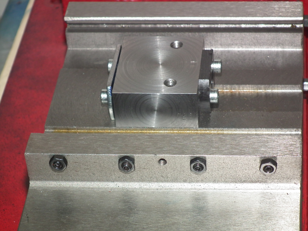

    Still, the M12 x 2 trapezoidal tap arrived from China last week so I was able to make a couple of anti-backlash acetal nuts for the leadscrews based loosely on the Brian Pitts design:
    Y leadscrew anti backlash nut.
    X leadscrew nut.

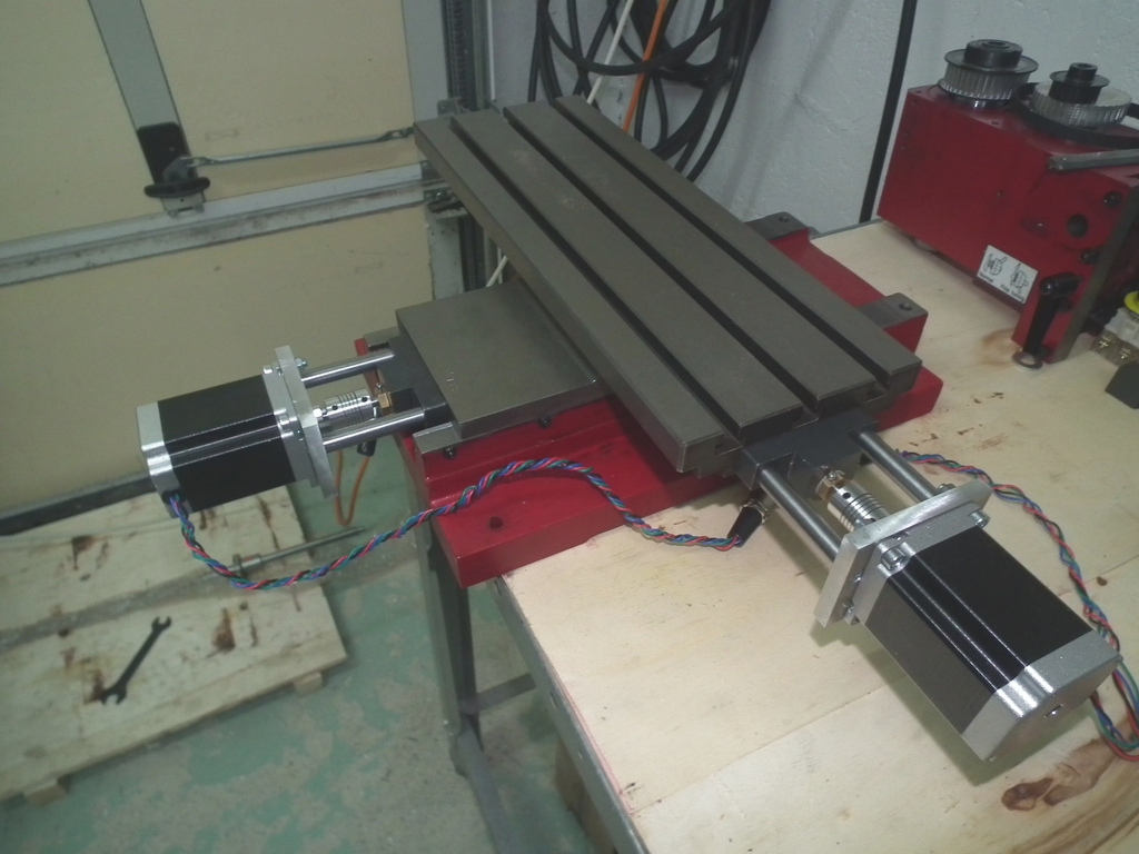

    and finally (for now):
    Base assembly (almost) complete. Just have to fit some mounting brackets for the home/limit switches.
    I can now adjust it to give me 0.5 thou backlash on the Y axis without it getting unduly stiff. However, the X axis gets stiff when the backlash is reduced below 2 thou so I have some investigation to do there.
