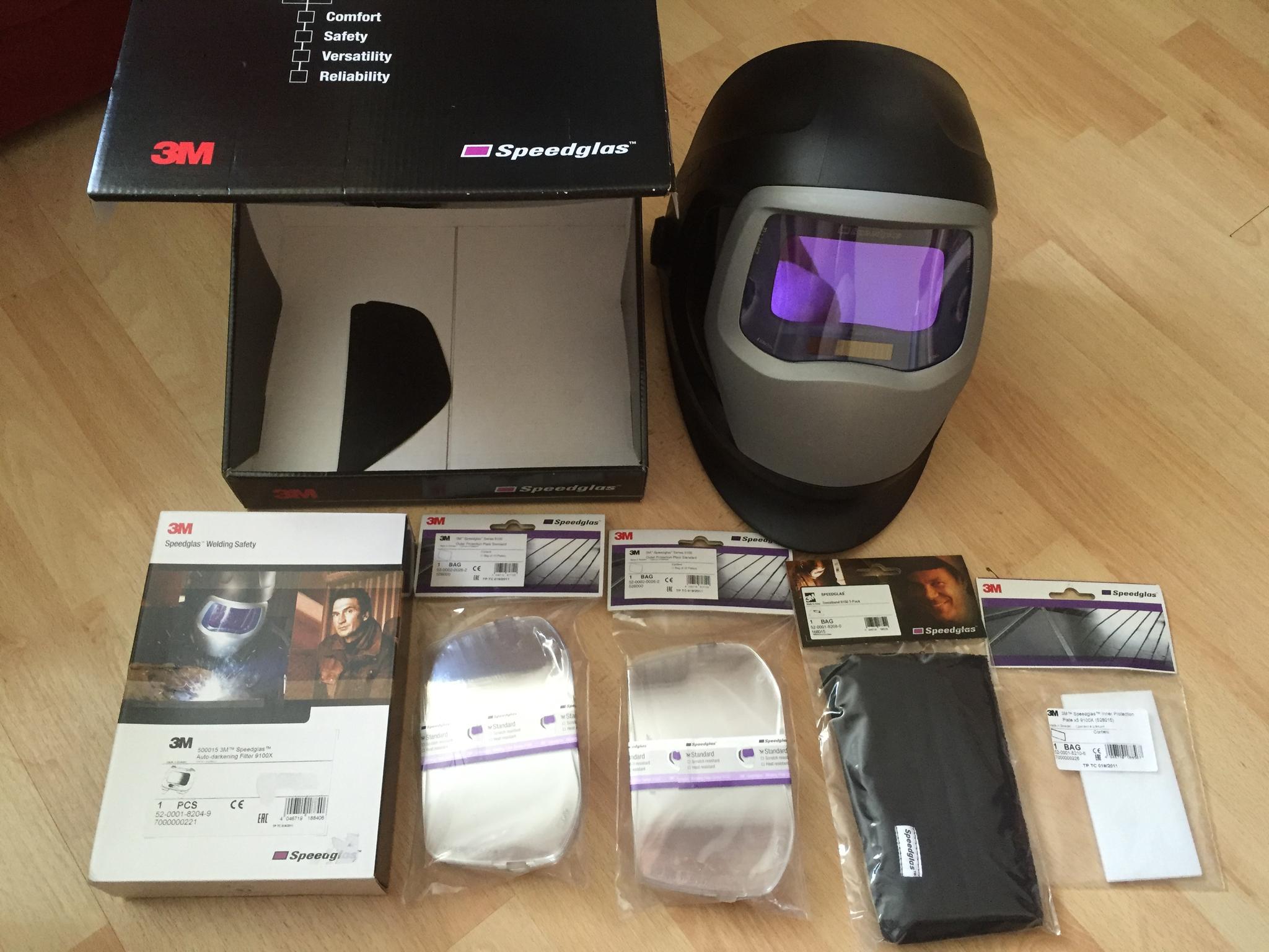

    I use both Mig Clarke 230TEC
    https://www.machinemart.co.uk/p/cl-migwld-230v230tec/
    and ACDC Tig Artech 170
    http://www.r-techwelding.co.uk/tig-w...al-tig-170ext/
    Happy with both and recommend them
    Use of proper helmet is must when use small current on tig - Jazz already mention
