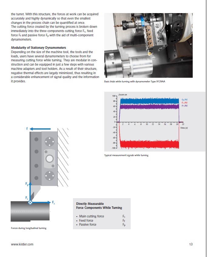

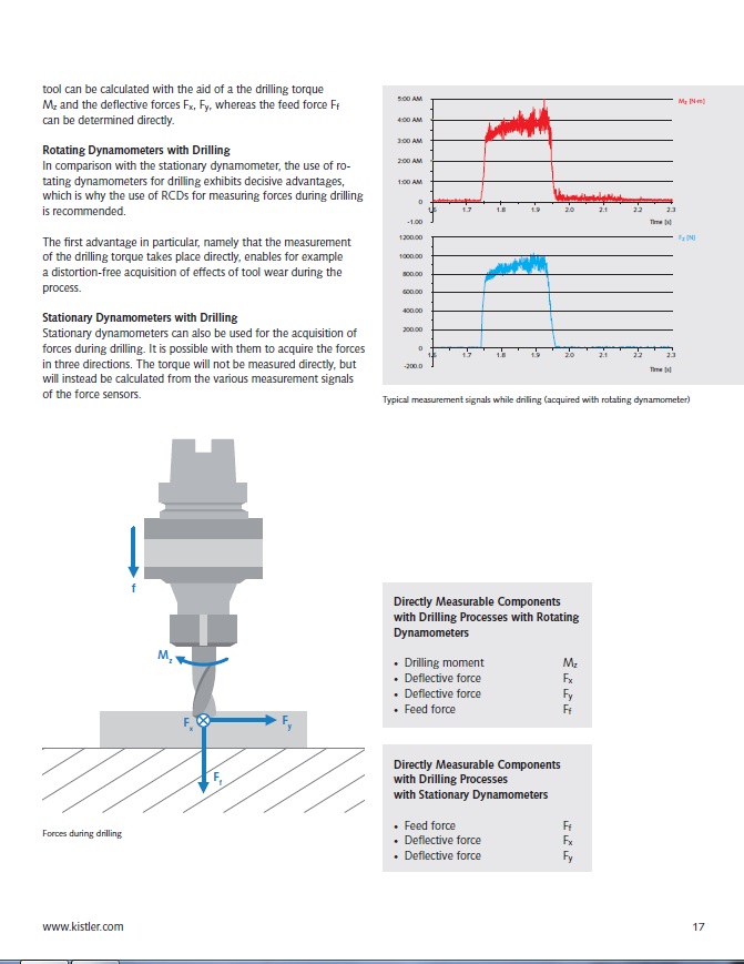

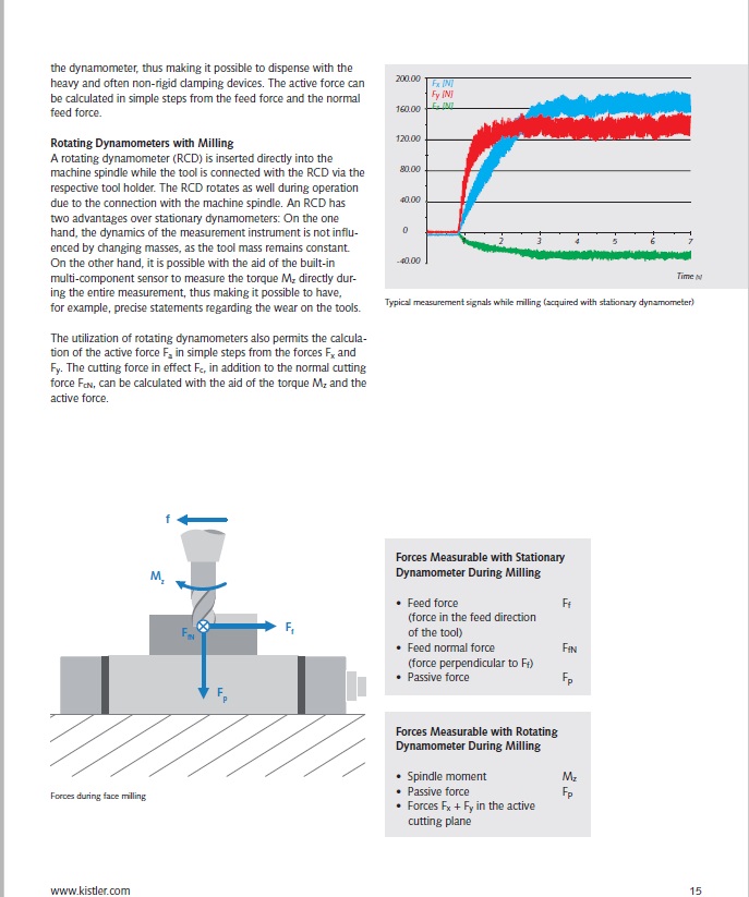

    Recently I found these from Kistler (manufacturer of measurement sensors). For milling they show typical forces (I assume cutting steel with ~8mm tool going by the picture?) of about 160 N?
    Also attached turning and drilling for info.
