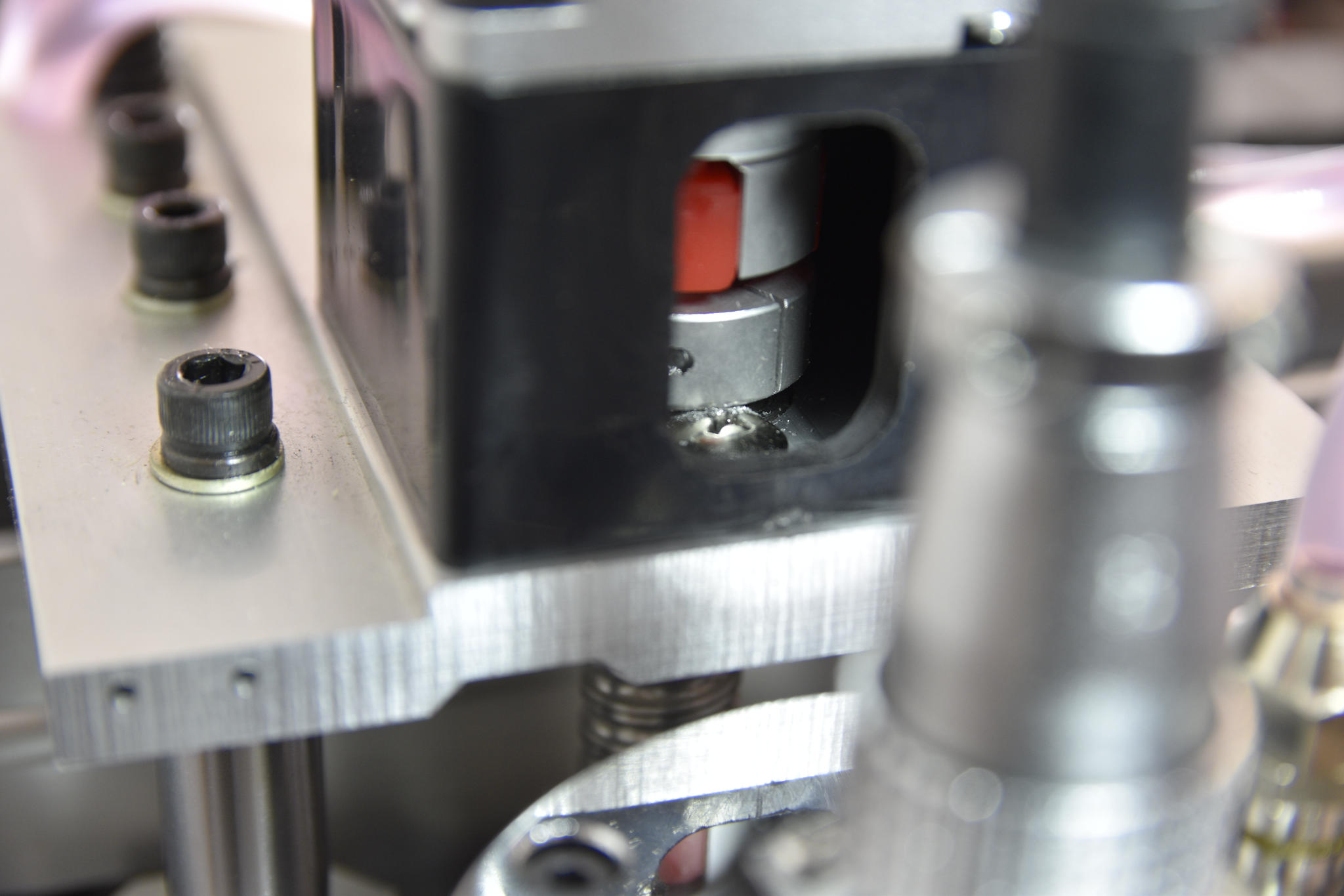

    We figured out the source of this issue. It turned out to be either a design flaw or manufacturing quality control issue related to the clamps that hold the Z axis motor shaft in place.
    I will explain more on this and post photos/video of what I am talking about.
    In a nutshell, the clamp that is supposed to hold the z motor shaft in place, tends to slip even when tightened very well.
    We added washers underneath the motor so it would not slip down too much. When we added the washers, and re-tightened it, it still slipped, but the washers are keeping it from slipping far enough to rub on the screw heads under it. the photos and video will explain it all later.

    Here is a YouTube video of the issue, and I have attached a photo.

    It looks to me that the leadscrew for the Z axis is not clamped at one end (it should be floating in one bearing and fixed in the other)
    Here's a a couple of photos to show what I mean.
ID:	18223Click image for larger version.
    It looks as though your machine is using the stepper motor to 'fix' the Z screw. However the type of coupling you are using negates this option.
    It is bad design to use the thrust bearings in a stepper and you should post some pictures of the leadscrew bearings at each end for us to check this out.
    The 'Oldham' coupler you have is not designed to resist being pulled apart, which is what is happening and the whole leadscrew is slipping downwards.

    Nick, I think it is the leadscrew bearings that are design deficient.

    As Rob suggests I think you have a problem with the bearing holding the screw in position the motor should certainly not be doing that job. It will further damage your machine without sorting this problem out.
    Take the motor off and see if you can check for end float in the screw

    It isn't end float. More like end sink. That has got more slop in it than an old Beetle crankshaft. I would bet that there is no fixed bearing at all.

    probably so, my response was to the fault as described, before photos were added.
    Having watched the video there seems to be a glaring absence of end-float bearings on the ballscrew, unless you count the screw the coupling rubs against ;-)
