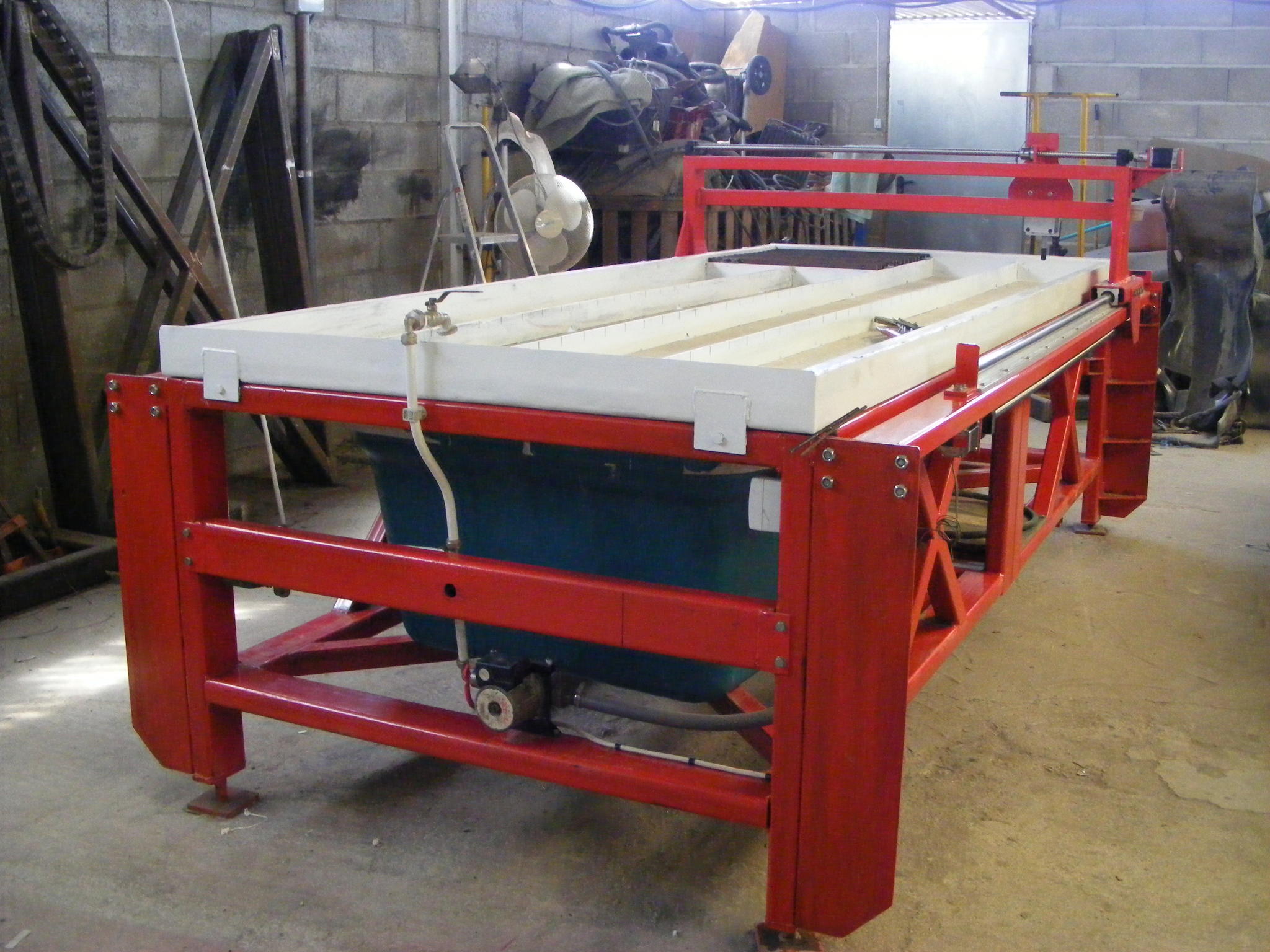

    Ok - so here goes.

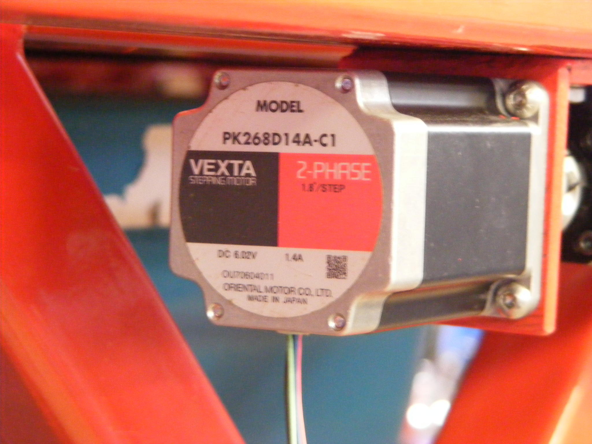

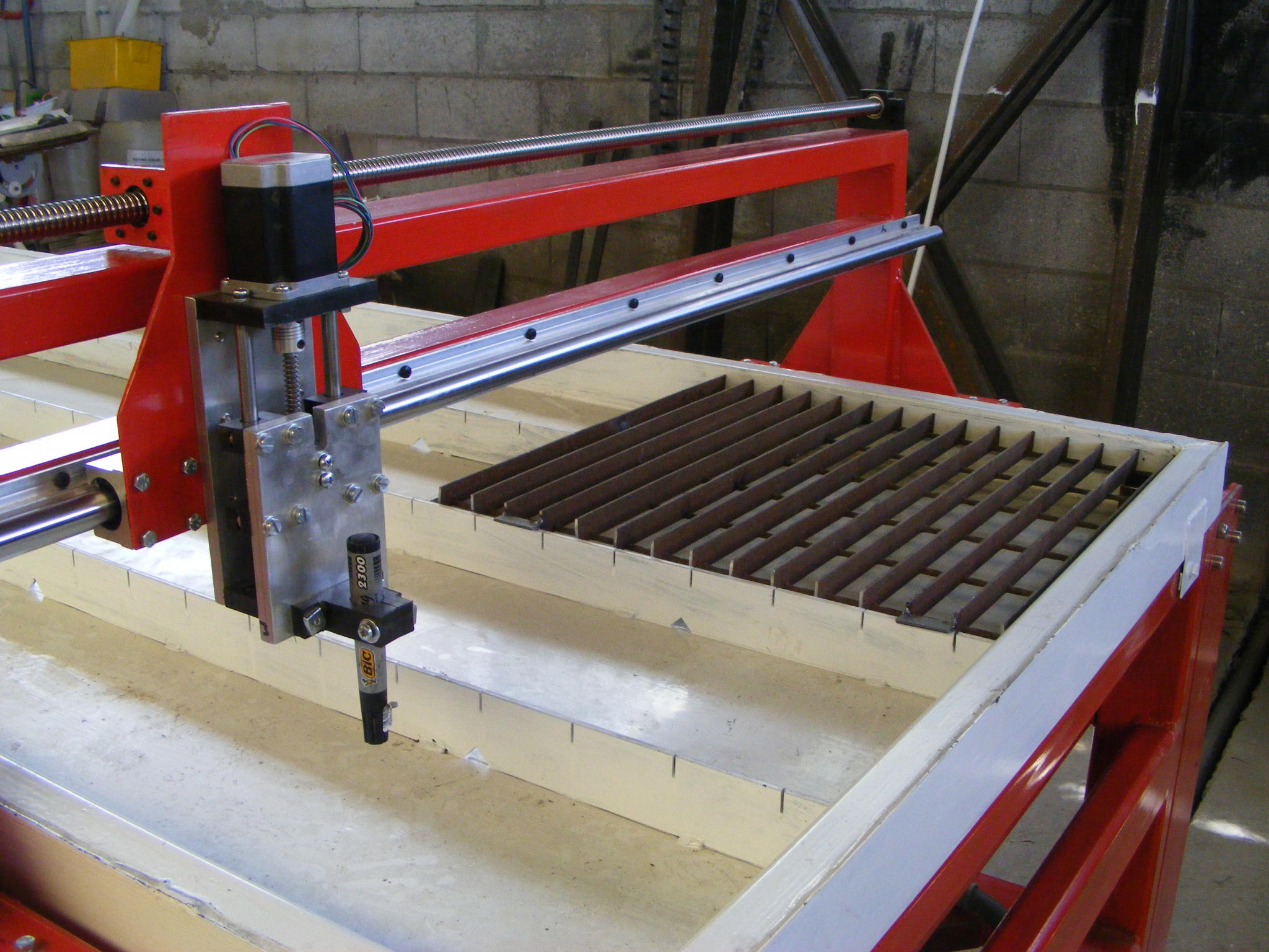

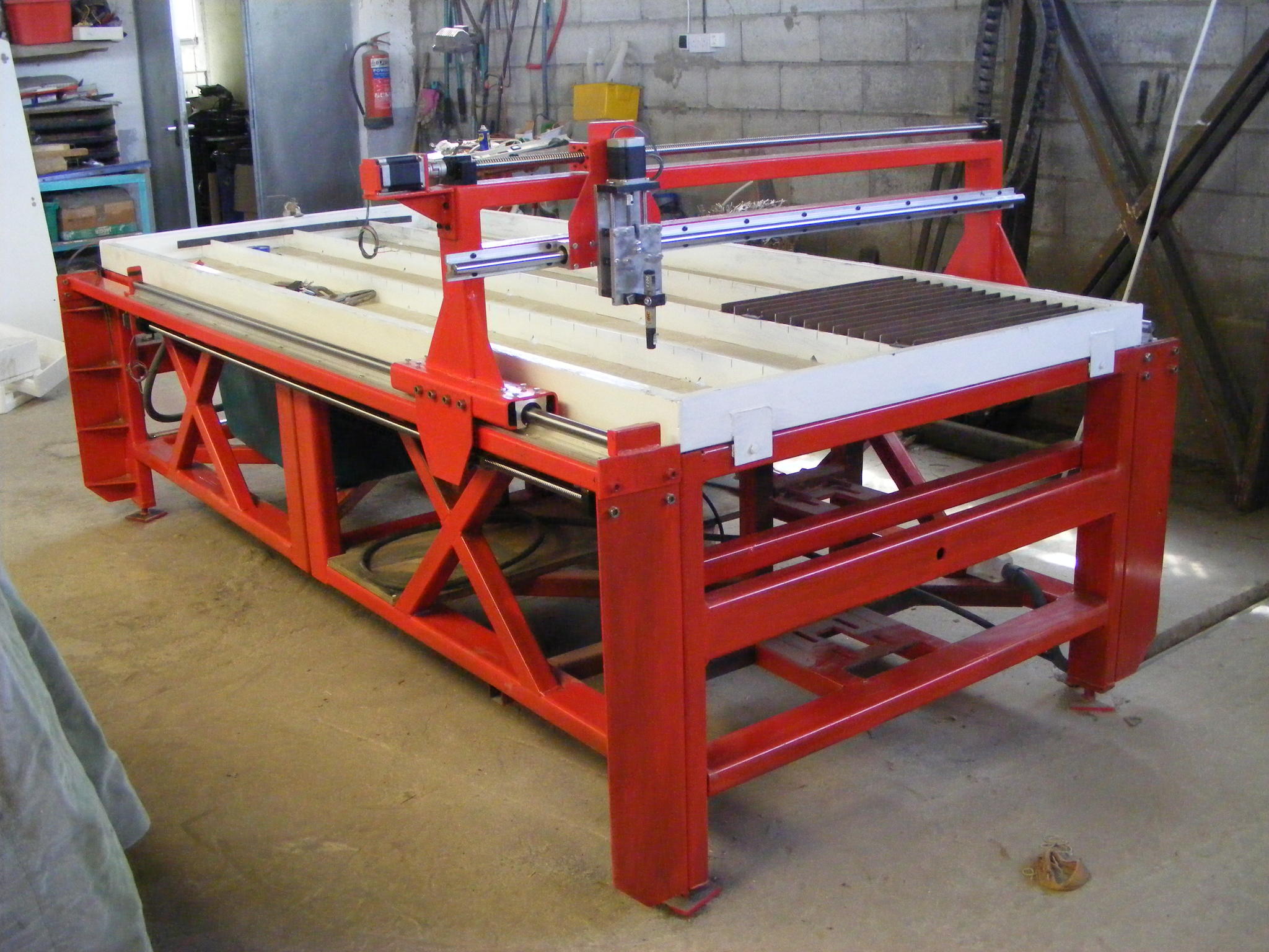

    I've made an attempt at building a 8' x 4' water table. Ballscrew x, y, z axis (z axis with 150mm travel was purchased complete off ebay) Currently awaiting delivery of a Hypertherm 45 with machine head. Photo's to follow - please note: constructive criticism greatly appreciated as i've got to learn. Have 3 x nema23 motors (Japanese - forgotten make but will update) all currently direct mounted but the whole thing bolts together. Don't know if these are up to the job. Water table has a drain to catch tank and a pump for refill. 3 phase electrics to the machine plus a neutral for the single phase stuff.

    So here's a few photos of the progress so far.

    Do you know the inductance of the motors? You might run into problems with the ball screws that long without rotating ball nuts.
    For Plasma you WILL need some good electronics and they will have to be able to slave the second screw with homing switches. cslabs make some good controllers. Dean (Jazzcnc) is the go to person for advise on them here as he has fitted lots of them.
