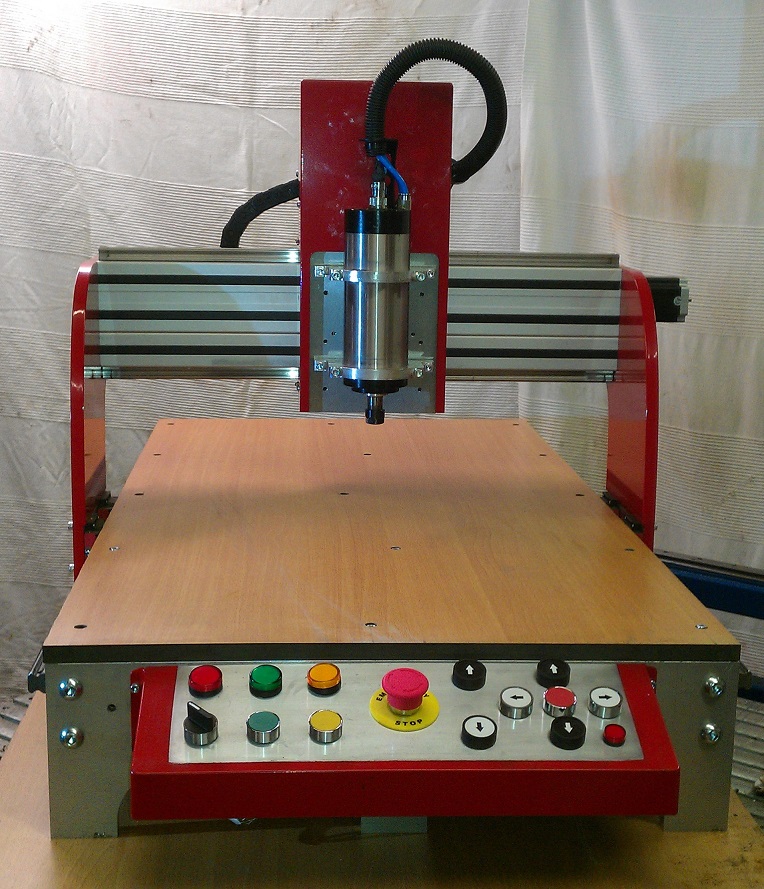

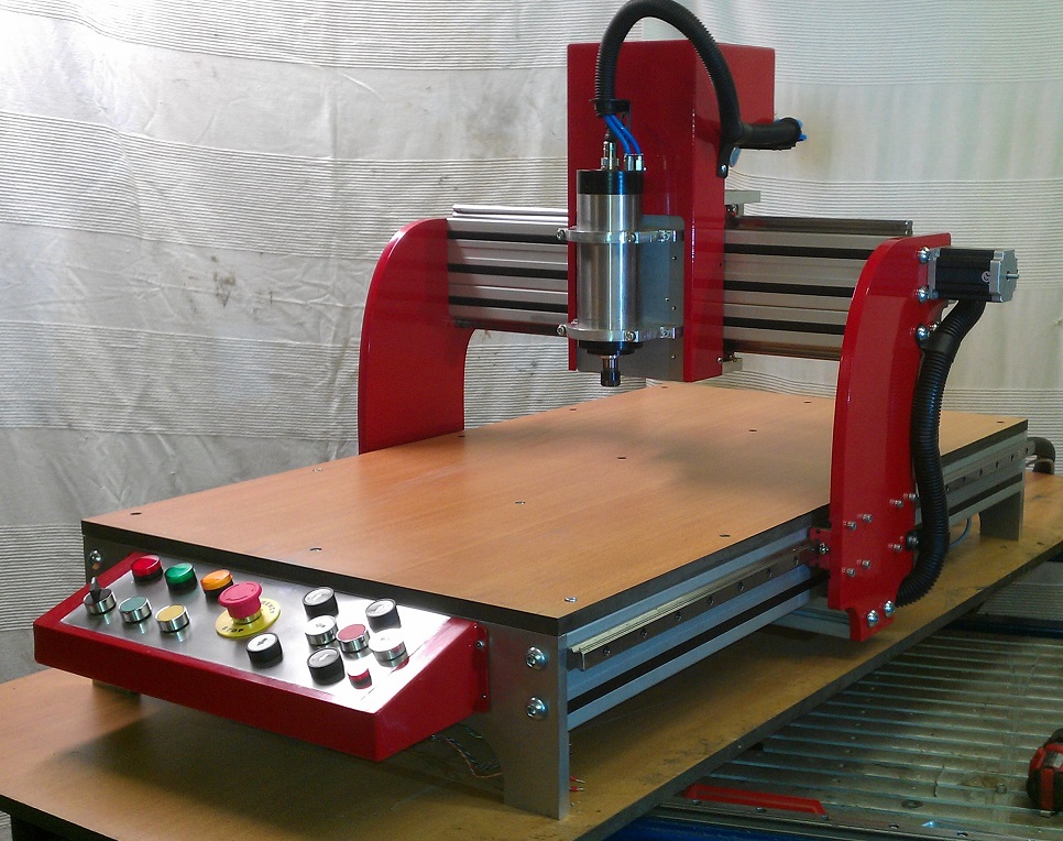

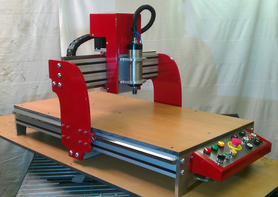

    Can somebody give me a link/picture to some examples of the build quality of these "bespoke" machines, to give me an idea of what my potential diy effort will be up against.
  11. #10
    I like this one
    /threads/9694-Hello-from-Slovenia-first-time-CNC-builder
    Dean(JAZZCNC) had input on this one so can't go wrong if you follow his lead.
    Mike
