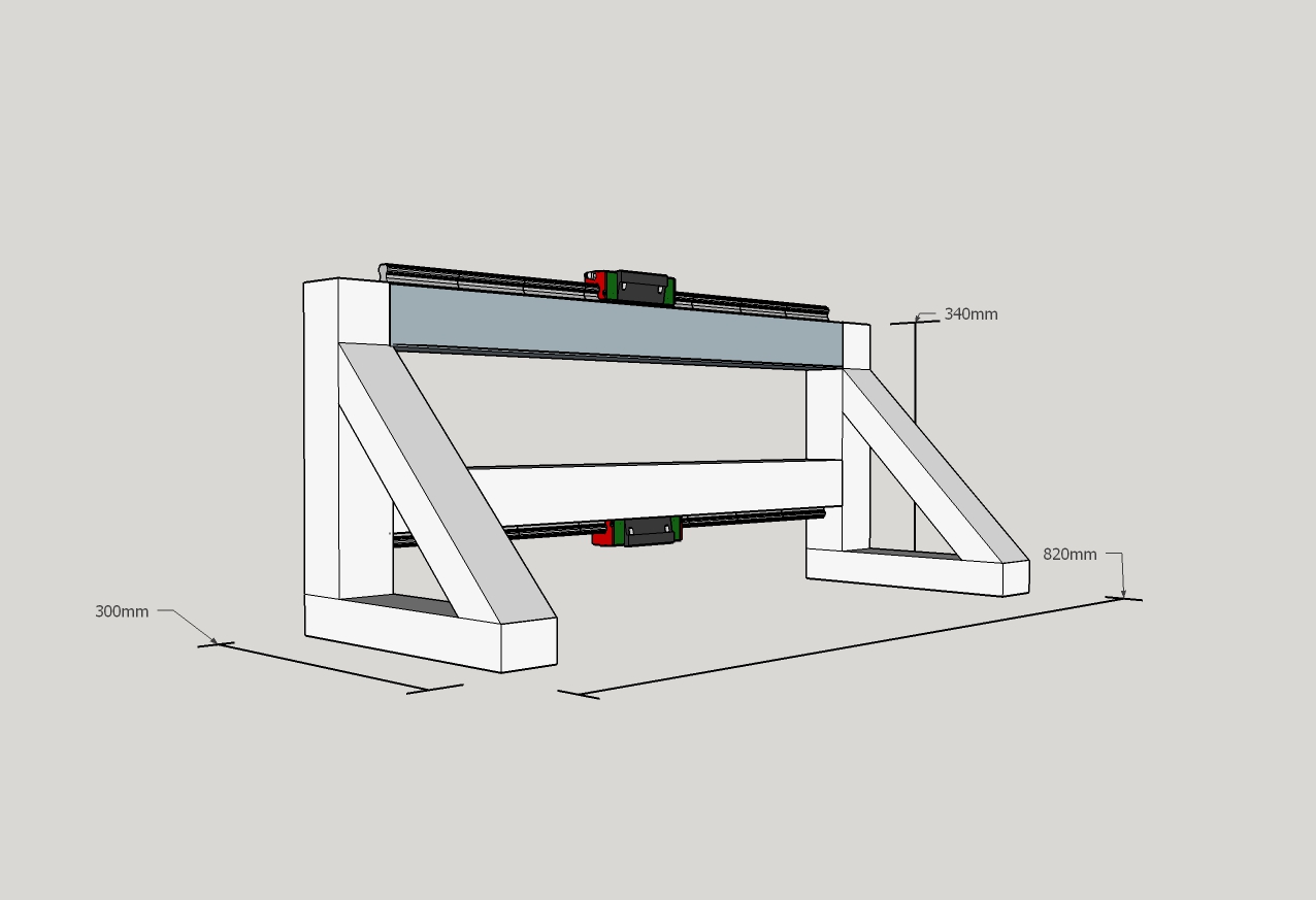

    I haven't ordered anything yet still messing about on sketchup lol.But I will take you and Jazzcnc advise and get the Hiwin type.Heres my first Attempt at a gantry It took me five hours to do this on sketchup I don't know what I was doing but I kept deleting parts off the sketch.

    just another +1 on the hiwin rails ...
    for the price difference it IS money well worth it !
    for the gantry , dont have the gantry side like an upside down T as it offsets the spindle too much and the spindle will go quite a bit over the tables surface. using a L shape might be better and reduce the amount you go off the table (unless you want to ofcourse)

    Yes, the spindle should be inside the footprint of the 4 gantry bearings, this is the key diagram; http://www.cncroutersource.com/do-it...NC-router.html

    Thanks for the advice would this be a better design.

    Hi Gregor
    That setup would ensure you get the Z axis very close to the gantry and the motor should be positioned as near to the centre of the X bearings as possible.
    Only problem i envisage is the alignment of the gantry rails, do have a solution to this ?
    Mike
  11. #10
    Yes, that's a better design.
    Mike
    You are right, maybe one rail could be welded and the other bolted to allow adjustment ?
