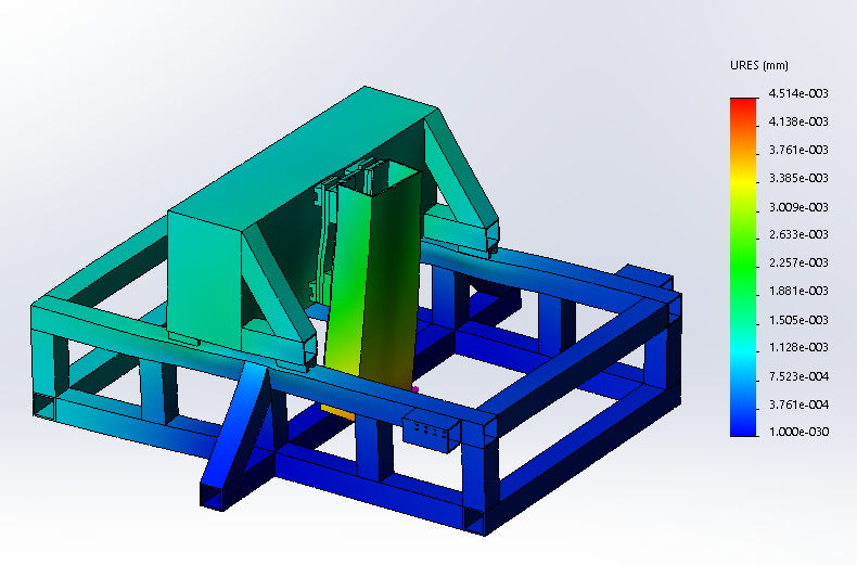

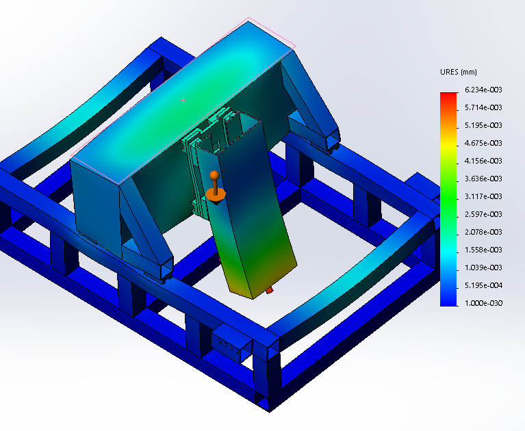

    Now the whole thing begins to come together again. I have done some more FEA on the whole frame. I will just add that they are approximations and gives a rough overview. Joints and mounting points will add to the deflections.

    Base:
    I did some test with and without the side supports. The side supports make the base a lot more rigid. However, without the side support the deflection on the base is still insignificant compared to the gantry and the y and z carts. I also looked at how steel would increase the rigidity, but since the deflection on the base already was insignificant on the total frame, the increased stiffness from the steel was very small on the whole frame. The base is about 57kg with aluminum and 105kg with steel.
Name:	compleate assembly 100 + g i X retning.PNG
    Gantry:
    The gantry have a lot to say on the stiffness of the frame especially torsion that add to deflection on loads in the x axis. The gantry is changed from a frame with a lot of 60x60mm square tubes to a single 300x200mm t=6 rectangular tube. The stiffness of the new setup is about the same, but it makes the assembly a lot easier. Which means there is less areas to make mistakes the rigidity of the machine will suffer from. I had to go for steel on the gantry to get it rigid enough, an aluminum rectangular tube was just not enough. Casting aluminum could be possible, but that will again make it more complex and prone to errors. The gantry is still movable on its own, but it is now at 50kg. The Y and Z cart is at 20kg so in total the gantry and Y and Z cart will be 70kg.

    Given that the additional cost and effort is low I'd add the side supports anyway as there may be a significant reduction in resonance under circumstances for which you have not calculated.

    Indeed, that's why I will probably build them anyway, but it can also be easily added later. The only minus is the added with, if I can get it trough a door on wheels whitout removing the gantry and tipping it on the side it would be nice. Else than that it is only positive with the added rigidity for unforseen deflections. Hovewer the base is already more than strong enough, it's the torsion on the gantry that is the weak point.

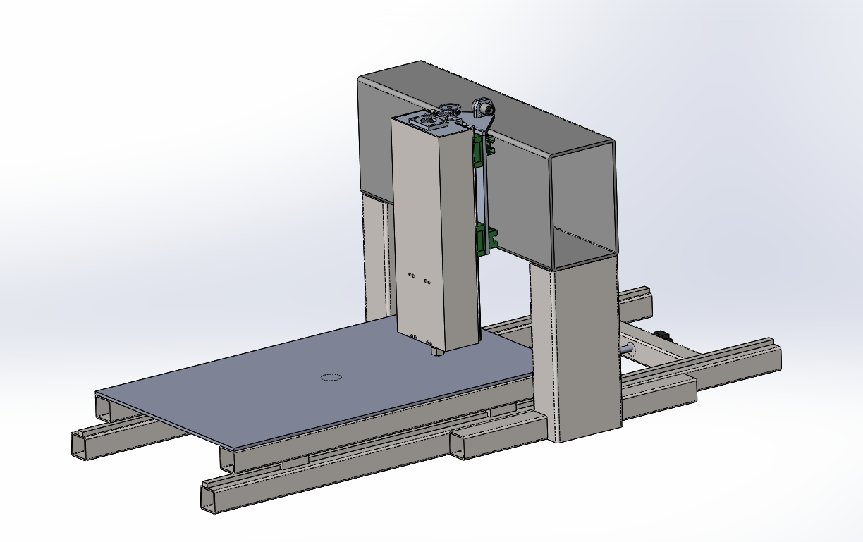

    So I have been working on redesigning the whole machine. I'm currently going for a stationary gantry design.

    Due to the fixed gantry design the heaviest moving part is now the base plate with 30kg. I'm going to use 20mm HIWIN profile rails on all axis.
    There will be one lead screw on each axis, no need for two on the X any more due to the stationary gantry. Here i'm going to use 1605 ball-screws. To drive the axis i'm currently looking at using servos in the 200-400W range. There is not the same amount of information on servos av steppers so I hope someone here have some knowledge on servos. Seems like JMC produce the cheapest servos and drives, but I cant find a lot of data on them. If there servos from JMC are good enough i'm probably going to use them. BST automation also seems to have a ok selection on servos, but again there is little documentation to find.

    It looks like you have the rails on the base and the carriages moving on the X-axis.
    If you have the carriages fixed on the base and the rails moving under the X-axis you can have maximum support and rigidity where you need it most at all times.
