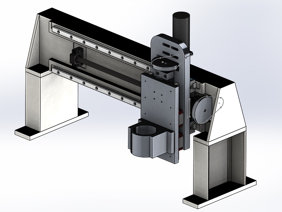

    A square tubes looks not enough strong for me for aluminium machining.
    I'm working on this frame for alu, with a smaller motors than what you want.
    You should move the X ballscrow to lower. It is better between the 2 rails.
    Everything looks welded. How can you do the end machining for a rails and others?

    The design is kinda crude, it was a fast iteration. I'll probably get some time in the weekend to upgrade it so the details is more understandable. The i'm going to add end plates to the large gantry square tube. Most of the machine will be welded. I have planned to bolt the gantry and base together at the bottom of the gantry legs. I guess I need to remove the aluminium part in the title of the post sinse it's mostly steel now.

    It looks like you have the rails on the base and the carriages moving on the X-axis.
    If you have the carriages fixed on the base and the rails moving under the X-axis you can have maximum support and rigidity where you need it most at all times.
    I agree, I changed it back and forth several times. It became a compromise. Rails on the base would make sure the support is maksimum and equal at all times. However the moving base would be longer and the leverage from the longer base would put more stress on the machine. The weight of the moving part would also be higher.

    The cost of servos is going to be quite high, so i'll probably for closed loop steppers instead. However the ClearPath servos seems tempting. Is there any good reason to use servos instead of closed loop steppers?
  8. #28
    Quote Originally Posted by PotatoMill View Post
    Closed loop steppers don't have the speed or torque capabilities of servos and are sold as an 'economical' alternative. The only good reason to use closed loop steppers is because they are cheaper.

  10. #30
    Thanks for the quick response Fenza and Remrendes
    According to a quick estimate I did I dont think i'm going to need any more torque than what these closed loop steppers deliver; http://www.aliexpress.com/item/new-o...a-82b3fb4b4813
    Estimates done with
    -40kg weight of moving part
    -130N force of cutter (excessive)
    -20N friction
    -85% efficiency
    -10 m/s^2 acceleration (more than I think i'll need, but I haven built any CNC machines before so i'm not certain on this.)
    -5mm lead
    Using T = (F*l)/(2*PI*n) where F is total force, l is lead per revolution, n efficiency
    I get 0.44N well within
    However I do know that theory and experience dont always match up. And in real life there could be some factor that make the estimate wrong.
