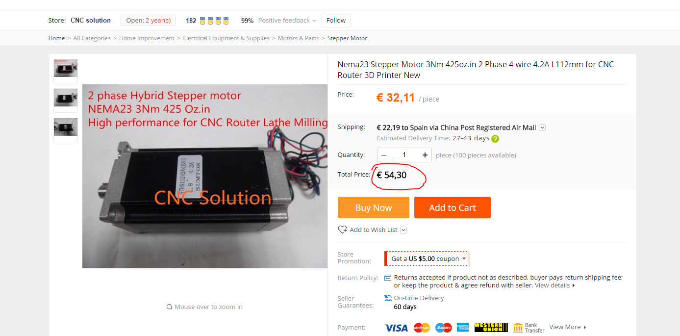

The plan is to use 20mm profile rails and 16mm ballscrews on all the axis. With dual 1000mm drive one the X-axis. I'm going to use nema23 stepper motors but i'm still uncertain on the torque requirements I have to do some more calculations there. Though it seems like most of the steppers have a very high corner speed and to utilize all the torque and speed of the motors they should be geared down about 3:1. Any thoughts on this?
