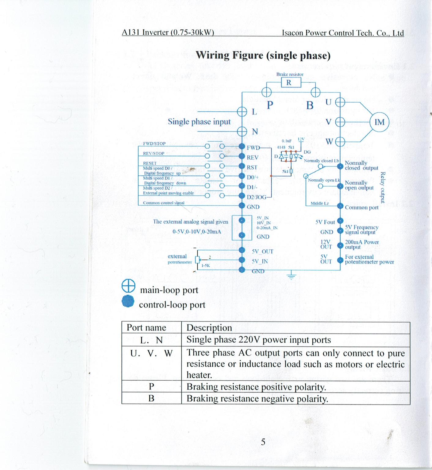

    Hi everyone I recently started a Gerber 48 build http://www.mycncuk.com/threads/9464-...ures-Inside%21 Jazz has been a great help in ironing out all my initial newbie problems that I had. But the final piece of the puzzle as far as my cnc set-up is the VFD setup to mach3. In the tread I linked Jazz did give me instruction that I followed but this resulted the VFD showing 000.00 on the panel and the bob relay light turning on but no movement . I have this BOB http://www.omc-stepperonline.com/dow...ers_Manual.pdf and the ASKPOWER A131 Series.
    The Spindle runs fine from the VFD panel but no movement from the mach3 only the relay light on BOB comes on and makes a click . Below I have attached the pages from the manual the last image is what I did in paint to show you how I have it wired at the moment.

    Ok well so sounds Mach3 is set up correctly for ON/OFF so now check you have voltage coming out from speed control. Command half the speed you setup the spindle pulleys for and should get close to 5v.
    If this works then check parameters in VFD are set for External ON/OFF and Speed Ref. If yes then it must be a wiring issue or the Digital input your using is set for another function so check this also.
    Are you feeding the BOB with the required 5V and 12-24V? Measure the voltage across the two 0-10V pins on your BOB at various speeds to see if you are actually getting it to pulse.
