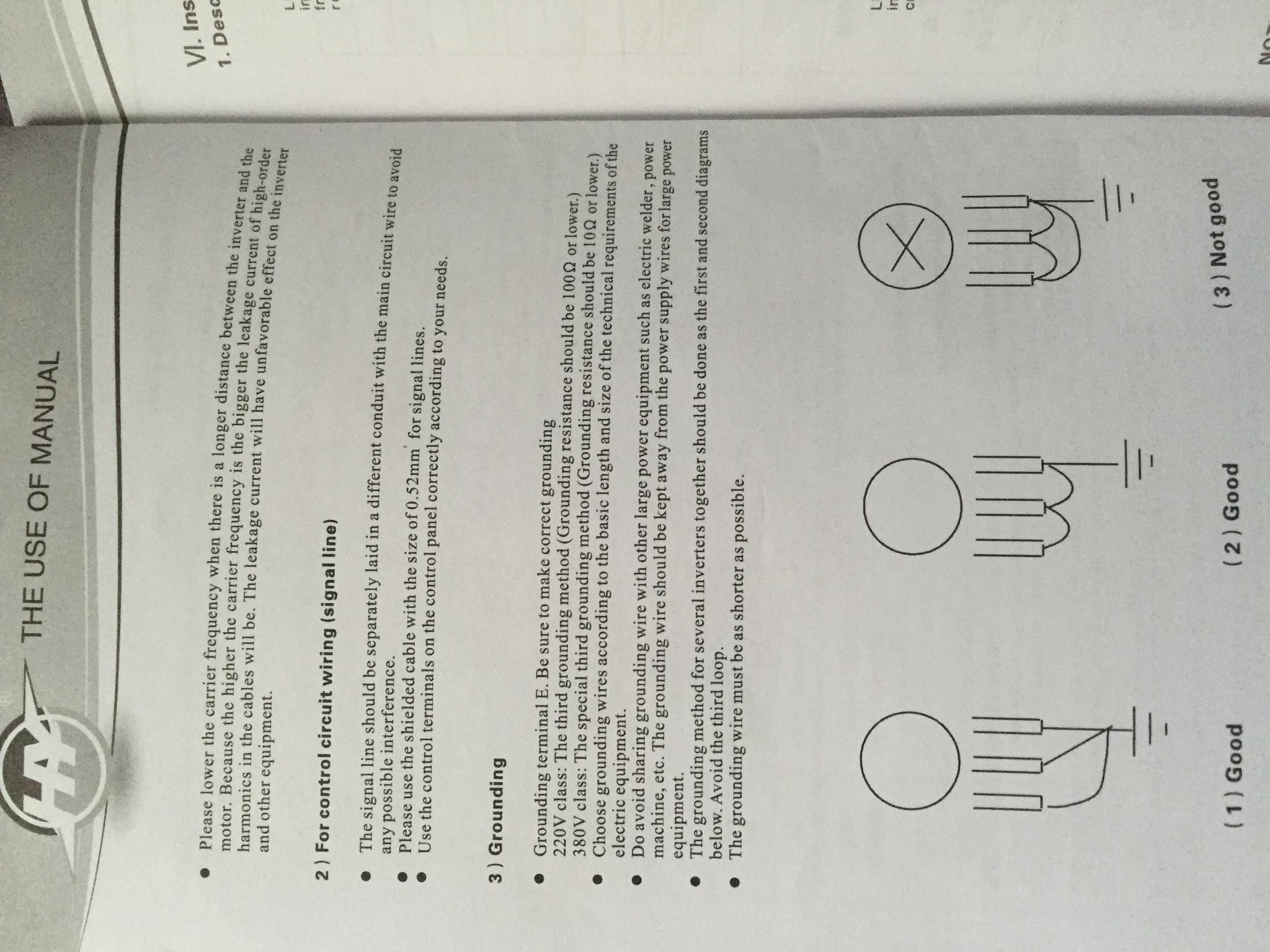

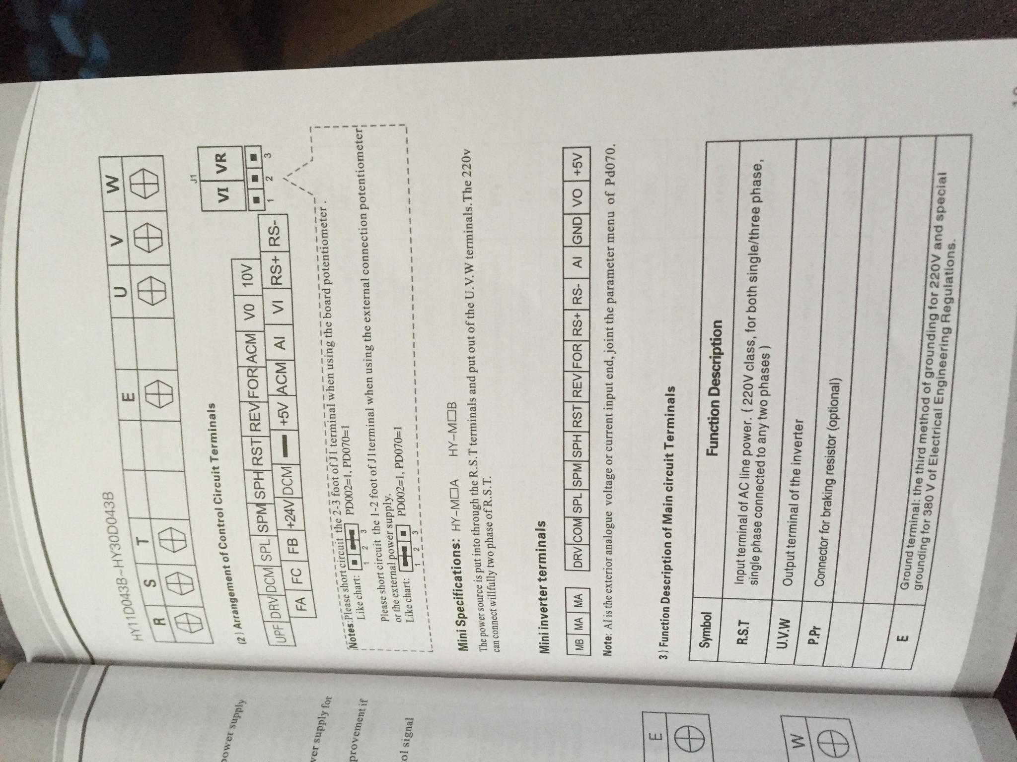

Thanks ive got that, I've got the spindle running however I can't seem to work out how to control the RPM
