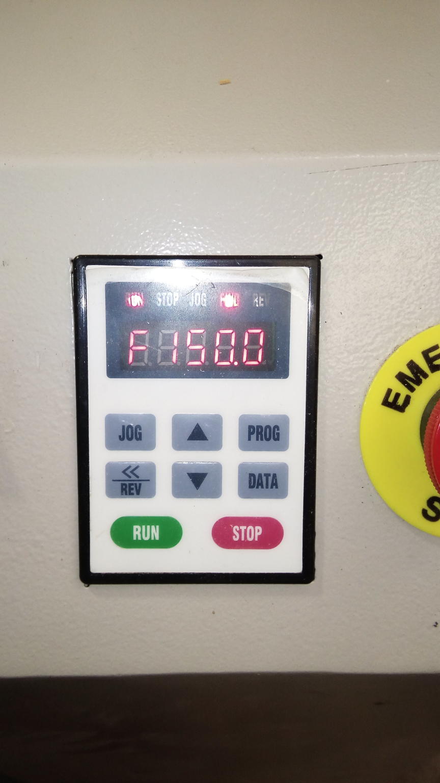

    I'm back having problems with a friends Chinese CNC. The spindle (1.5kw water cooled 80mm) seam to stop when I try to make it go over 10,000rpm. If I set it in fusion cam to do 10,000rm its fine however if I set it to 12,000 it does not start. If I set it to 10,000 then start the file and then up the spindle speed in nc studio it also then cuts out so I am thinking its on the vfd side of things.
    I don't have much in the way of instructions for the machine so finding it hard to figure much out, any ideas? The pic bellow shows the vfd I'm not sure even what one it exactly is.

    I am not familiar with the VFD model, you'll need to read the manual for details, but that sounds very much like the ramp-up time is set too short and you need a slower ramp-up setting in the appropriate parameter(s)

    I wouldn't of thought ramp up time would cause the issue, especially since it seems to get up to 10k OK.
    However, we really need more details.
    VFD make/model (there must be a sticker on it somewhere..), what software/controller is the machine using, and how is the VFD interfaced to the controller (0-10V or Modbus).
    Any messages shown on the VFD when the spindle stops?

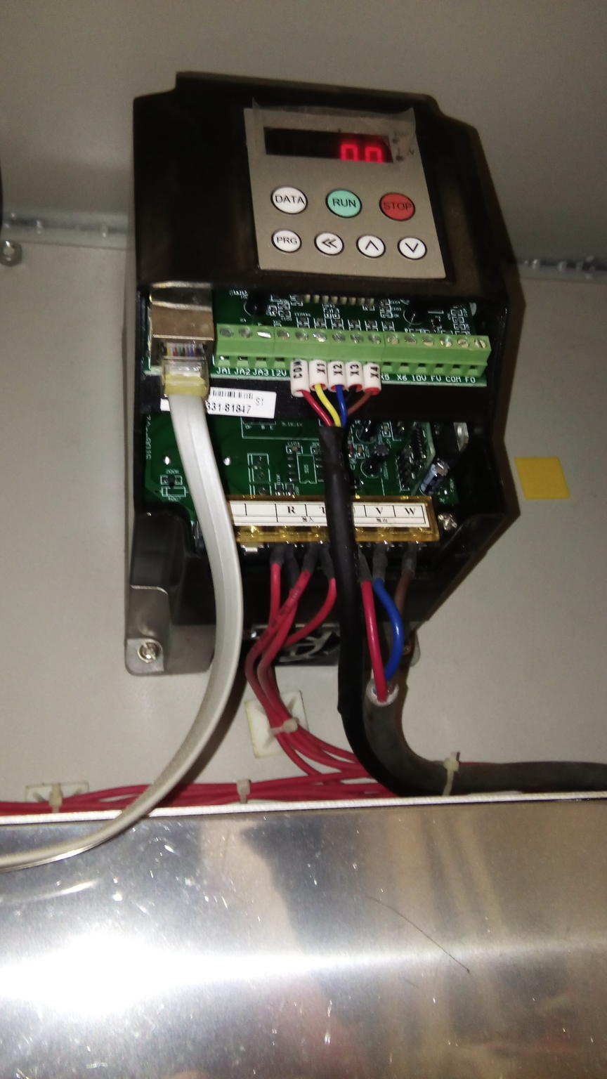

    When you're there, try and work out a wiring diagram, and get some photos of how things are connected.
    If you can work out the activation signals to the VFD, see if they remain active when the spindle stops. There is the possibility that the controller is stopping the spindle when too high a speed is commanded, so knowing what the activation signal/speed set signal are doing narrows down to if it's a controller issue, or a VFD issue.

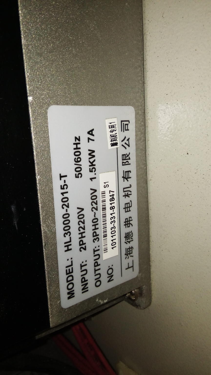

    10,000 revs divided by 50 hz equals 200.
    First check on the plate that the VFD can actually go to 400 hz, many can't. I have a couple here than can only go to 150 Hz and 200 Hz.
    Then check inside the parameters for Max Hz isn't set to 200 instead of 400.

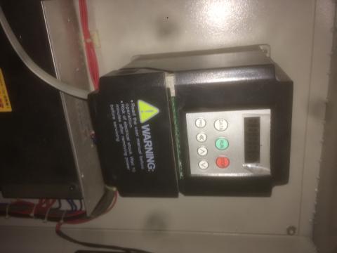

    OK. So I'm sure it is machine side of things as I does it without any file loaded. Trying to find a manual is proving hard but I found one for sale saying it does 400 hz just not sure if its set to that.

    Quote Originally Posted by charlieuk View Post
    Just don't change any parameters without knowing what you are changing. If you start experimenting without manual and just guess you may fry the VFD or the motor. Perhaps Mactec54 can maybe help you over on CNCZone.
    Find a seller that sells it on aliexpress or ebay, contact him and ask him for the manual. That simple.
    Where did you buy that spindle from?
    Or download a typical Chinese spindle manual, al is same same, with small differences. Find there the max frequency and max it to 400hz.
    here is the manual in Russian https://docviewer.yandex.com/?url=ya...c=58b415ee5c3b , lame but you can use copy past in google translator and get the important stuff
