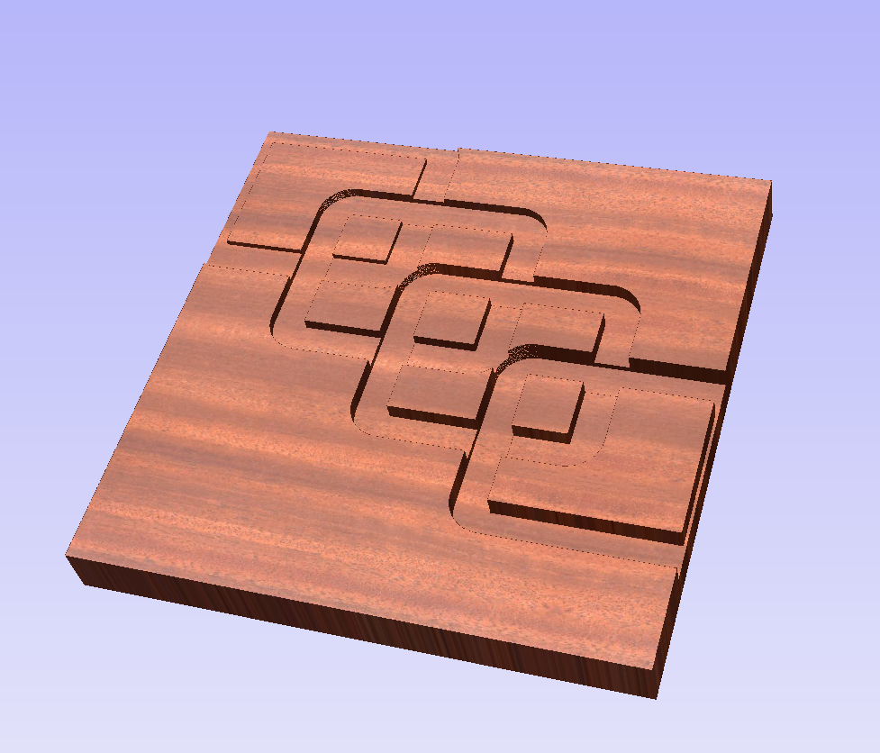

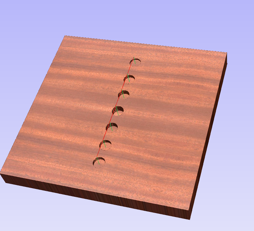

    Basically during program if first profile or pocket is ok, then i have a drill toolpath it does all holes like -2mm deep.
    So i tested it with 4 squares: all is perfect, first square 1mm deep, second 2, 3 and 4mm.
    Start drilling though or change from one type of toolpath and looses ~2mm.
    And the thing is that it does not lose anything as if at end of program command manually to 0, it goes exactly to 0
    Same with V carving. see at the right side of video how it messed things. Basically it started right and then where the corners should be cut it cuts 2mm above where cut should be.
    On the video see how it must cut holes from 1mm, 2, 3 to 4 and again to 1mm deep. It misses the first
    Thats how it should be:

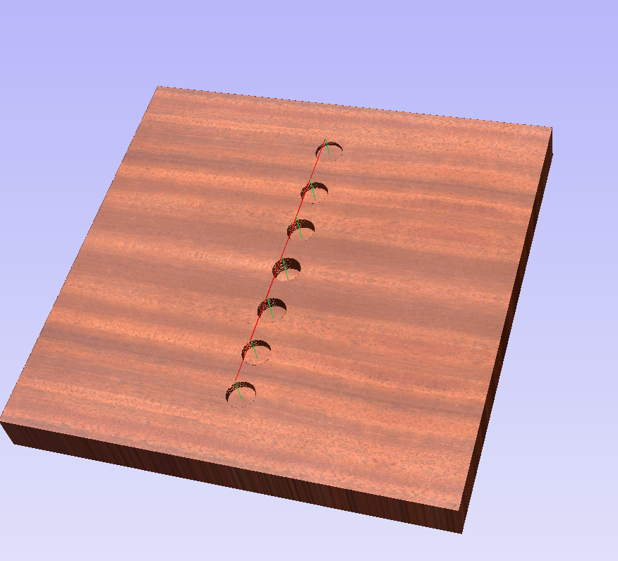

    this one is the only one that does it ok:
    test2.txt
    These are the first tests, 100x100 square, circle and then drill. The square was ok, the circle ok and just at the end of the circle profile it lifts up instead of closing the circle same depth. Then the final drill holes of course not deep enough.

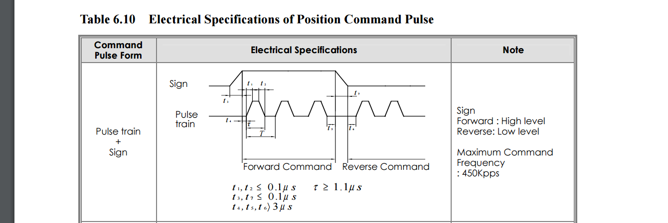

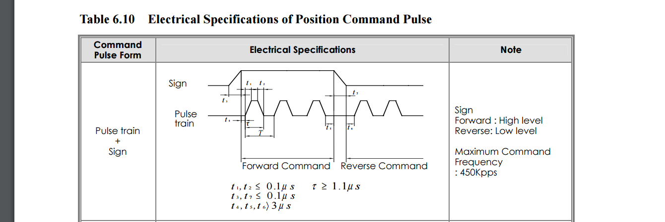

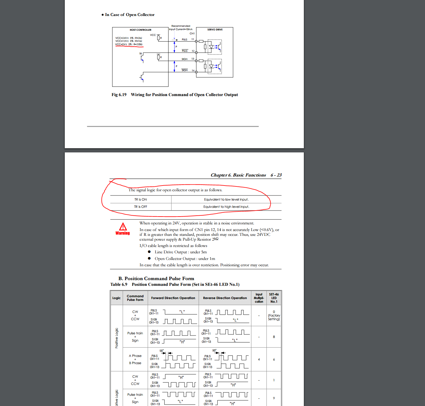

    Could be you have the Step pulse active on the falling edge rather than rising edge. Basicly it's timing issue and the Step pulse is happening before the Dir so your losing a position with every direction change.
    Try changing the Step Active pin state and see if it makes difference.?

    Today i feel good so i decided again to brainstorm the problem. I read a couple of times again the bloody Samsung CSDJ PLUS manual. I could not find anything there or in the software about "falling edge" or "rising edge" , maybe cause they call them sth differently, though i think its not adjustable and somehow could be obvious to sb knowledgable looking at the pictures below.
ID:	18414Click image for larger version.

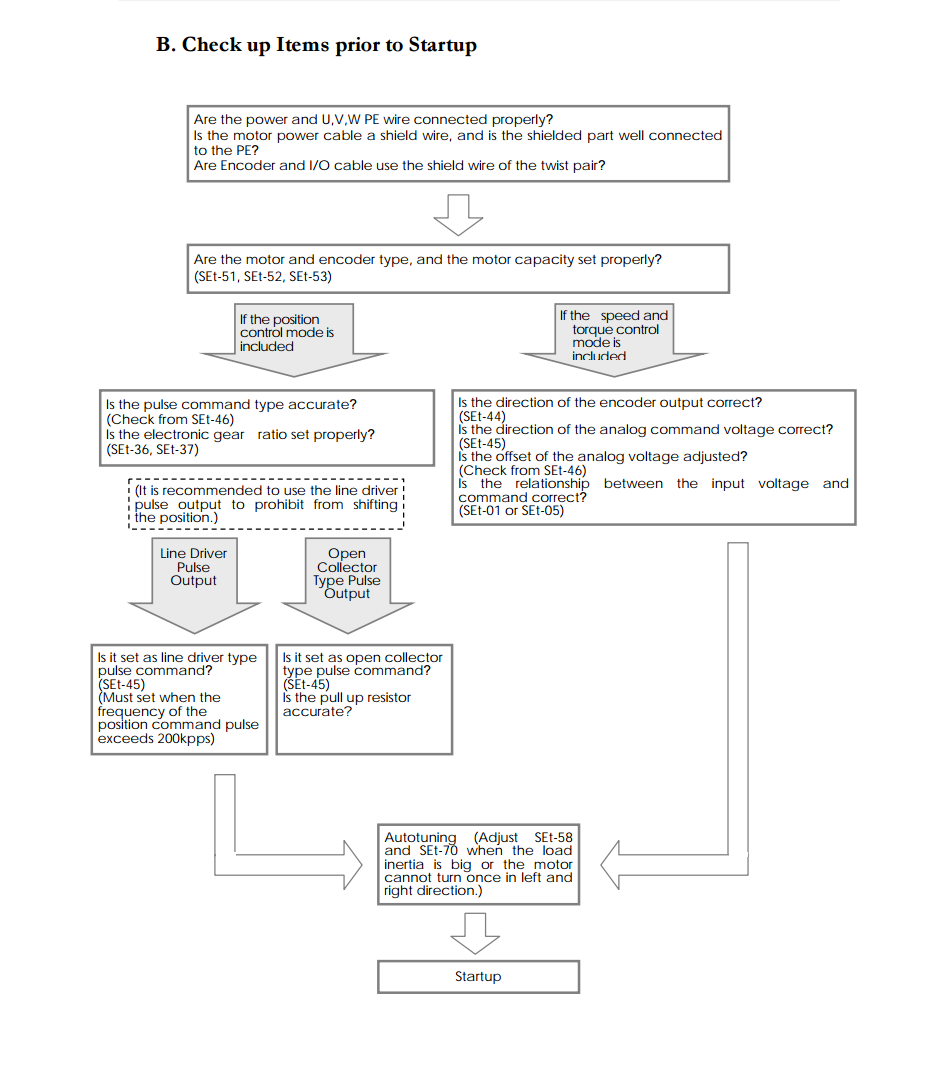

    So i started step by step as per manual, checking all again:
    For a moment i thought the culprit was the resistor value. As before drive was connected to galil board /24v/ . But, no- 220ohm, correct for 5v pulse signal.

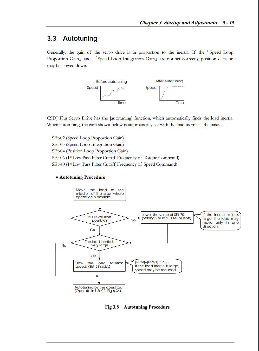

    So according to the manual then the Autotuning is the next step

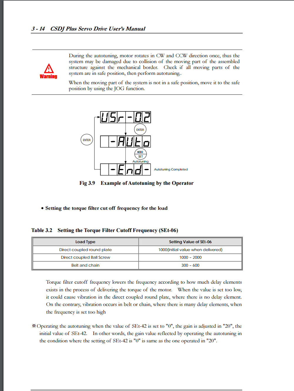

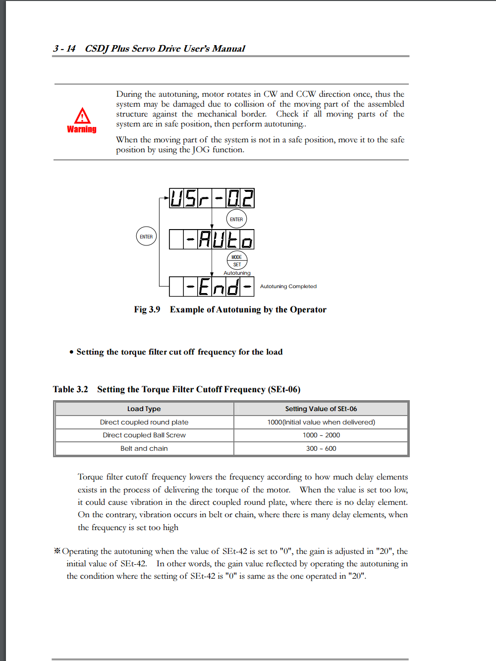

ID:	18424Click image for larger version.
ID:	18425Click image for larger version.

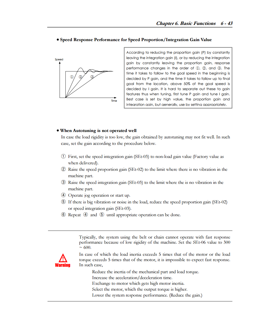

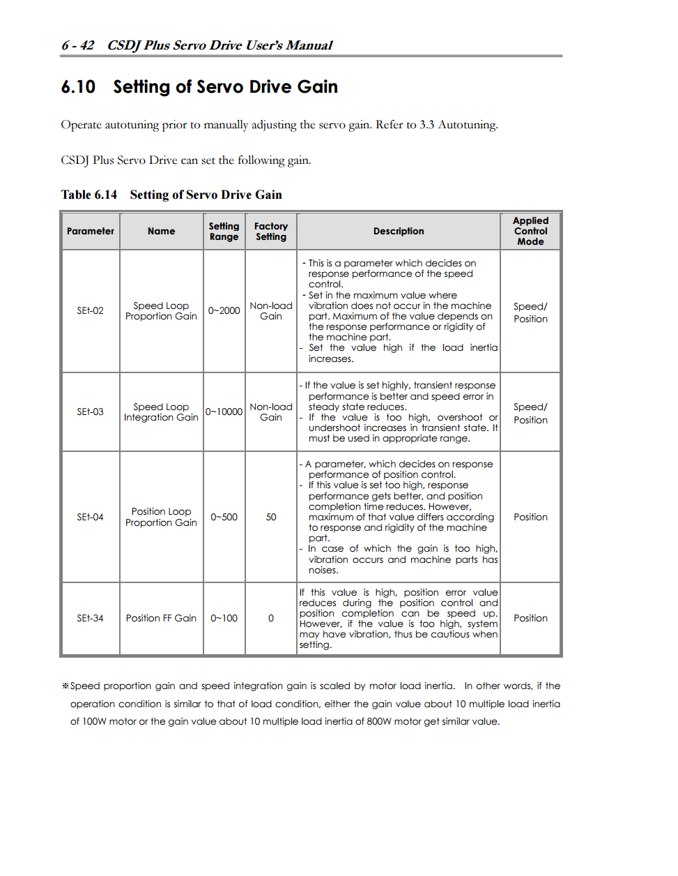

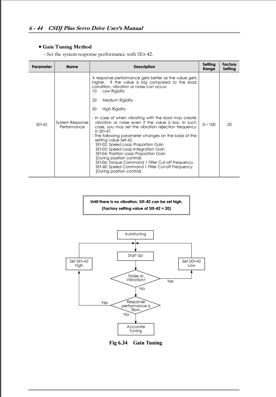

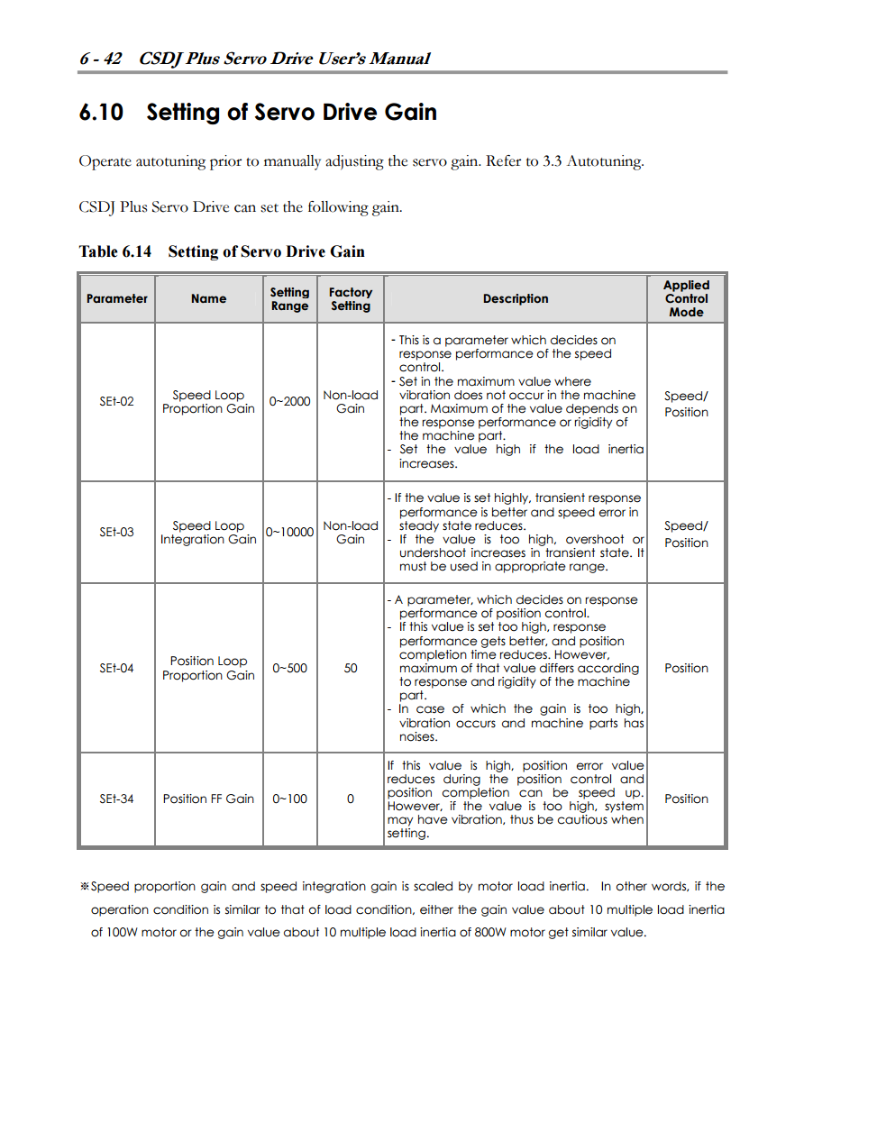

    I am reading now section 6, which is all about the tuning that is in the manual, apart from the auto tuning:
ID:	18422Click image for larger version.
ID:	18420Click image for larger version.

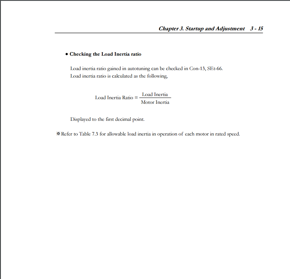

    I am starting to think that the auto tuning does not do things right for the Z. I am still baffled why the Jog from servo drive software is snappy and from Mach3 is like undershooting a bit?.
    Could that be the autotuning and that from there on the drive is not tuned and undershooting? Unfortunately my phone needs recharging but later will take picture of the Gain and autotuning screen from software.
    Another thing is -why when autotuning it always changes on next autotuning? it shows load inertia ratio 3-4, sometimes 8-9. Some times 1. I am baffled.
    What i did as a last resort is raised the gain from 20 to 70 now, and all seems more snappy even from Mach3. Though i am tired for today. Will continue.

    I could not find anything there or in the software about "[COLOR=#333333]falling edge" or "rising edge" , maybe cause they call them sth differently, though i think its not adjustable and somehow could be obvious to sb knowledgable looking at the pictures below.
    The drive will expect to see Step pulse either on the Rising edge or Falling. Can be a setting but often the manual just states what it requires.
    To change the Edge you do this in Mach3 using the Active hi/lo setting so it's easy to try if not sure.
    Ok I just looked at the pictures and it's right there in the first picture the portion you circled. TR=on /off
    Also the warning is saying what I suggested that if the low/high is wrong there is position shift and you'll have errors. Every direction change you'll lose one pulse.
    Don't think pokeys supports this but not used one for while so not sure but if possible wire step/Dir differential rather than Common Anode or Cathode.

    Reason was bad servo tuning. It seems it was a mistake to rely on the autotuning function. So it was undershooting . When positioning the Z. And the gantry also. Symptoms were you move it to position and when it stops there was a further fine adjusting movement. But as it is my first servo machine, i thought that normal.
    So i still do not understand very well how to fine tune the parameters one by one, even if i read a lot of info on internet. However luckily Samsung servo has 3rd method as seen on last document above. Just raising the gain, so all else auto adjusts some how. factory was 20, 50 is for rigid machine, 100 is max. So i made the Z gain 75 and now is snappy as a bullet from new AK47.
    All other axis are set to 50, and i am still testing if to raise that or no.
    I still have to understand if TR=on/off is set right, and how to change it exactly from the servo software. I guess as the machine is rigid, motors and acceleration are calculated correctly, gain is set correctly, if problems still persist then that would be the solution. Unfortunately Pokeys does not support differential.
