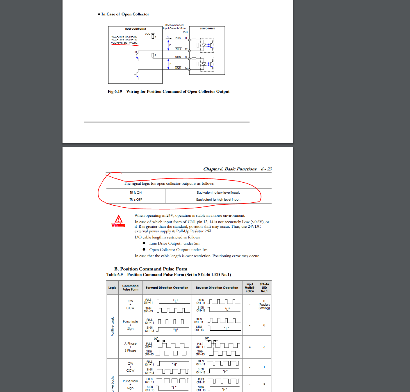

    Today i feel good so i decided again to brainstorm the problem. I read a couple of times again the bloody Samsung CSDJ PLUS manual. I could not find anything there or in the software about "falling edge" or "rising edge" , maybe cause they call them sth differently, though i think its not adjustable and somehow could be obvious to sb knowledgable looking at the pictures below.

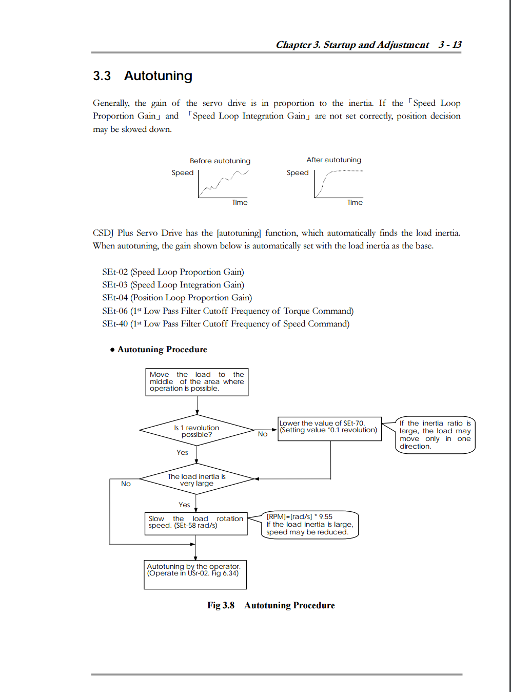

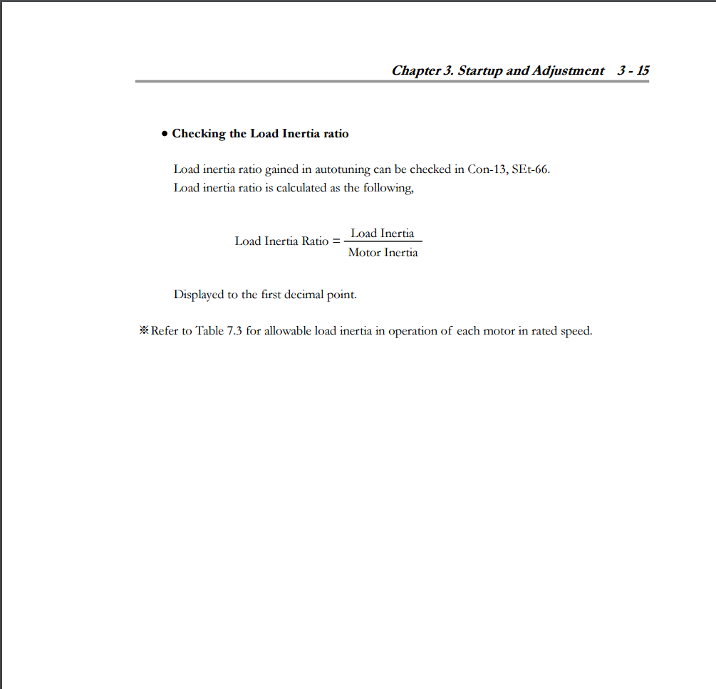

    I am starting to think that the auto tuning does not do things right for the Z. I am still baffled why the Jog from servo drive software is snappy and from Mach3 is like undershooting a bit?.
    Could that be the autotuning and that from there on the drive is not tuned and undershooting? Unfortunately my phone needs recharging but later will take picture of the Gain and autotuning screen from software.
    Another thing is -why when autotuning it always changes on next autotuning? it shows load inertia ratio 3-4, sometimes 8-9. Some times 1. I am baffled.

    I could not find anything there or in the software about "[COLOR=#333333]falling edge" or "rising edge" , maybe cause they call them sth differently, though i think its not adjustable and somehow could be obvious to sb knowledgable looking at the pictures below.
    The drive will expect to see Step pulse either on the Rising edge or Falling. Can be a setting but often the manual just states what it requires.
    To change the Edge you do this in Mach3 using the Active hi/lo setting so it's easy to try if not sure.
    Ok I just looked at the pictures and it's right there in the first picture the portion you circled. TR=on /off
    Also the warning is saying what I suggested that if the low/high is wrong there is position shift and you'll have errors. Every direction change you'll lose one pulse.

    Reason was bad servo tuning. It seems it was a mistake to rely on the autotuning function. So it was undershooting . When positioning the Z. And the gantry also. Symptoms were you move it to position and when it stops there was a further fine adjusting movement. But as it is my first servo machine, i thought that normal.
    So i still do not understand very well how to fine tune the parameters one by one, even if i read a lot of info on internet. However luckily Samsung servo has 3rd method as seen on last document above. Just raising the gain, so all else auto adjusts some how. factory was 20, 50 is for rigid machine, 100 is max. So i made the Z gain 75 and now is snappy as a bullet from new AK47.
