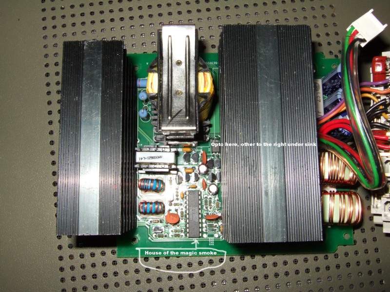

    A couple of hi-res images if needed ...
    http://www.i2net.me.uk/files/cnc/min...oard-hires.JPG

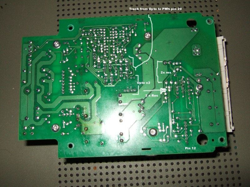

    Back of the board showing the 2 optos (2 x 4 pins), the track feeding pin 20 (Error Amp) on the PWM and the 4 res making up the 2 voltage dividers. (ignore the pencil marks, they may or may not be correct!)
    Top of board, only 1 of the optos is visible.

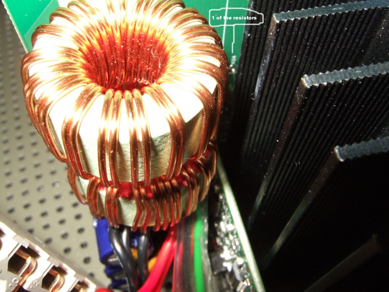

    Close-up of output coils, one of the two large voltage divider resistors marked (R34). The large resistor from the second divider (R11) is right next to it.
    The zener is just so I can set up your test circuit... still not found one :(
    My idea is to modify one or both of the voltage dividers by fitting parallel resistors, this is a nice easy modification and so long as we don't ask for the impossible the whole of the control circuit should play along with us :)
    Example:
    In fixed mode the op voltage is 42.9v and the voltage at the centre of each divider pair is 4.29 volts. This 4.29 is the critical voltage in fixed mode, the control circuit will do every thing it can to maintain 4.29 volts at the centre of the divider pair. If we reduce the value of the lower resistor in the divider then this resistor will drop fewer volts and the divider ratio will effectively increase. If we select a value that gives us an 11:1 divider for example, in order to maintain 4.29v the output voltage would have to be 47.19 volts. Yay, in theory :)
    Reducing the value of the upper resistor in the pair reduces the divider ratio which should allow us to modify the output voltage range in variable mode.
    What I don't know for certain is the value of the resistors in the pair, my colour vision is not so good so I can't read the value of R34 or R11.Once we know the value of one of the resistors we can calculate the rest :)

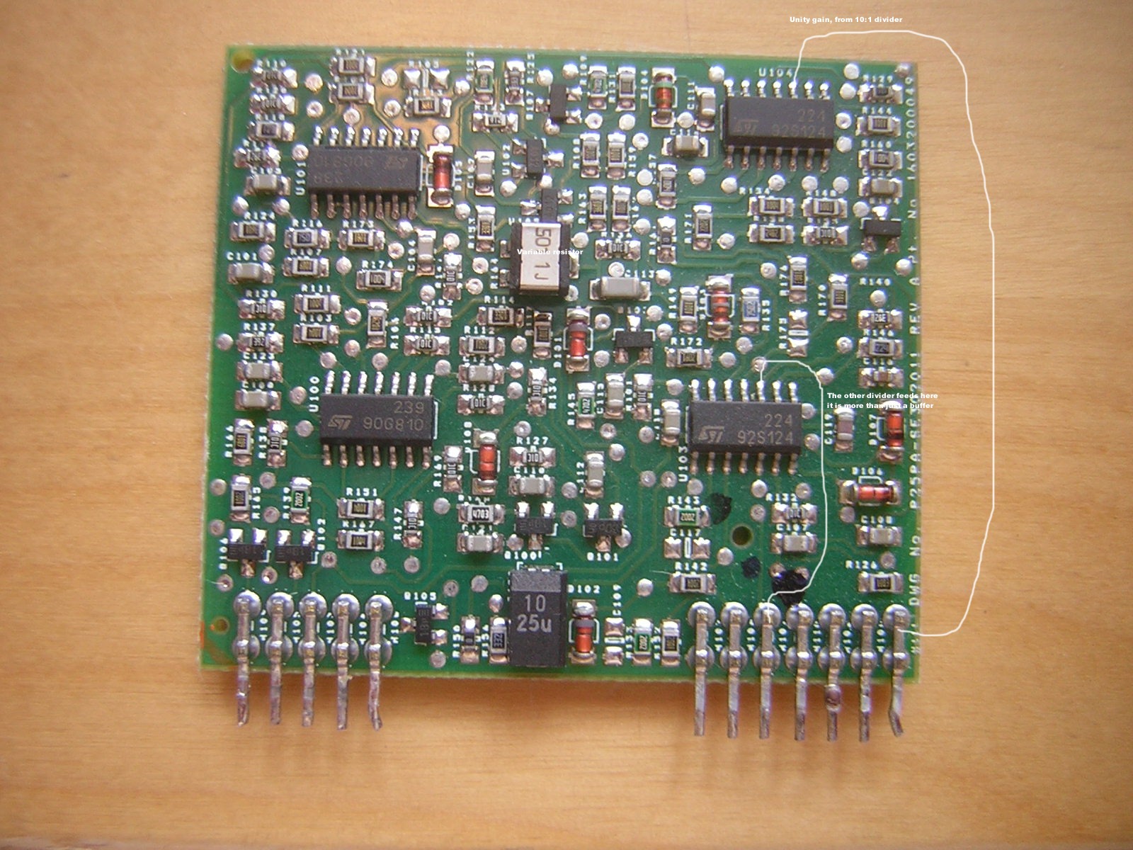

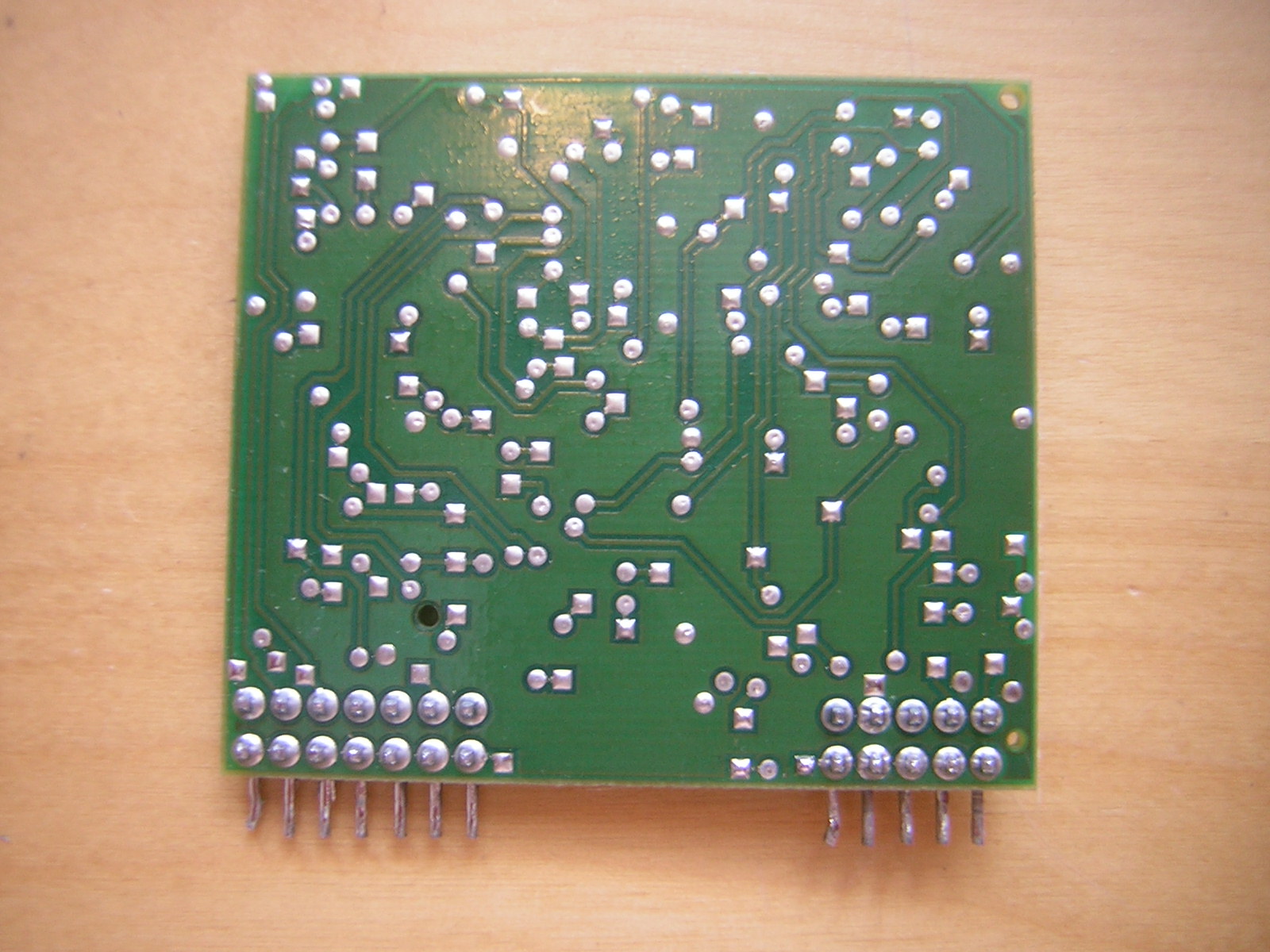

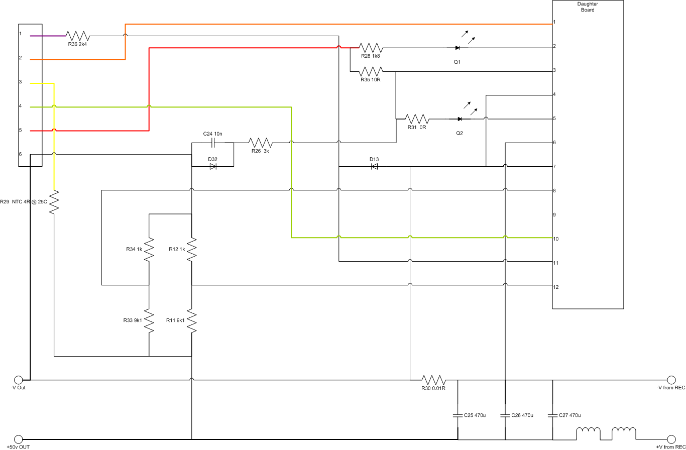

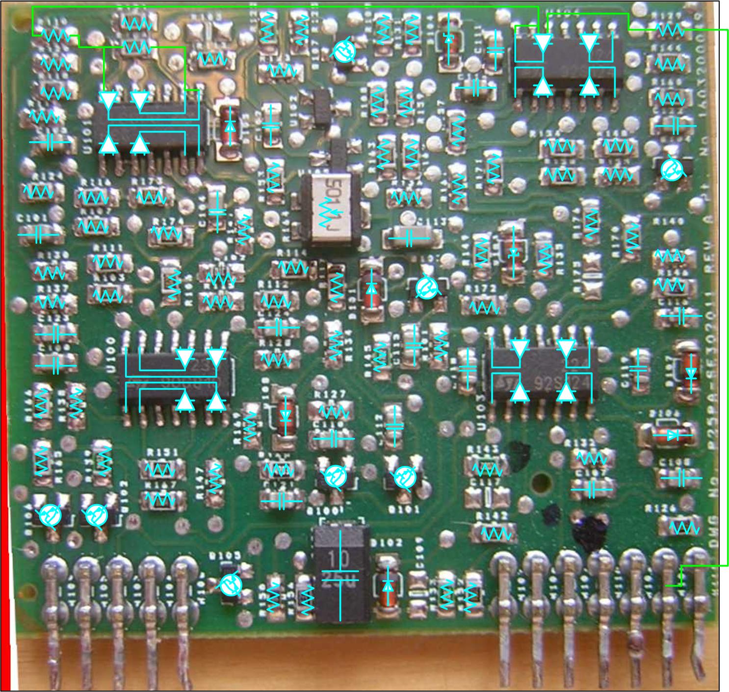

    Attached is circuit diagram for the wiring to the daughter board. Q1/Q2 are the opto, the 6-way connector to the top left is the connection to the output connector. Also attached are pics of daughter board, will start tracing that through later this evening/weekend, and main board after decimation.
    On the 6way, pin 1 is the control volts Ucr, pin 2 is SYSOUT, pin 3 is the 50v rail internal to the PSU (via temp compensation so can be used to control output voltage on load in a system), pin 4 and 5 I suspect are +/- voltages to the control board and pin 6 is common.
    It is likely as ecat says that R11/R12 and R33/34 are the dividers providing upper and lower voltage control limits, why there are two isn't clear. Adjusting either R11 or R33 may not change the output voltage, but merely adjust the levels at which the SYSOUT function changes state... some experimentation needed there... but getting closer...

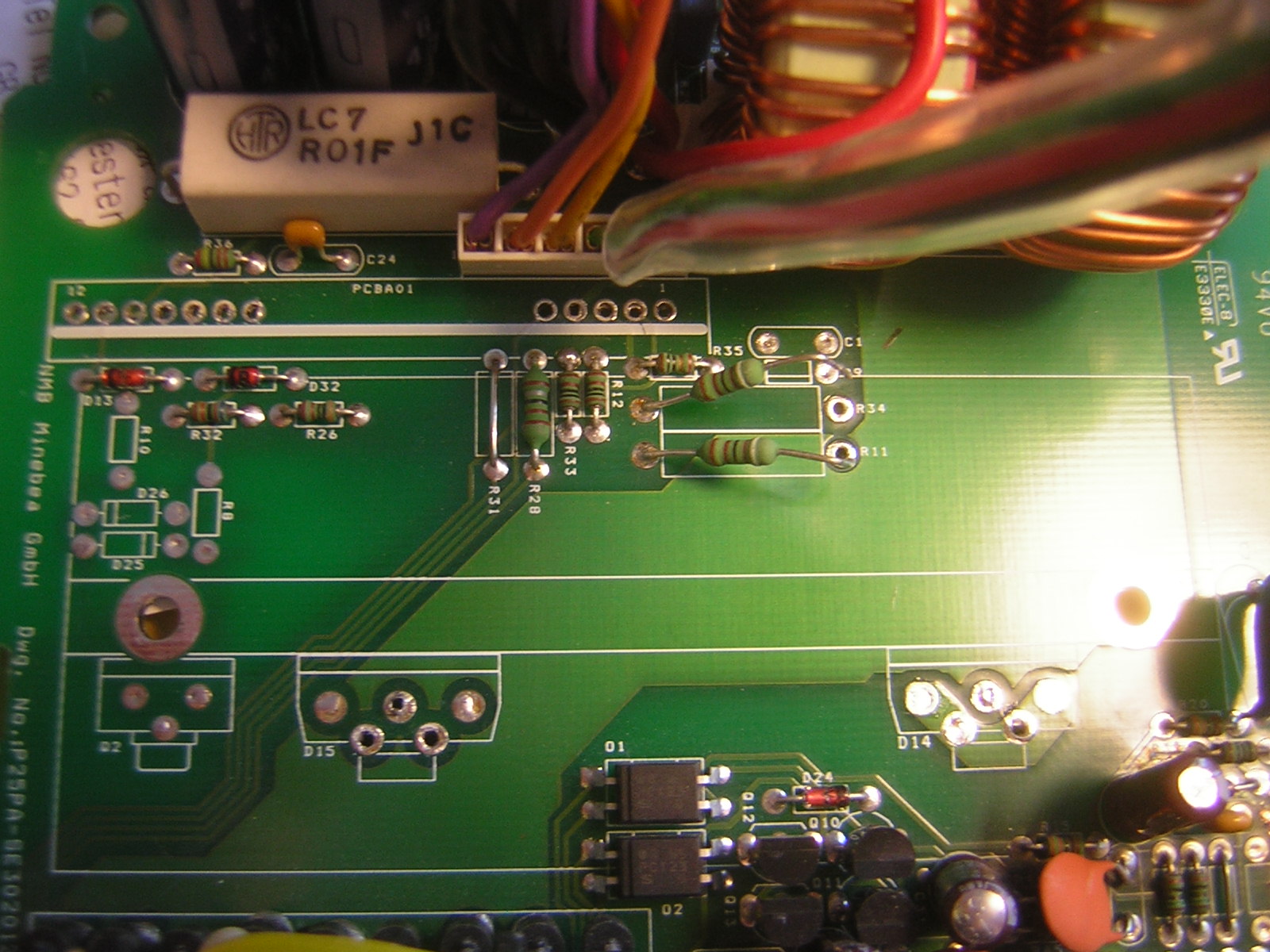

    You have been busy. Indeed, R11, R12, R33, R34 are the ones I'm looking at, 9.1k and 1k make the 10:1 divider. Lovely. So, I'll stick a 10k resistor across R11 and or R12 and we'll see what happens. Why 10k? As my old man said one day 'it's always 10k', in this case it may, or may not, give us a fixed output of 47v. Good enough for you?

    Ok, in fixed mode I now have 47v output :naughty:
    First attempt was across R12, I don't know what it is supposed to do but it doesn't affect the fixed mode voltage.
    Second attempt I used 9k4 in parallel with R34 and the result is close enough to my calculations. Always a good sign. Why start with 9.4k? Simple, I found a bag of 4k7s.

    I've identified all the parts on the daughter board with the except of U102 and U105 which are just above the variable resistor, marked A012. All the other transistors on the board are generic NPN (1Bp = BC846) and PNP (3Dp = BC856) but these are designated like ICs - I have a suspicion they might be band-gap current sources or something...i dont think they are mosfets as these are designated 'Q' types elsewhere and diodes are 'D' (there are 6 generic small signal types and 2 zeners).
    I've imported the diagram into Visio and populated it... now just putting in the links.... see attached WIP...
