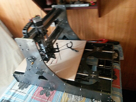

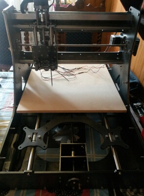

    What stepped from my head to reality for now is this desktop router.It`s a small but very rigid little thing. It`s about 70 kg total weight,
    and it`s a 90% mechanically done. I`ll have some z work ,as you can see, then some paint job, plastic covers, cabling, makeup (maybe not :-) )...
    Here are the pic.(sorry my spare phone is terrible, broke the real one week ago :-( , hope i`ll get new one before spindle build starts ).
ID:	21660Click image for larger version.
    P.S.Sorry for a little off topic, F the router, lets make some SPINDLE!
    and..sorry for my a little "better" then google translate, english :-) .

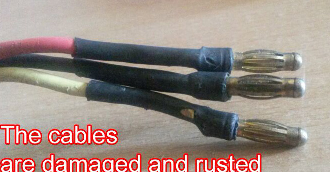

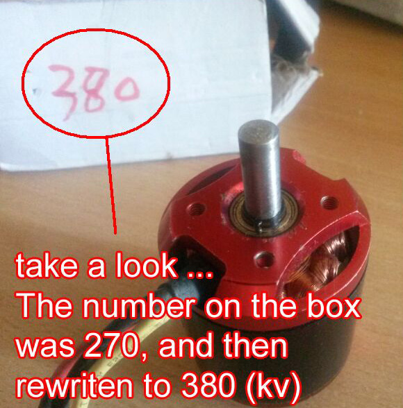

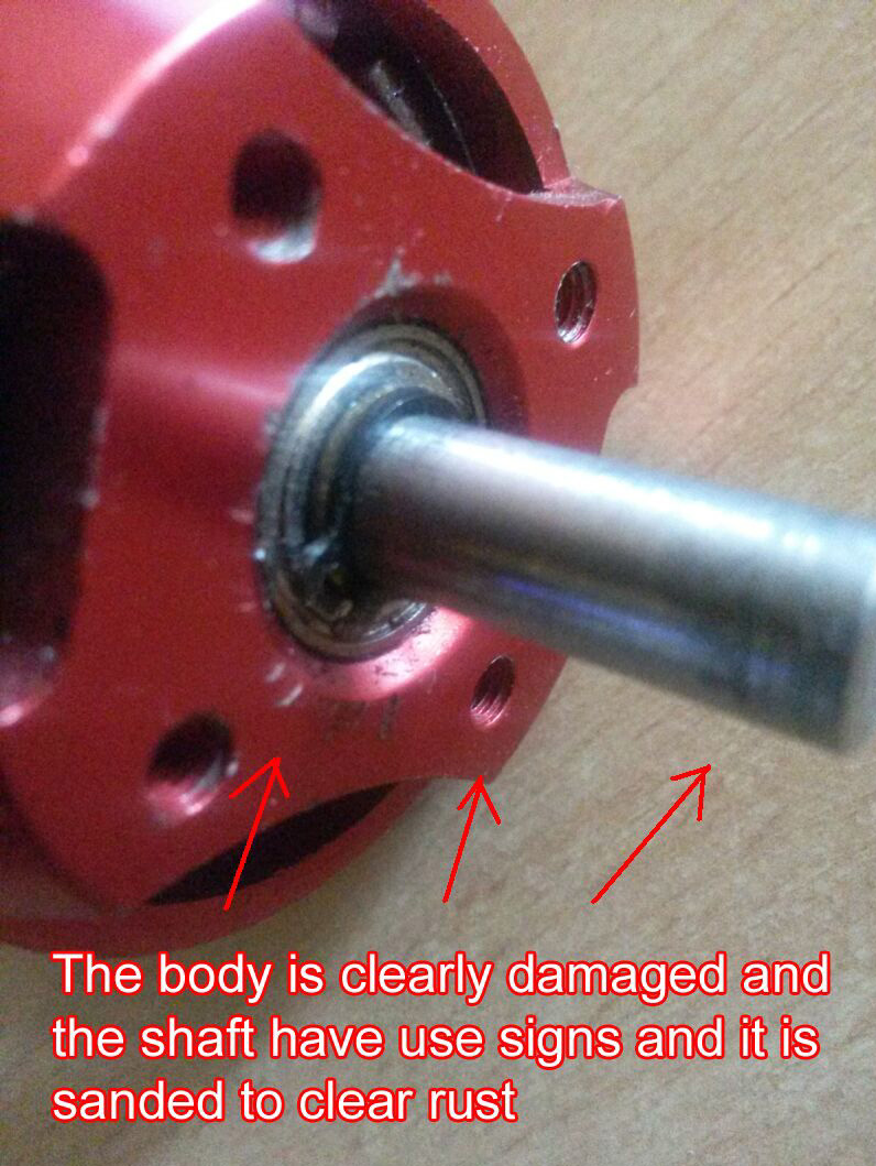

    Lee said that ppl here love pictures...
    So here they are... :-( , but not happy ones.
ID:	21674Click image for larger version.
ID:	21675Click image for larger version.
    So... motor come today. I was very happy, but my happines lasted for about 10 sec, and then pufffff...
  11. #9
    Update:motor returned.
    Looking for new one... 500-600kv.
    Any suggestions?
