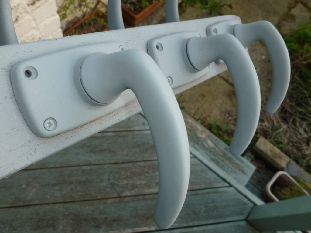

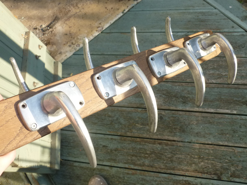

    I've been restoring some old alu door handles. As ever, it's one step sideways then another couple backwards, but here's my method so far:
    1. Back to bare metal, steel-wooled everything smooth.
    2. Primed, two light coats.
    3. (Can you guess what I didn't do?)*
    4. Gloss coat.
    *I didn't rub down the primer before applying the gloss and now I'm left with a subtle stippled effect.
    Okay, a dumb school-boy error (ha, who knew that a once over with a scrap bit of denim would have sufficed to knock the roughness off the primer?)
    My question - do I need to go back to bare metal, or can I let the current finish dry for a day or two and then steel wool it back to some sort of flatness, clean it with a rag/meths and then go again with the gloss?
    Wal.

    The good news (after deciding not to wait until next week for my mistakes to cure) is that the fresh paint has come off easily to get me back to metal. I came across this solvent free stripper a while back and it works a treat - just ten minutes after coating the handles the paint was pretty much falling off 'em:
    So back to square one with not too much additional ball-ache. I'll be sure to rub back the primer this time around. Thanks for all the suggestions..!
    Wal.
