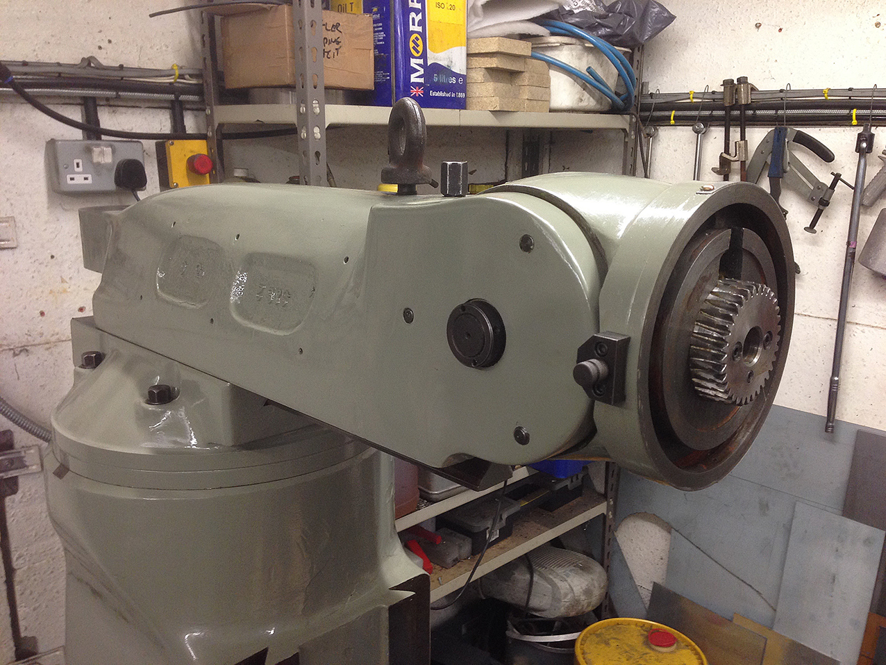

    Got the ram and knuckle on this morning, also stripped and painted the saddle and head.

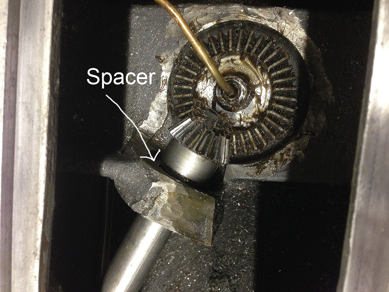

    Also fitted a spacer here as the gear mesh was terrible, way too wide. For the first time in all the years i've owned her, the knee now glides up and down silently

    Looking lovely Dave, looks so much nicer cleaned up and painted, should turn out to be a nice conversion/restoration.

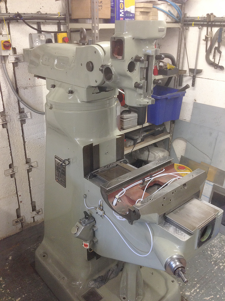

    Got the head on, spindle in and new oil pipes plumbed in and tested.

    Also stripped and painted the lower drive housings and scraped out the wax that used to be grease ;)
  10. #100
    Looking good Dave, are you fitting new ballscrews you ordered as you re assemble or are they fairly easy to access/fit without breaking down the whole thing again?
