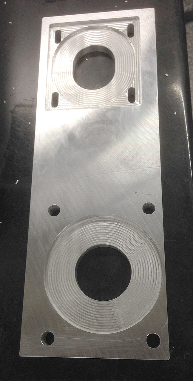

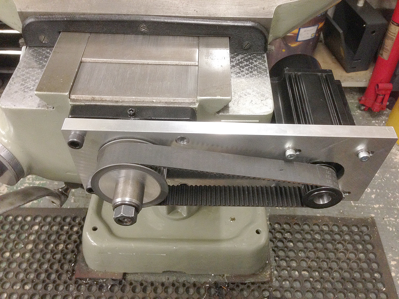

    Decided to exercise my minimal CAD/CAM knowledge and plunge into a slab of 15mm ally for the Y axis motor plate.
    Took 44 minutes on the mini-mill, used a single 5mm tool for the whole job and pocketed all the waste out ;)
    Fitted perfectly...
    Seemed a better place than hanging down below I think.

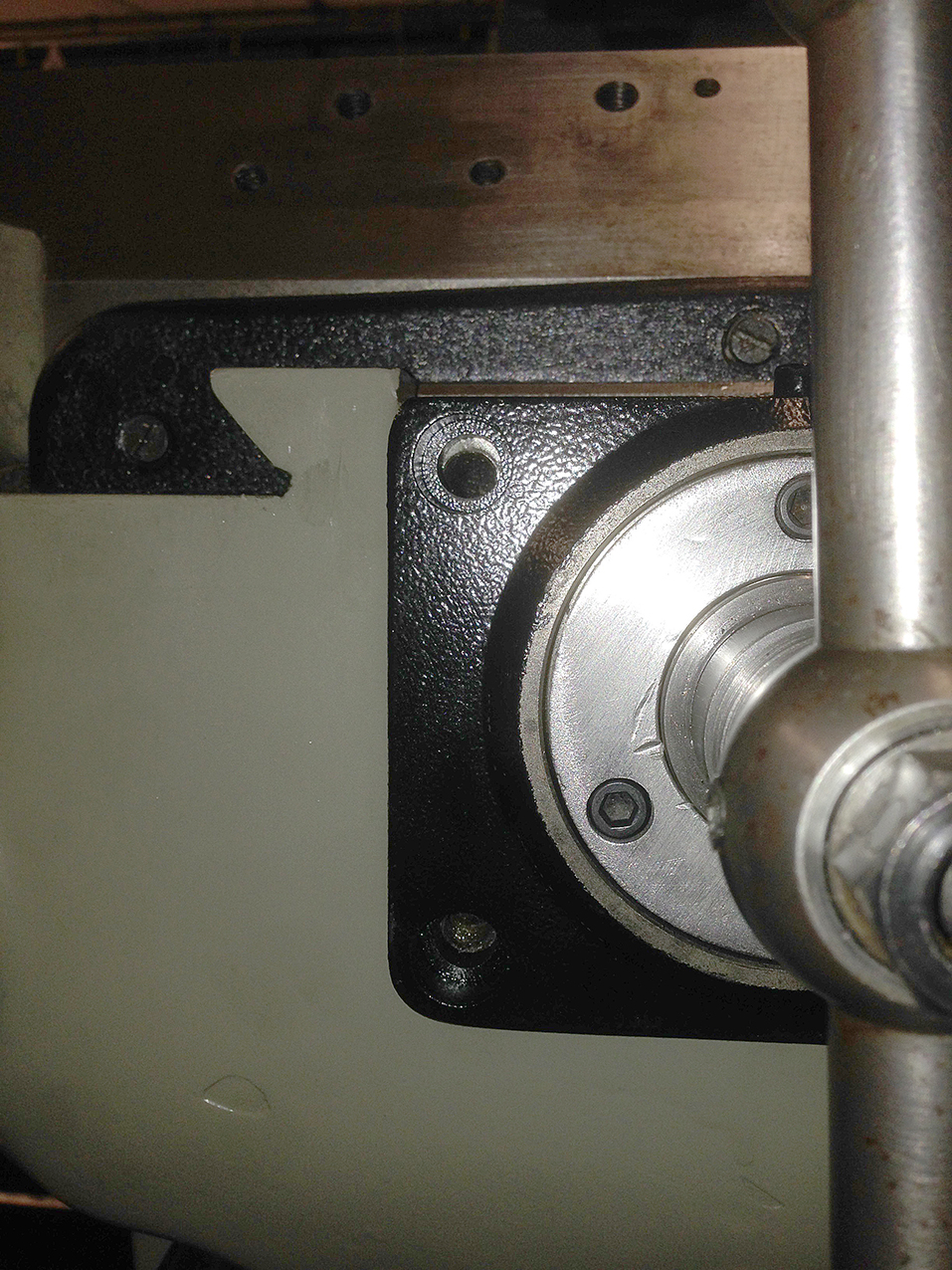

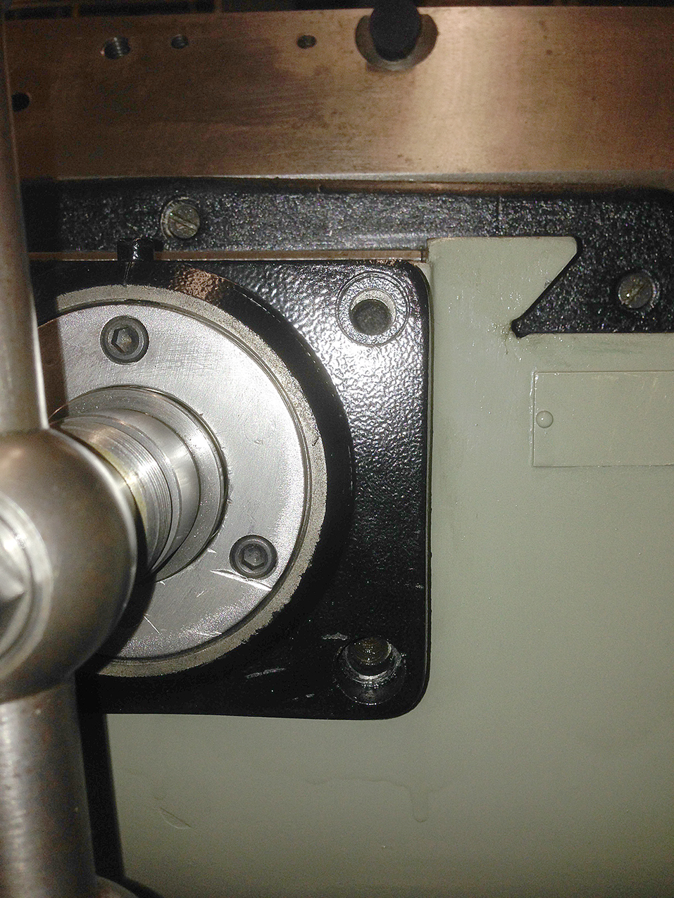

    Finally got the replacement Y axis screw Got it fitted and got the table back on at last...
    Not quite plug-n-play though - the new end bracket does not fit properly and will need machining, will have to get this done elsewhere as my mill not usable ;)

    Can't simply file the holes longer as the counterbores need moving too. I had to get the new bracket as the original machine had power-feeds.
  7. #127
    Found a local company to move the bores and counter-bores on the Y axis bracket - so annoying having to get stuff done outside when it would have taken me about 15mins to do, I had to leave it most of the day, make two 30min trips and stump up £40 :(
    Anyway, done now and fits nicely, also mounted the motor plate using some spacers to pick up on the bottom of the counter-bores at the top face is not flat. Had to make a shim for the bearings to give a bit of pre-load but not bind up. Next job is to turn up a spacer tube for the pulley-to-bearing gap and then fit the belt - one axis finished.

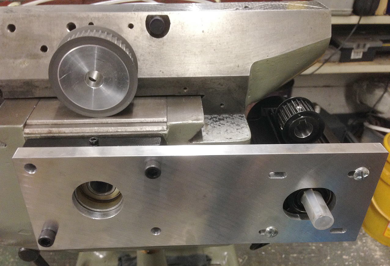

    Got X-axis motor plate fully fitted...

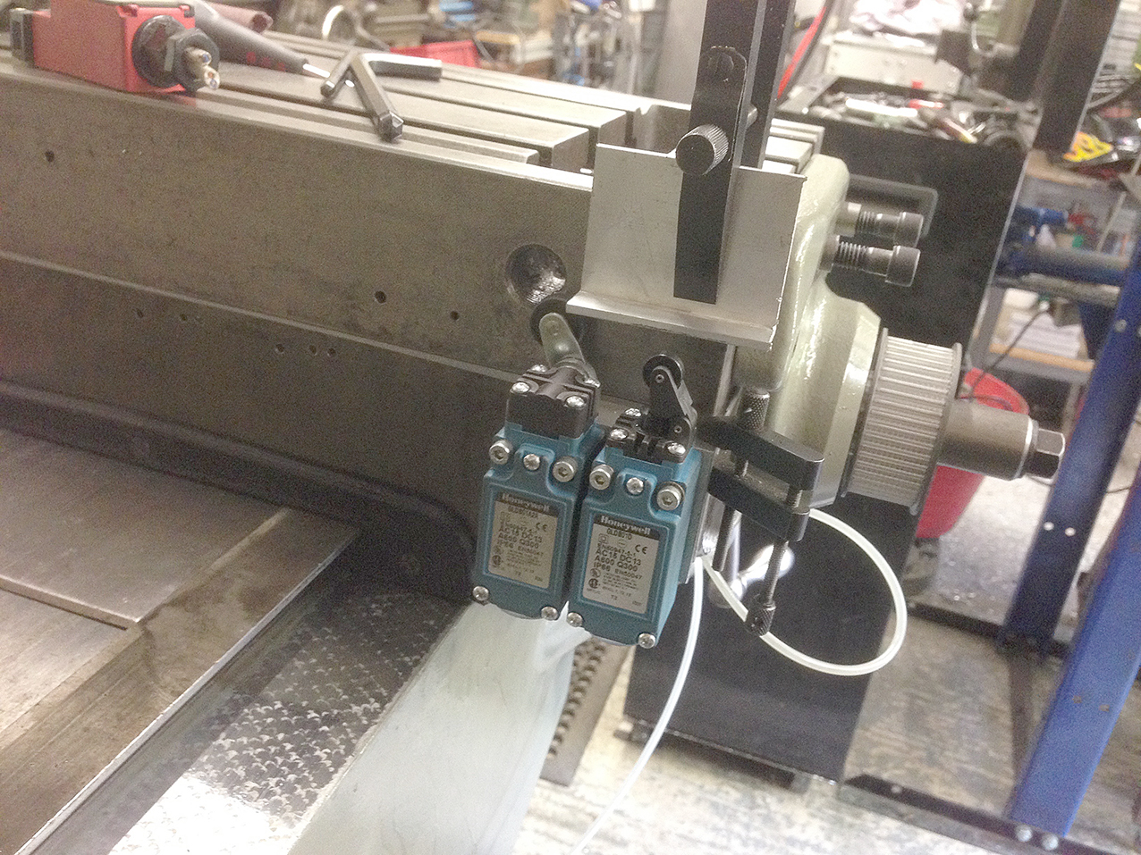

    Limit switches next, Y-Axis Limits and home switches...
    From the left we have Y--, Y-Home, Y++.
    The home switch remains tripped once it trips so that i can home even if the switch is triggered, a home-offset value will take care of the switch position.

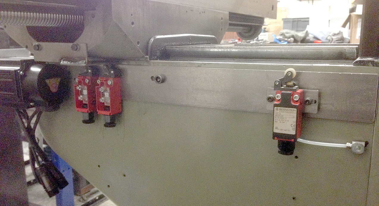

    Then the X-axis, a bit harder this one, first idea...
    From the right we have X-home then a dual-direction X-- & X++ switch. The picture is not quite right - imagine the right-hand switch is another roller type like the left one, I have one somewhere, just got to find it ;)
    The only down-side I can see is that it blocks the chances of using flood coolant again as the switches are in the way of the left drain hole.
    Still thinking on this one.
