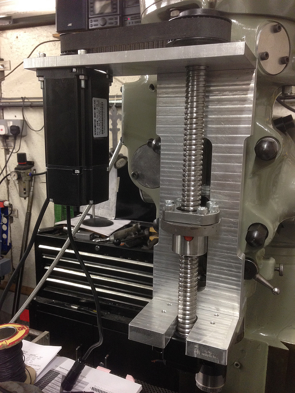

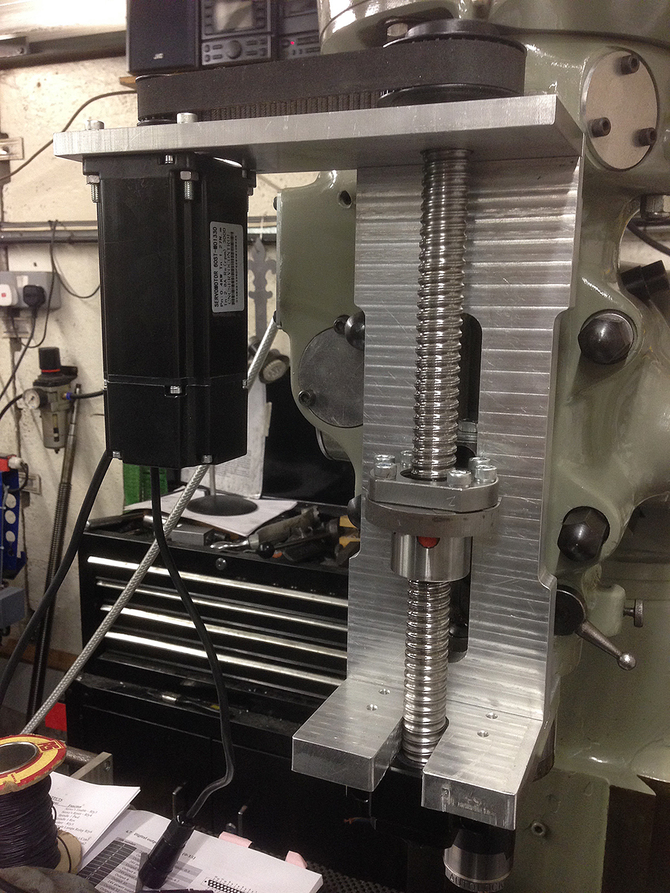

    Ok, sorted it i think
    Couldn't rest without a fix so a couple of hours fiddling and a few thin shims later we have smooth motion from top to bottom, its pretty easy to reverse-drive it by moving the quill lever
    The bracket that holds the nut was slightly twisted and the nut hole was too tight, fixing both of those cured the problem.
    Now i need to fix up some limit switches and get the motor hooked up.

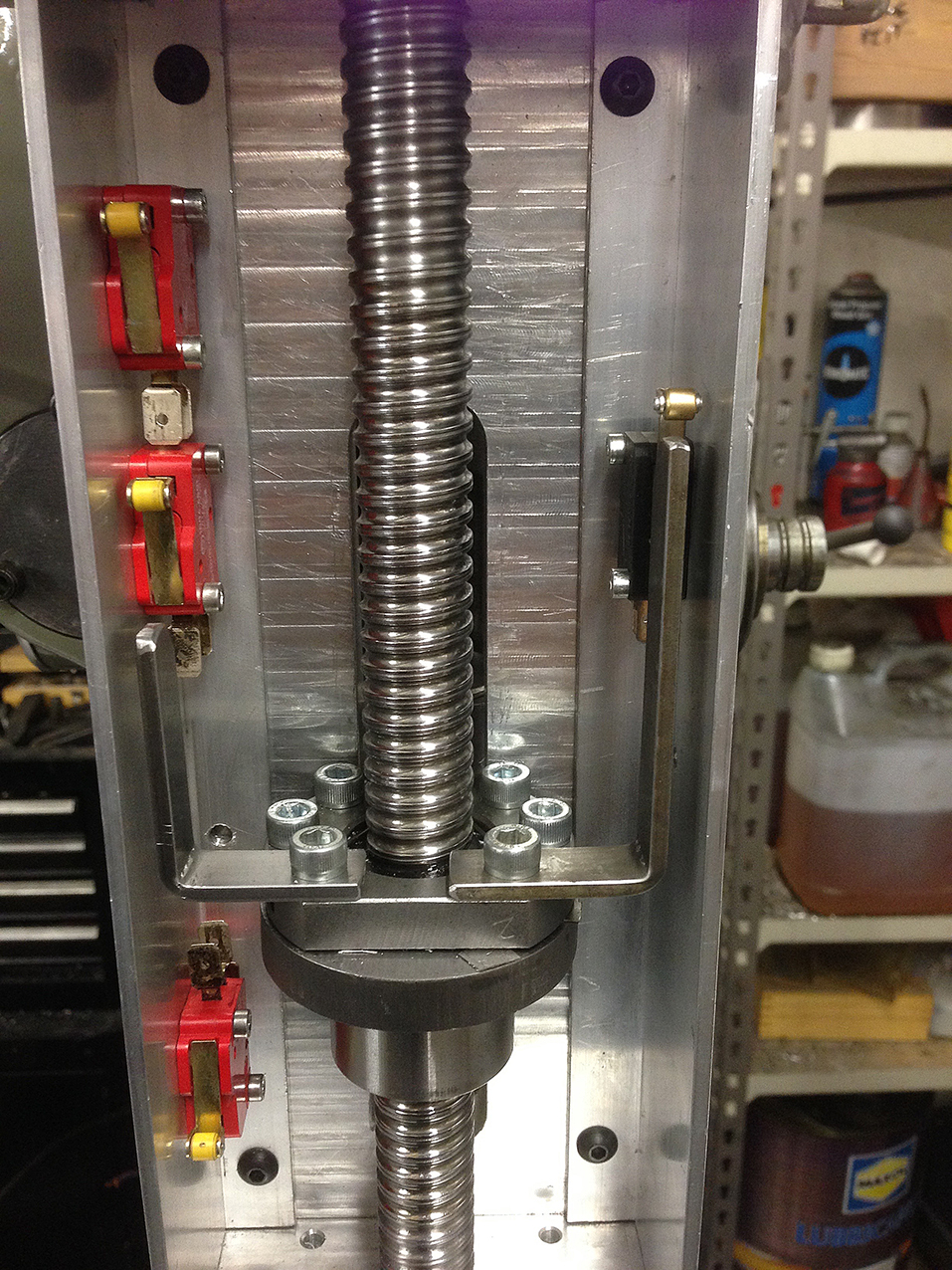

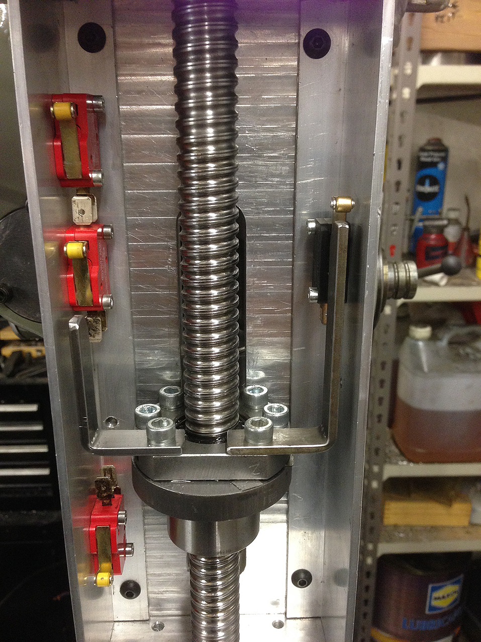

  2. #152
    Got the switches fitted and have finally achieved 3-axis motion :)

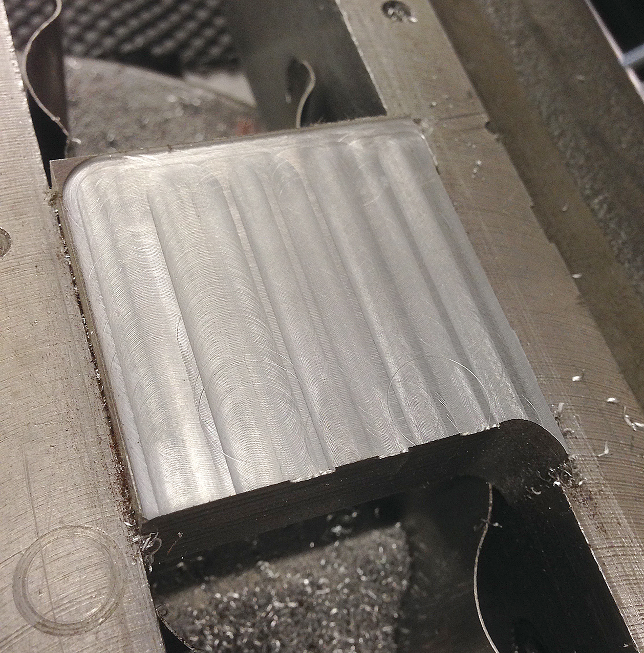

    Scary stuff - she has cut her first steel
    Spent the morning putting stuff back - trammed the head, fitted the vise and trammed that in, fitted a floating Z touch-plate and modified the touch-off macro so it did what i wanted.
    Threw a small lump of 20mm scrap in, a duff 1/2" four-flute cutter and programmed a facing cut in Aspire of 0.5mm, seemed way slower than i would have moved if doing it manually - may not be a bad thing. It gave me a speed of 140mm/min at 650rpm
    Picture below - looks worse than it is, pretty good finish as it goes considering the state of the tool etc. and dry cutting plus unknown grade of steel.
    Next I tried spot-drilling four places and followed up with through-drilling with a 6mm drill, all went perfectly.
    I really need to sort the speed control out though - it tells me when to put it in back-gear or high/low speed so the VFD can give me the final speed BUT it only does this when it gets the S command from the code - it shows the message on screen but the carries on cutting at the wrong speed. What i need is for it to stop the spindle and show the message, wait for me to set the right conditions and the restart the spindle and get to work.

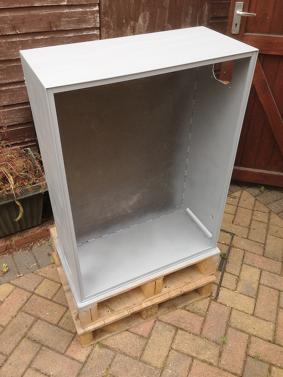

    Ha, I already have that built, it's fitted on the mini-mill.
    The next step is to weld up a suitable control cabinet, this is needing a big cab - about 850 tall x 700 wide and 270 deep, commercial ones are +£250 in that size so will plasma cut and weld up from 3mm sheet steel parts i think.

  6. #156
    Got the control cabinet built today, absolute monster and a two-person lift :)

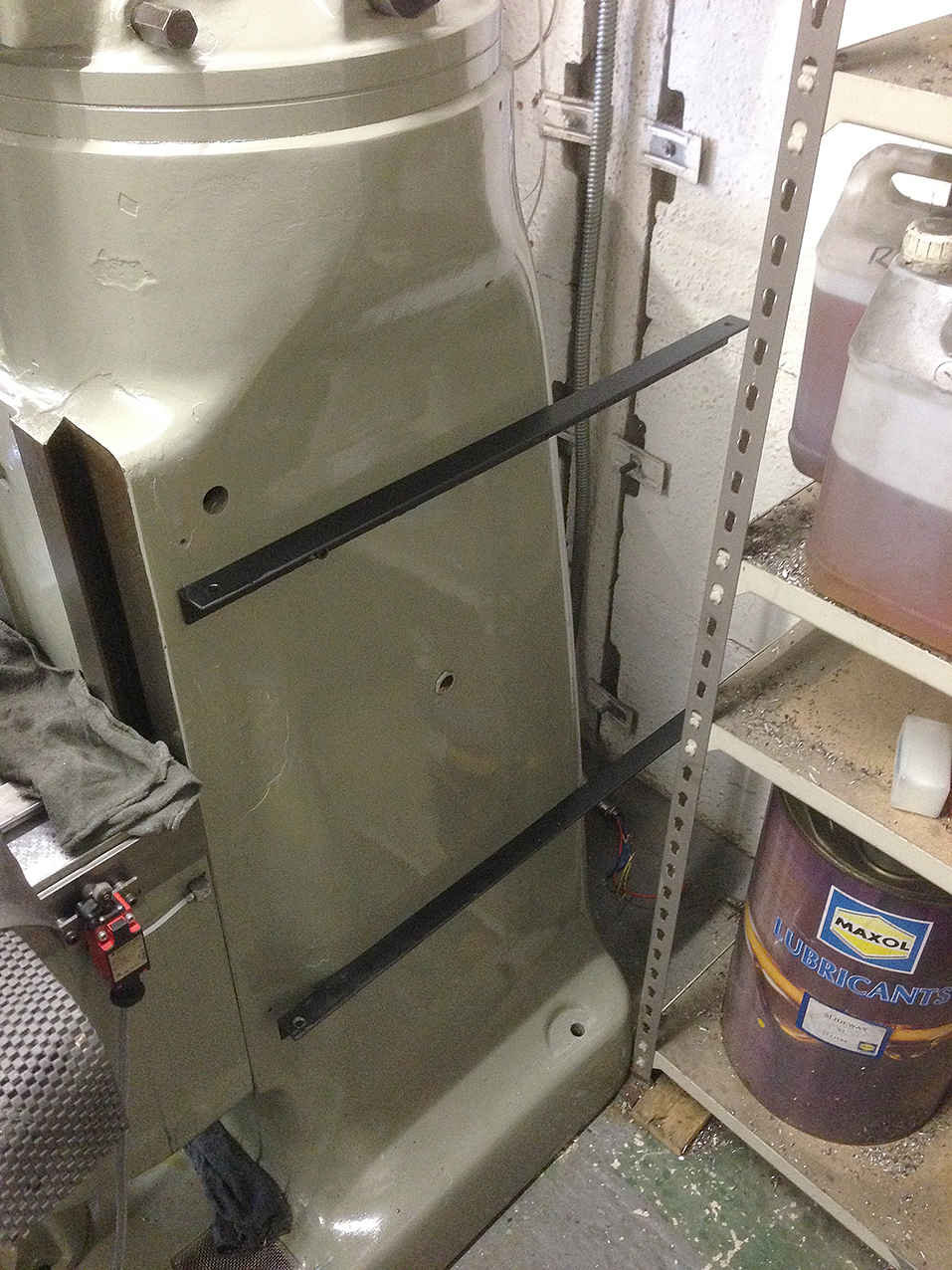

    Fitted the mounting bars too.
    Next job is to strip the test setup down and start final fitting.
    Well it will be a three person lift when you fill it
  8. #158
    your'e not wrong there, i have all the guts temporarily mounted on a pallet top and i can just about lift it all, not quite sure how i'll lift the steel panel into the cabinet yet;)

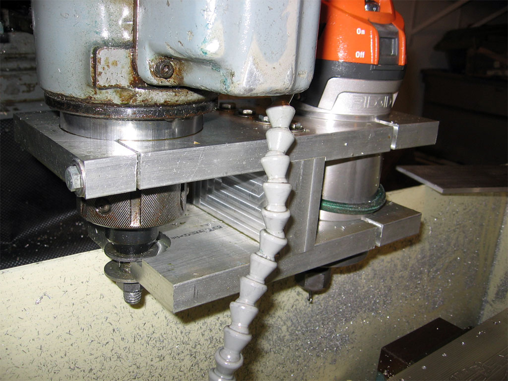

    Back to my dual-spindle attachment, yes its been done before, found two people that have done a great job and turned out some amazing stuff on them.
    I was looking at a single thick clamp ,made from maybe 25-30mm alu, but this idea seems far better....
    It uses a two-layer clamp, bridged in the middle firmly and then clamped on the quill plus clamped to a fixture held in a collet in the spindle. This seems like it would be very stable plus use up less of my valuable Z axis travel.
    Material is probably only 15-20mm thick so i would lose no more than 20mm of travel in Z, leaving me a healthy 100mm to play with. The wide spaced clamps should also grip the high speed spindle better too.
    Not sure why he has made the bottom clamp like it is at the spindle nose, I would go with a solid area and a 20mm shaft fitted for a 20mm R8 collet - the attachment would then be slid upwards into the collet and onto the quill.

    Why not just get a quillmaster or a speeder? Somthing that is inline with the spindle in the firstplace.
