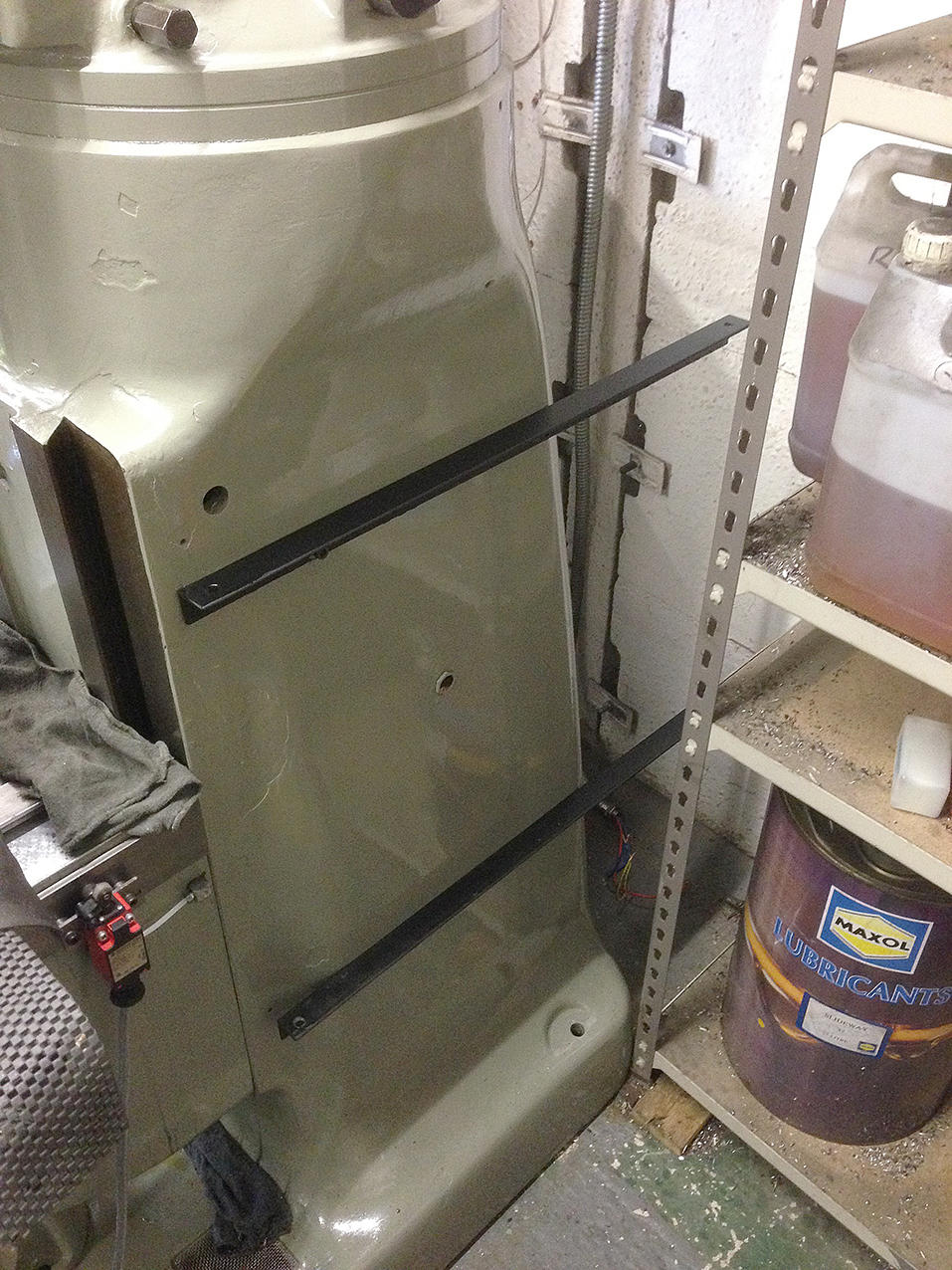

    Got the control cabinet built today, absolute monster and a two-person lift :)
    Fitted the mounting bars too.
    Next job is to strip the test setup down and start final fitting.
